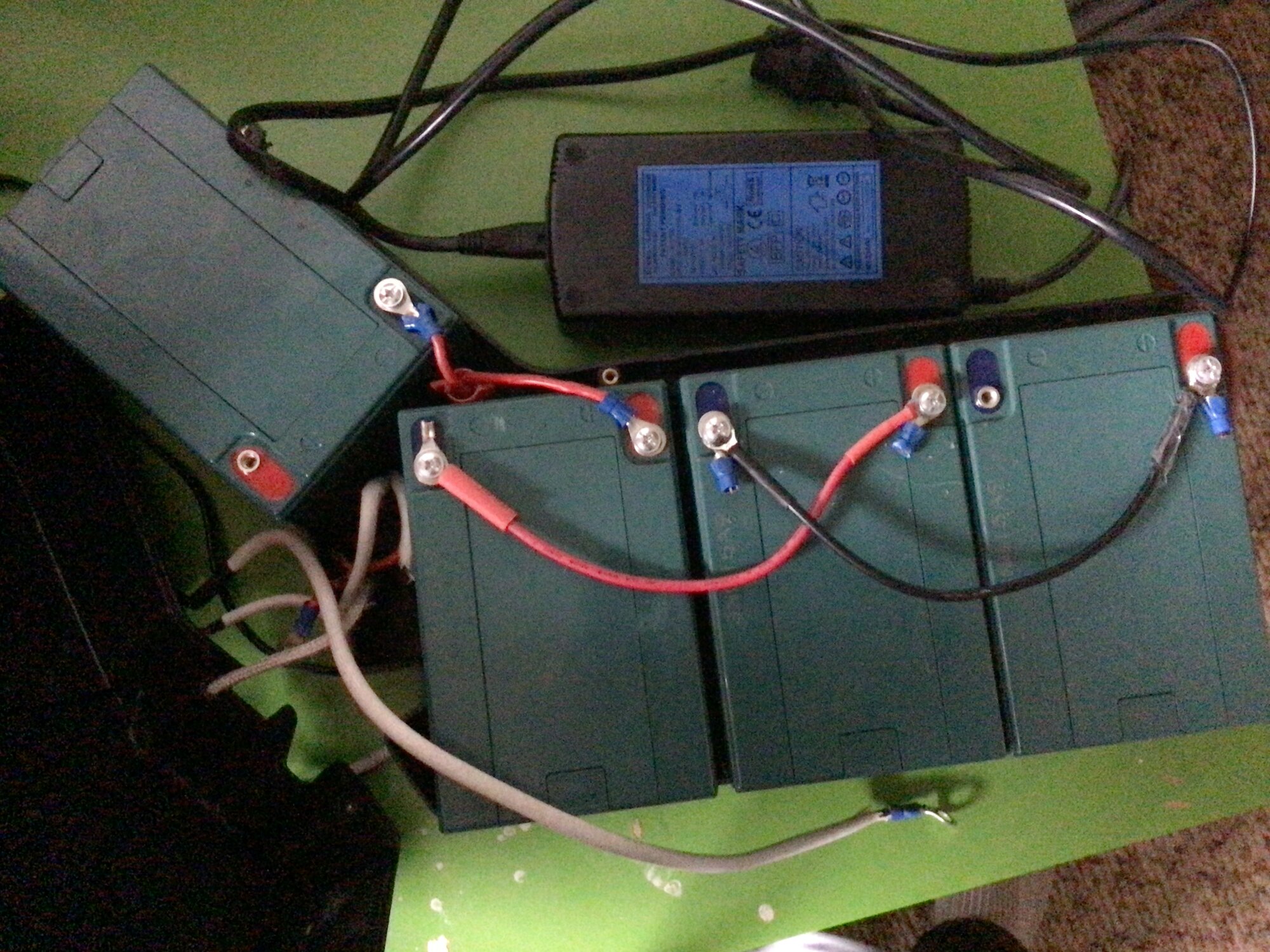

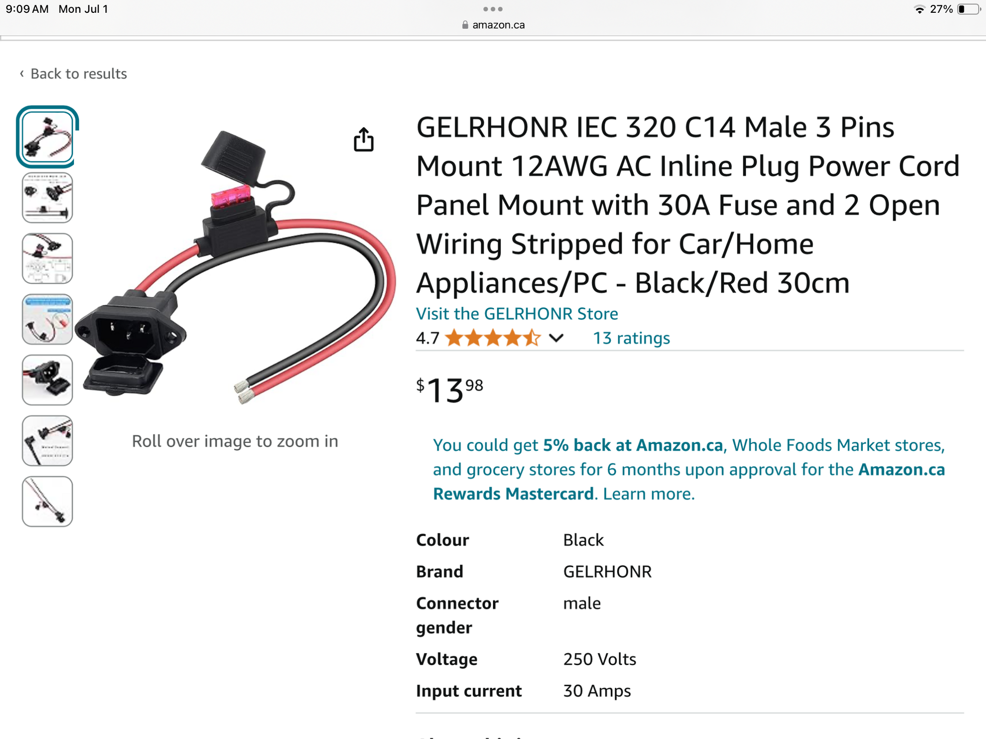

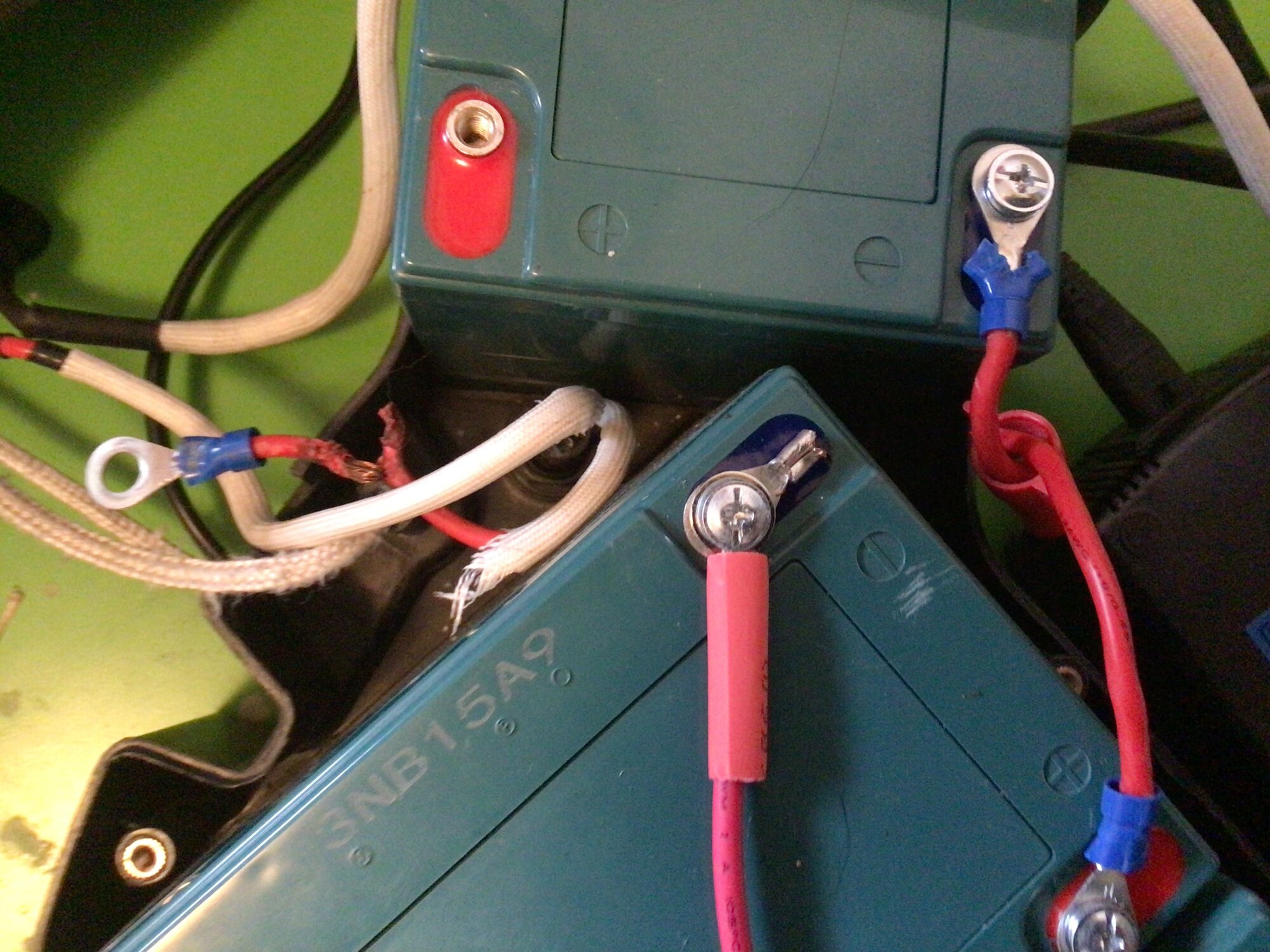

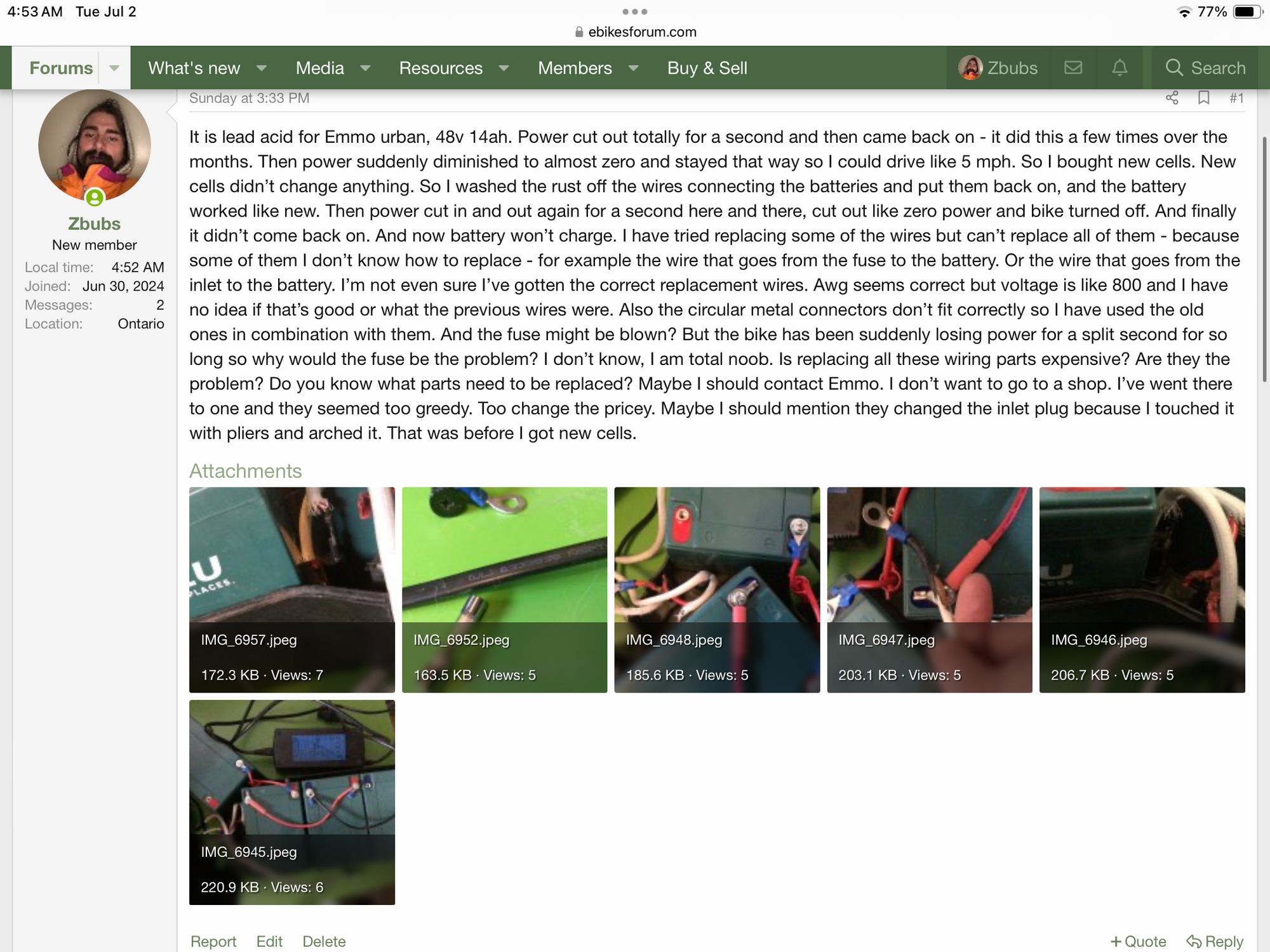

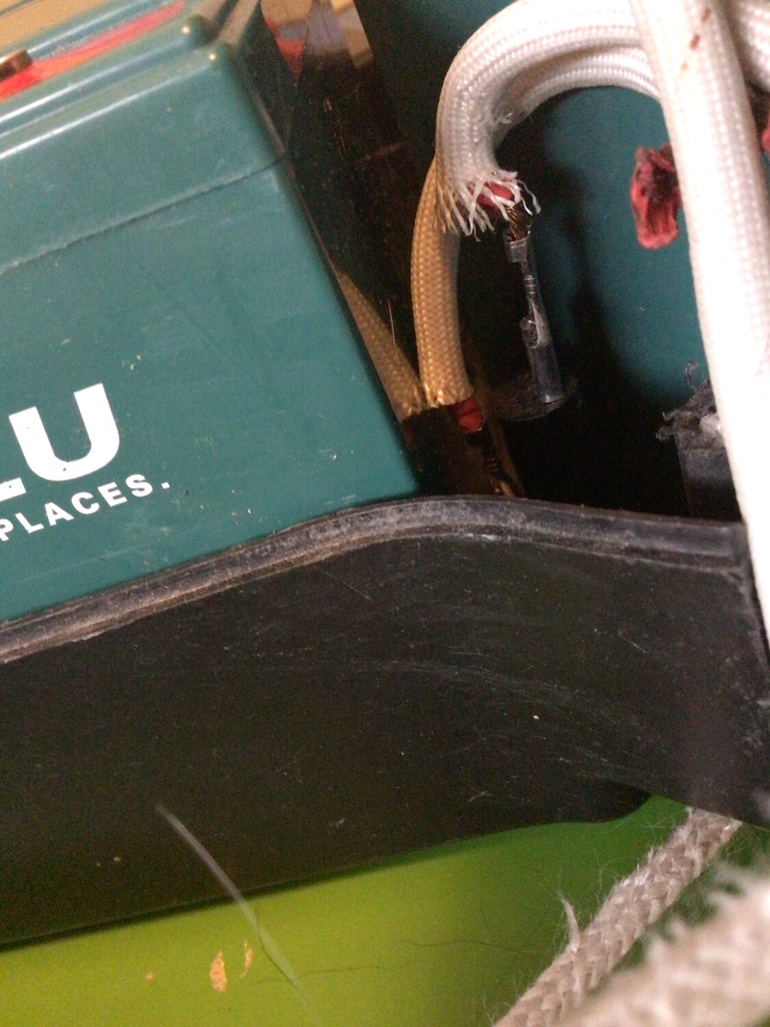

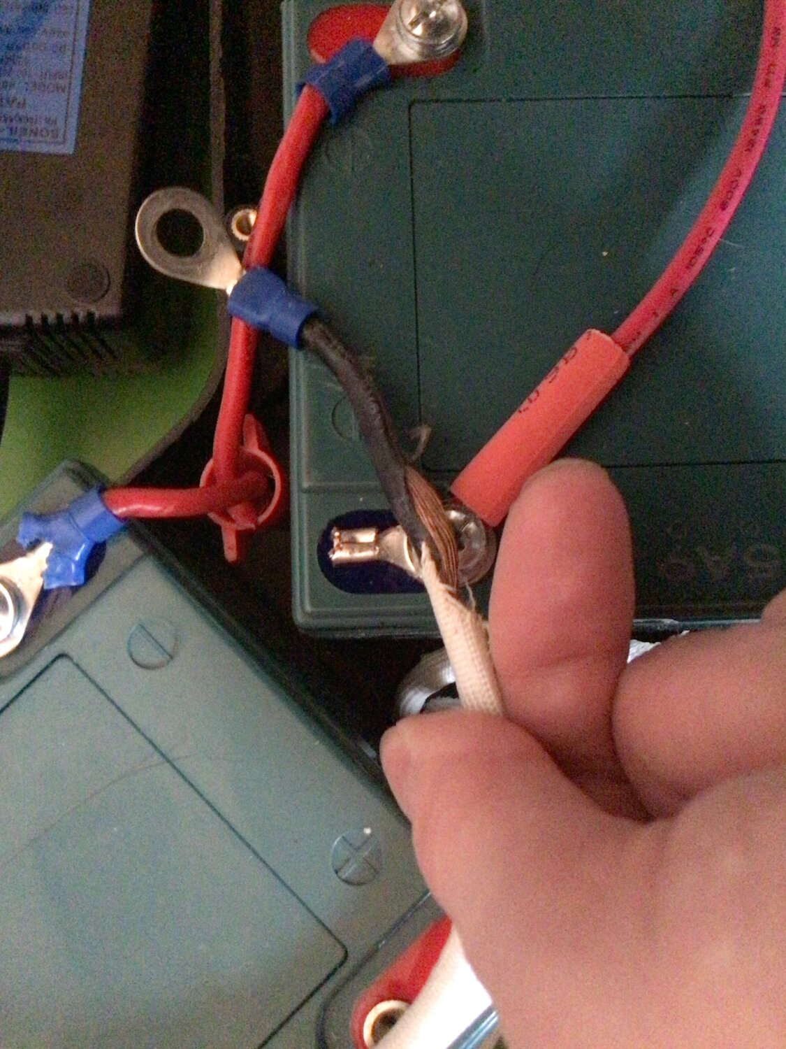

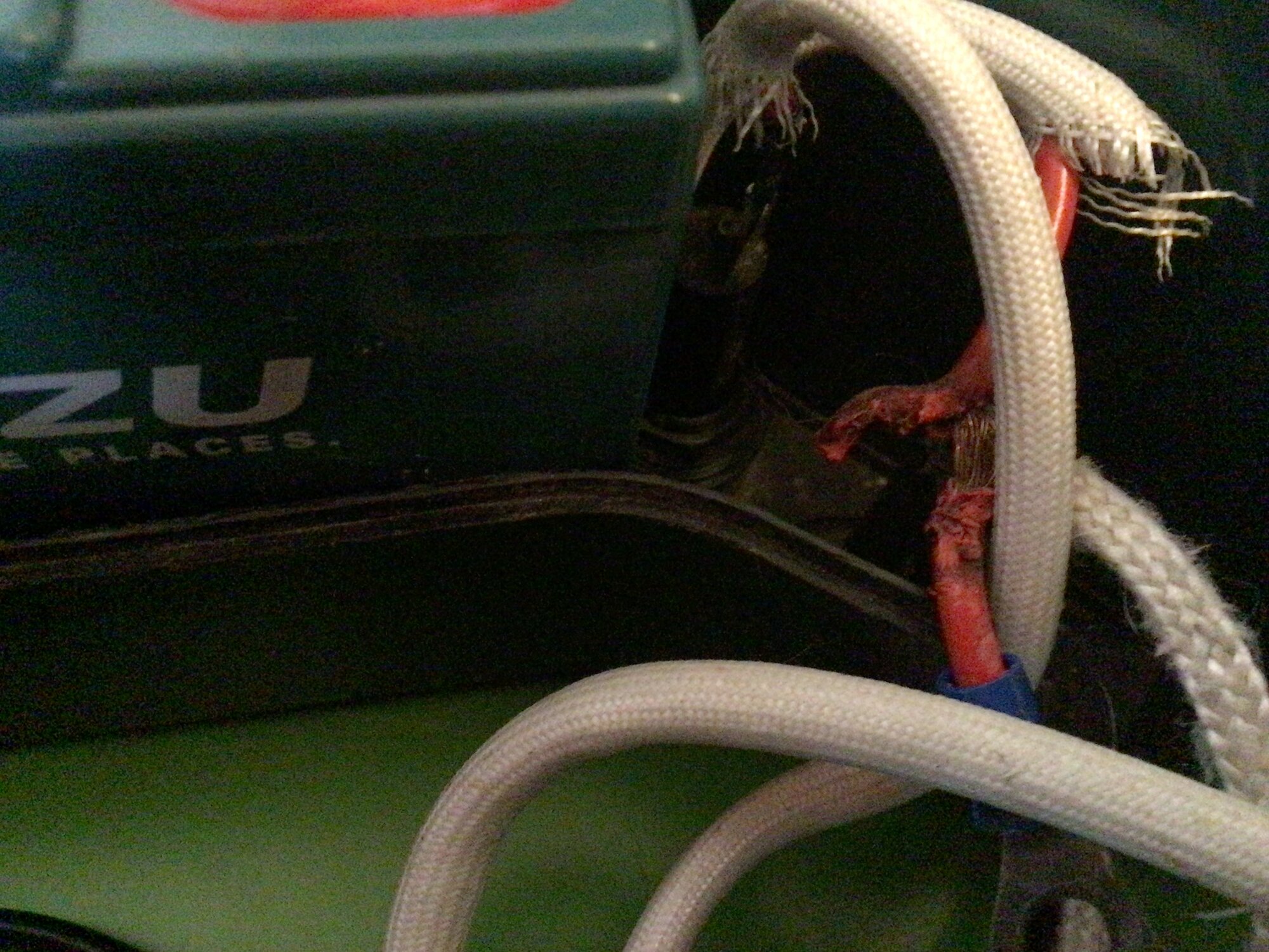

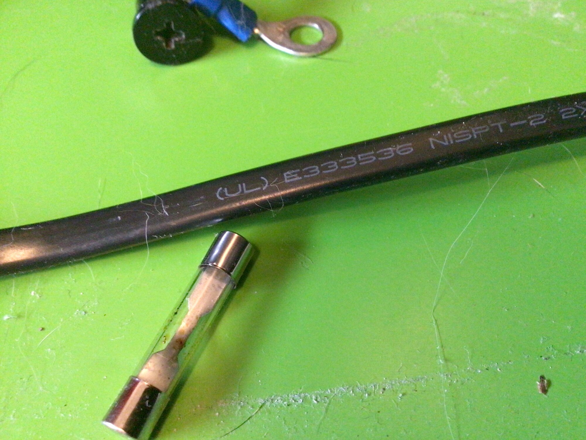

This is where I’m at so far. I posted this on another forum. I am pasting it here because I will get more people then to help me. can you read the dialogue in the pics? Do you think this Amazon link will replace my glass fuse?

Edit - I got in touch with Emmo and found out the amp of the fuse which is written on it - 20 amp, which makes this Amazon thing not workable. Emmo says they can replace all the housing , it is an hour away to pick it up . I’ve written back maybe they can mail it. It is nutty city driving in Toronto which is not fun.
Battery is fixed. Took it to shop. Paid 58 dollars. Seemingly, I’m a noob so who knows, they bypassed the fuse. So battery has no fuse now. But battery works and better than ever so far. New wiring seems to give it more power. I am very happy.
What did the dealer say about the wisdom of bypassing an ebike battery fuse? Does that battery live or charge in your house or garage?
Others might know the real risk level, but the question should be asked.
Those are SLA batteries, so it's not as dangerous as Lithium ion, but it should have a fuse.
He could short out the battery, melt the wires and start a fire, but the battery shouldn't explode.

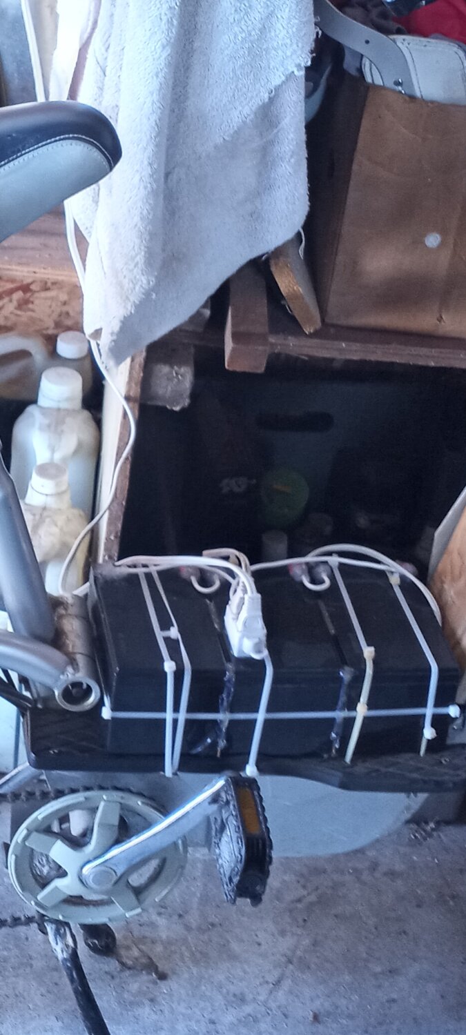

I've got the same thing going on with my old e-bike,..
I used used Polarized extention cords to make connectors to plug the battery into the e-bike and charger.
I'll be fine as long as I don't plug my ebike directly into an outlet. 😂
