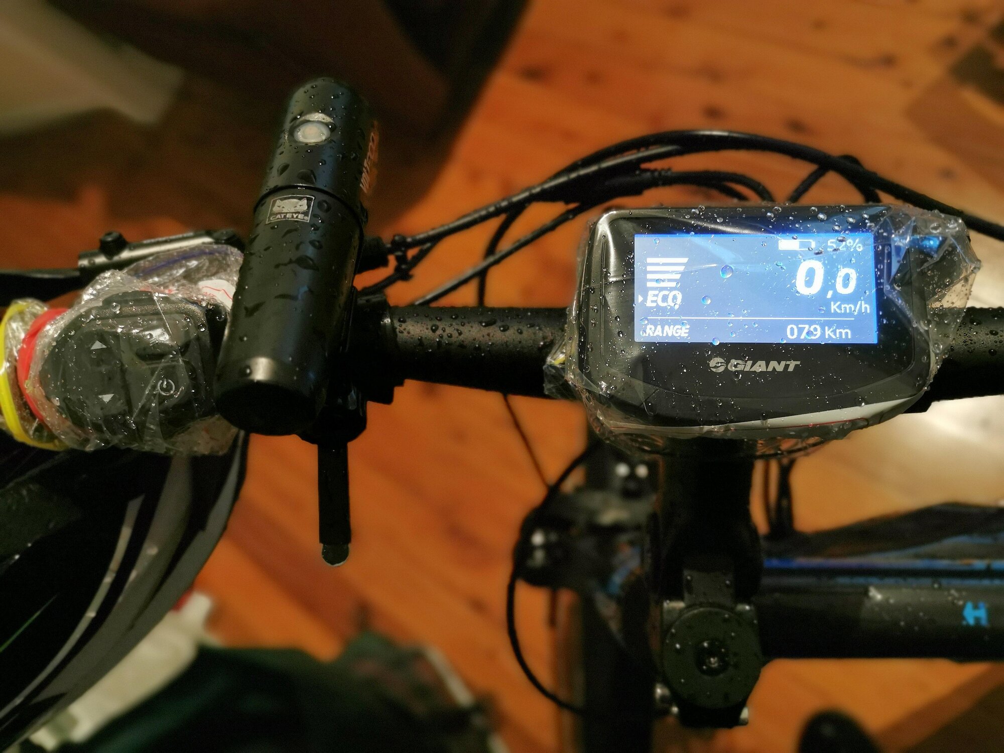

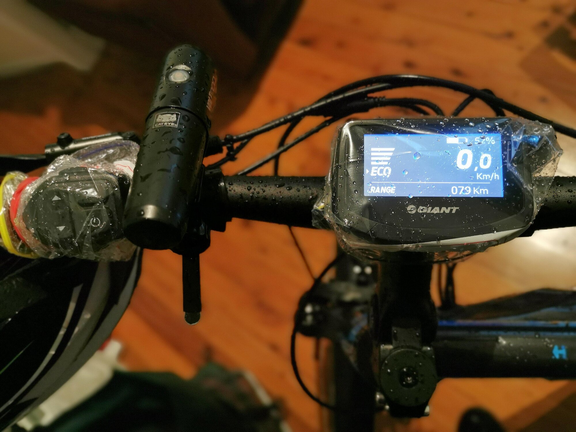

I don't know if I'm being overly paranoid here, but warranty or not this is my daily commute and I need it operational so in the rain I've started taking these precautions:
1 cent sandwich bags and rubber bands that came with the pak choy FTW!
