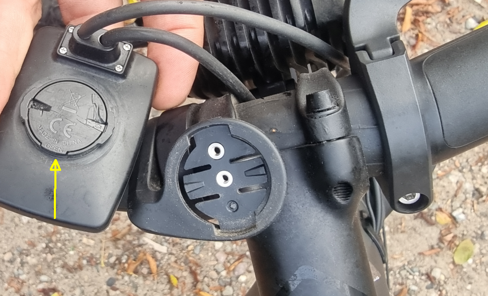

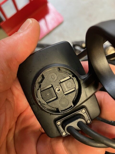

I am trying to replace the battery of my TCD-W but OMG its seems like impossible. There are two versions of this display. Some you just twist of and underneath is a little cap. But not this one. Underneath is a metal spring attached with a tiny screw. Once removed it looks like this (see picture) But what do to next?? Anyone? Please.

Just pull the cover up from a side. Do not try to turn it.
I'm affraid there is nothing to pull up there.

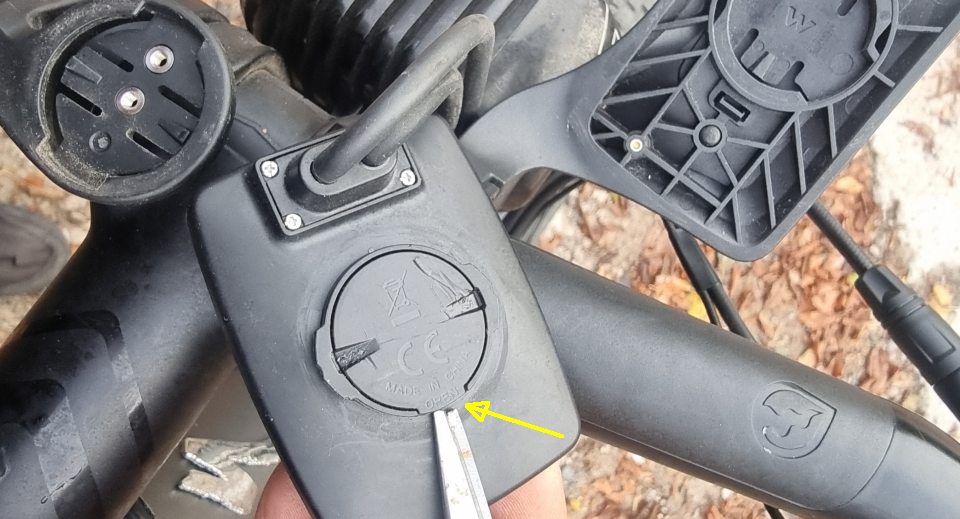

^ Hi Marco, it looks like you still have the mounting bracket attached to the display, it should just twist off now and allow you access to the cover Stefan mentions: see if this thread helps
Thank you @Bavi! The promised pictures:
Remove the display from its holder by a quarter-turn.
Use a sharp object to pull the cover up where indicated (a tab clearly marked 'Open').
Extract the battery by inserting the sharp object where indicated.
You need a CR1220 battery, and a new one will last for at least a year, depending on how often the e-bike is ridden. I cannot say for any Vado Gen 1 model but the lack of an operating display locks my Vado 6.0 motor out.
Hopefully a new CR1220 will do the trick.
It has to! Only check whether one side of the battery (the inner one) is not protected by a sticker. The sticker (if any) contains a bitter substance so young kids would not swallow it :) I write this as I overlooked the sticker on one of button batteries and then wondered why a device didn't work :D
Unfortunately no succes :-(. (not due to protective sticker) messured the new battery and it is fine. Can it be that the display has to be paired again with the motorcontroller?
No! As soon as you have inserted the battery and closed the cover then started the system, the display should come up alive...
I was in a situation in which I had to replace a damaged display with a new one (including the cables, and the handlebar remote). Just after connecting the new unit, the system went alive. If there was any new pairing necessary, it could only affect the Mission Control but not anything else. The display works autonomously and is not paired with the controller or motor.
Isn't it the time you should visit an authorized Specialized dealer?
Marco, make sure the contacts inside the unit are clean and battery is connecting with them properly... BTW, was there any life at all on the display with the old battery (if there was, try putting it back in and see if any life returns) and if you can check the voltage on the old one too just for comparisons sake 👍
