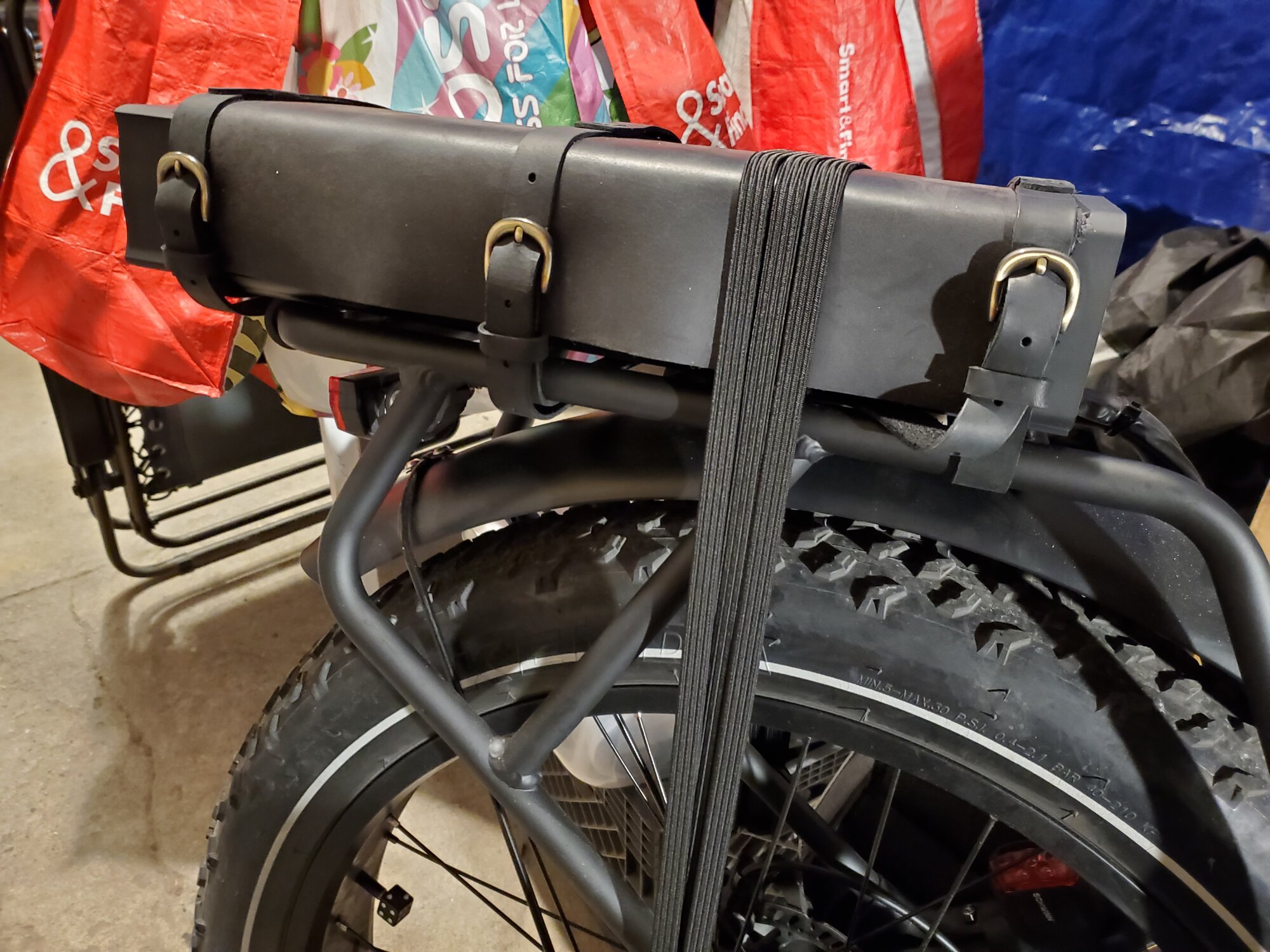

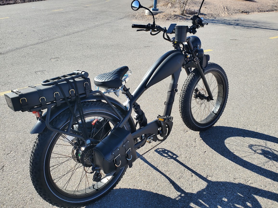

I experienced the same problem with my Cheetah, so I added a 48v/20ah rear rack battery and connected them all to a fusion datex battery combiner and its been working great for months.Cable management, to keep the bike looking "clean", is the hardest part. I am 6'1 235lbs and I consistently get 40+ miles on the highest PAS level and still have 2-3 bars left.
