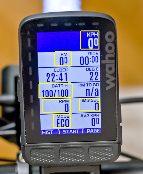

It could be a Wahoo ELEMNT as well. Unlike Garmin Edge, Wahoo ELEMNT can report the status of not only the main SL battery but also of the Range Extender.
You would need a Wahoo mount though.
