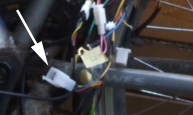

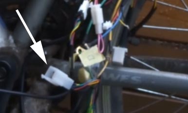

The KT controller and LCD8H are compatible. The wire colors on the display connector should match exactly. In your picture, you have the jumper plug in the display connector. I assume you took that out and plugged the display in its place?
Hello Harry, I have been plugging the display into a different connector and had made an adapter specially for it because I thought the connector was wrong. I will try plugging the display into the connector you mentioned tonight and see what happens.

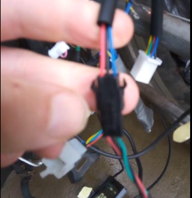

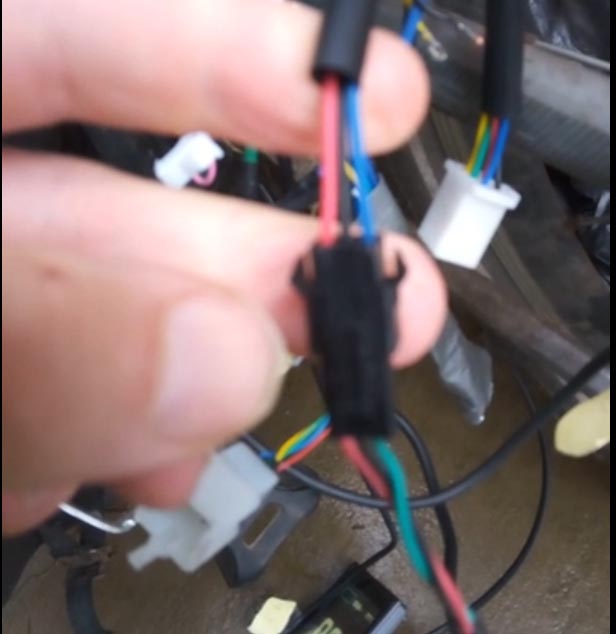

This is the Hall Sensor connector, a 2x3 plug. There will be five or six wires coming out of the motor that connect to it, matched by color. Looks like you have nothing going to it. Bike won't work unless it does. If you were to blip a properly connected throttle, with the Hall connector open like that, you would get an Error message about bad Hall sensor on a KT LCD display.
This is the throttle connector. If you had looked at your KT doc's, it would tell you it's the three pin plug with red. black, blue. The colors look right here, providing that the other end goes to your bike's throttle?
The KT doc's say Brown, Yellow, Black wires is the PAS. I cannot see the wire colors on your second video. Forget about connecting the PAS until you get the motor running via throttle or Walk mode. Also do not connect the brakes until you get the motor running. If the brakes are on, they will inhibit the motor.
