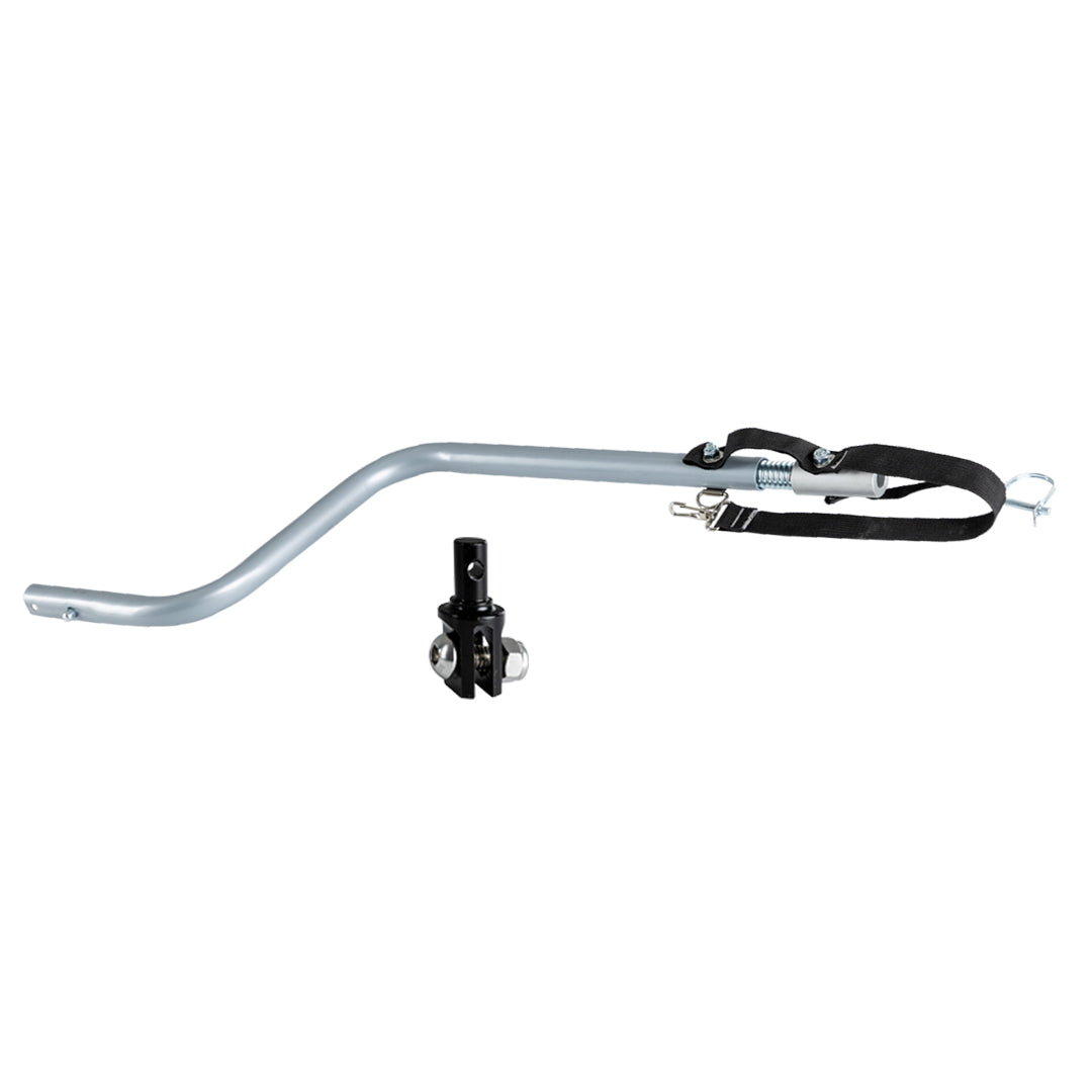

I'm trying to find a way to attach a pet/child trailer to a trike. Almost all of the trailers use the same arm and connection method to the left side of the bike's axle but with the trike this connection part needs to be mounted in the center of the bike. The only adapter I've come across is this:
The weld mod to the standard adapter part is fine but the method that they use to attach to the rear of the trike (hose clamps?) is kind of hokey.
Hrmm...I don't see how that would work. The arm on the trailer is only so long and connecting to the seat tube would be both too high and bring the trailer far to close to the rear of the trike to make any turn at all.
Thanks, I see what you're getting at. I have a trailer already and am just interested in the hitch adapter to the trike frame itself. Almost all pet/child trailers (Burley, PetSafe etc) use the same arm that attaches to the front left corner of the trailer and connection adapter to the left side of the axle but to make this work that adapter has to connect in some way to the center area of the trike.

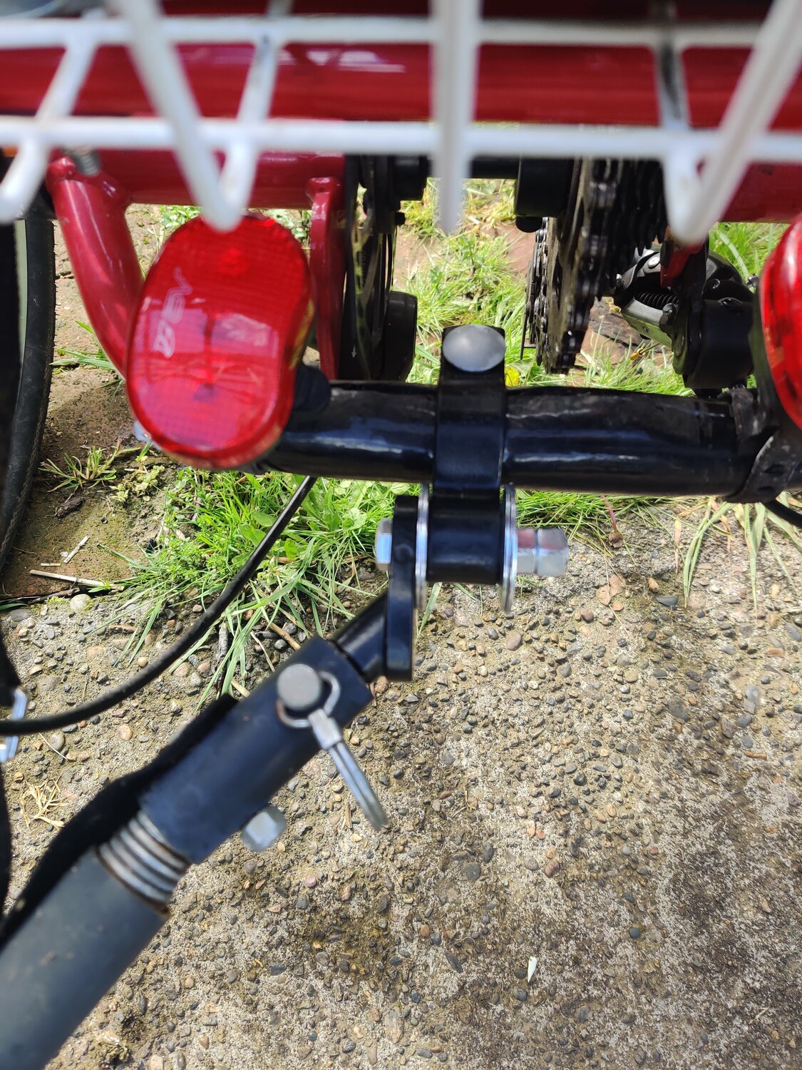

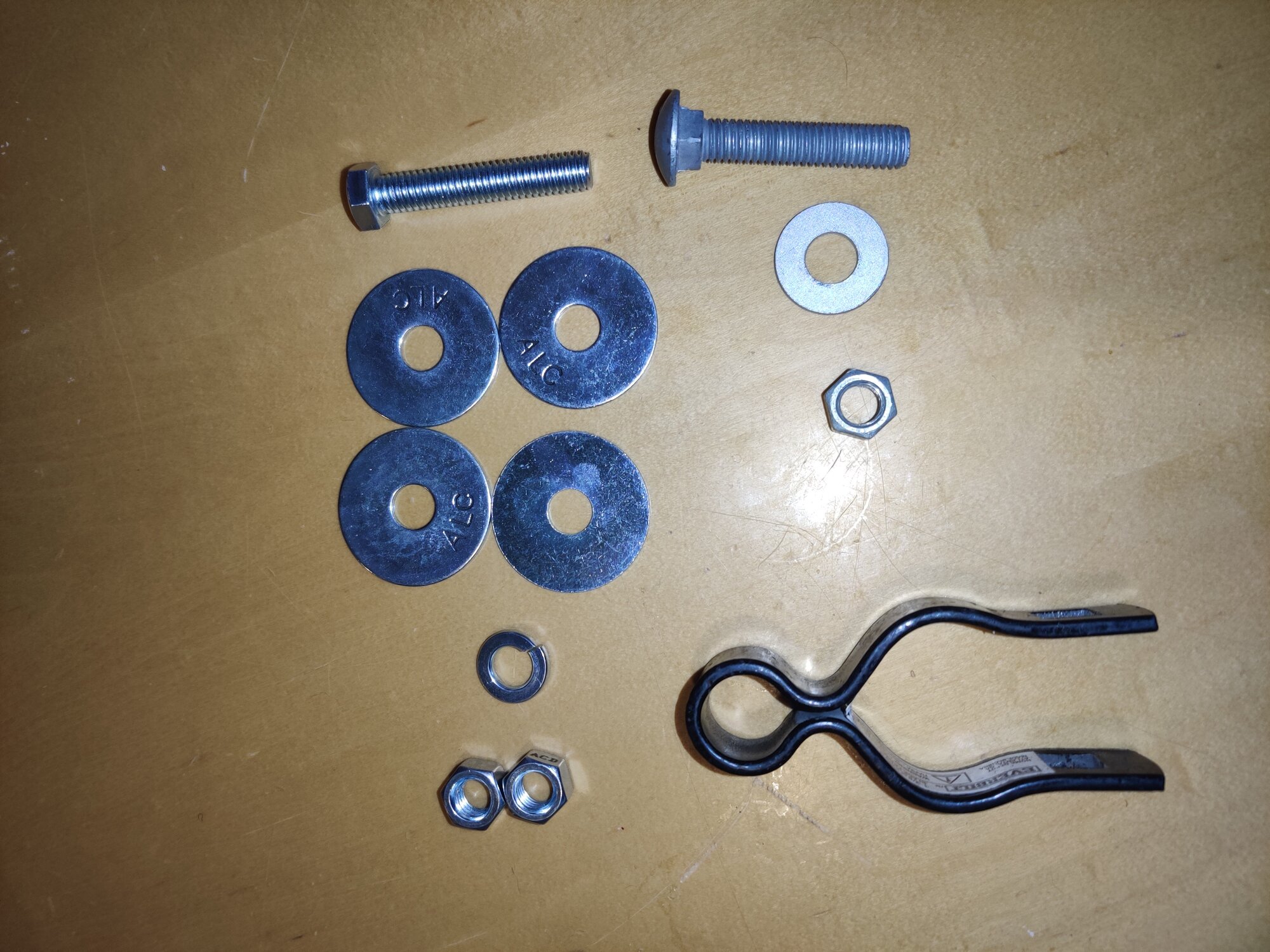

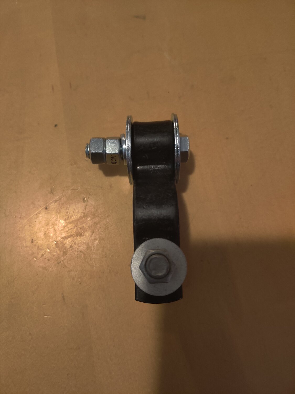

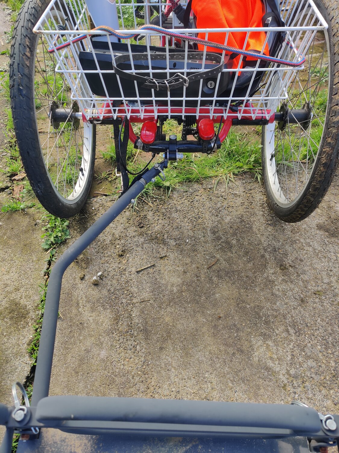

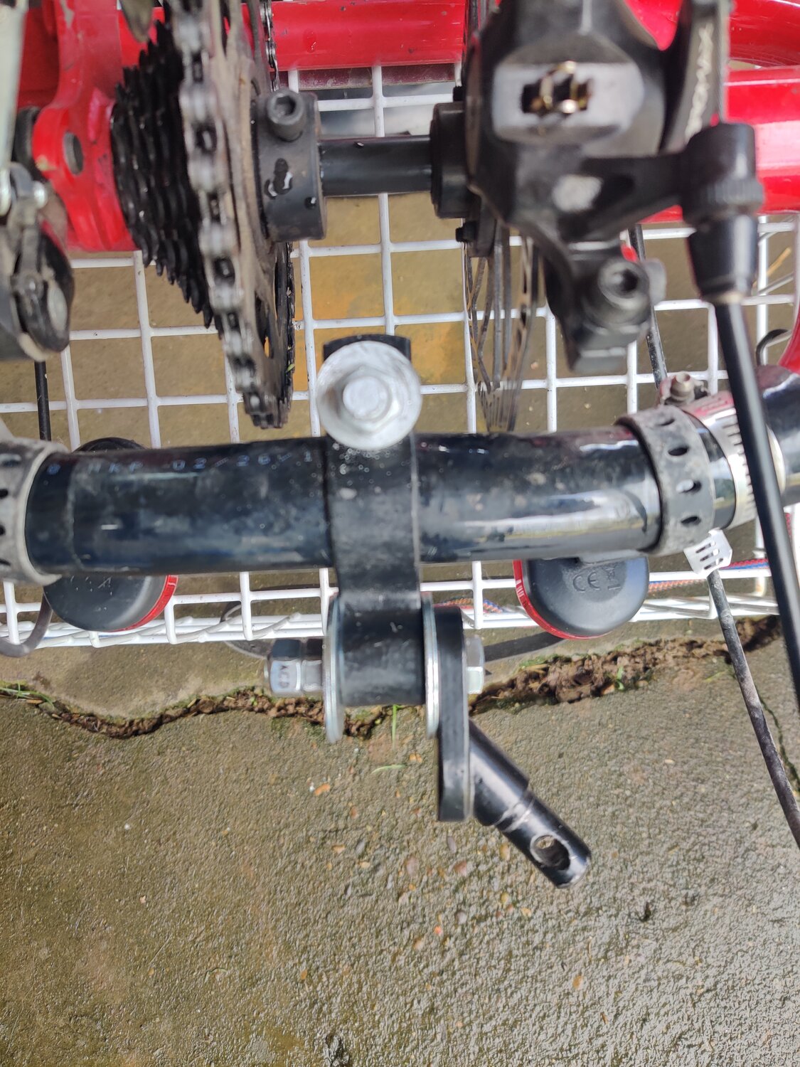

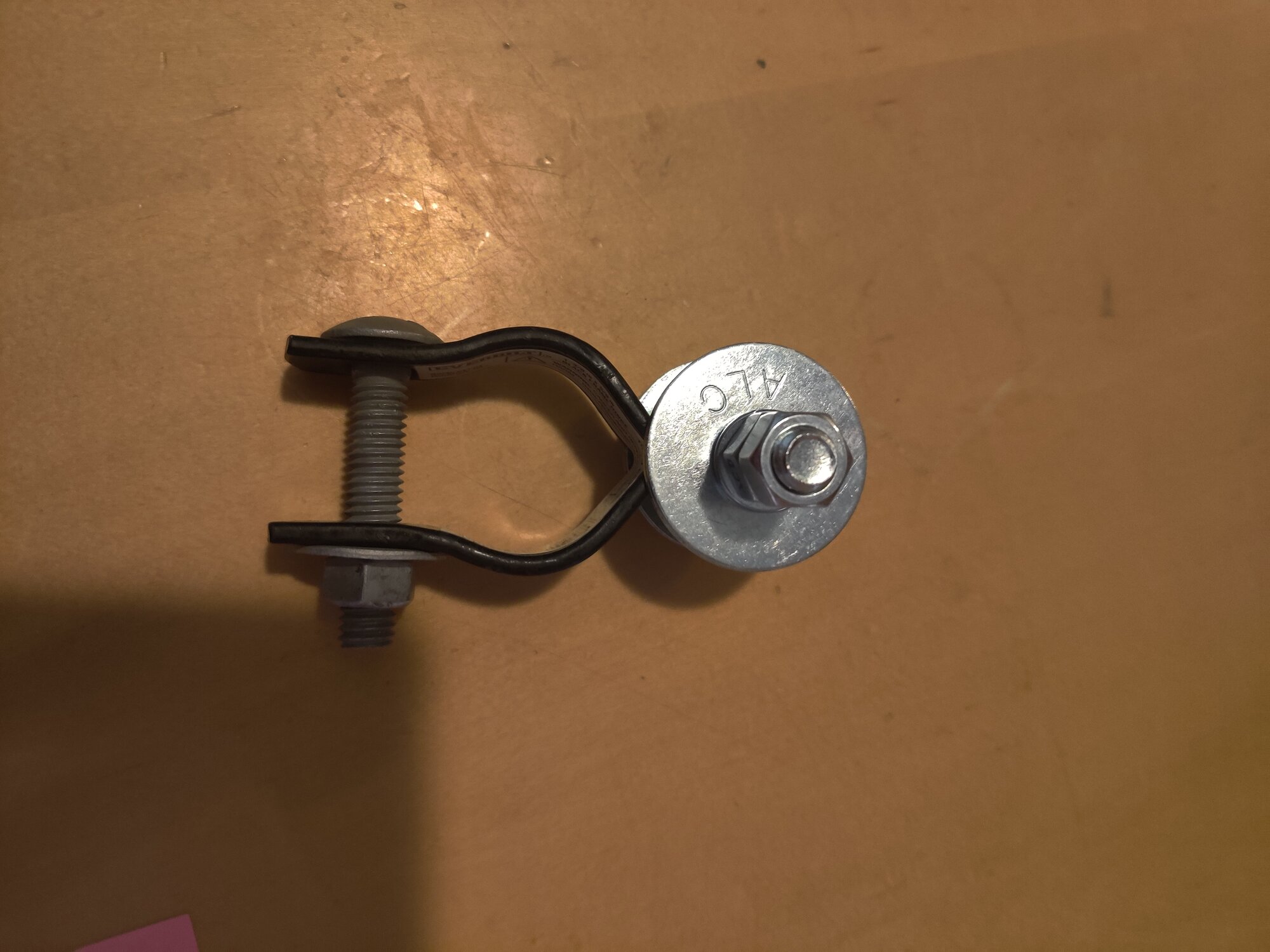

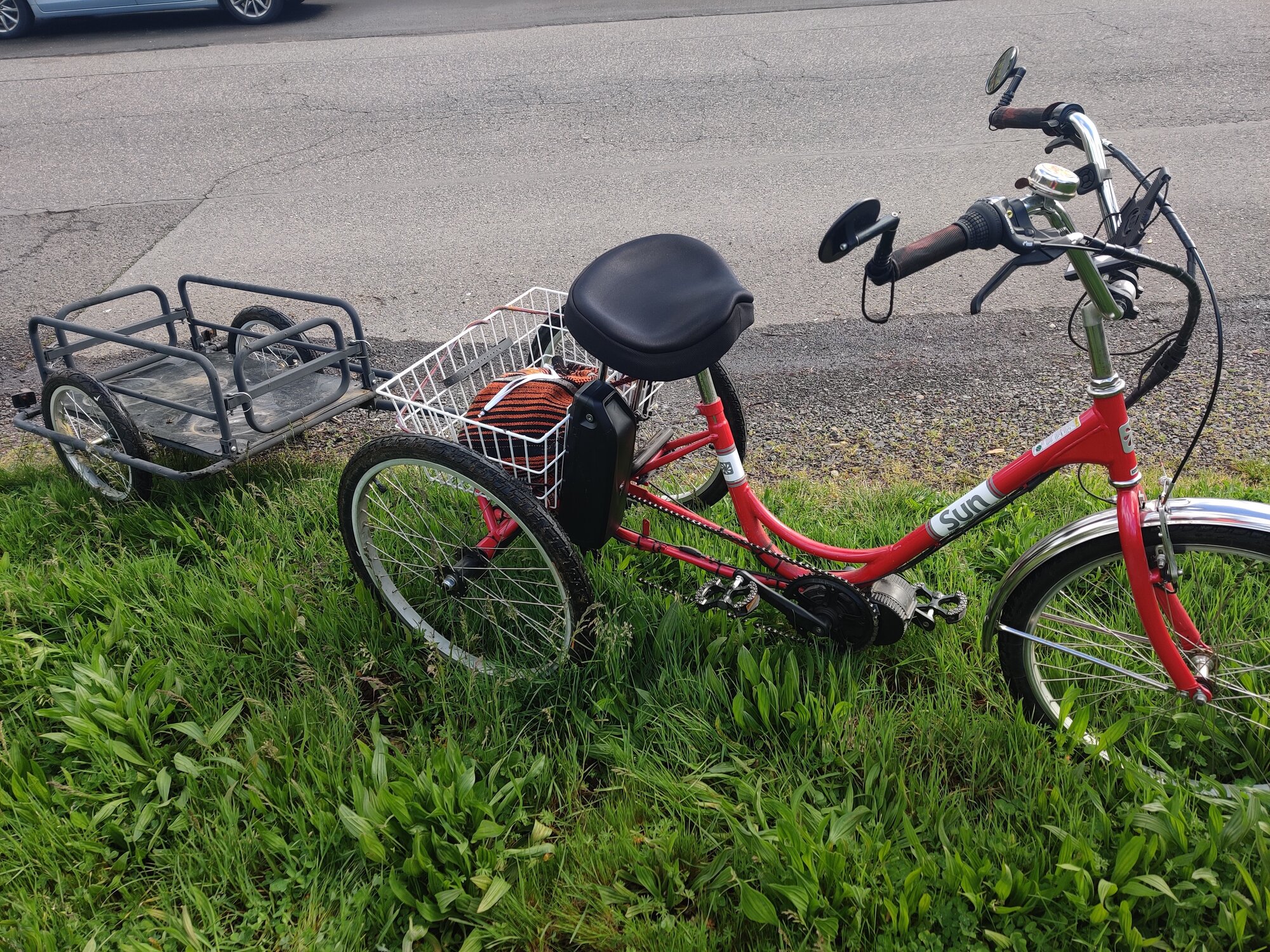

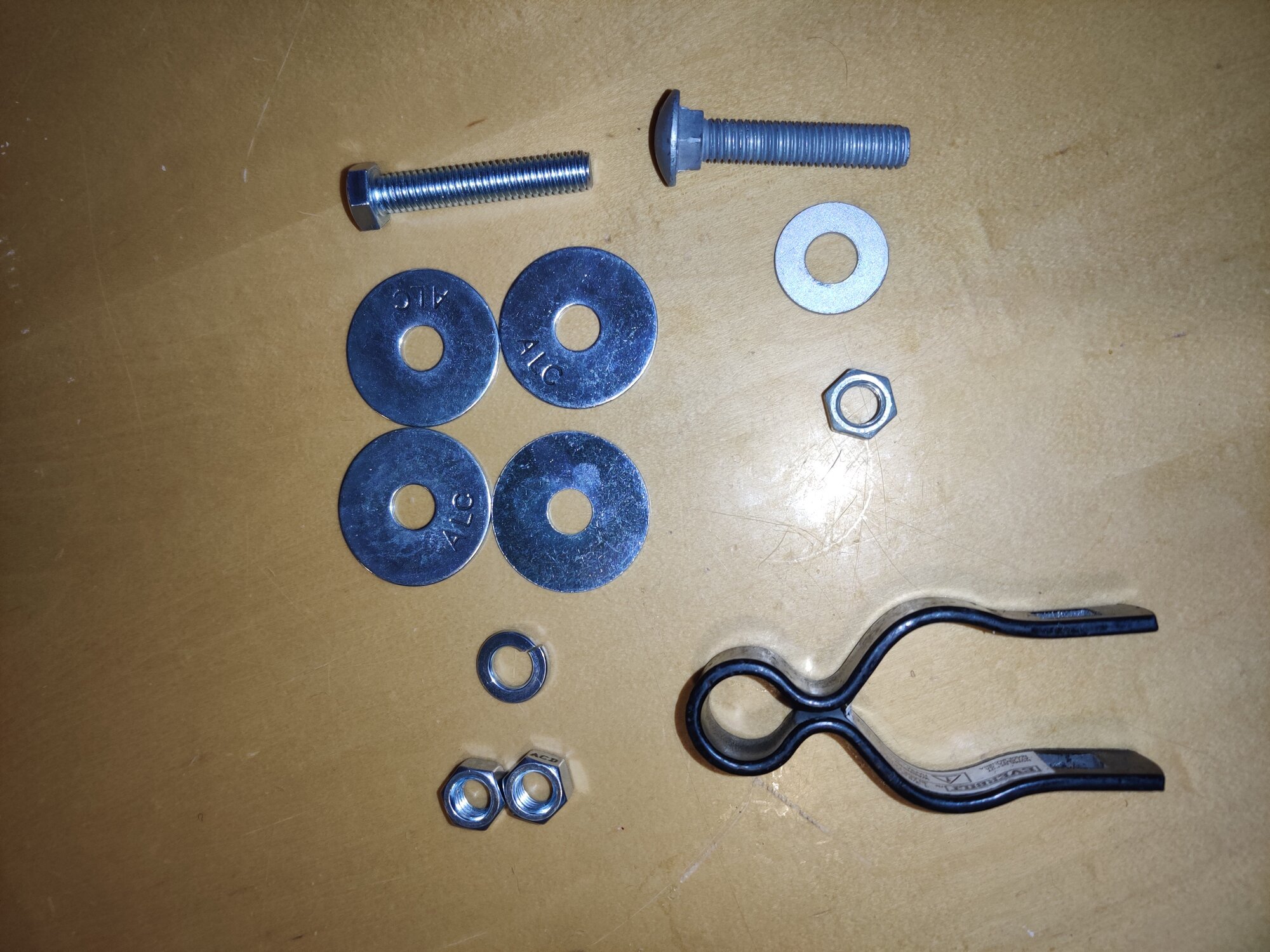

I started looking for a hitch or coupler to add a bike trailer to my trike. All of the ones I found online looked like poor quality and were overpriced. Those also involved changing the adapter so I couldn't switch the trailer easily from my trike to Jenna's bike and back. I came across this thread and got the idea to make one. I figured I would share this in case anyone else needs to make something similar.
With a vague idea and some measurements, off to Home Depot I went. I already had a piece of hose as a base around my lower center bar so I didn't need a new one but if you don't then get one. I got:
1 1 - 3/8 in x 5/8 in Frame hinge from the fence department
4 3/8" x 1-1/2" Fender Washers
2 3/8" zinc hex nuts (I used 2 to reduce them vibrating off)
1 3/8" zinc lock washer (This goes between the bolt and the coupler that comes with the trailer)
1 3/8" x 2" zinc hex bolt
1 3/8" galvanized hex nut
1 3/8" x 2" galvanized bolt
1 3/8" galvanized flat washer
I used the lock washer on to out against the bolt side that you put the hitch coupler on. You may ask, "Why didn't you get galvanized for all of the bolts, nuts, and washers?". Well, that is because the fender washers of the size I needed only came in zinc, the gremlin in my brain didn't like the way they looked with the galvanized bolts on that side. My total was $7.67 (would have been another $4.14 if I didn't already have the hose).

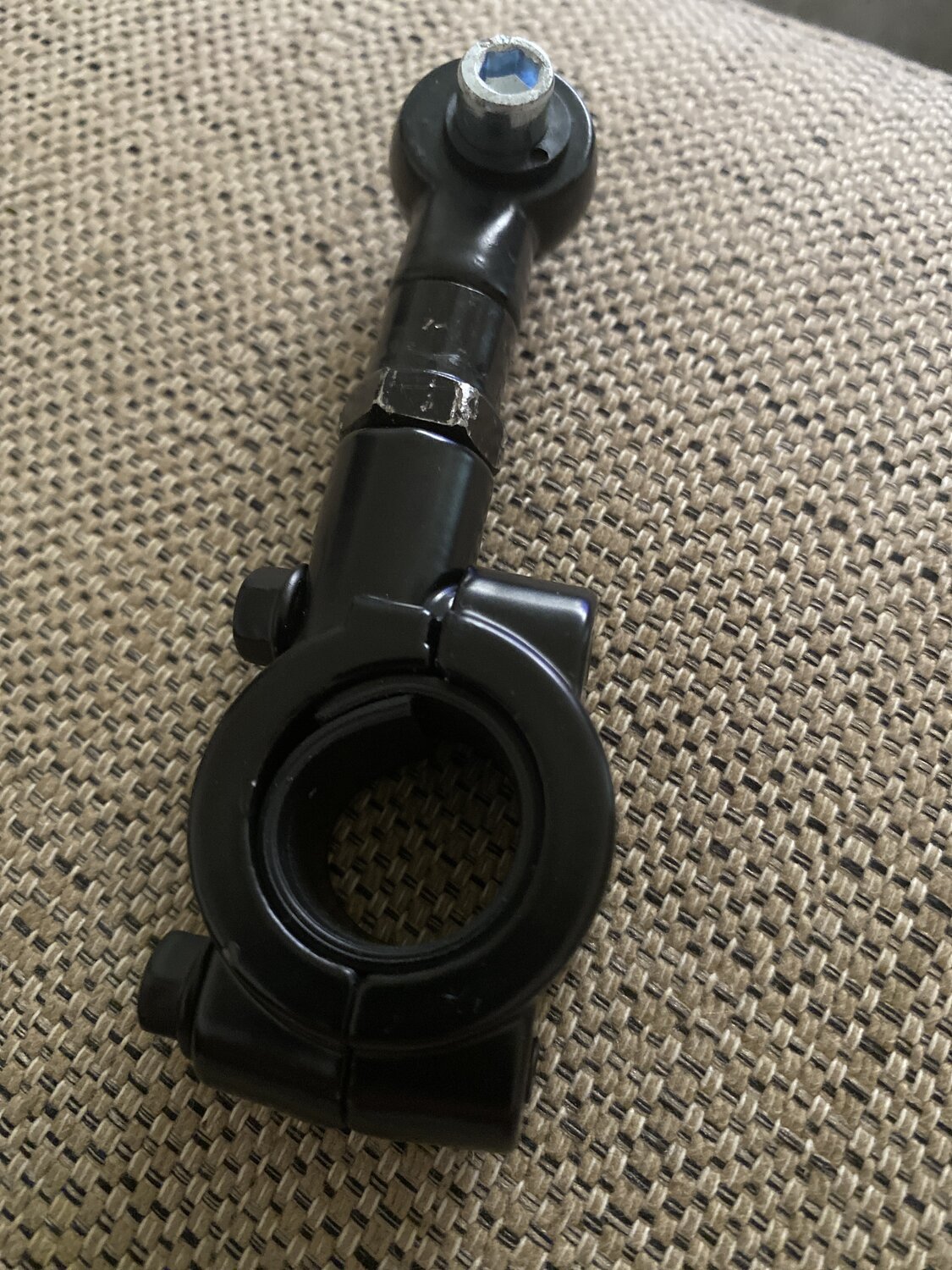

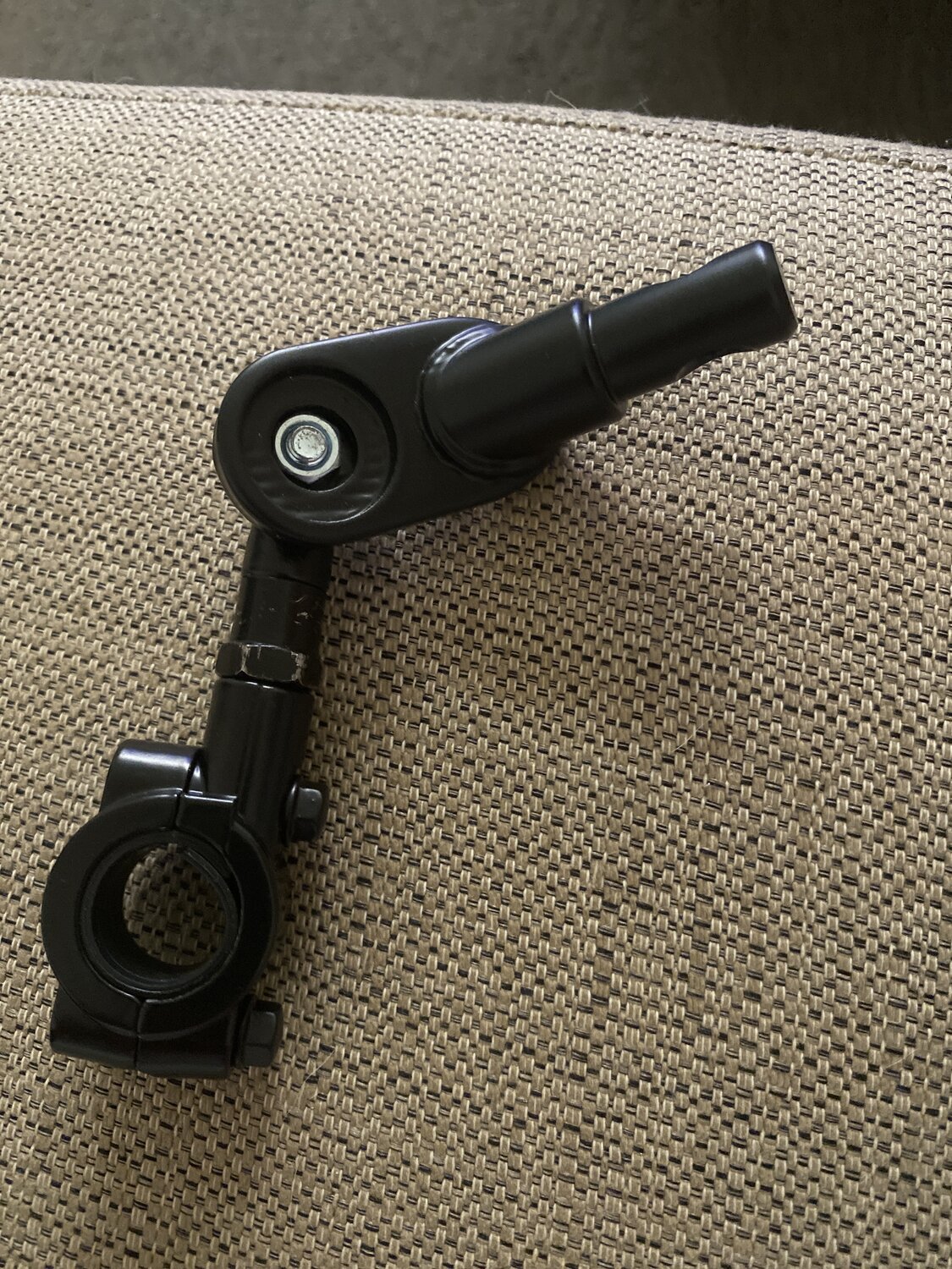

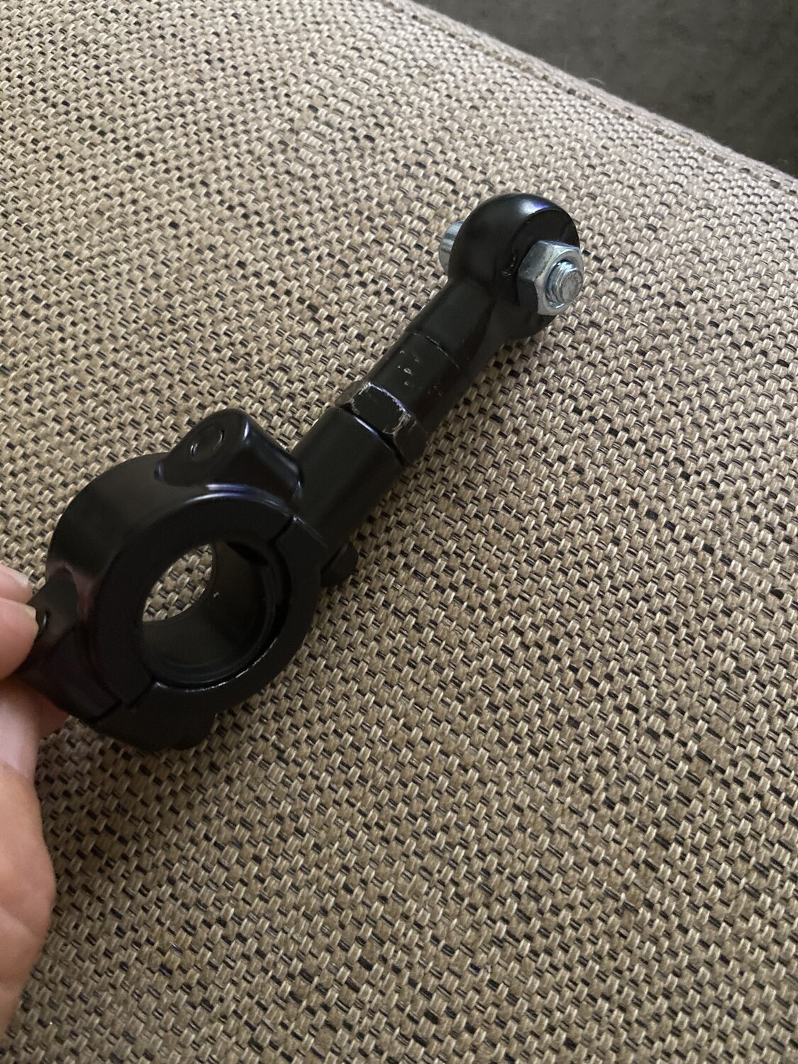

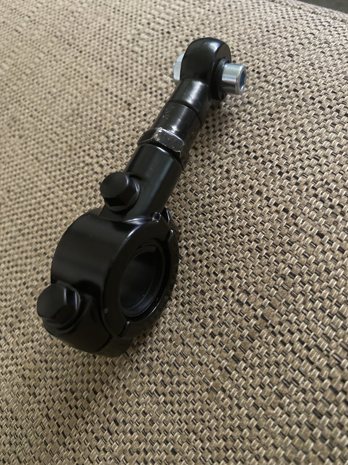

I just found an old mirror holder in my stuff and this looks like it may work with longer screws. My issue was that my battery is mounted underneath my trike so hopefully this will solve the issue of the hitch being in the way of my battery. I’ll upload pics once I work it out but here is one of the mirror mount I intend to use. Just need to figure out which way and which bike bar to attach it to solve the problem.

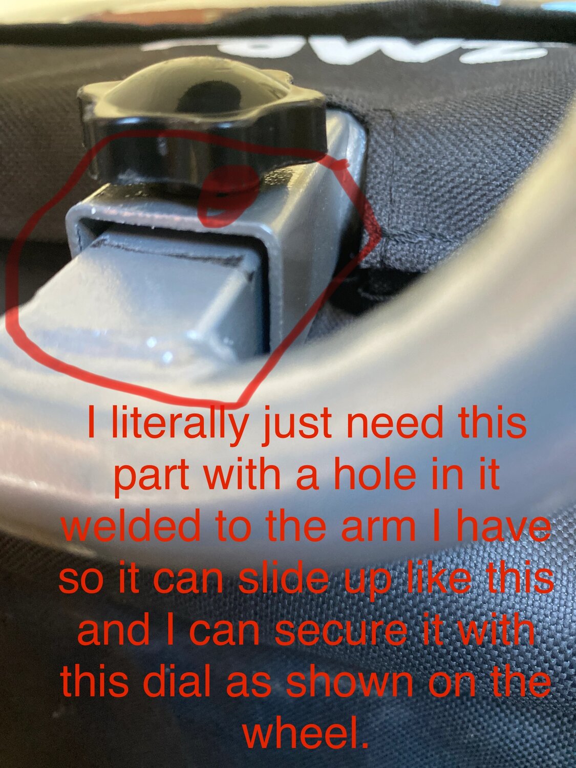

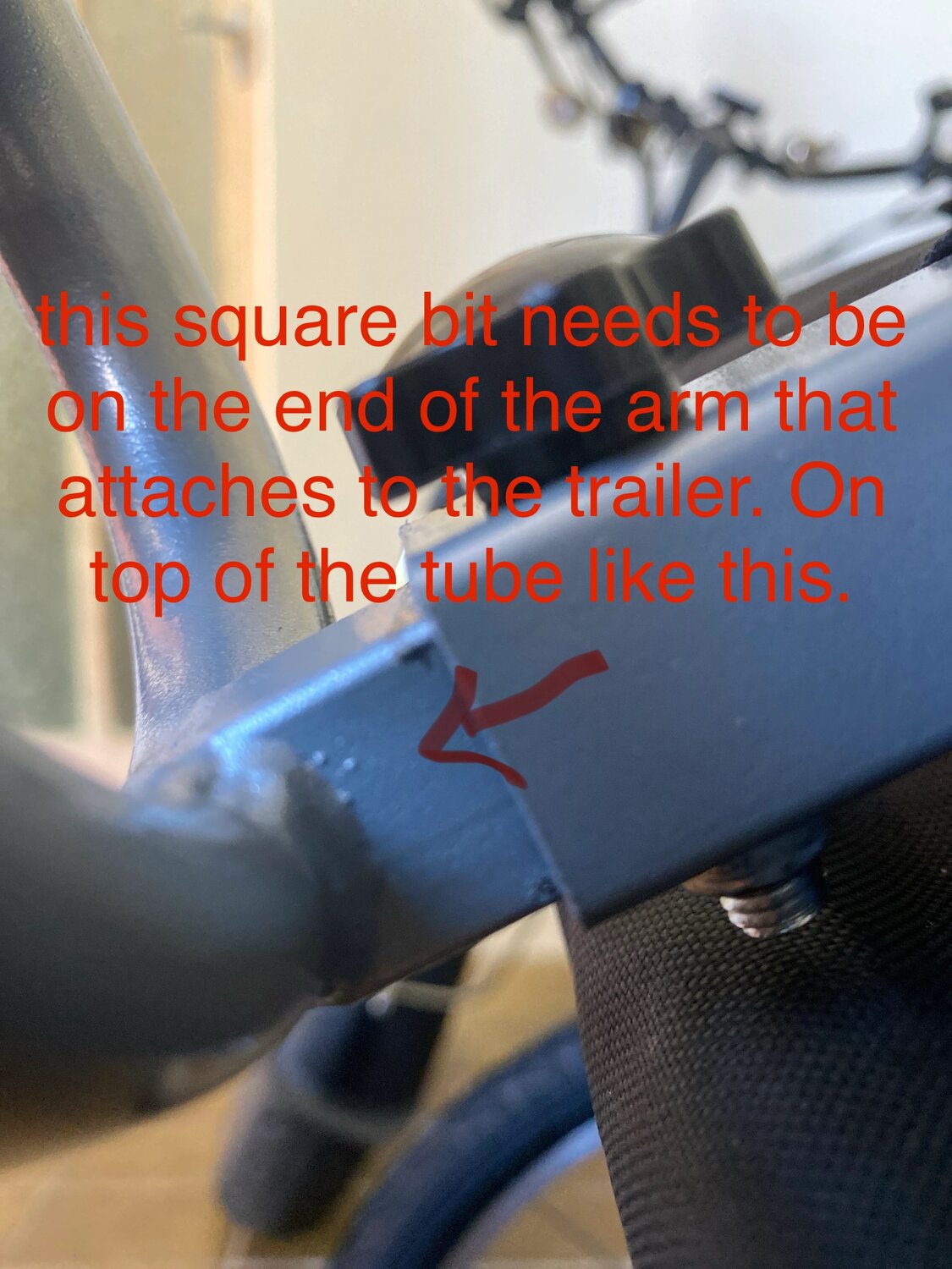

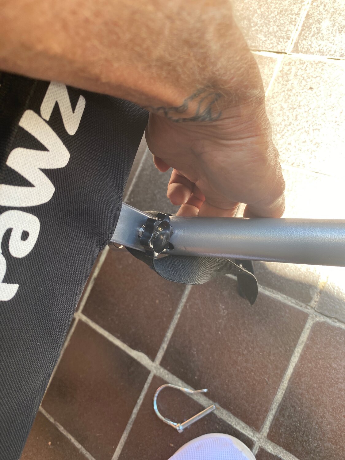

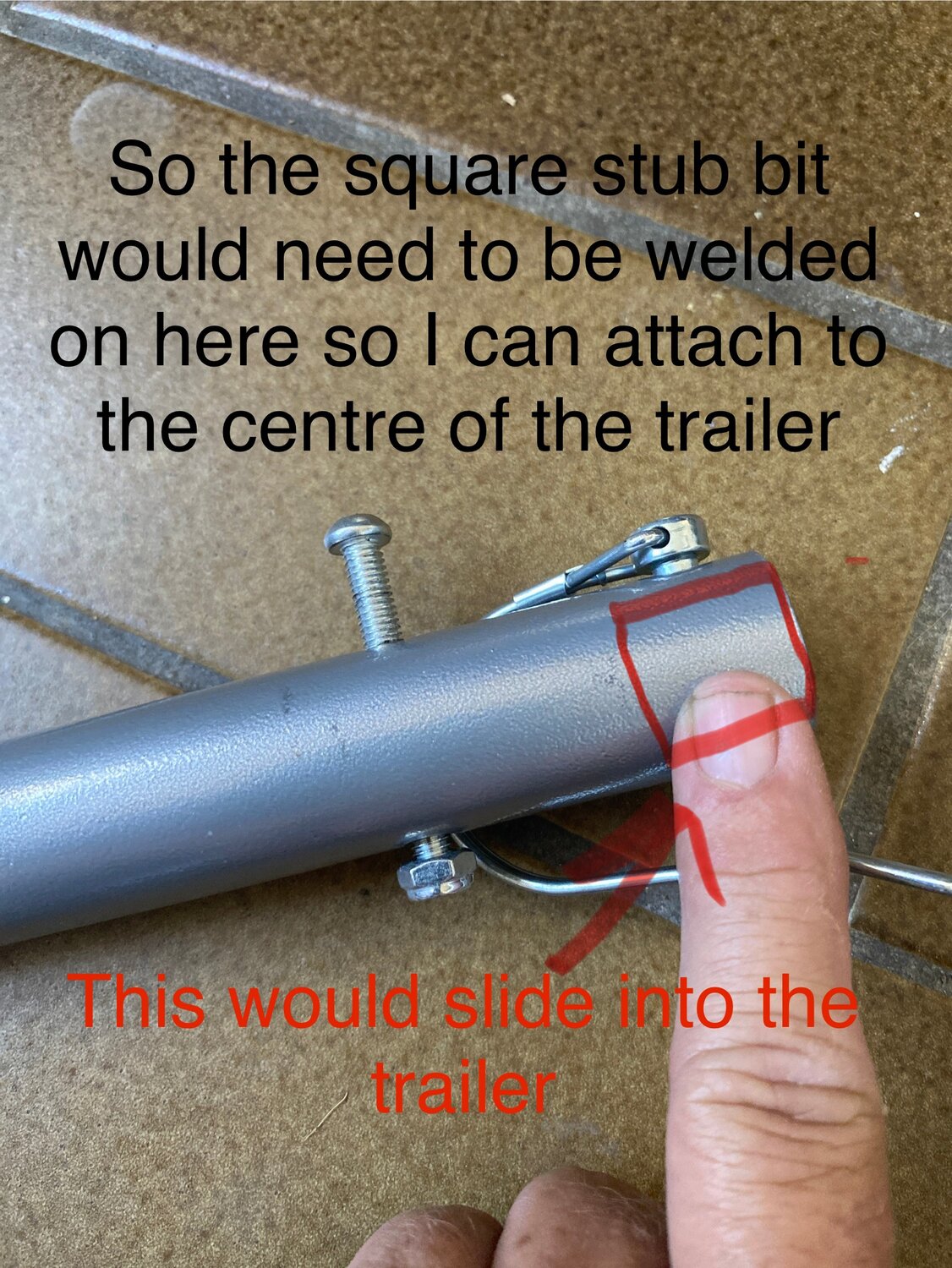

Now I’m not sure if I can use the original arm or should I try to find a straight arm to attach the trailer to the trike? Not sure how the turning would go with either. Any help would be appreciated.

Hey R1CK, thank you for the detailed design and photos. I’m a first time poster here and needed a way to be able to haul my mower as I have a small lawn care business (laughs). I take care of 3 older folks yards for them. I’m also vision impaired and not able to drive, so this meant I had to drag my wife who also has issues out from yard to yard when I have to go mow. Thanks to your ingenuity I’m saving myself a lot of headaches lol. I run a Denago ETrike 1. Instead of the tubing I ended up using recycled tube from a popped tire of mine and that worked very well. I’m still fine tuning it to get it far enough over where it doesn’t rub the left tire but last night was first hookup.
Thanks again for your help on this and yes I know the “safety strap is hanging I was just “mocking it up”.
