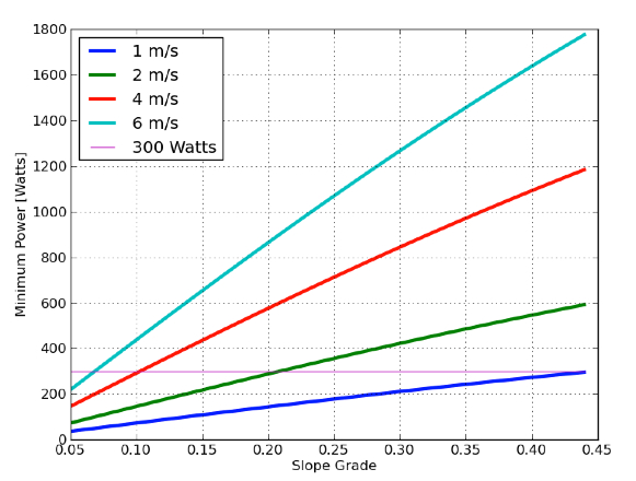

For a bicyclist without a motor, the answer is:

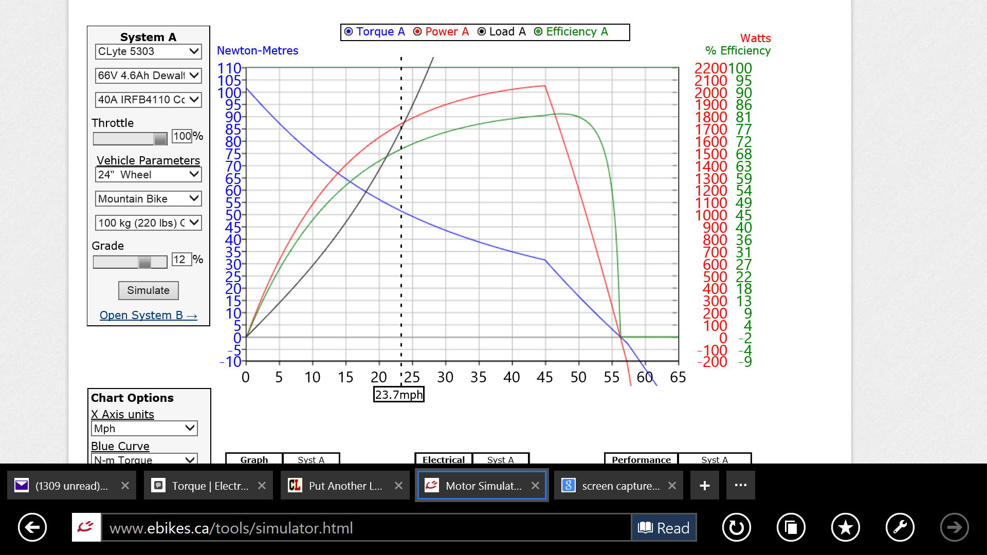

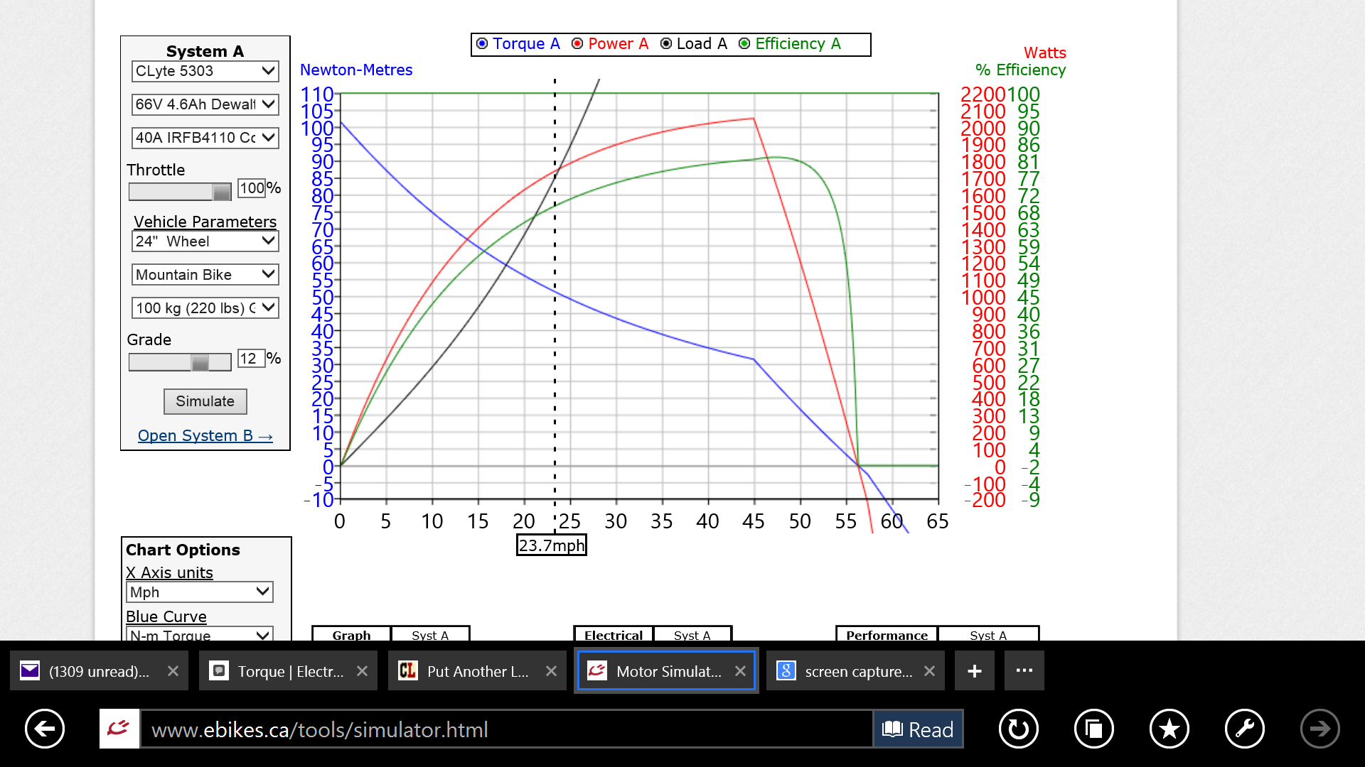

Once the Stealth Fighter gets moving, it will do just fine at 2500W. The other part of the torque equation is how it relates to power: Power=Torque x rotational speed (w).
Starting at 0 mph, the power is zero, even if at max current and peak torque. The power is lost as heat in the motor.
As the wheel rotates, w increases, torque decreases at the same power, but you are gaining speed.etc.
Stealth use to use the Crystalyte 5303 hub. Here is a simulation up to 2100W. It will maintain a speed of 21.7mph on a 12% grade.
