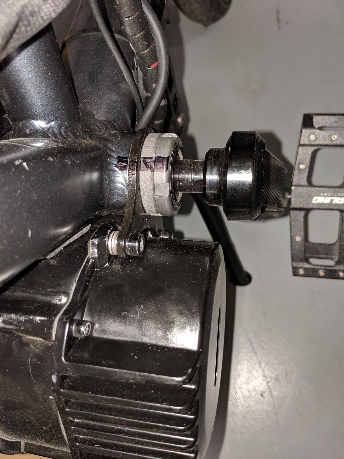

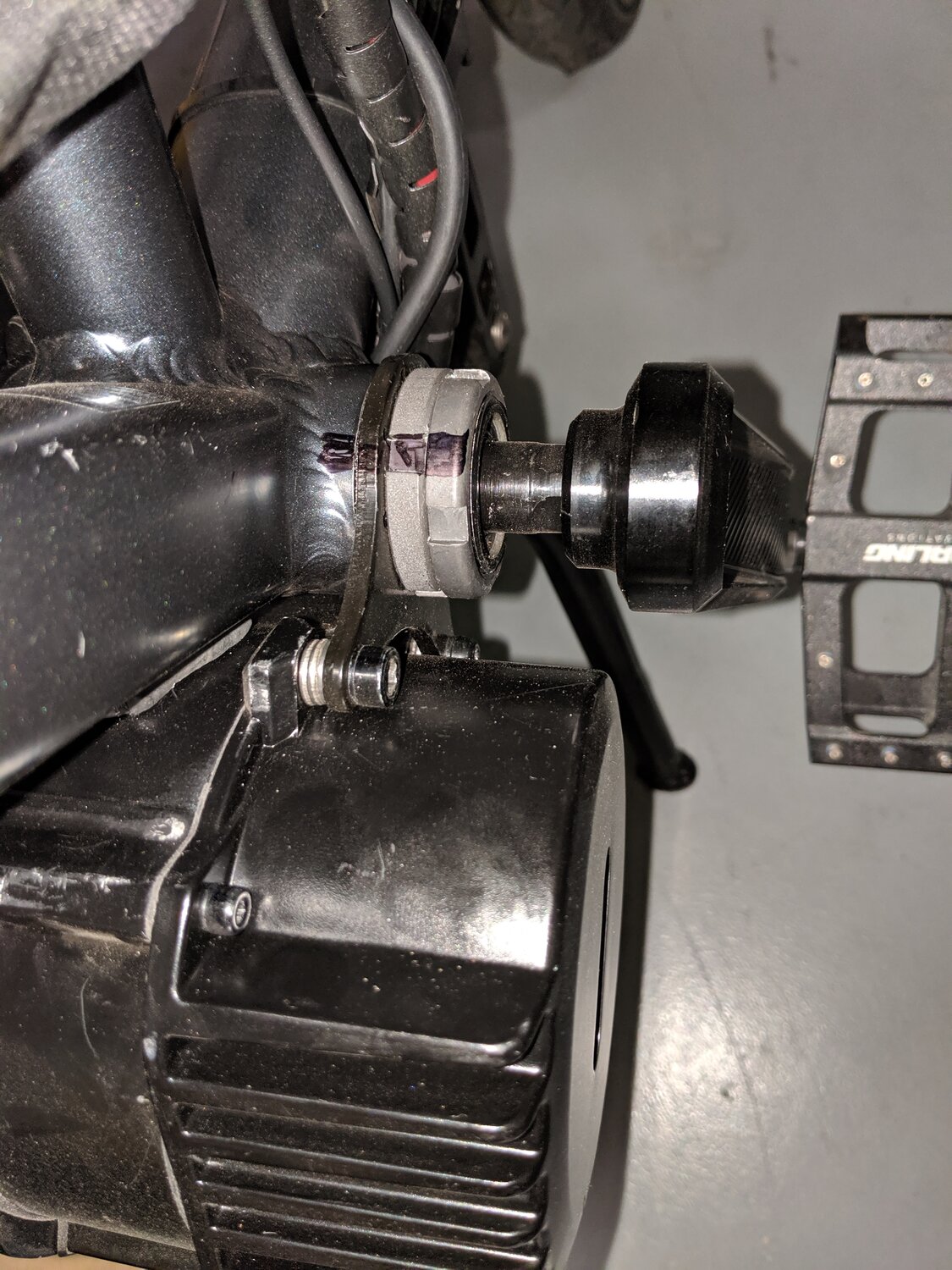

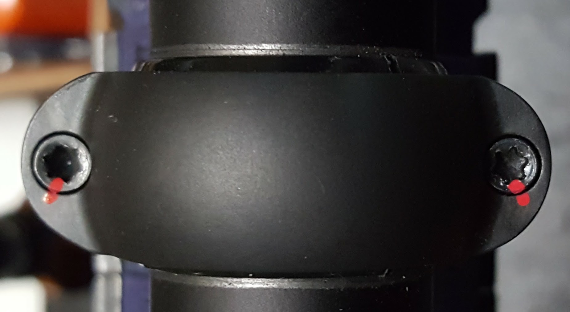

Another trick preferable to thread locker: Use registration marks. The first pic shows a big fat sharpie covering the two rings plus the bottom bracket of a BBSHD install. Its meant to be seen from a standing glance down so I made it obvious. In the second picture I used a thin red oil pencil from Amazon on much smaller parts (the pencil'd rings show if the tube is shifting back/forth).
Do marks like this and all you have to do is glance at them to see if they can be left alone.
View attachment 85822View attachment 85824
