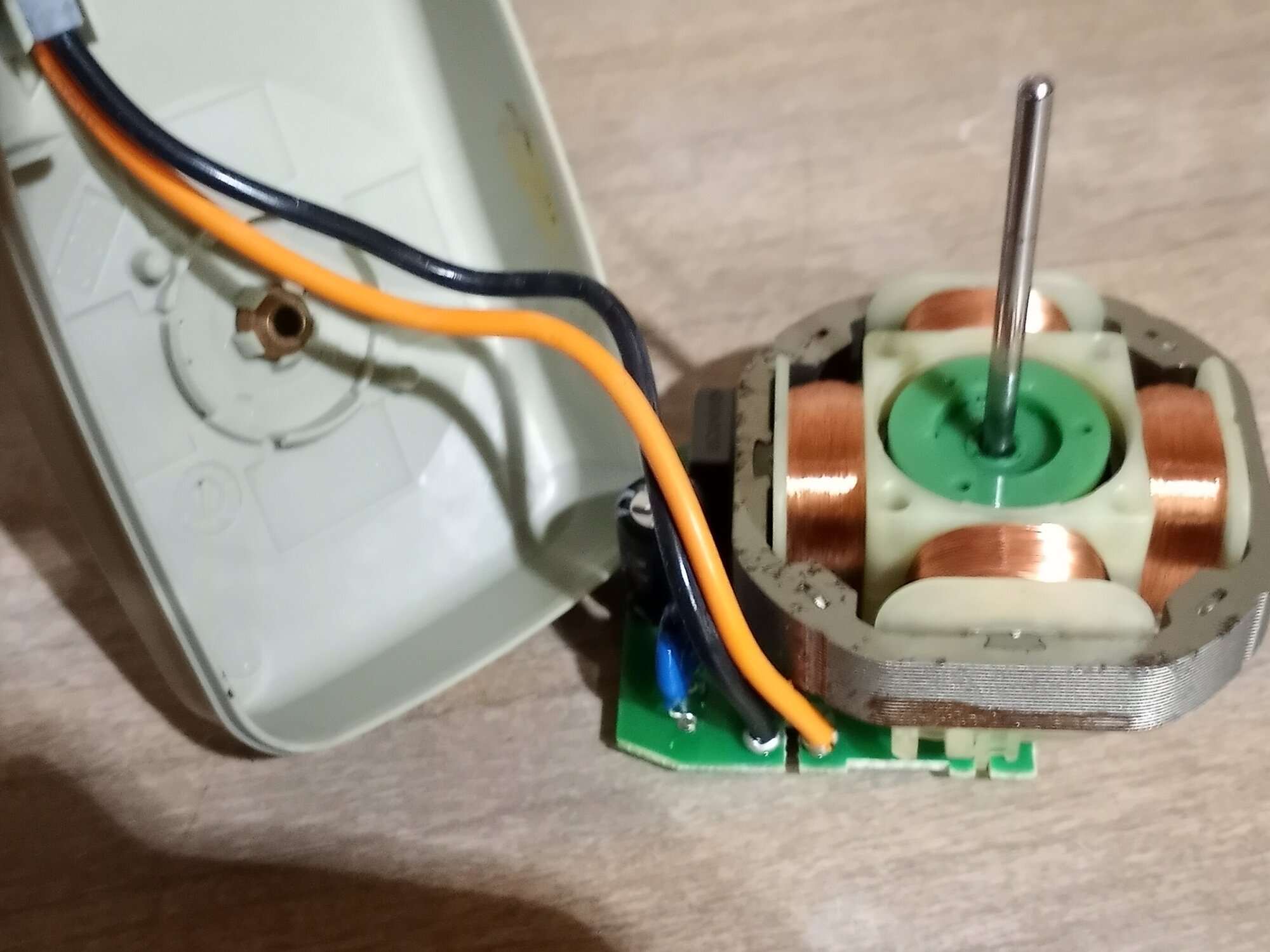

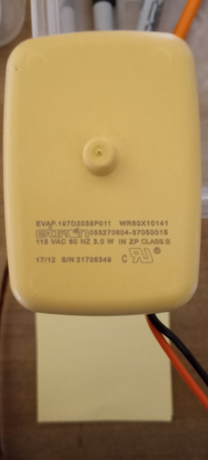

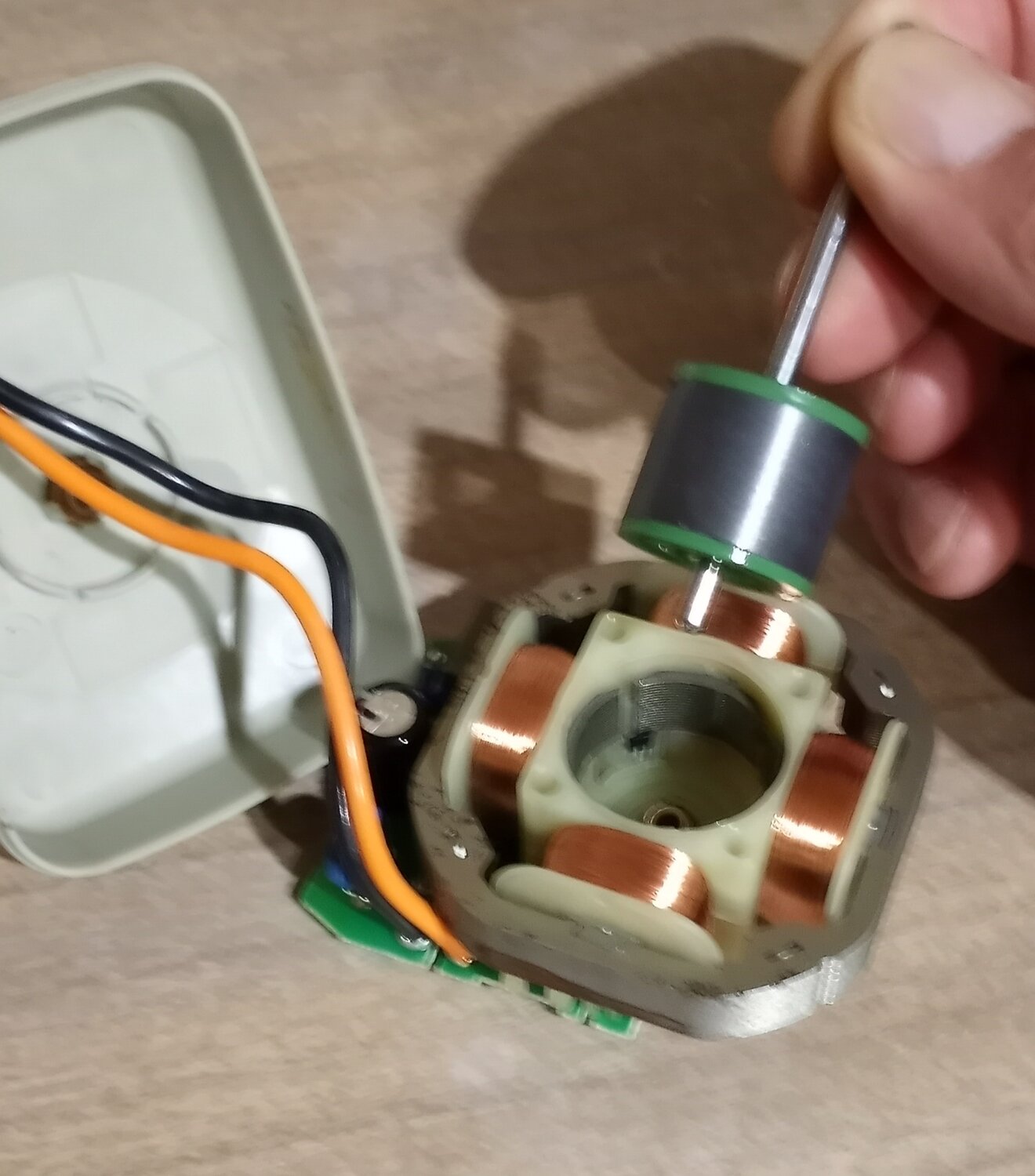

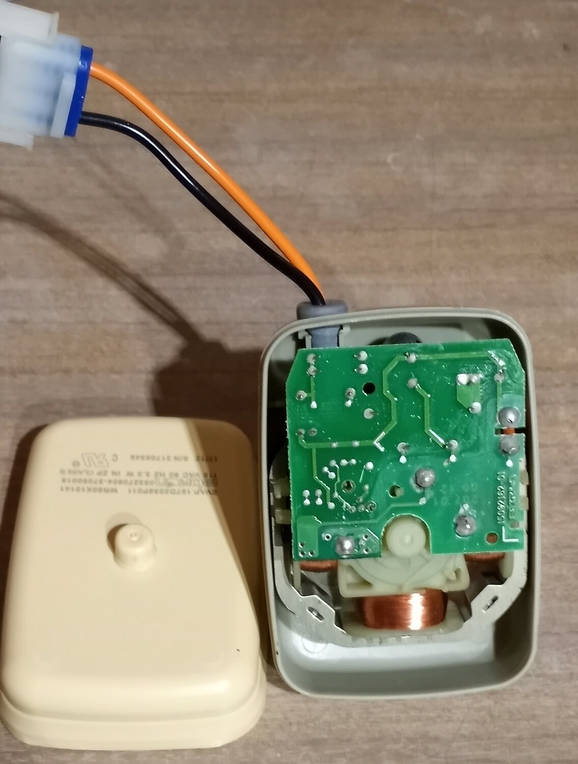

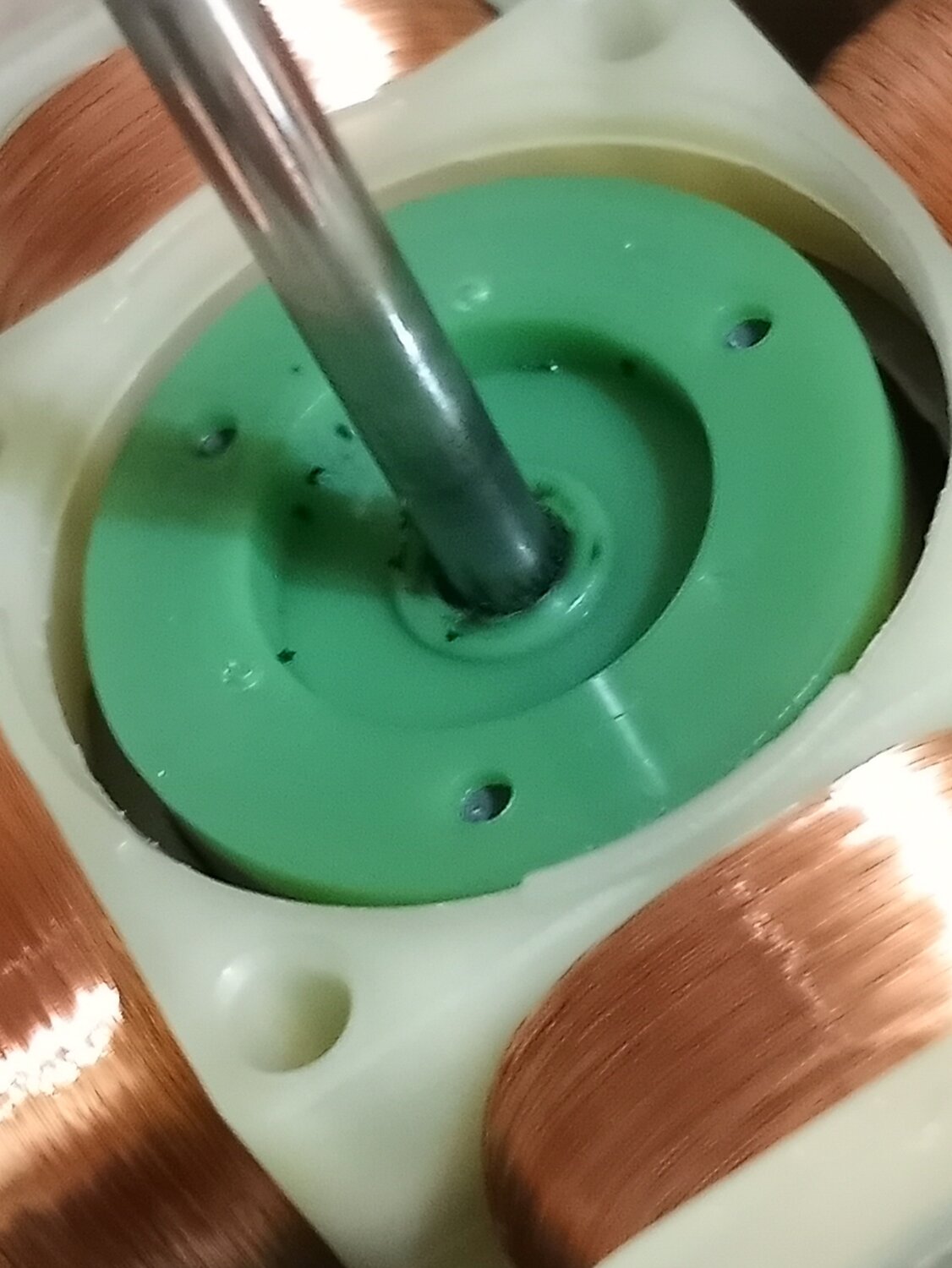

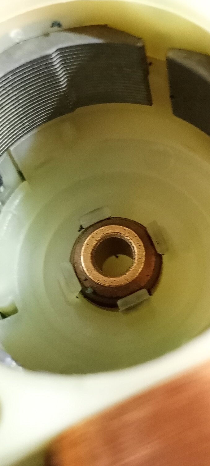

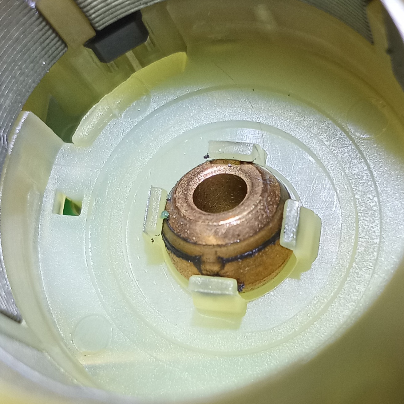

On a related note, I fixed my noisy fridge fan motor,..

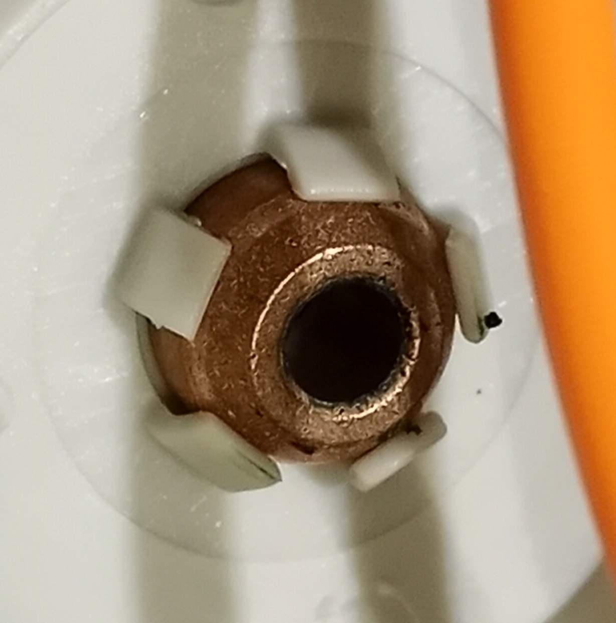

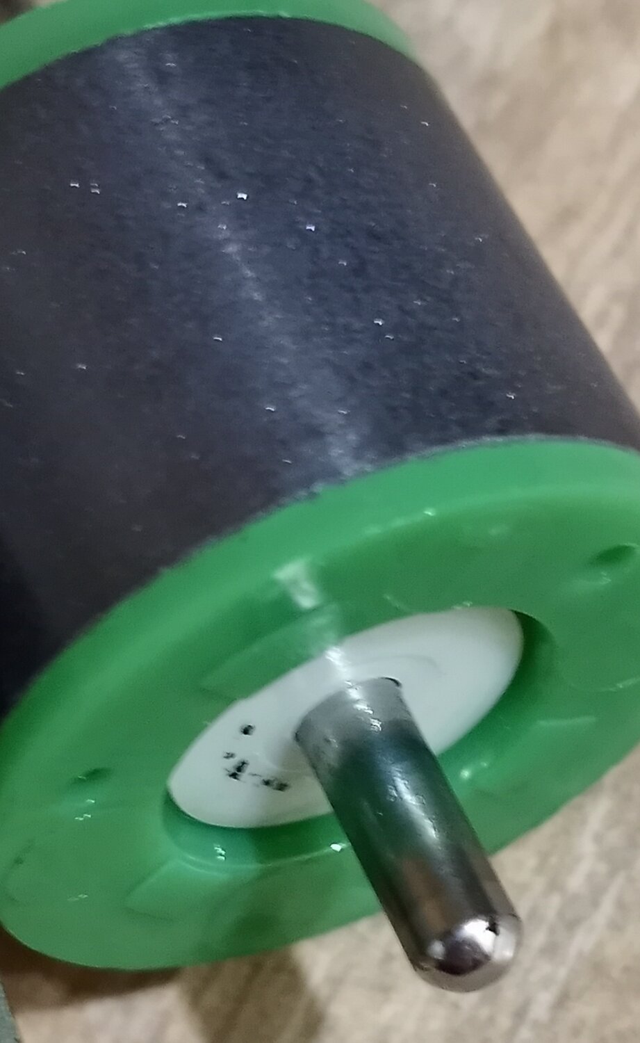

It turned out that the felt feeding oil to the sintered metal bushing had dried out, then the axle seized in the bushing and the bushing started to spin.
I polished the blue glazing off the axle shaft, reoiled the felt and got it going again,..
I was too nervous to attempt to fix it for fear of breaking something and all my food would rot while I waited for a new motor to arrive, so I bought and installed a new motor first. Now I have a spare for next time.
Most people buy a new fridge when it stops working.
The new motor was ~$40
