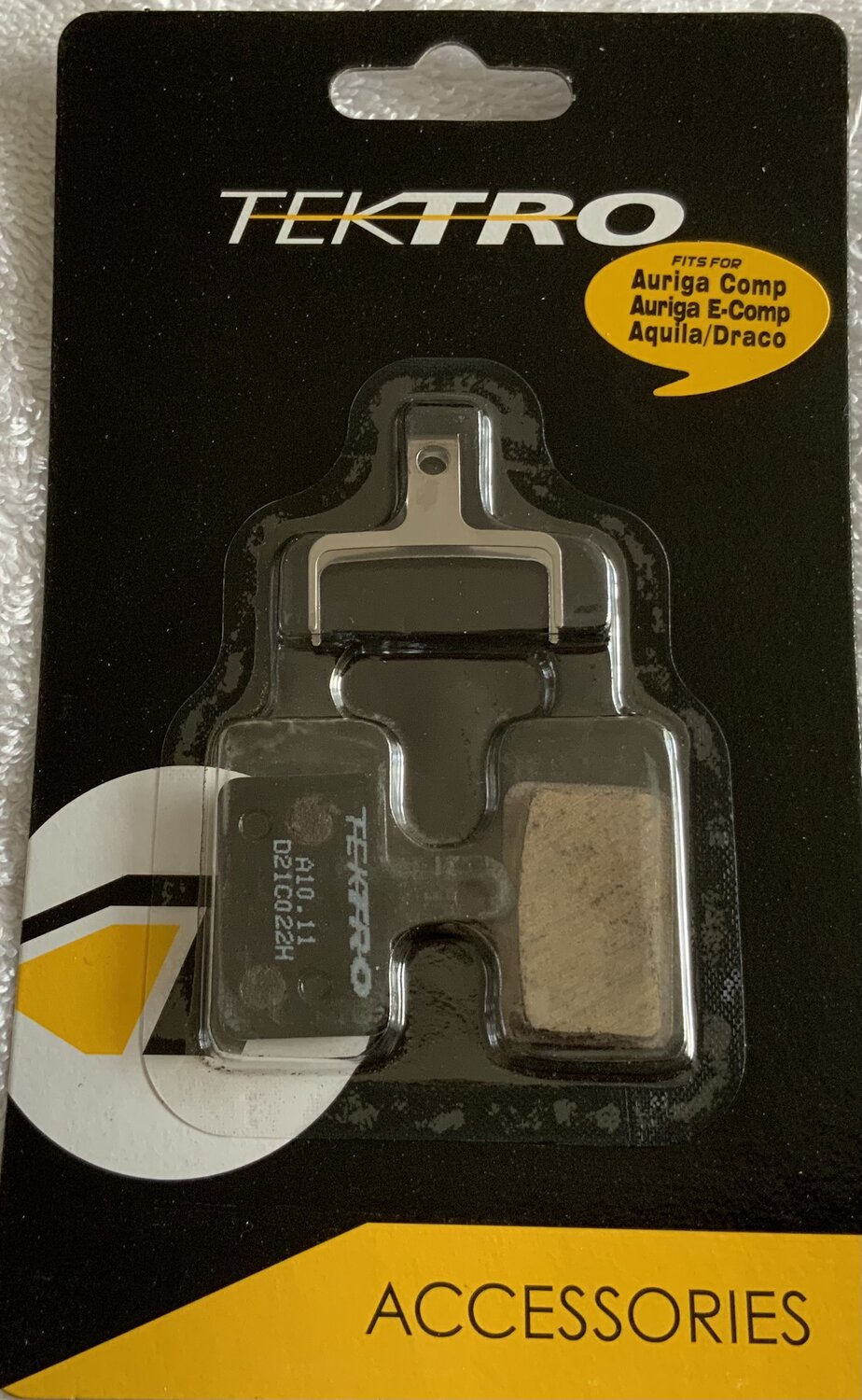

TektroA10-11, I didn’t know which ones to get as there was quite a big choice, are these the right ones?

Following your question, I have now loocked up which pads to get for the Tektro HD-R510 system on the Tektro website (wish I had done this beforehandand) and I now realise that I bought the wrong ones! The ones to go for a Tektro F10BS. There is also a very helpful video on the site for this particular pad, which shows how to change them and it does seem quite a simple process.

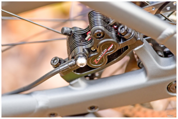

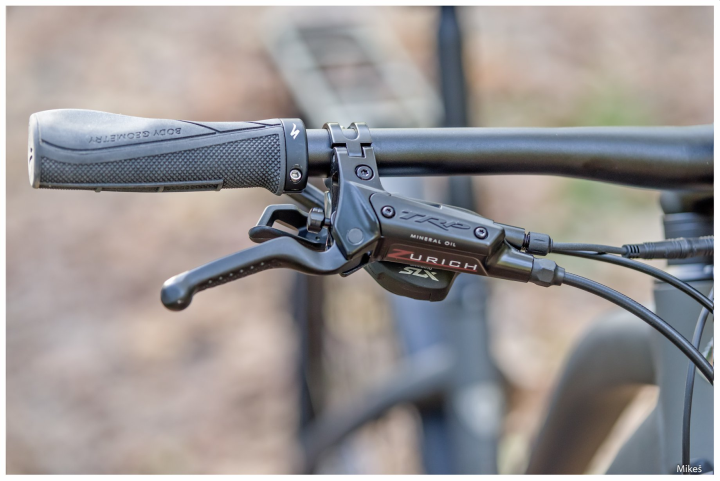

My Vado 6.0 is equipped with 4-piston 180-mm TRP Zurich brakes. These are e-bike specific, EU Type Approved brakes for 45 km/h e-bikes, and these brakes are equipped with a braking sensor for the STOP indicator tail-light. TRP stands for Tektro Racing Products, the high-end division of Tektro. TRP Zurich take Q20.11 brake pads.
TRP Zurich brake lever is equipped with a ball at its end, similarly to what is done to motorcycle brake levers.
The huge block of the TRP Zurich is made as a powerful radiator for quick heat release.
