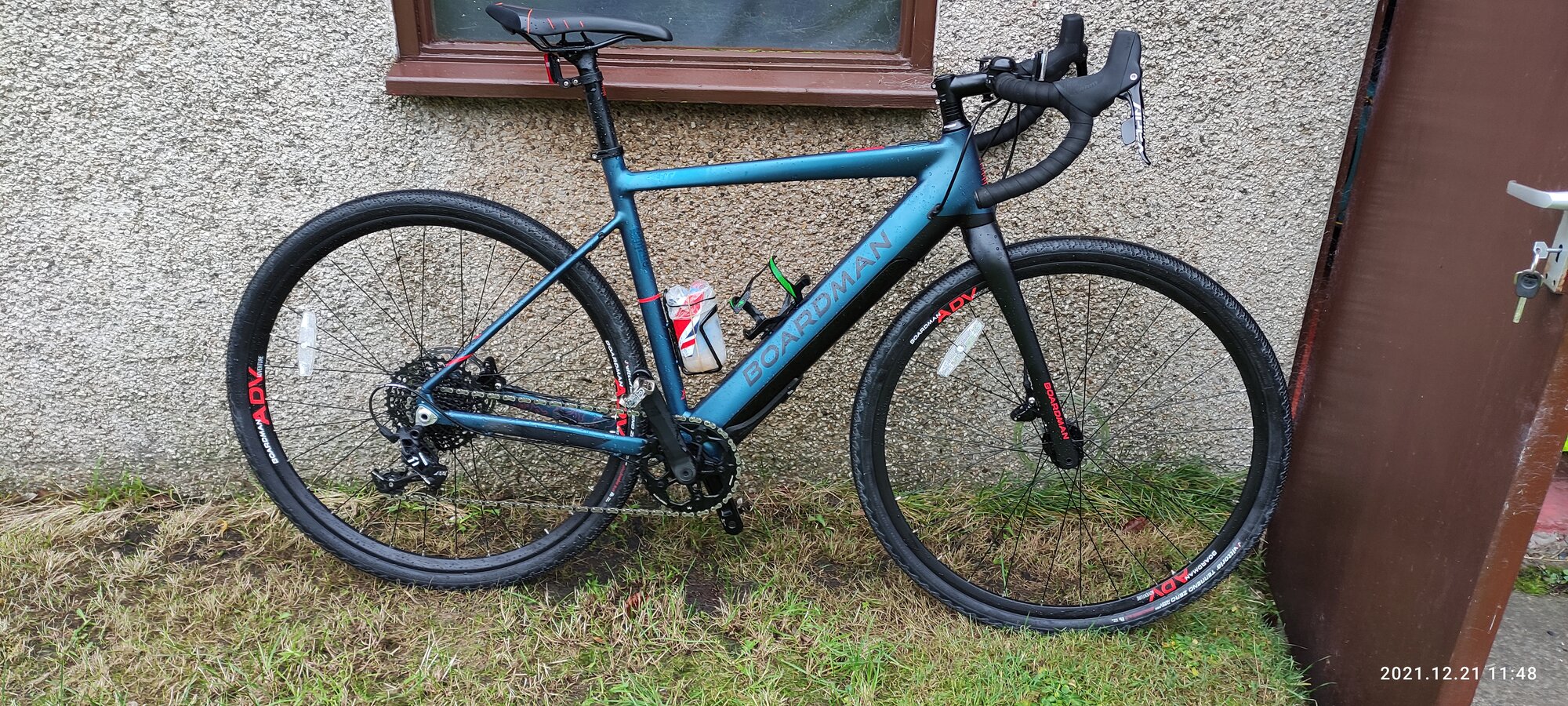

Just a pic, pre chainring change :D

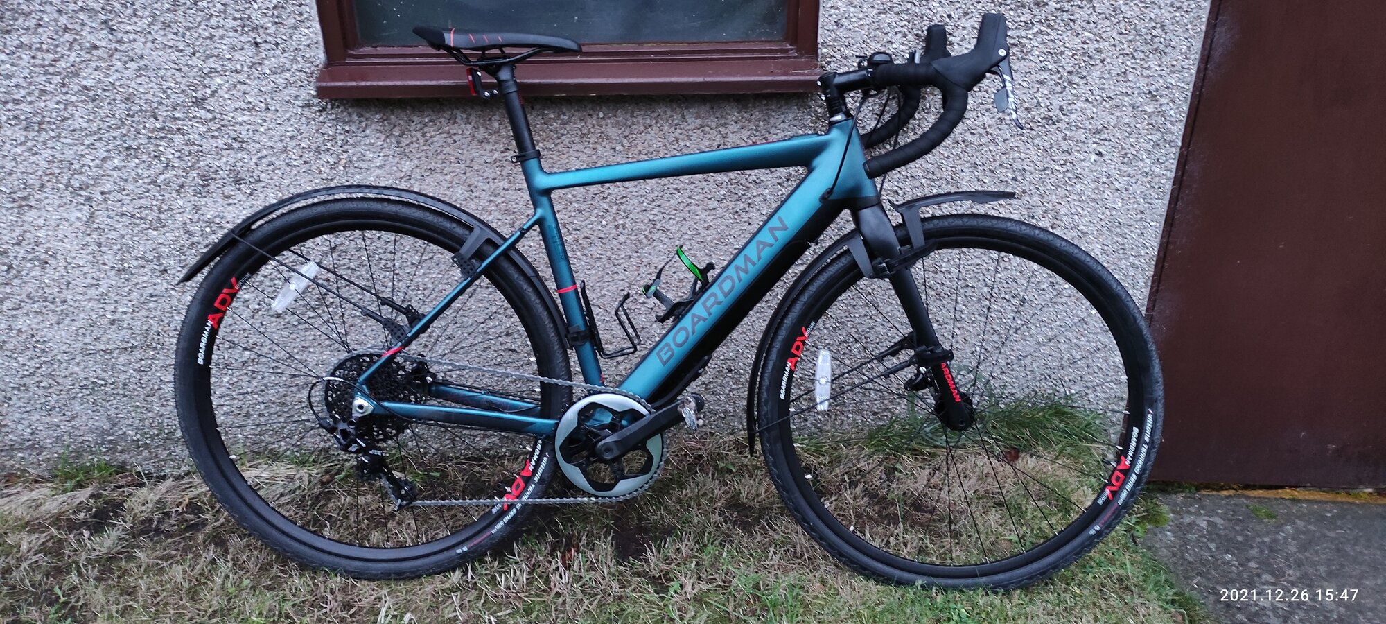

Speed Rocket mudguards and 50T chainring fitted with no issues. Chain was the right length so didn't need to shorten it at all.

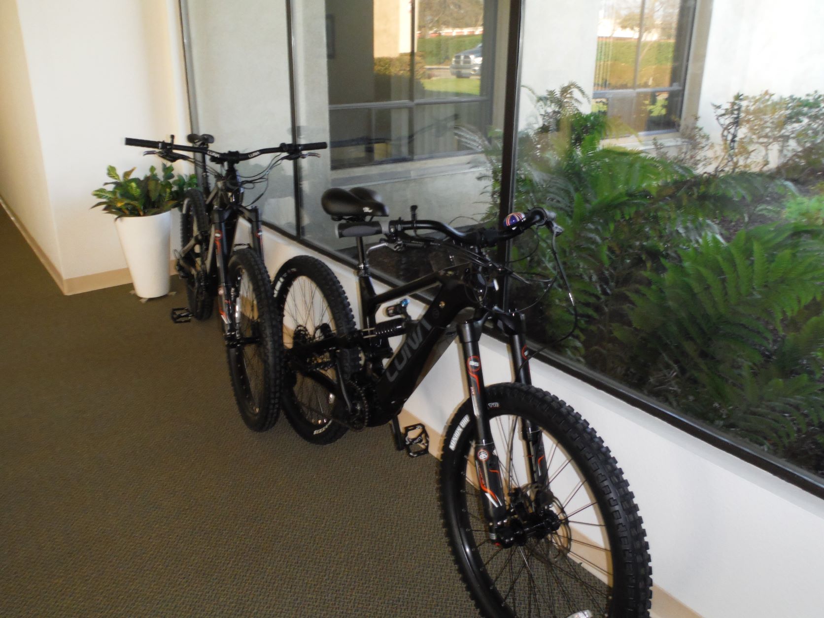

Nice mudguards! I got caught in the rain today riding a bike without fenders. What is your motor? It looks clean. Check this paint job. 120Nm.

Cracking paint job 😎

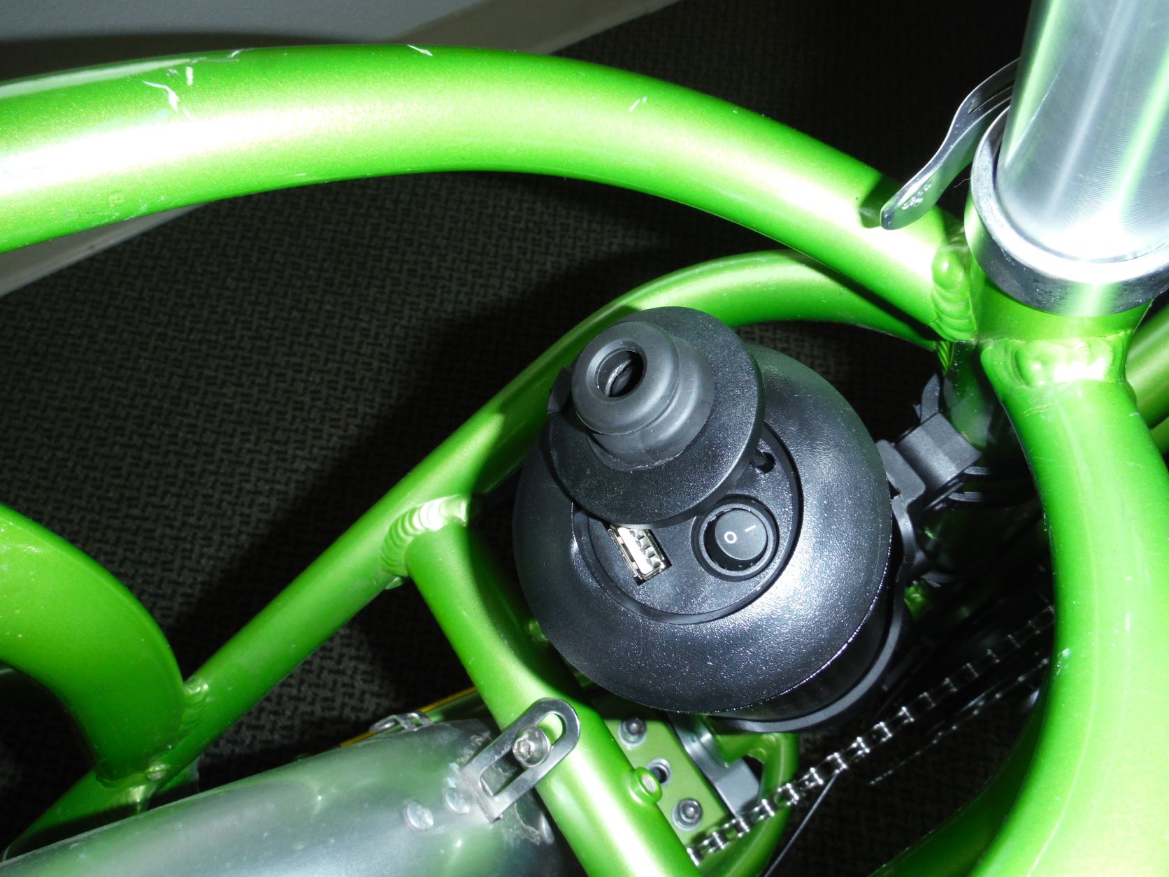

This green one is one that I made yesterday and delivered today. The outer chainring was intended to merely function as a decorative chainguard. But in the upper register of gears it can be used, it is also 50-t. The motor is 750W with a torque sensor. No throttle. The rack holds 120Kg of cargo. The new owner is a green politician. It is a recycled cycle. What do you think of the battery top idea?

It good with the new chainring, the 42T original was just a little on the small side for the commute.
That is a lovely looking machine, some motor was well - is it mounted under the bottom bracket - a very neat installation indeed!
Once upon a time I used a 58-t. It was very fast on the top end. But would derail itself from the chainring when in the low gears. That was dumb. This chrome one is 50 to a Nexus 8, 16-t cog. I like 50 a lot but usually stick with 42, so as to not overstress the main bearing. The owner of the paint job Christmas bike is duel citizens with the UK/US so I surprised her with a bell.
