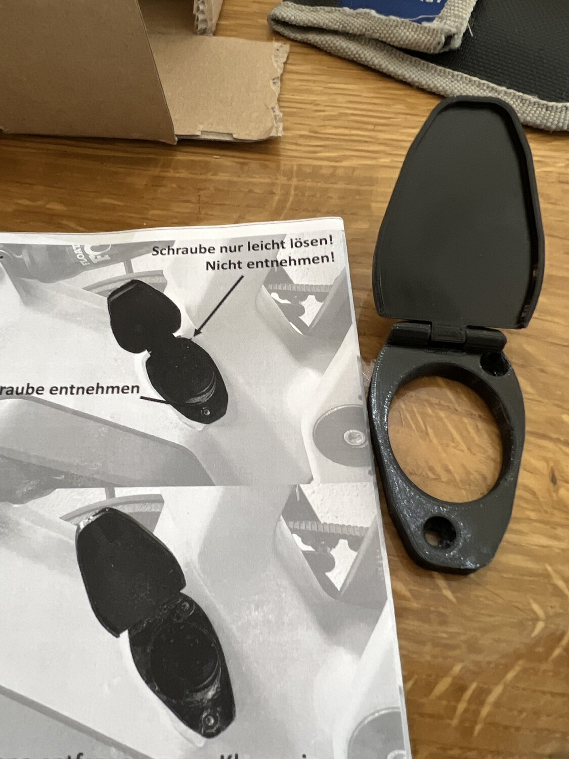

My New Super Delight charging port cover has a magnetic feature to hold it closed. Magnet in flip up top / tip of cover is designed to latch “magnetically” against the screw that holds the port cover to the frame.
Problem = the screw that Riese Muller uses to attach the charging port cover to the frame is NOT IRON / non ferrous, so the magnetic latch is USELESS!
Propel bikes (who is awesome) sent out a warranty claim and immediately sent me a new cover (same cover with the same problems) BUT I must add that the replacement cover screws provided with the new cover as the “warranty fix” were too short.

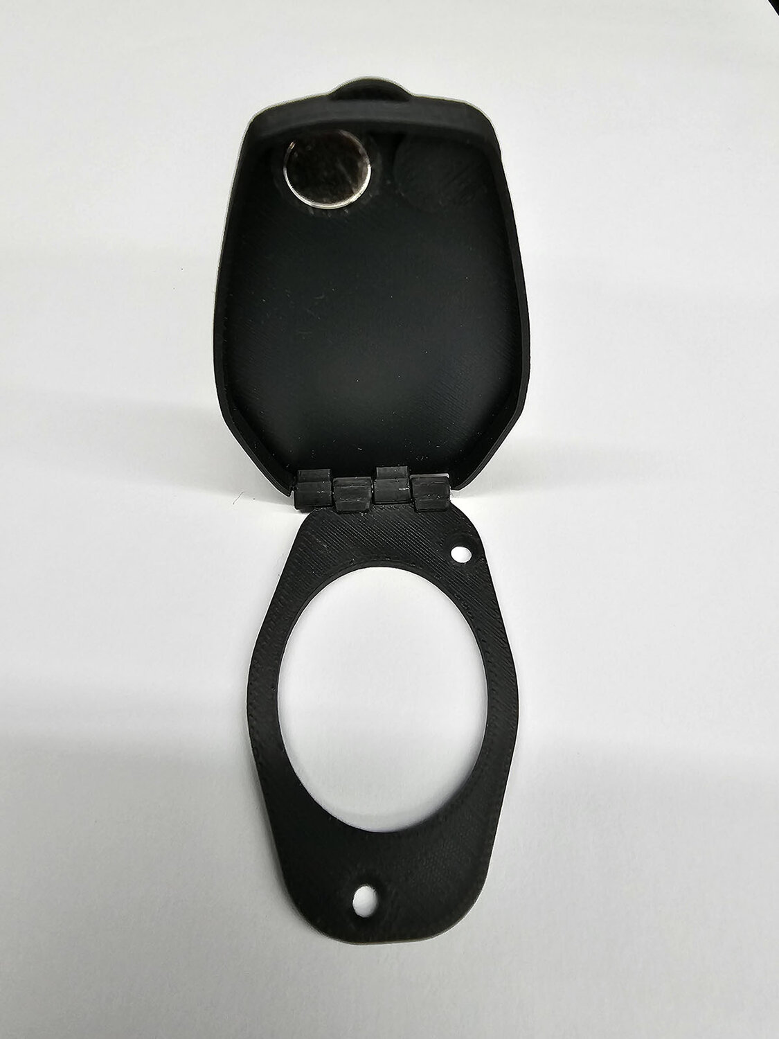

After being very disappointed with Riese and Muller's charging covers and having destroyed several with pedal strikes because they popped open, I decided to make my own. After several iterations I finally had one that worked as I wanted it too.
I used ASA as this material was developed to have a high UV resistance so it shouldn't fade much, if at all. Also it is tolerant to many hydrocarbons and chemicals so it should survive the odd spray of GT85 etc. I also used an expensive magnet to ensure the cover would stay closed normally although I have to make sure I close it after charging to prevent pedal strike.
I made a few more so I can try and help people who are having the same problem. See the link below -

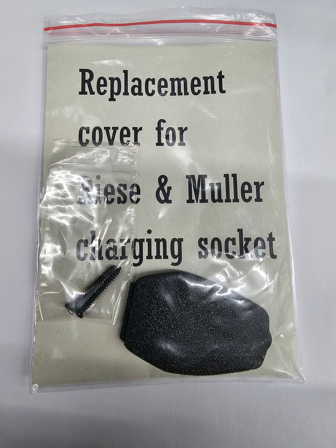

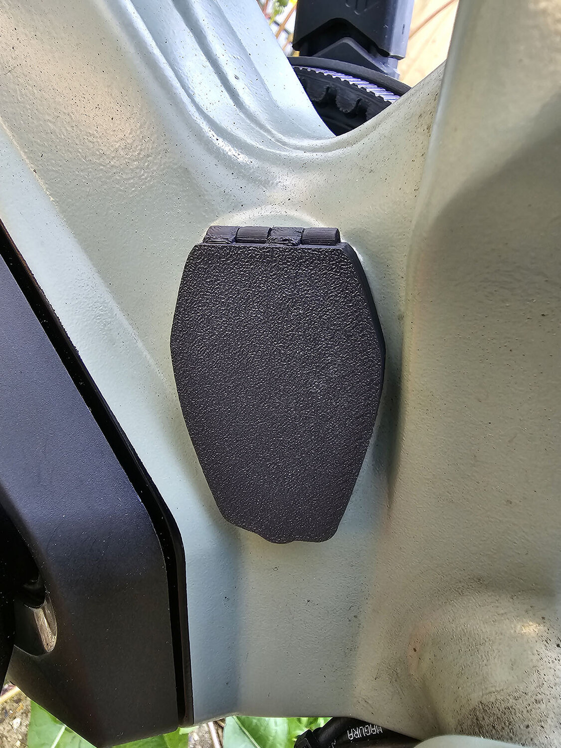

Ah is this your design/product. I found it on ebay, ordered and fitted it yesterday - fitted perfectly, thank you
I bought one too -- thank you very much. It's so disappointing that Riese and Muller couldn't come up with your simple but infinitely more durable design. It would cost them a few pennies more, maybe, but surely that is what we're paying for.

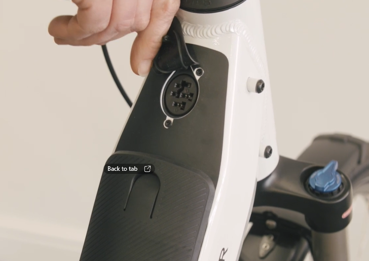

Does anyone know if the port on the listed models is the same as on the Nevo3, which is not listed. Thanks.
Sorry Bil but I'm not sure. I watched a Nevo 3 review and it looks very similar but I can't caregorically confirm whether it is identical.
They look very alike, albeit the Nevo isn't hinged with the weak flap like the Delite is.
The charging socket is identical on both bikes, so the screw or fixing holes would be the same.
