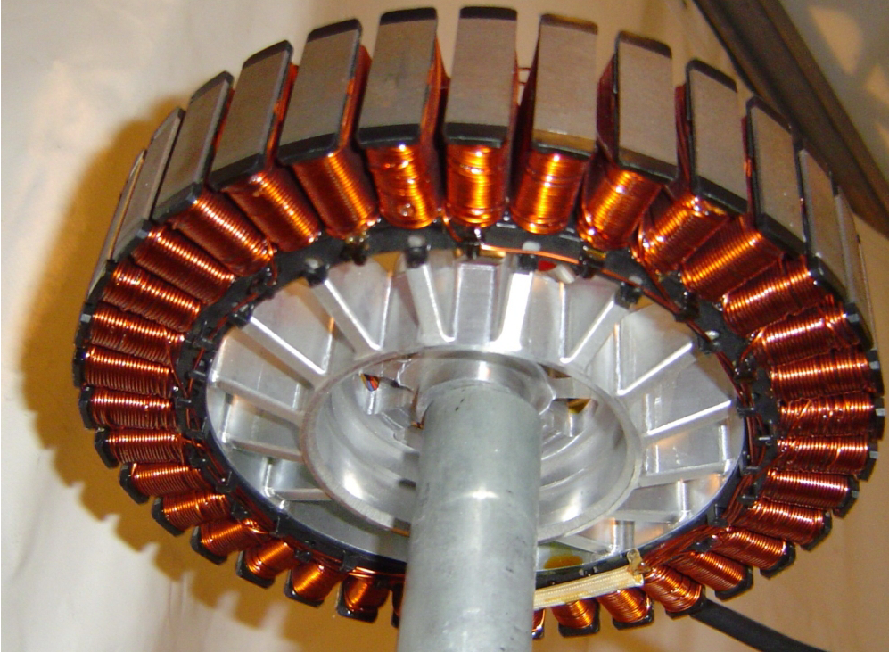

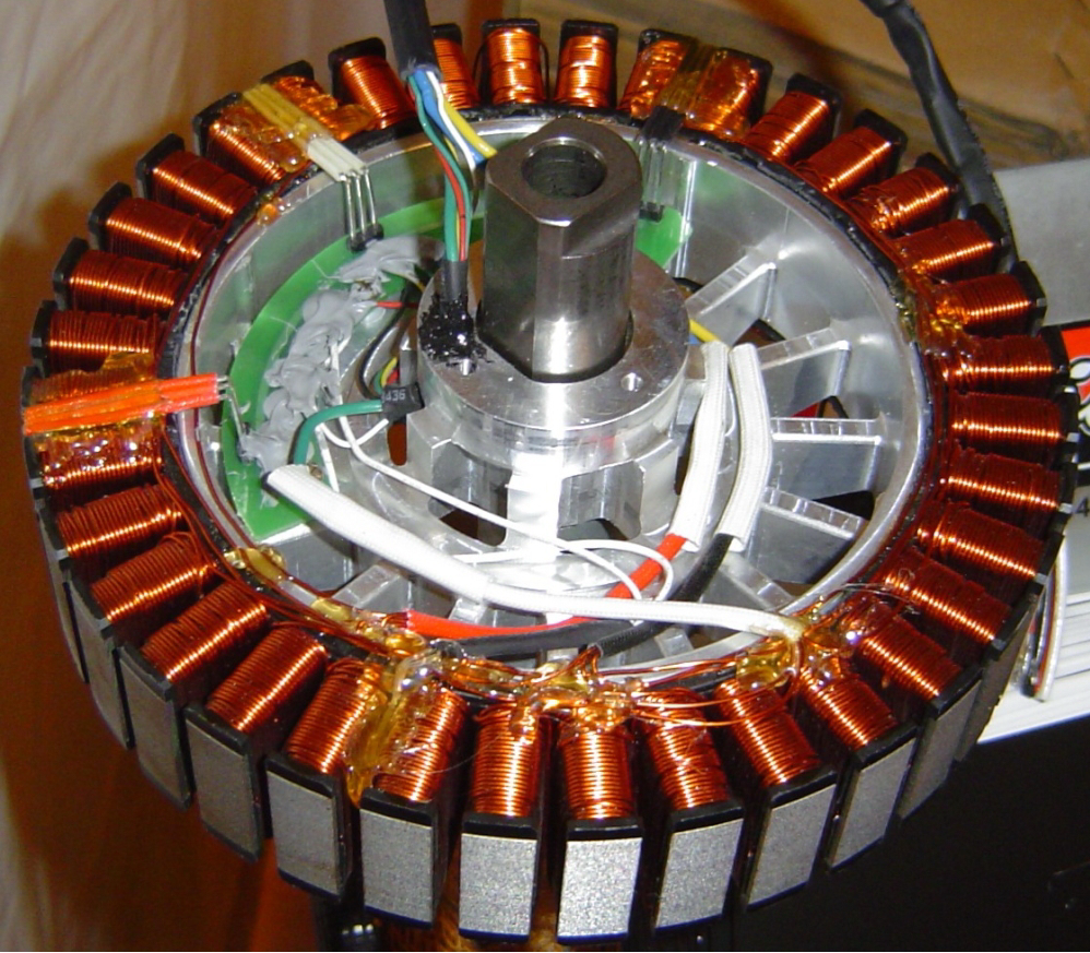

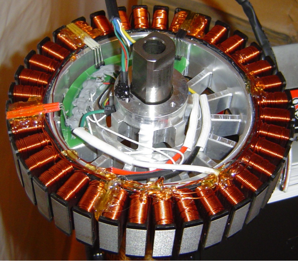

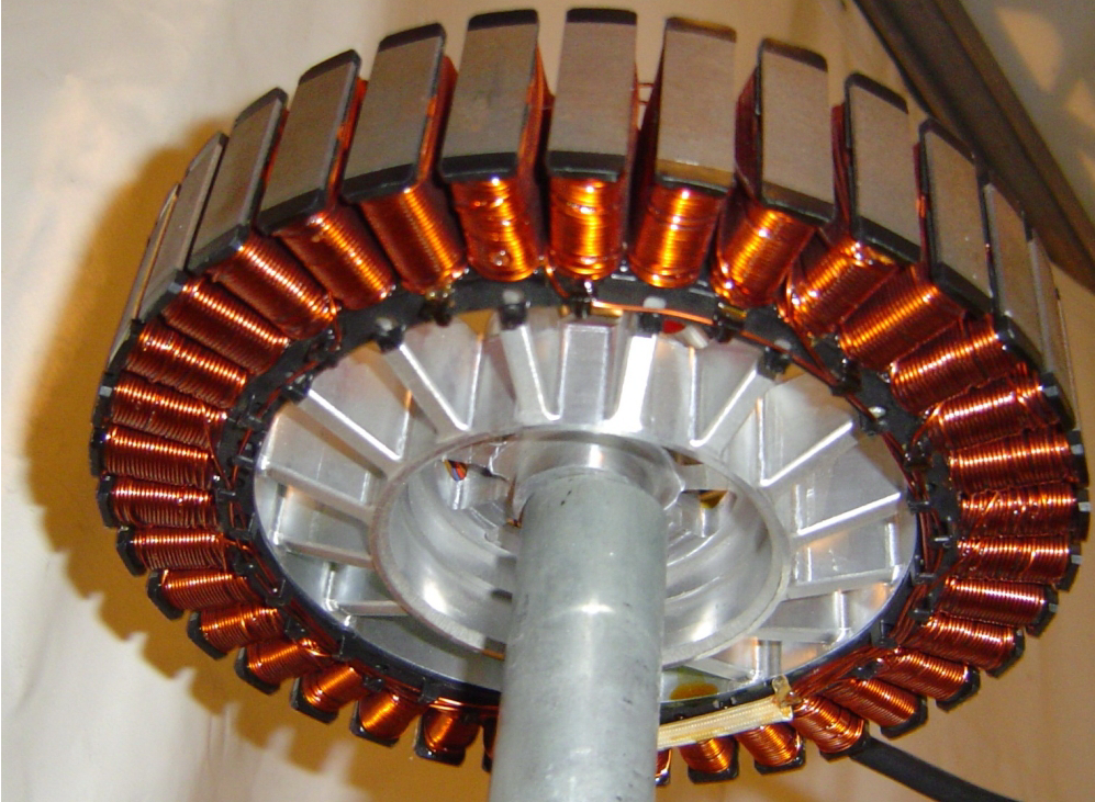

This is how a Stromer motor looks like from inside: Copper, iron - and the magnets at the rotor.
Here is NOTHING to repair, no major electronics, no gearing, no switches!
Show us a picture of a mid drive from inside to compare....
The experts recognize the temperature and the hall sensor - and are happy, the sensitive motor controlling electronics is outside :)
Very nice picture but on Stromer st1 first generation, isn't the controller built inside with motor? Since this is my second motor replacement ...the odds of it being defective I thought are a million to one......just wish I knew what is the culprit is giving me that no-comm error message.
This picture is from 2014 when the ST2 was introduced. The ST1 is withdrawn from the market since years. I tried to figure out why you were able to buy one; the outcome is my text above "how to get a lemon".
