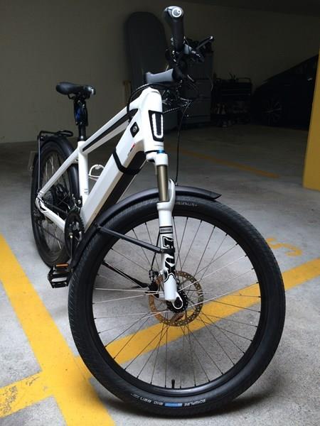

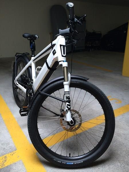

I'm sure one of you know. Curious as I'm wonder what other fork options I may have available.
Fox 26" 100 mm or 120 mm travel fork would work. Also, it would raise the handlebar position by few inches making it less aggressive.
Here is an example.
