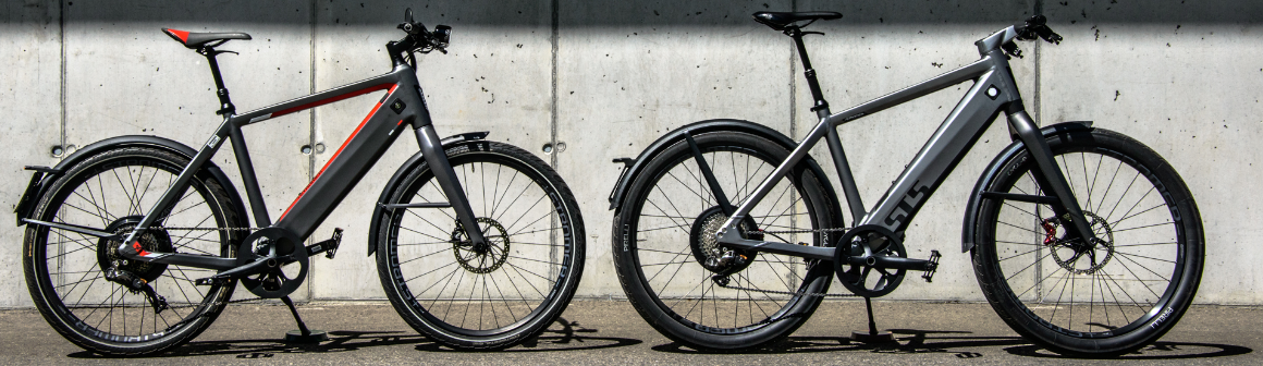

OK; if Stromer would make a 911 series, the ST2s would be the GT3 and the ST5 the turbo.
The ST1x is the most harsh, with the rigid alu fork and narrow tires. The ST2 had a carbon fork with more flexibility - and was fully equipped. So, the ST1x was an option if money counts. With shorter wheelbase and more narrow handlebar, they were made for city traffic. Agile, able to pass between car lines in the traffic jam.
All 27½" have different steering angle. The ST1 feels closest to the old 26". The riding feeling especially on the ST5 is really different. It's more smooth, but with the large handlebar you'll need some more space on the road.
In my case, I didn't miss a suspension fork. But this depends on the road you commute, the speed you ride and our subjective impression. However, you have the option for the Wren USD fork. This construction is ahead of may be all competitors: USD technology like on motorcycles and no change in the bike geometry!
Overall, the new 27½ are more comfortable and ST1 and ST3 offering broad variety of stem/handlebar.
The impression of the difference is even bigger in real life than on the picture:
