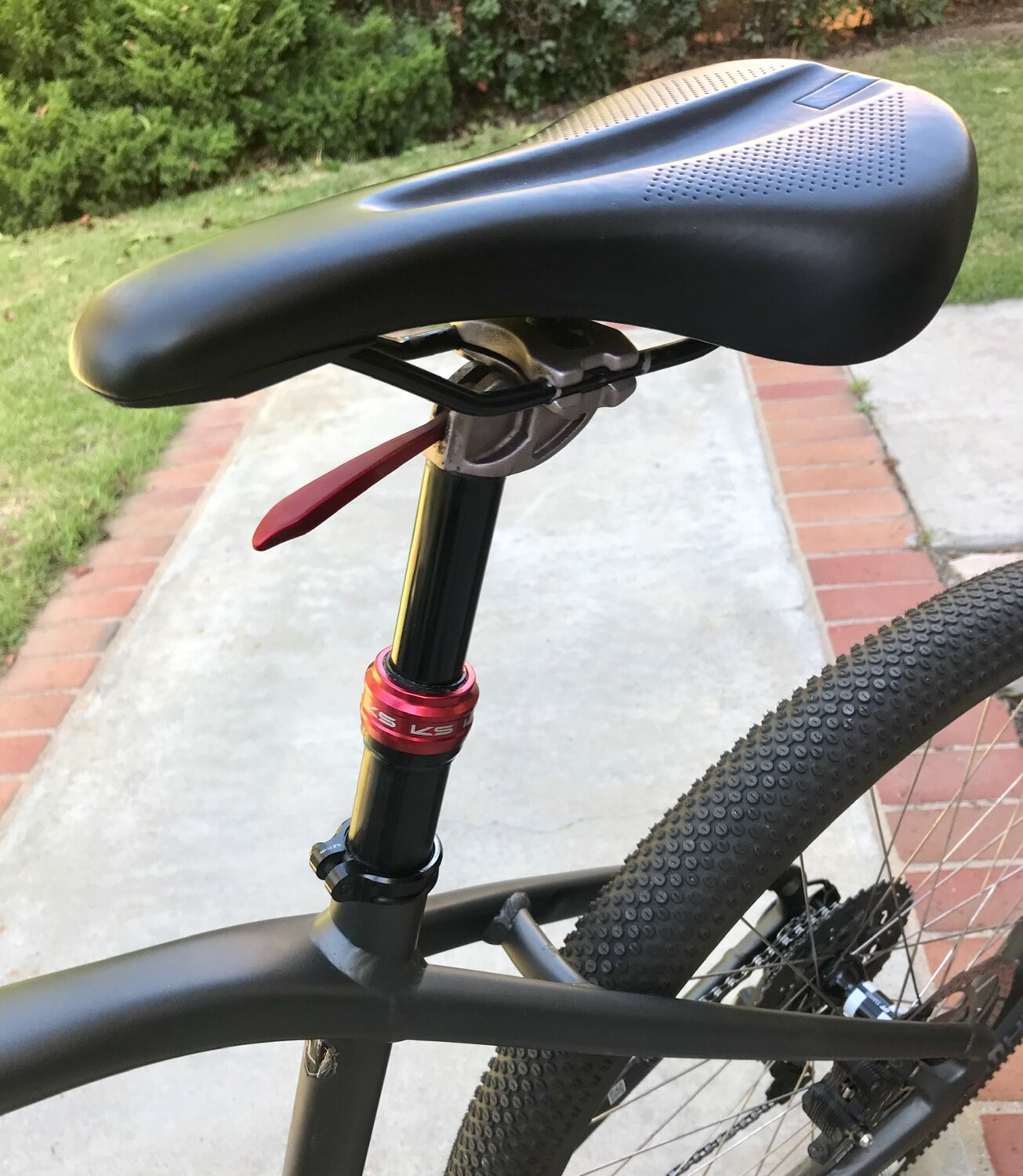

Stefan I'm going to buy a dropper like you have. A proper dropper with a thumb lever will be too difficult to install properly. There is no access into the frame from the right side unless a hole is drilled into the frame, and that's where a cable would need to go. But I decided a dropper is necessary. After using them on my MTBs I feel safer with the seat dropped in many situations. And the most efficient saddle height for pedaling is not very casual, especially in flip flops.
Well done... can you share the specific make and model dropper post used?
I am looking at the Trans-X Jump seat ($99 usd) and the Kind Shock 2021 KS eTen 100mm Dropper Seatpost Post with Lever ($140 usd)
Those two posts are the only dropper posts I see with a lever under the seat.
I'm also looking at the PNS Coast dropper which "combines ride smoothing suspension and the benefits of a dropper into one seat post." This post has external routing. The suspension aspect intrigues me because the Vado SL does not have much compliance built into the rear end. It's a stiff riding bike. I put 42c tires on the bike which provides a little more cushion, but it's still a stiff ride in the rear.
Perfect, thanks... I just ordered the KS eTen Dropper. ;)
