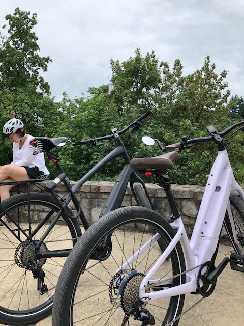

Jan, my riding partner rarely shifts, so her cadence is slow and fast. The power never cuts out. The assist always is invisible. The resistance to the leg on a push of the pedals does not ever surge. This is the pleasure we paid a premium for.
