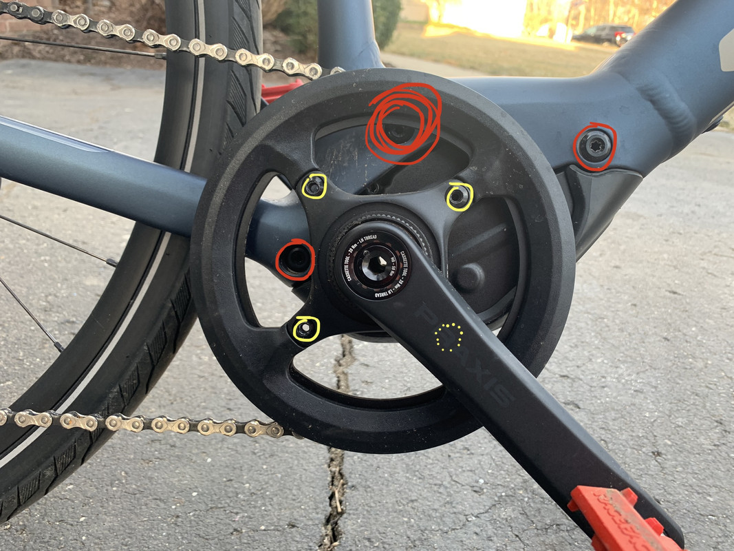

Flip the whole thing over and it’s just four bolts that hold on the chainring and four more on the motor. (The ring is in the way of one motor bolt.) I did it with a set of Allen wrenches, it looked daunting but was pretty simple.

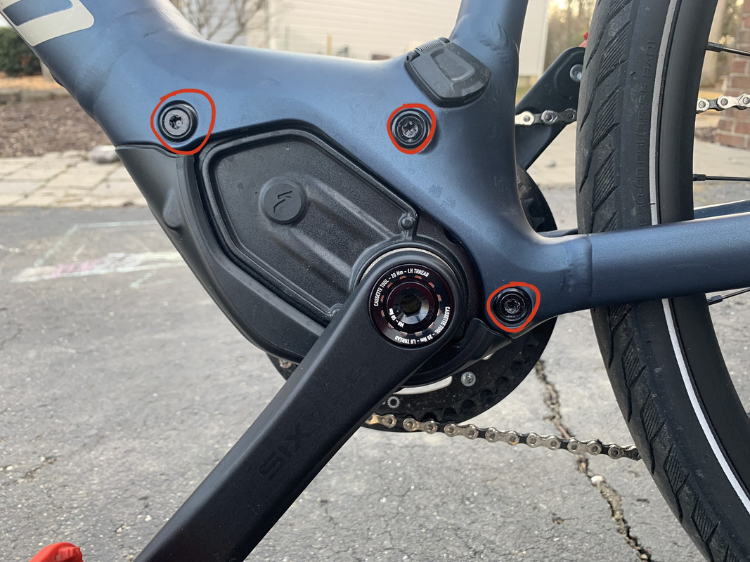

I miscounted when I said four motor bolts, it looks like six.
Three here:
and three here:
The top motor bolt on the drive side is blocked by the chainring, so I took it off with the yellow bolts. The moving crank arms will get out of the way. The ring will rotate and come off over the right crank and pedal.
After those bolts were out, I just wiggled it and the motor came right out. Disconnect the wires inside and you’re free.
Three here:
and three here:
Interesting... my motor was pretty much stuck in there when I took those bolts out. No change to wiggle out. I'll give it another try again. Thanks for the insight
