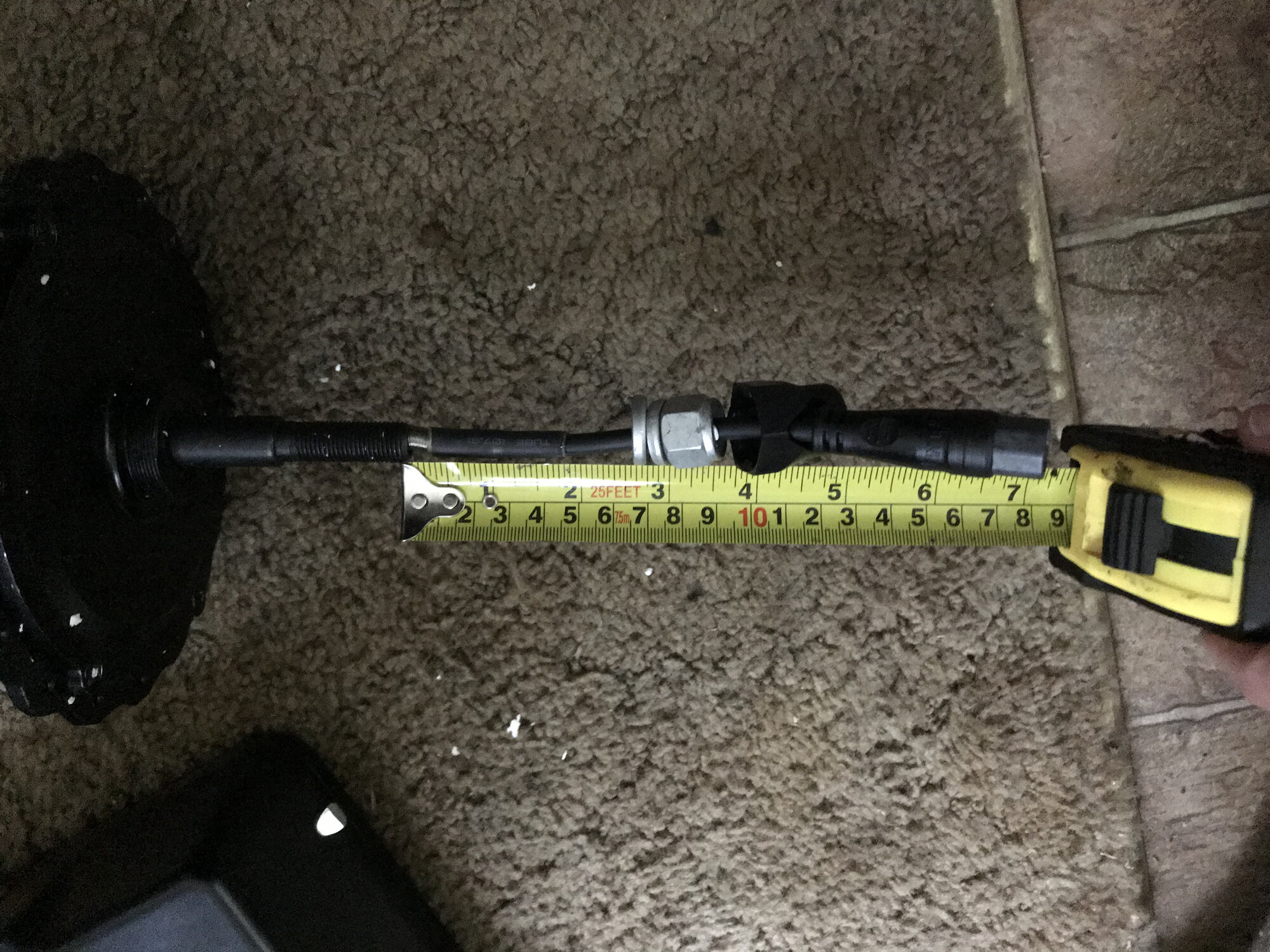

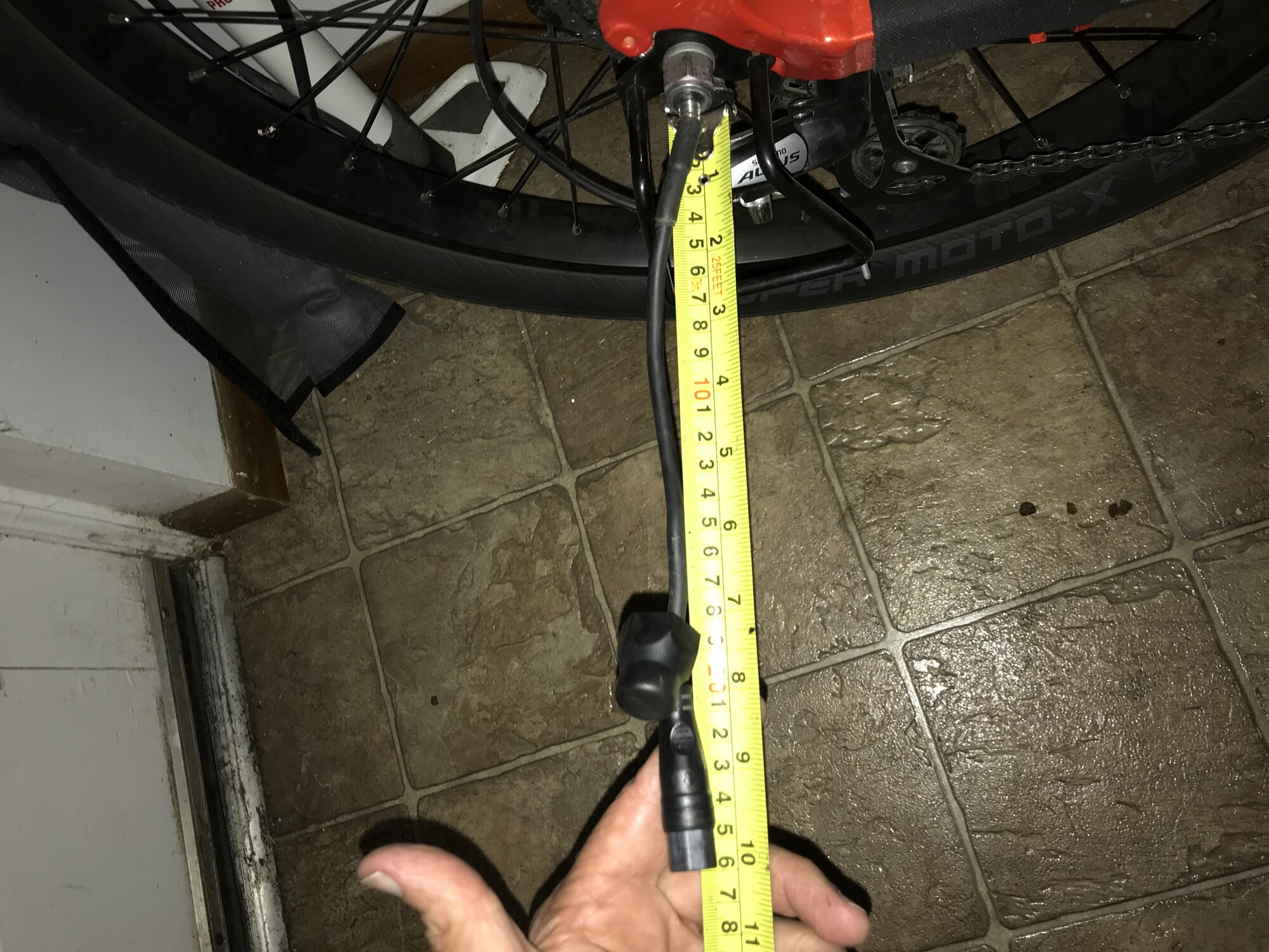

Sorry needed some ventilation- here’s pics,they keep sending motors with connection cables that are too short-
Original 10.25 axle cable exit to end
Replacement 6.75 = 3.5 inches too short

Have someone extend the cable for you, There's three thick wires for power and six small signal wires in there. Somebody at a PC shop. Tell him to use butt connectors on the thick wires.
They’ve sold 100,000 ebikes - if they can’t fulfill this super basic request....... No surgery until it’s the patient’s last option,but thanks!

You can buy an extension cable, pretty simple fix.
Hopefully their ineptitude won’t cause me to bridge a 3.5 inch gap with a f****** 4foot cable!!!! Thanks I’ve saved the link for that possibility!
Ok, so there are two versions of the 750w motor Sondors uses. One is for the fat bike which I believe has shorter chainstays and the MXS which I believe has longer chainstays. If your not a member of the Sondors Owners Group on Facebook I’d join. Someone will most likely buy your motor. Then I’d contact Sondors and let them know you need a motor for a MXS and it has to have a 10 inch cable.
