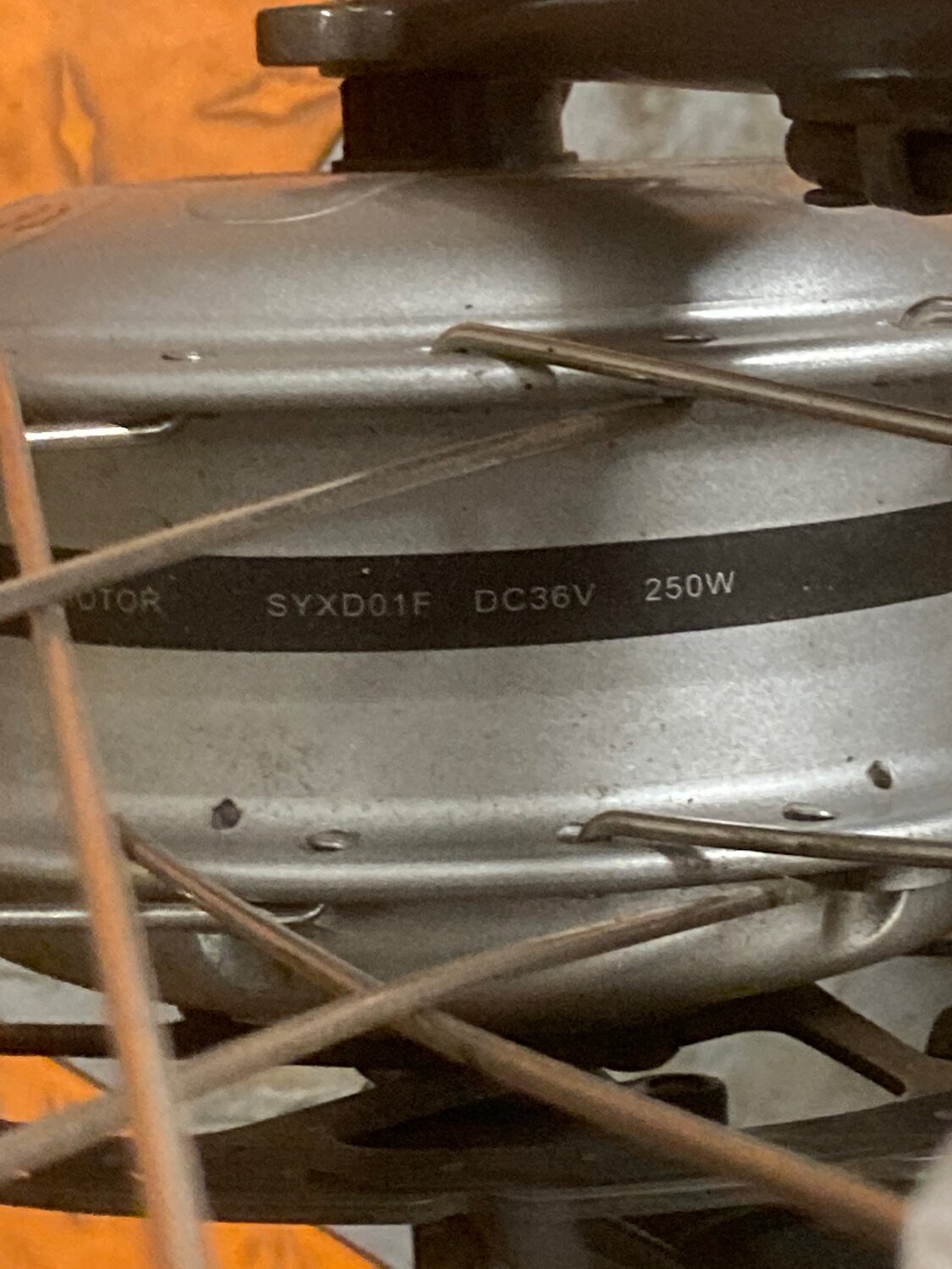

I am looking at swapping out the suspect electronics and battery on a dead Faraday I purchased.
Assuming the motor 8Fun is a Bafang and works, looking for parts - was hoping there was some consensus on standards or
parts to get/avoid...

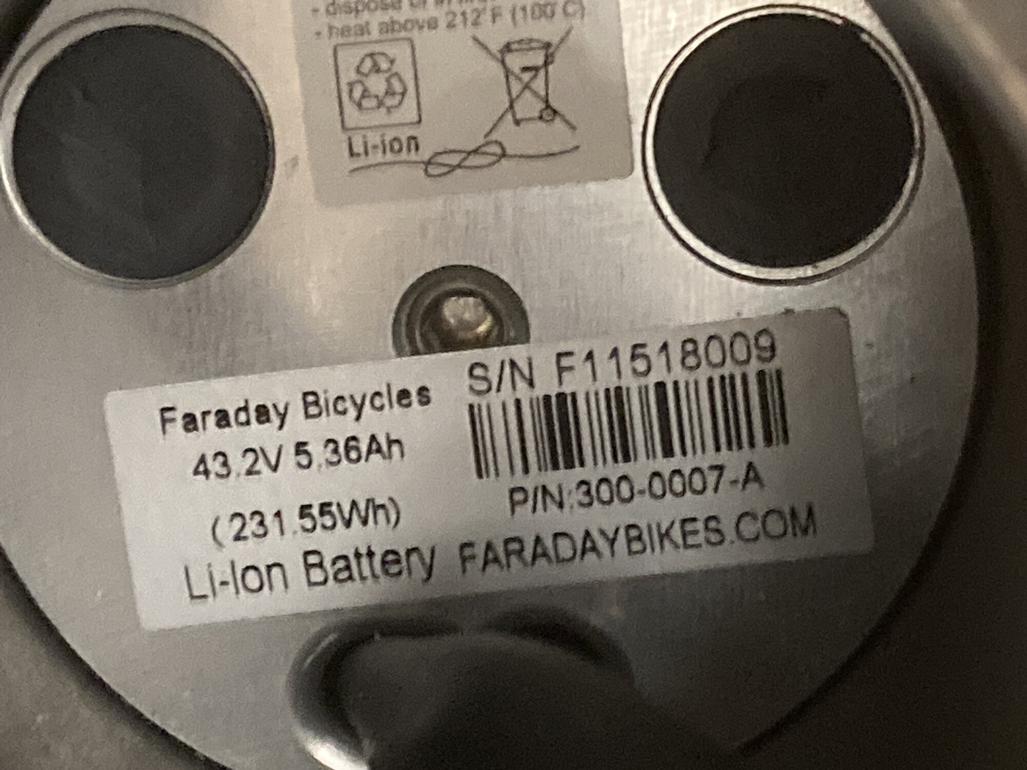

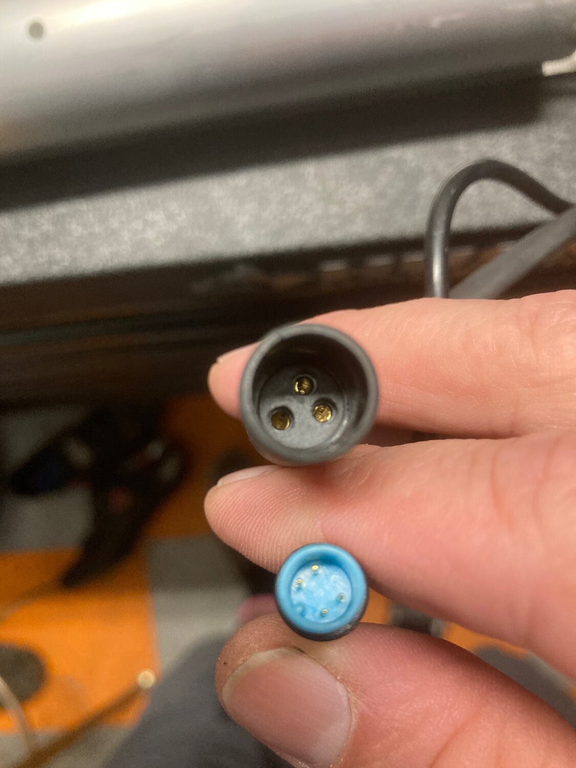

Should I crack open the battery case and check the individual cells? I am poking around with multimeter, get nothing except continuity between 1 pin of the
triple connector and one off the quad connector (I assume a ground)

I left the stock battery on the charger overnight with a Kill-A-Watt to see how much was going into the charger.
A consistent 3 watt draw with all red-lights solid on the controller, 20ish Watt-Hrs burned.
No change to the performance with charger unplugged - everything still dead.
Assuming I won't electrocute myself on the dead battery, I am ready to crack open the case to see if I can swap out the cells inside.
I would like to keep the Faraday's sleek form factor, maybe use the electronics if the problem is all battery.

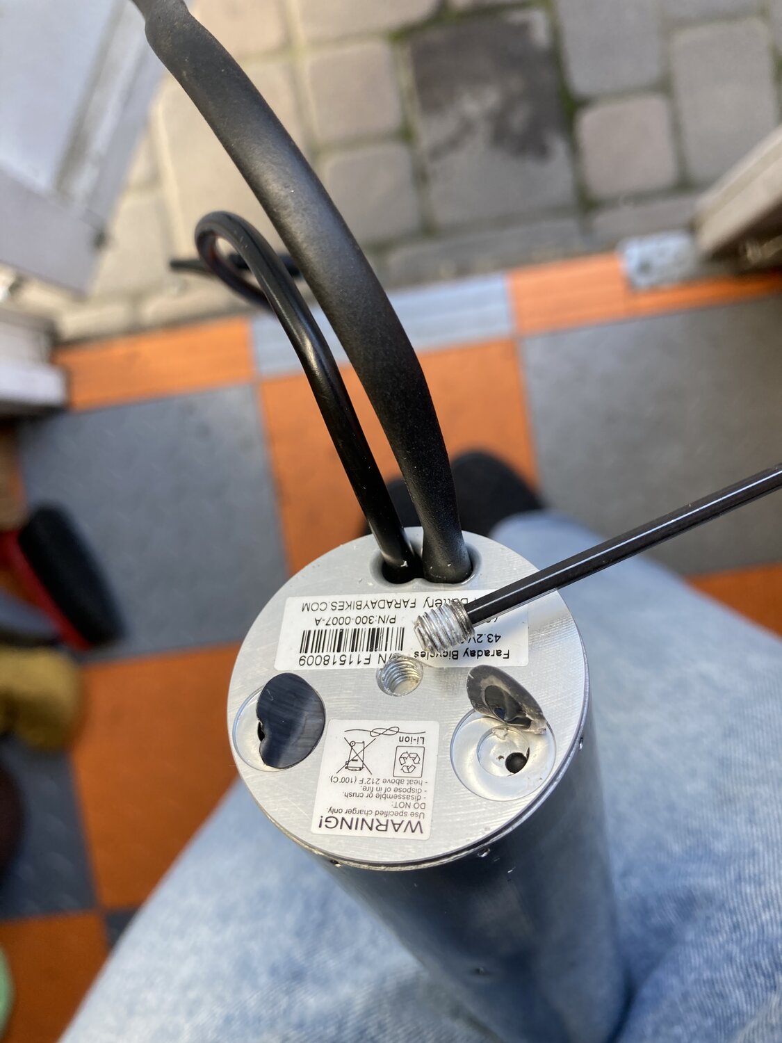

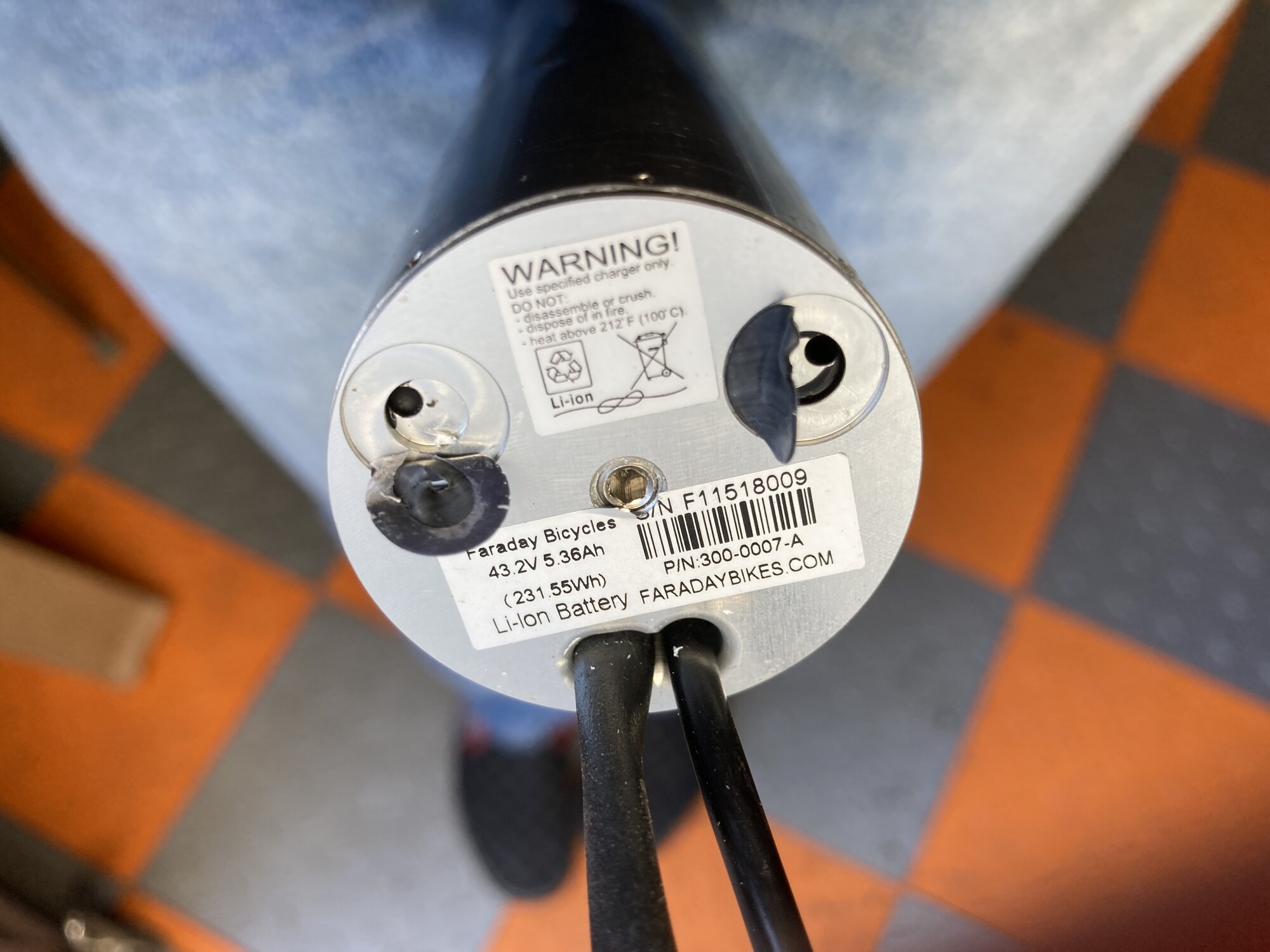

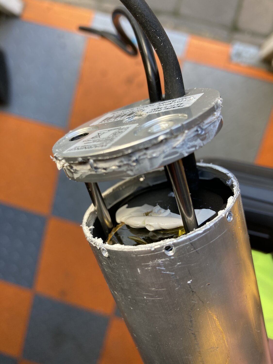

Observations:

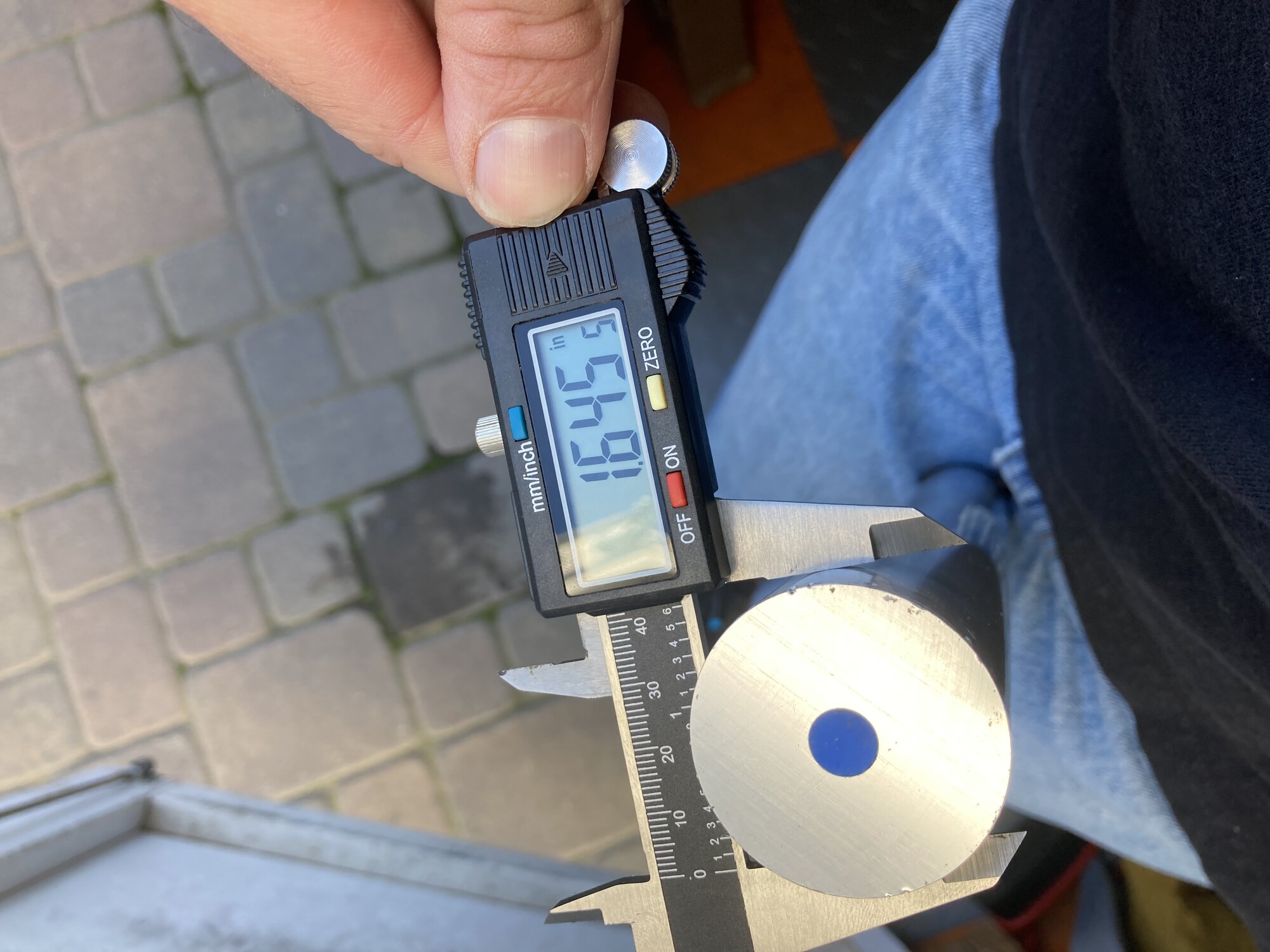

  • 1.645" / 41.8mm diameter with the calipers
  • The ends are a different metal than the tube itself
  • The tube ends are pinched/hammered with a pin to enhance traction on the end points (see pics)
  • wired end
    • has a 2.5mm allen screw center, not very long (see photo below), not sure why or what is under it? white stuff? (see pics)
    • 2 additional ports covered with light rubber, moved them asside to reveal 2 holes. Multimeter here? Maybe batteries are in series 2x/end here? (see pics)

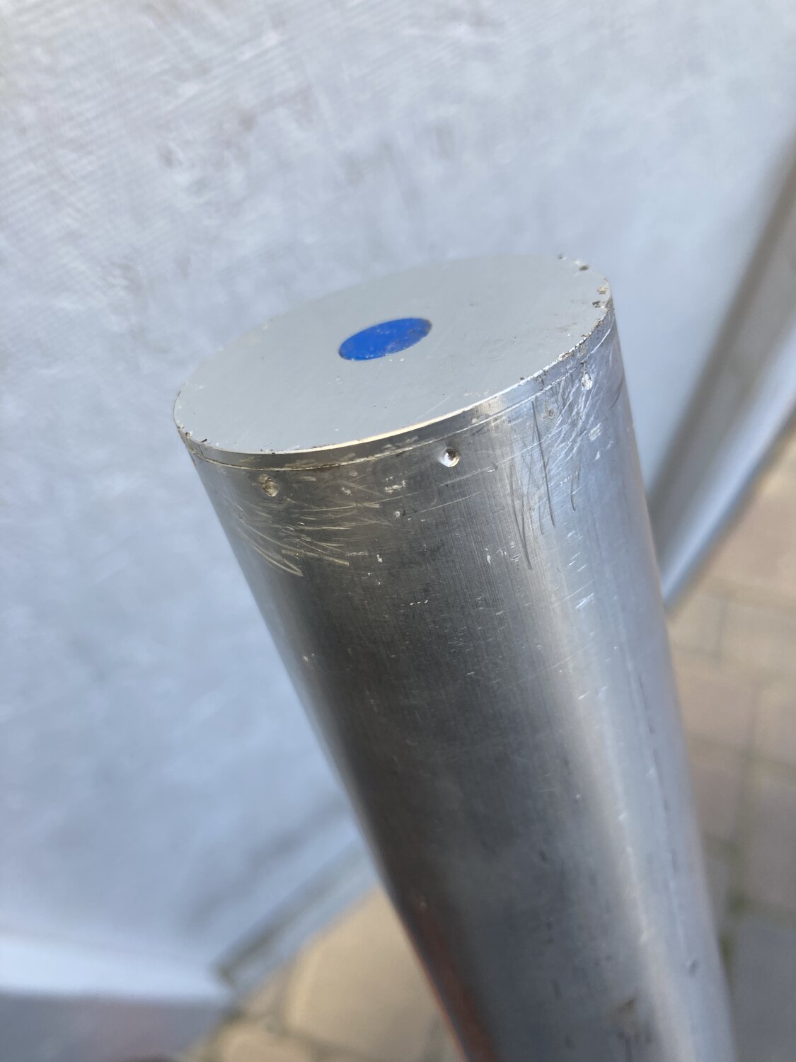

  • non wired end
    • 1 blue rubber port on the other side - when pulled, more white stuff
Next steps?

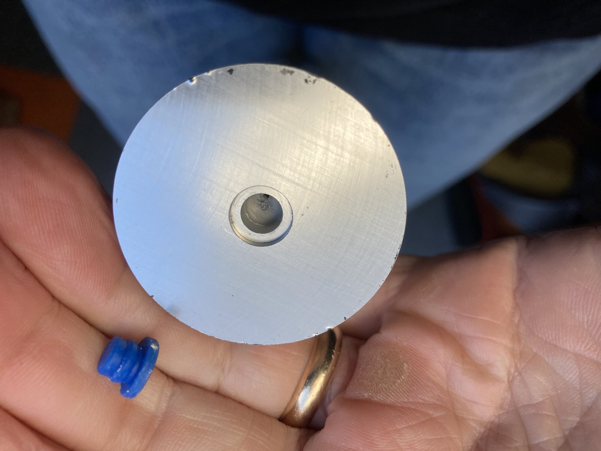

  • pipe cutter is too small to try spinning out the end-caps
  • do I need to drill out the indented aluminum to free the caps?
  • any dangers here to be aware of before I crack it?
  • shop for replacement tubing - I could try debugging with a 12x1 18650 series setup in a PVC tube.

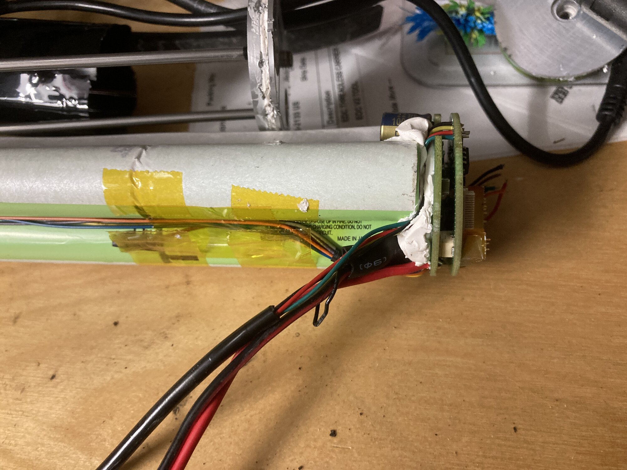

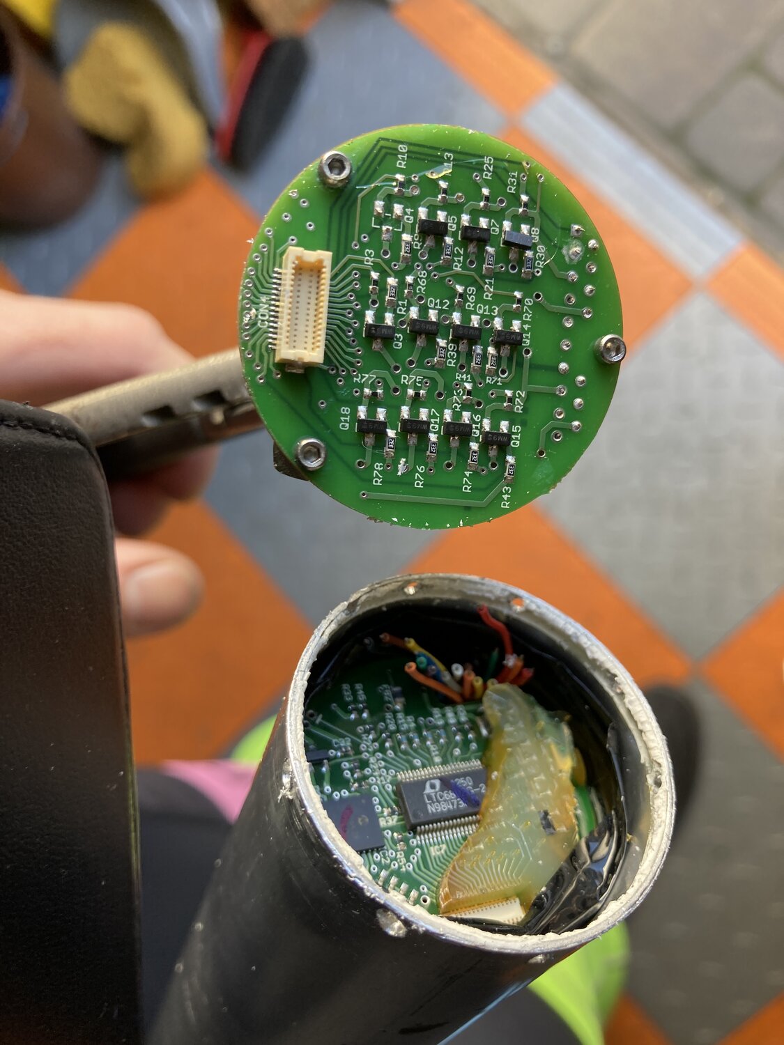

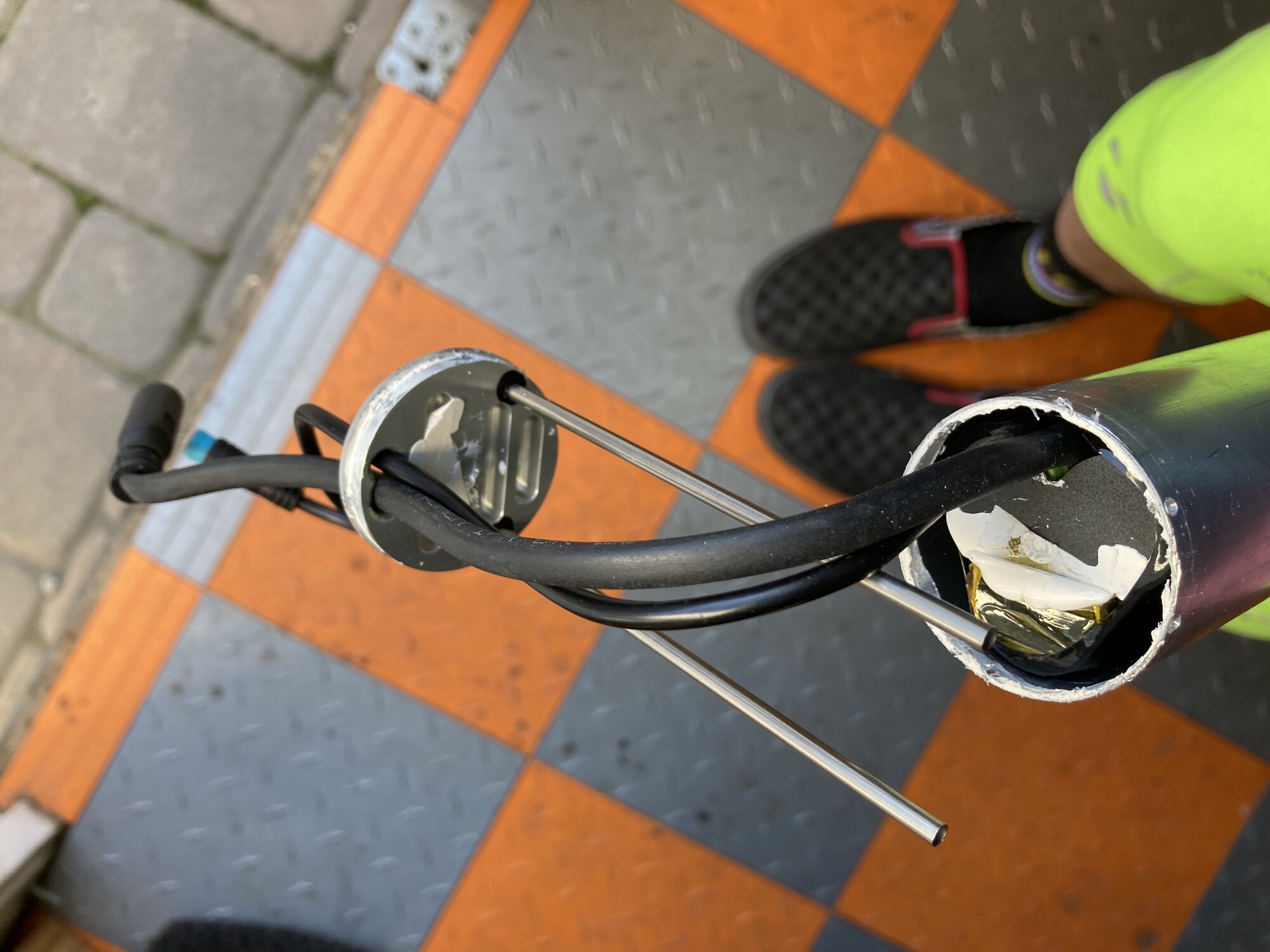

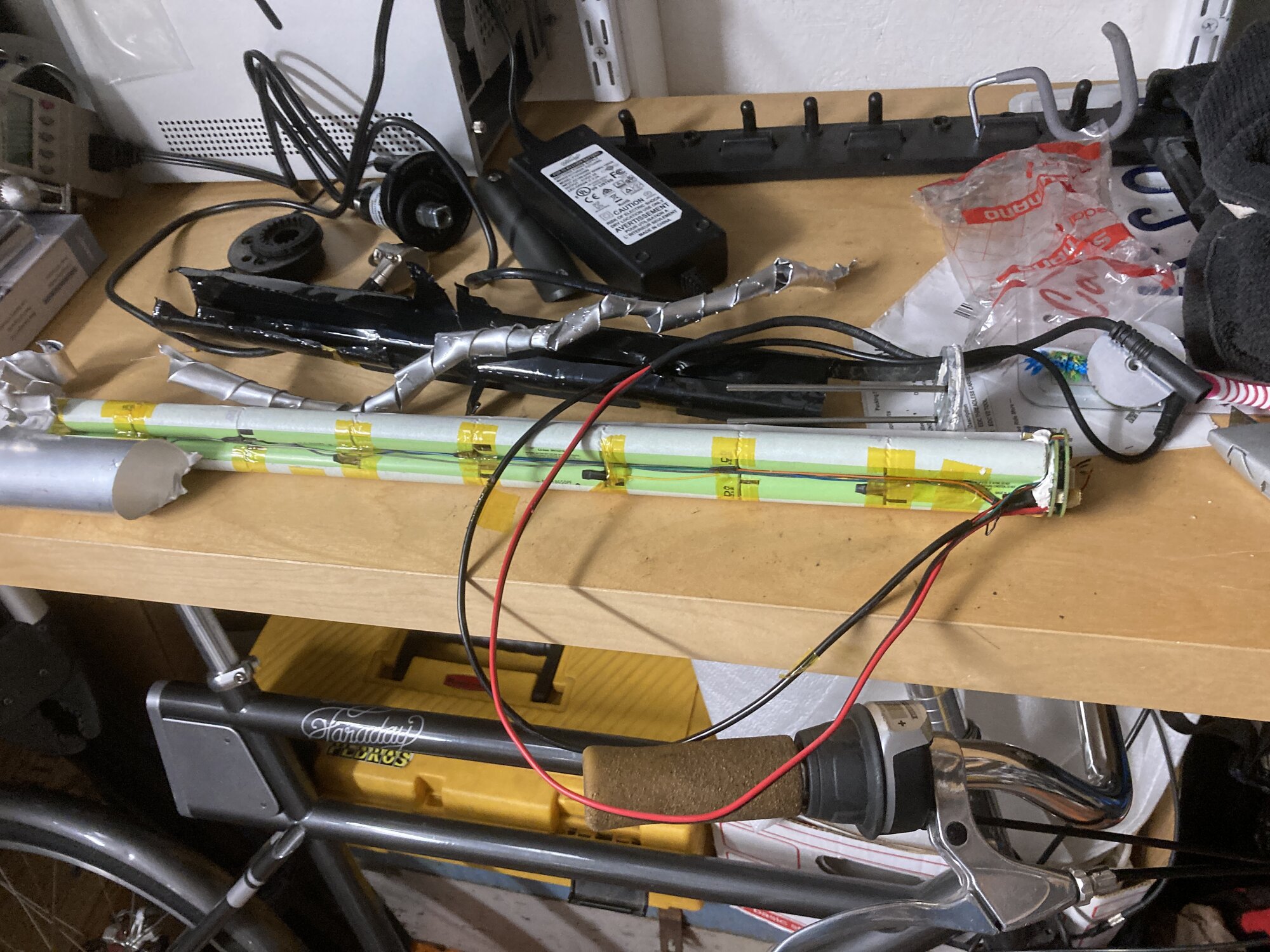

Btw, I cracked open the battery - looks like 3 cells per row. Broke the BMS hidden in the far end. Picks below
Corrections - tube is about 20” long - about 8 x 65mm, so its still 24 cells! Crazy wiring likely required to get 12s2p in this 3x8 form factor.

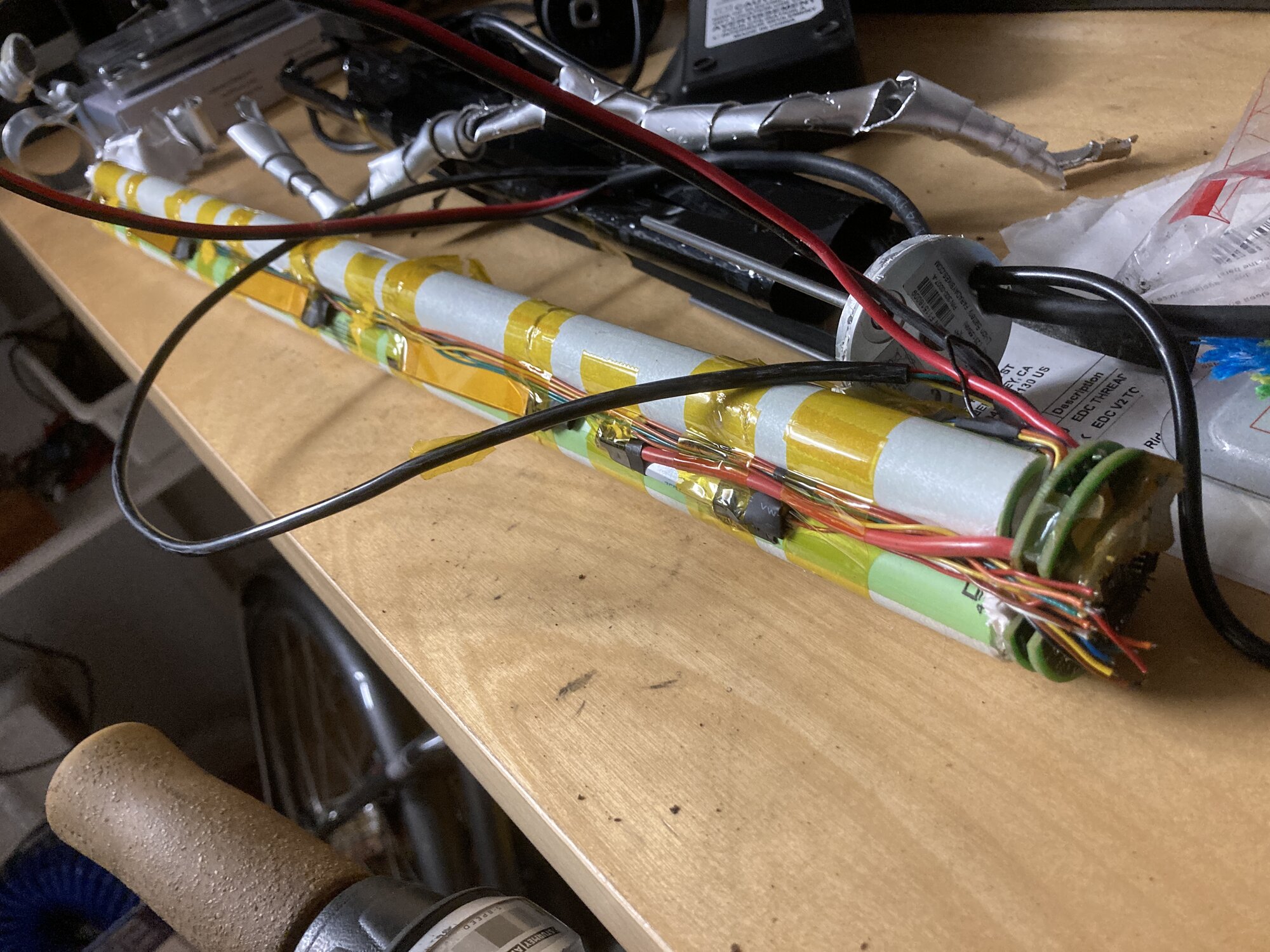

And even more - peeled the aluminum pipe apart. A network of wires between the cells is in play to make the 24 cells into an 12s2p in this 3x8 pattern

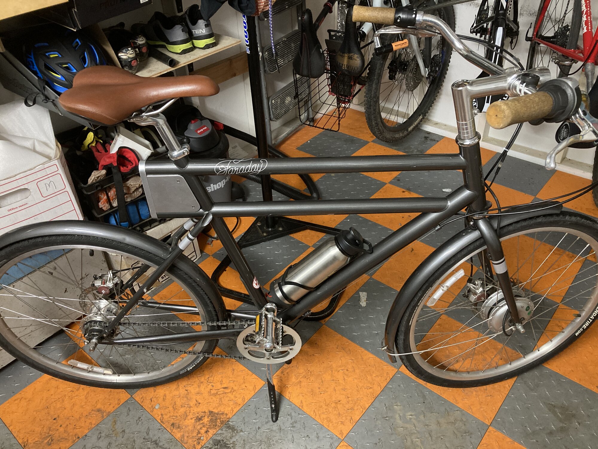

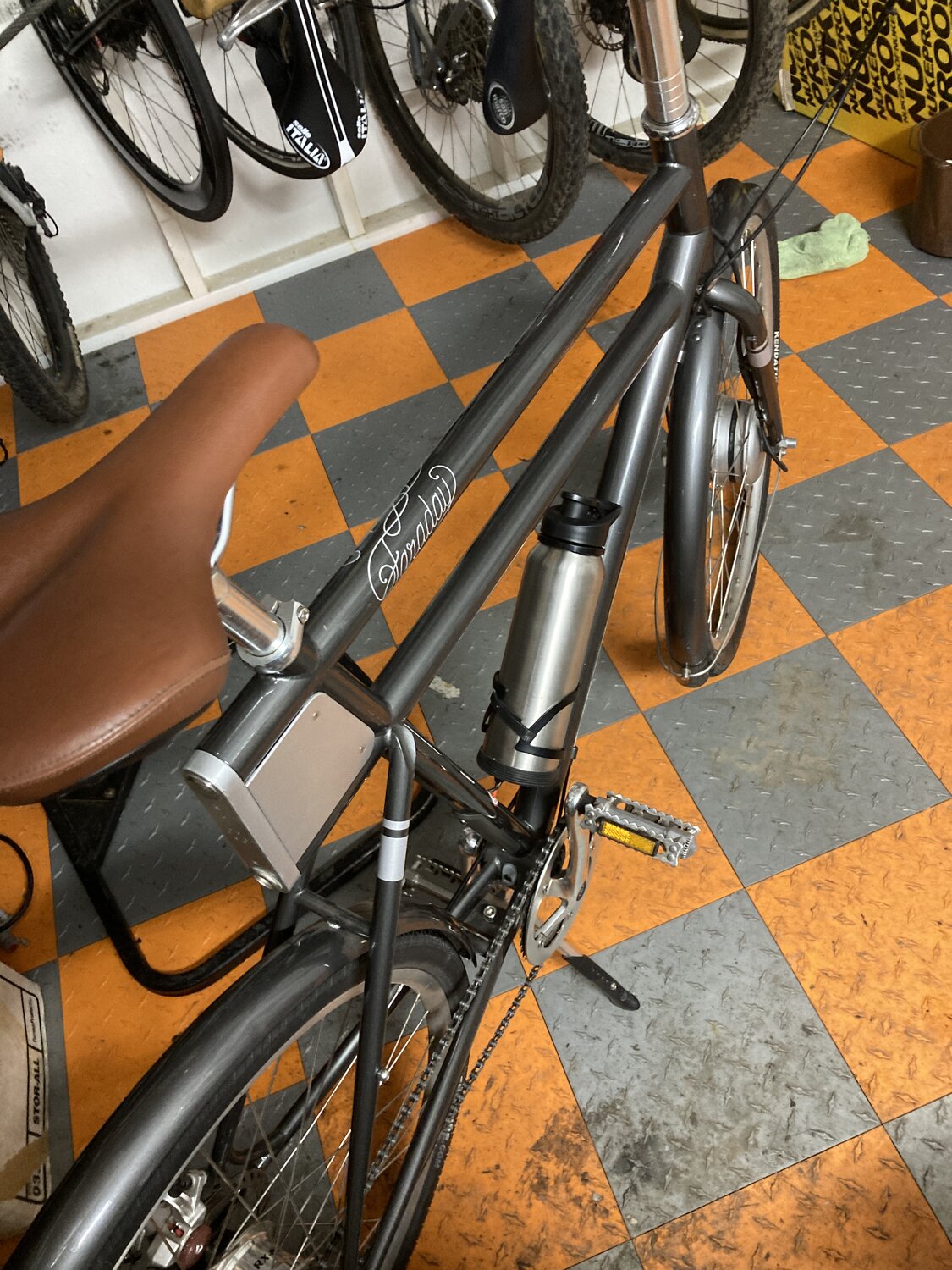

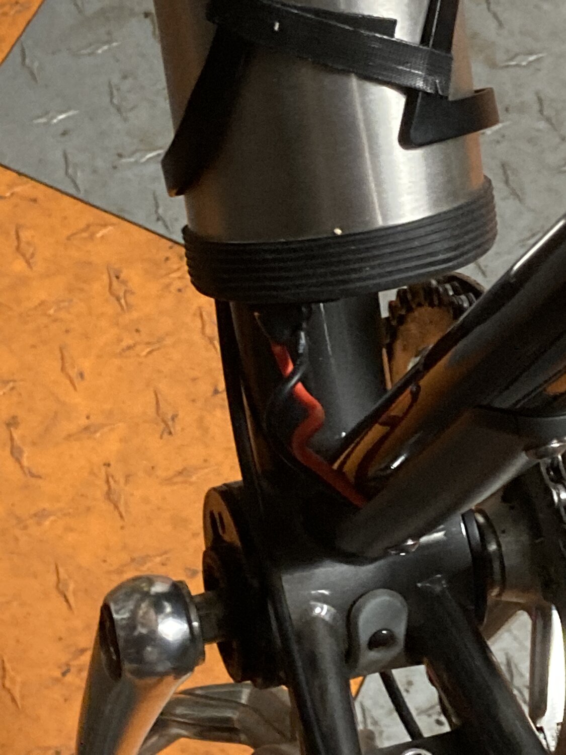

I got my 48v water-bottle battery ($172 @ Amazon), drilled holes for the cage, soldiered up the power cable and it all lit up, motor started spinning with pedal action!
