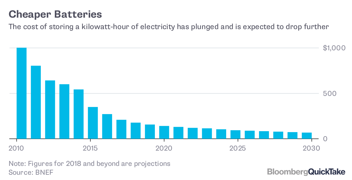

Interesting reading... https://www.bloomberg.com/quicktake/batteries
