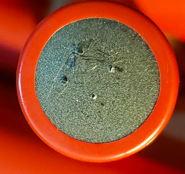

SALVAGE CELLS!

Grade A salvage GA cells sell for $2.75 each.
Sanyo NCR 18650GA 3450mAh/10A
[with little signs of removing welds]
2,75$/each; >200 pcs 2,69$/each

The cells are technically salvaged yes, but from unused packs and they are all tested and showing %95-102 of capacity. The cells were made in 2019, not in 2014 like the ones you linked.
