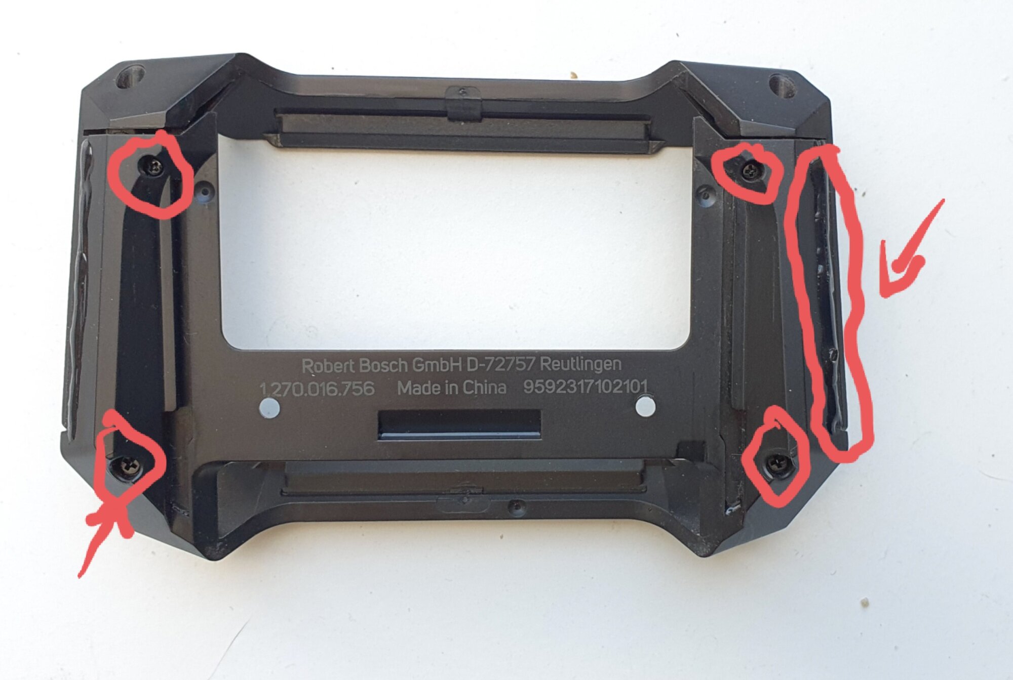

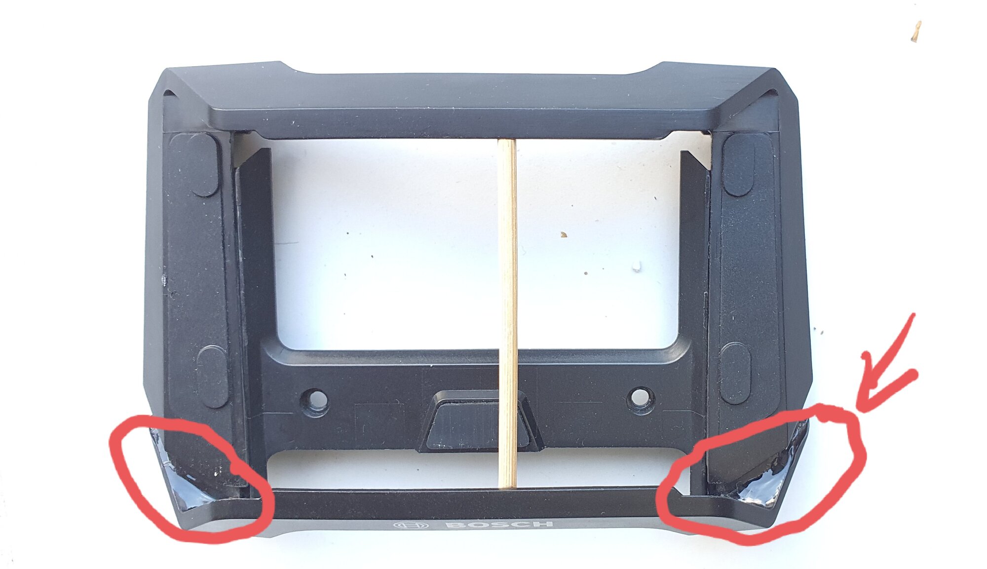

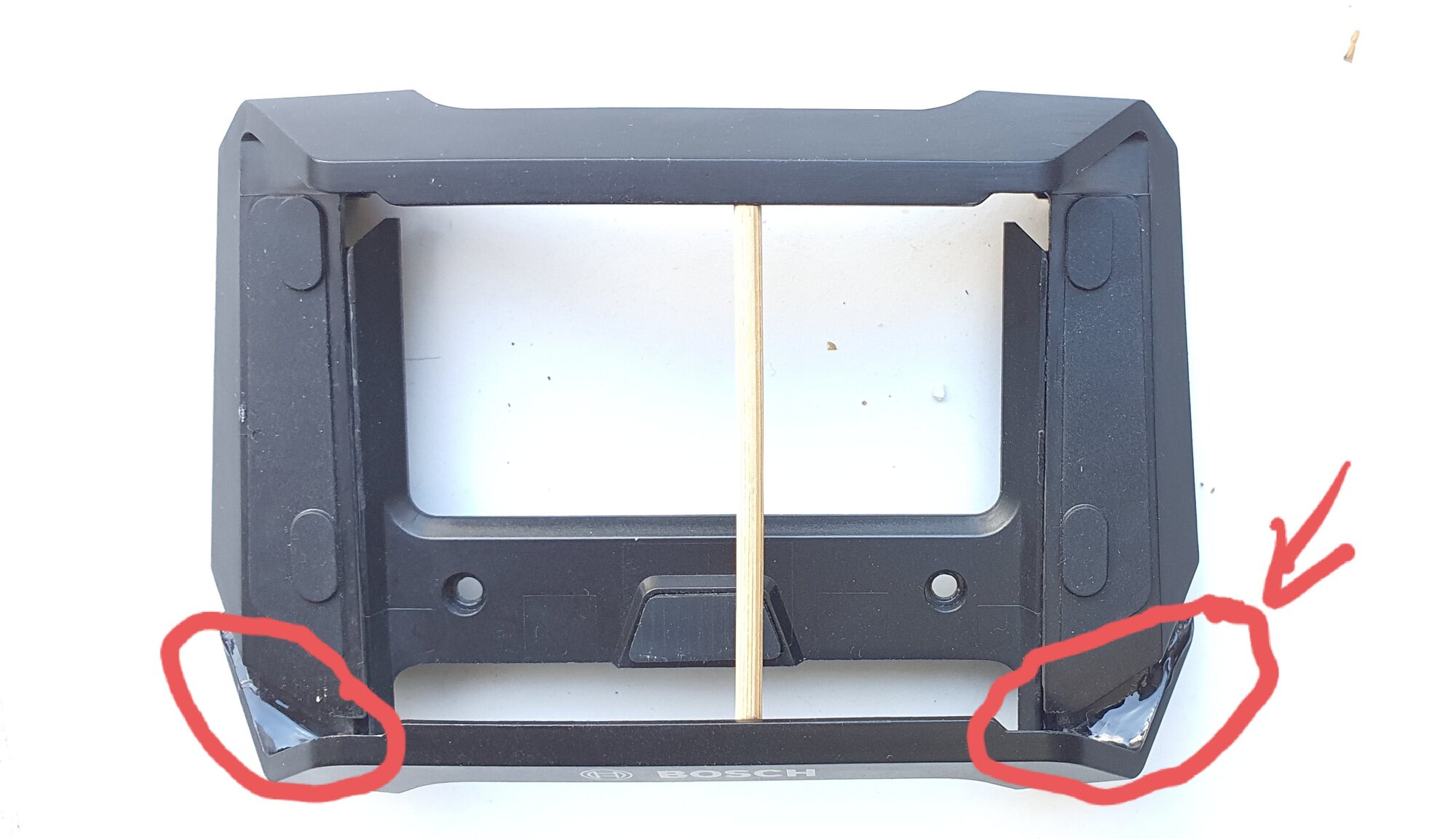

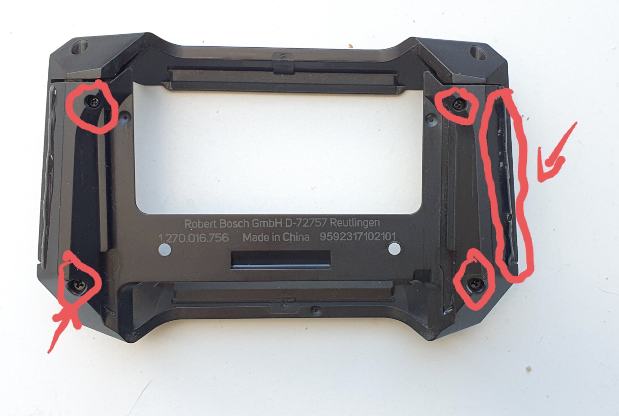

I had after the first 40km on my brand new bike the same that the bracket was snapped off on both sides.
Smarthub was mounted by the factory (Riese & Muller)
After a good look indeed this is a terrible construction it's only holding by 4 tiny screws.
I have take some ultra violet glue that's is very hard and make a solid construction.
I have more than 4000 km riding with this construction and it's very stable.
Check the photos.
Glue on the side.
Glue in the bracket on the bottom
Check the photos.
Glue on the side.

The tiny screws are not sufficient to resistant to shocks.
I have now a steady construction and also don't use a smartphone case.
