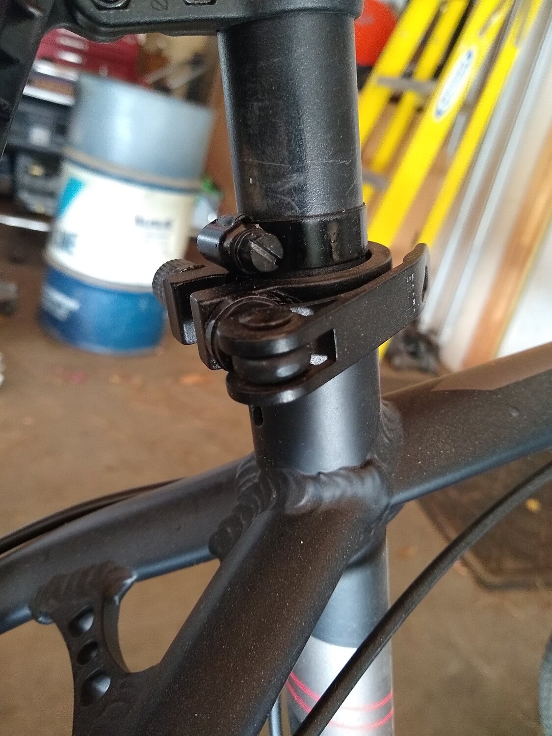

I need to raise my saddle. I have a Lectric type bike, and the post is locked with one of those locking levers. I did it today, super tight, as tight as I could make it, and eventually, the saddle slid down.
I'm sure I could come up with a home hack, but, what is the Proper way to deal with this. Ideally without replacing parts, because I have a long ride coming up.
Is there something tape of or other stuff that can be put on the post that will make it less likely it will slip?
Thanks.
Firstly, ensure the clamp is rotated so the lever / bolt line up with the section of frame that has a split - ie max clamping efficiency.
There are products designed to help the post grip - search seat post paste. Rather than buying a tube, see if your lbs can apply some for a suitable donation? They are a carbon based grit.
If that doesn't work, try a better quality clamp.
Everything PDoz says PLUS:
I think you have a 27.2 post. I've found they do tend to slip some. Two things:
1. After tightening the lever, then use your multi-tool and tighten the "screw" another 1/8 turn or until it stays.
2. All else fails lose some weight 😜.

PDoz - I lined those up, gave it one more turn of the tightness knob, and then brute forced the clamp closed. Just finished an 8 mile ride with no movement.​

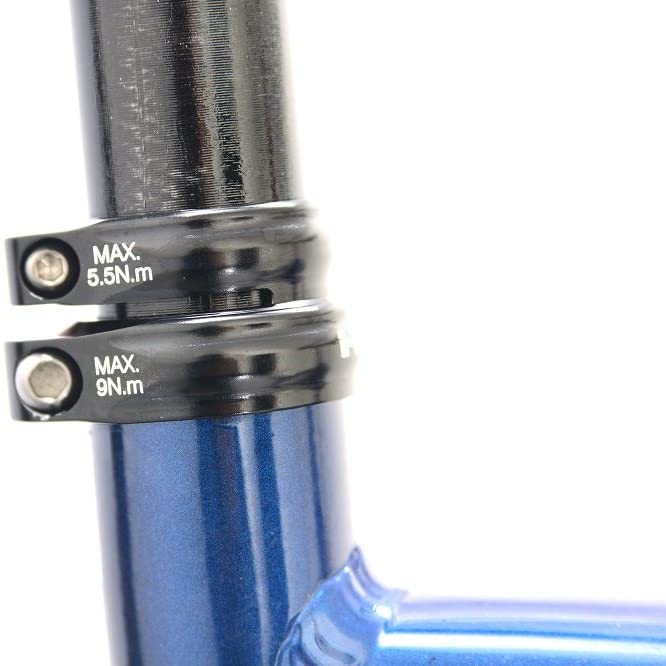

I found the best way to lock a seatpost down is to use a double post clamp. One that clamps to the frame as usual, AND the seatpost.
The one I am linking is the pricey one. I have used this one and cheaper versions that you can find on Amazon and Ebay.
I needed one of these due to a slightly oversized, out of spec seat tube on a frame. It worked so well I try and use one on every bike I have built from that point forward. These things were originally intended to provide kinder/gentler clamping on carbon fiber frames and posts. But they aren't limited to them.

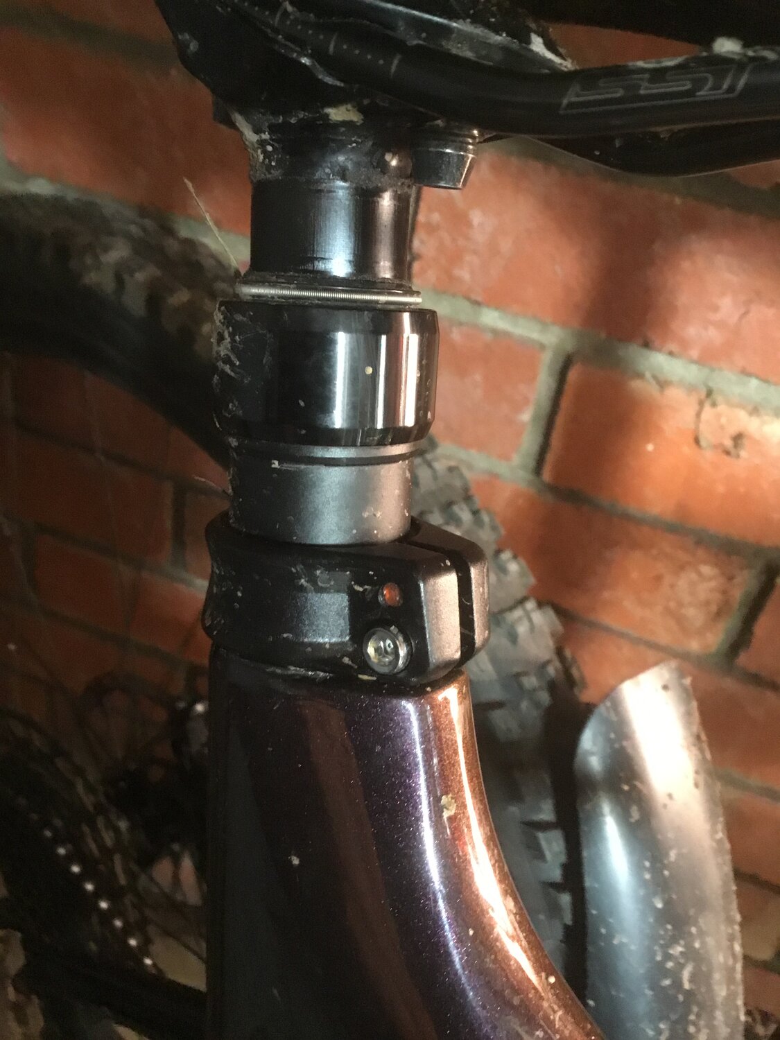

I particularly like the one on my sons giant - twice as thick as normal, two allen keys to spread the load

Take a look at that picture I posted of that double seat clamp. Scribed on it is a torque specification of 5.5Nm. Thats unusually low but the typical range is 6 and at most 8 Nm. Thats 4.4 to 6 foot pounds (i.e. almost nothing). I know on the surface it may seem counterintuitive but you really do not want to tighten the bejesus out of a seat clamp. If you follow that link and look at the first review, thats my green bike. Read the review and you'll see I sheared the bolt on that clamp as it turns out the torque spec on that clamp is over-stated (others report the same thing in other reviews). On others (entirely different design), I have farmer-tightened them and bent the ears together (I'm a big guy and mistakenly thought more tighter was more better). That can compromise the whole clamp or worst case even the frame; especially if anything is composite. I even cracked one seatpost clamp come to think of it.
Since I've had those learning experiences, I have done a couple of things:
1) Greased the seatpost lightly prior to installation as is typically recommended. As counterintuitive goes, this was all that! I know it sounds insane, but read directions on seatpost assembly and its a common item.
2. Stick to the torque spec (which means using a torque wrench at the get-go). Trust it, and it works. If it doesn't something else is wrong that needs a solution.
this. the people who design these things for new bikes aren’t idiots. they work. and a properly specified fastener with a torque spec, torqued properly, will not slip when used within design limits! i too used to be in the “hand tight plus a bit” camp, but am now firmly on team torque wrench. I also avoid all fasteners which can’t be torqued precisely.
Tomjasz was talking about the difficulty achieving normal seat clamp tension due to arthritis - ie I wasn't advocating crushing frames or seat posts. As per my first post, my bikes are carefully assembled including seat post paste ( and these are dropper posts in carbon frames - hence the lovely clamp on his giant reign)
