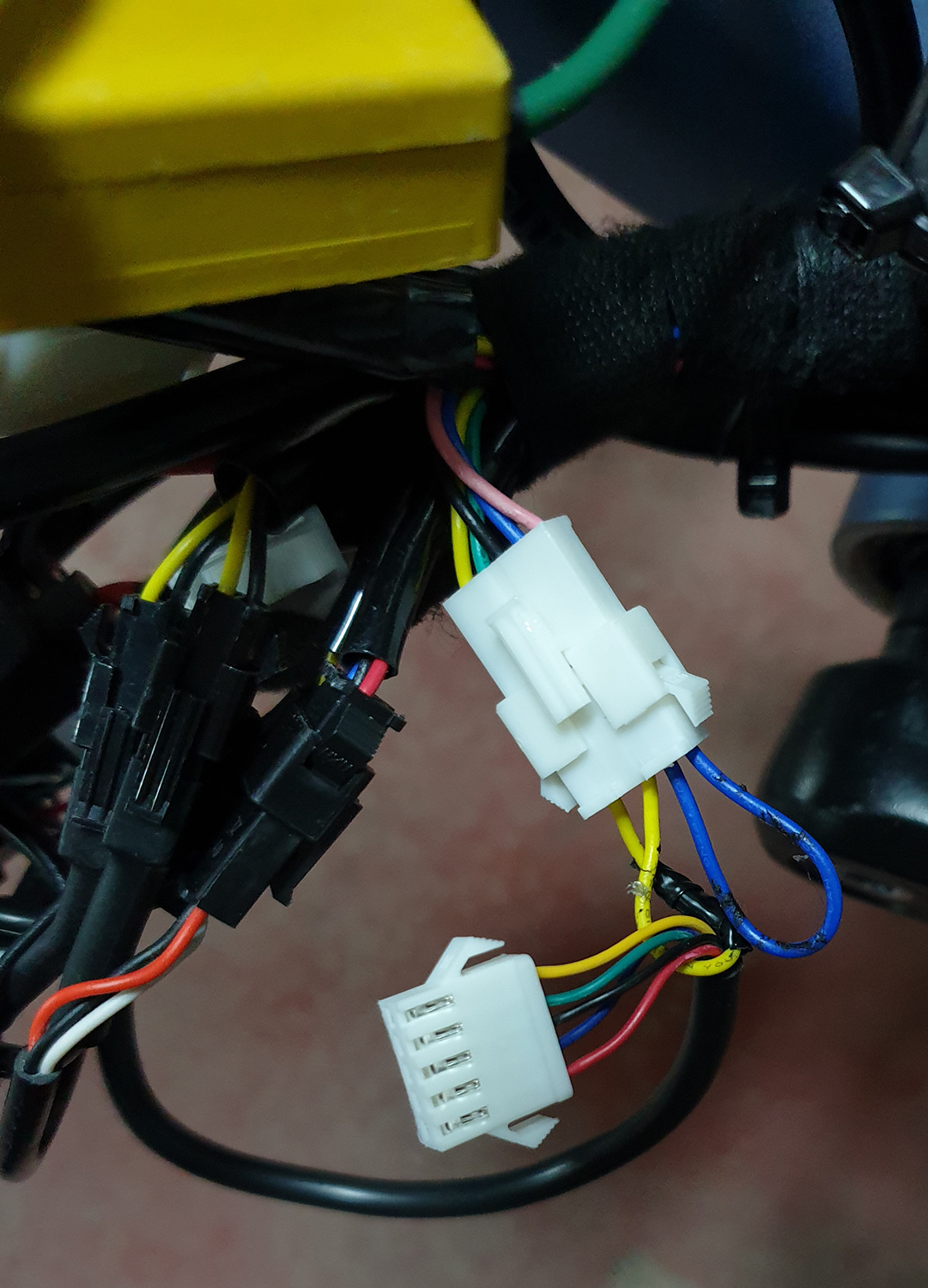

The bike won't run, but does the display show anything or is it also dead?
If it isn't working, it could be a faulty display. In that case if you can grab hold of a display by-pass like the one shown on the attached photo, you can try and have the bike running again (just as a test), because you will only have a throttle and brakes, but no light, horn. If the wheel turns you know you need a new display. One word of caution though... The dead display could be caused by other fault in the system and installing a new one could get damaged the same way your first one did..
