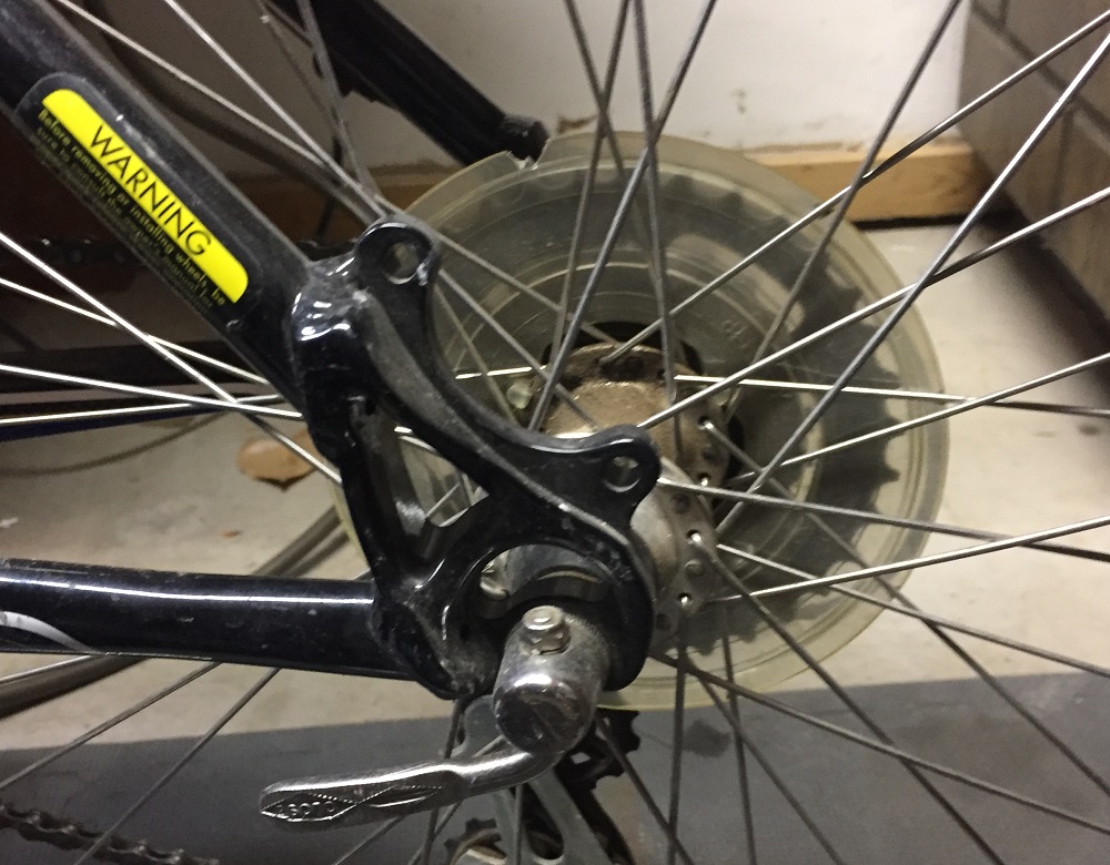

Attaching photos of my left and right handlebar "pods" as well as the front and rear caliper mounts.

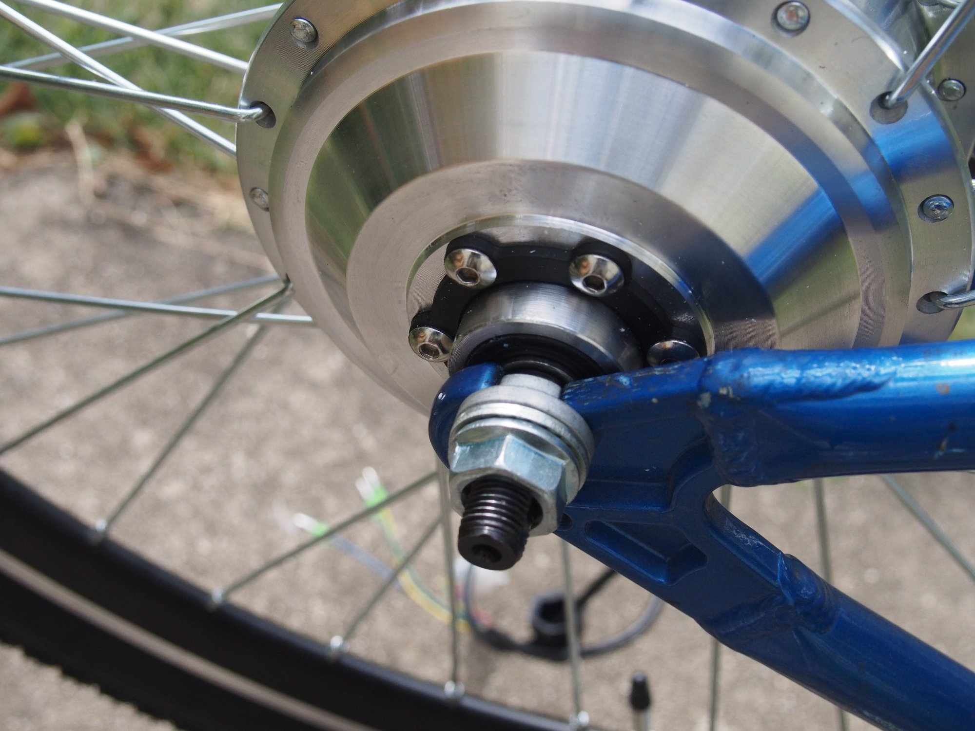

That rear drop out looks a bit holey. Better include torque arms. So you're going to put a 15 pound motor in the rear? I've yet to install a heavy motor. Mostly 5 pound and 8 pound motors. 250W and 500W. Never planned to compete with cars.

I've got torque arms, and my motor is in a steel fork on the front. I made them out of bed frame rail. The advantage of front motor, I have an 8 speed 11-32 rear sprocket cluster with SRAM derailleur. Hub motors come with cheap 7 speed 14-28 clusters. The country of origin indicates to me the steel is probably soft. 28 is not big enough to climb 15% with 60 lb supplies without the motor. 14 is not tall enough for me to help the motor over 12 mph. 8 speed freewheels won't fit the rear fork, I bought 3 and neither sun nor shimano provides dimensions much less the ****ese suppliers on ebay. I could never find a 11-32 7 speed freewheel in stock anywhere although they are in catalogs. So I changed from the rear DD motor to the front geared hub motor from ebikeling. He no longer sells 48 v geared hub motors.

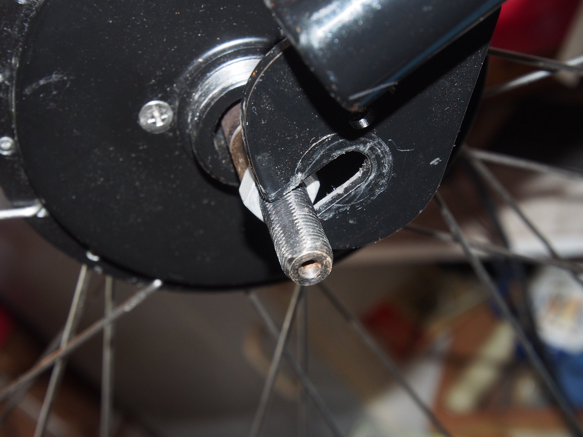

Your dropouts don't look strong enough to support a big motor.
The first pic is yours, showing how they cast the frame with air around the axle. That's a 10mm diameter axle if your didn't know. A motor axle, shown in the second pic, is 12mm x 10mm. If the space is limited, as in your bike, installers often deepen the slot by 1mm so that tit remains centered, and the axle nuts fit in the same place.
I don't think you have a lot of room. If it were my bike, I'd pick another one. I was in this exact scenario with my first one. I posted that 3rd pic in August 2015 showing the progress of my first install an an alloy frame diamondback. Was advised to get torque arms.
I changed to a steel frame Trek that I also owned. Glad I did.

And that rear axle mount looks sketchy.

You make good points with your comments about the strength of the frame. As far as the cost issue goes, yes, I know the battery is the most expensive part of the conversion.
