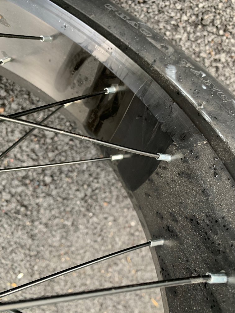

Check out the seam on my rim. Is this normal or the start of a problem? Thanks.
FrankR Active Member Region USA City Milky Way Galaxy May 28, 2022 #1 Check out the seam on my rim. Is this normal or the start of a problem? Thanks.
fooferdoggie Well-Known Member May 28, 2022 #2 looks like a button rim. even decent rims can be butted and to welded.
harryS Well-Known Member May 28, 2022 #3 Two kinds of rims, welded and pinned (button). The latter will show the seam, while welded rims get the joint machined and cleaned up. Here's a dirty job where an operator has to run a bending machine,
