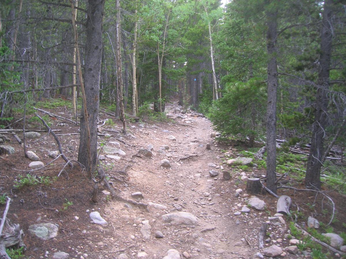

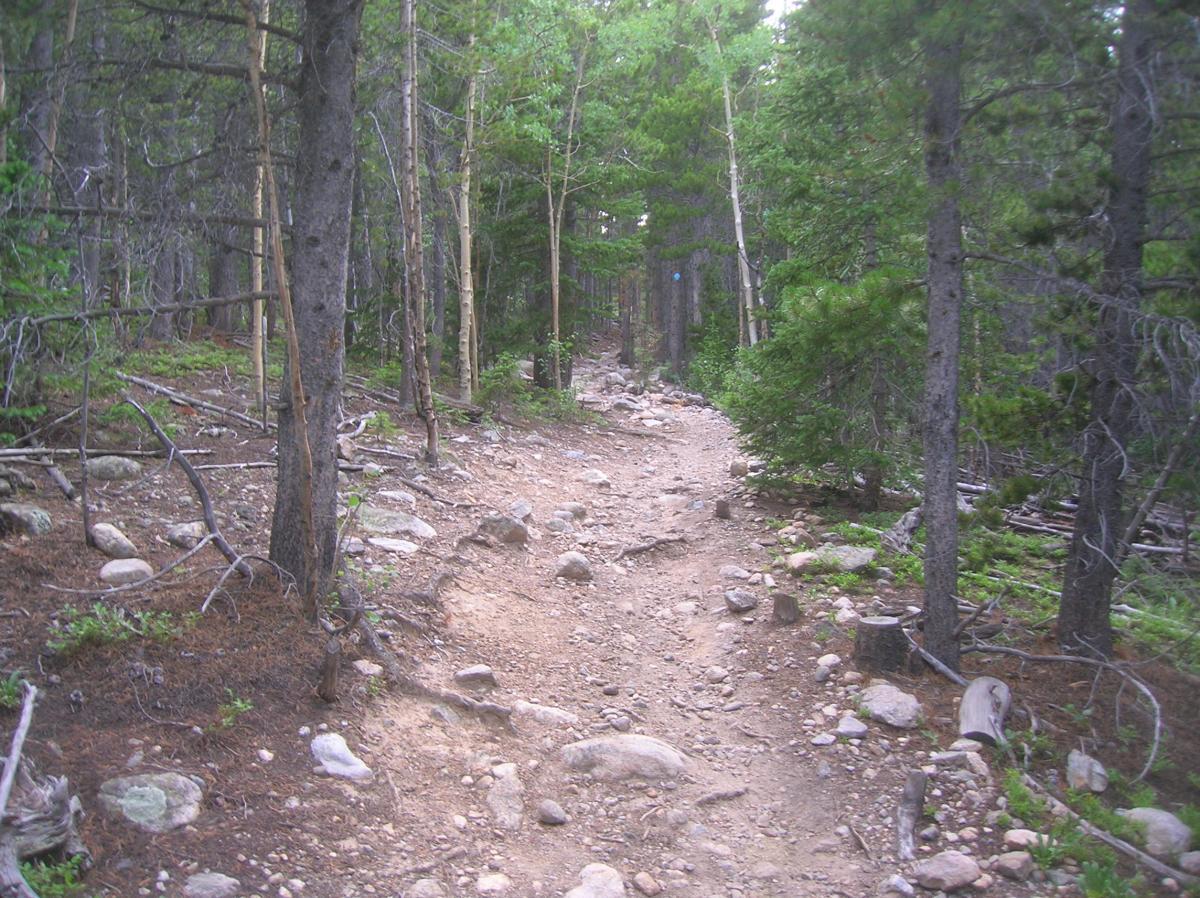

Here is a pic from sourdough trail near brainard..., this is a 'mild' section. Sourdough trail is BRUTAL. Its an out and back trail but I always just do the other half on the road.

Is that what the Sourdough looks like in the summer!? <kidding> I x-ctry ski it in the winter, and wear a helmet because I've fallen, hitting my head on those rocks. My plan was the motorized Forest service roads.. like going up to Rainbow Lakes trail head, which sometimes looks like this, just wider!

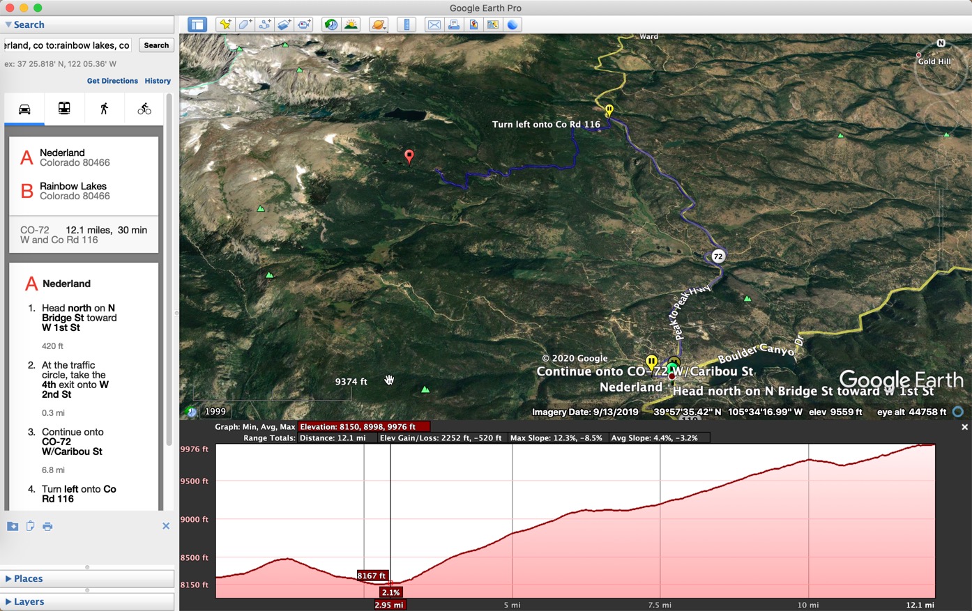

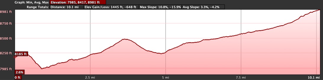

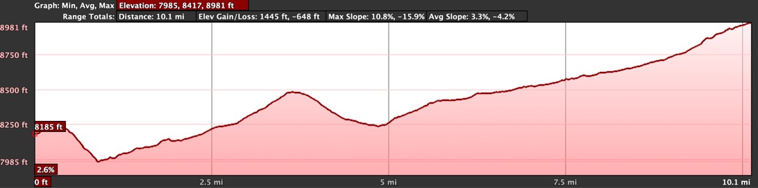

Look ma! I learned how to add images!
My reason for adding these profiles is that I don't know how to compare my hilliness to your hilliness around the country. The awesome upgrade is that a 2000 foot elevation gain over 10 miles is the same performance anywhere , whether its VT, PA, CA, or CO - these are electric bikes, no carburetor!

I did xcountry ski sourdough 'once' thinking how fun it would be to do on skis after MTB it after moving to CO. I gave up on xcountry skiing after that and just stuck with downhill skiing.

FWIW, that trail is hard to capture in pictures. Its simply BRUTAL I doubt you could take more than a mile or two of it before stopping to rest due to mental overload. Its very demanding technically and just never stops, every single foot requires top notch mental technical ability. Maybe its gotten easier since I last rode it in 2007 (recent youtube videos look ALOT easier)

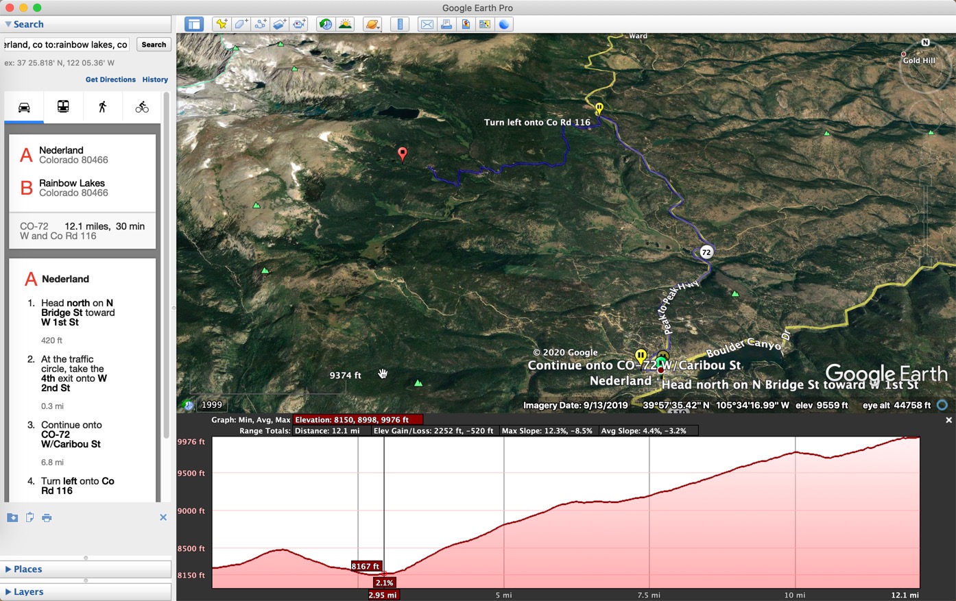

To the OP..I used to park in nederland and ride up caribou road till the trailhead and then take 128J/Forest Road 505 back. Forest Road 505 was just insane, I usually stopped 4 times just to rest (going downhill). I also did this on a honda xr400 many times.

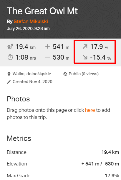

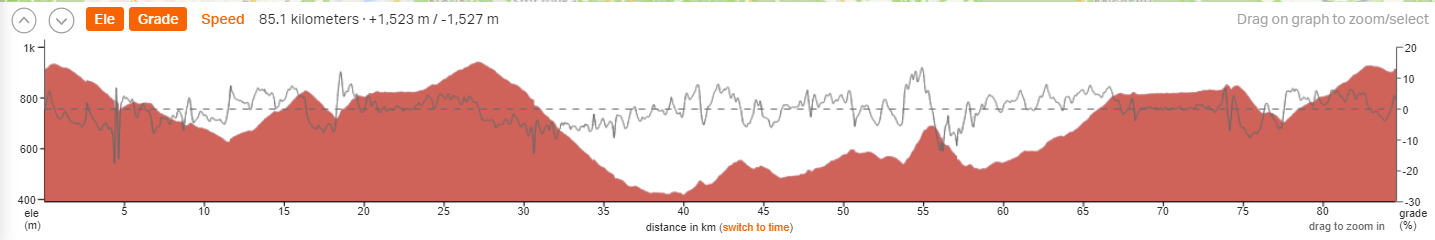

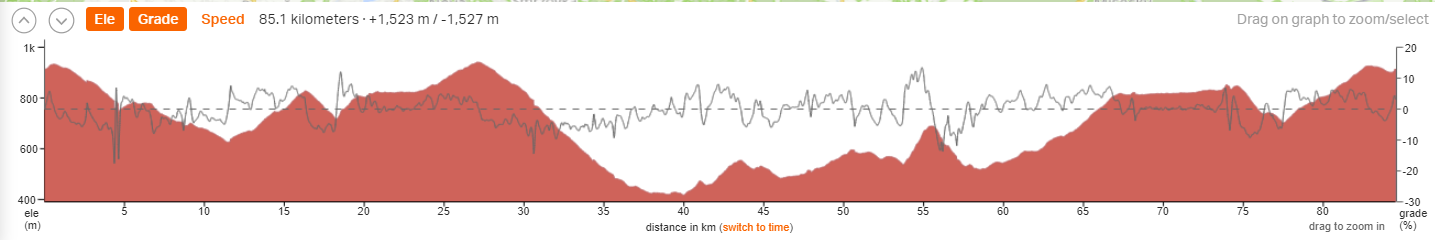

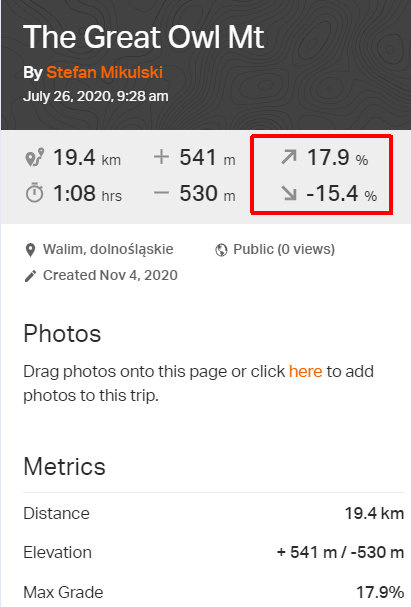

See this terraunbound:
If I -- with my ill legs -- could do the 17.9% grade climb on the Trance E+ 2 Pro, it simply indicates anyone could do that. (Your maximum grade in your example was 12.3%).
That trip was for 50 miles with 5000 ft elevation gain, mountain roads. My Vado 5.0 (mid-drive motor e-bike) could do it; my Trance E+ Pro ridden by my brother was even more suitable there.
Yeah - that's what I'm aiming for (Caribou Road)... not 505, its no fun even on a dirt bike and getting worse every year with no maintenance. You still would recommend mid-drive? because a hub-motor would ... (fill in the blank please? )
To the other guys adding to this...sourdough trail isnt really steep, its just rocky and technical......forever. Trust me, you 'will' take the road back as opposed to the same offroad trail twice
I would feel comfortable taking a hub-drive up caribou although I havnt ridden it in over 5 years. Im not a big fan of cadence only assist (like the radrover). YMMV
The thing with hub drive is...as you get steeper, you need to put in more human effort. I have ridden my Juiced CCX easily up 15%grades(1/4 mile) and up to 30% (limited distance..300ft) but with the realization of its limits. I can ride up 6% with a headwind at 24mph for a few miles on my juiced CCX without overheating.
With mid-drive, it just doesnt matter, I could ride my Bulls eBike up a 15+% grade till the battery died with no worries.
Would a radrover get up caribou road..most certainly, as you increase speed (maybe), increase speed more, probably not
If you are certain to stick to gentle slopes like that, then the lower end mid drive bikes should be viable - think giant stance rather than trance.

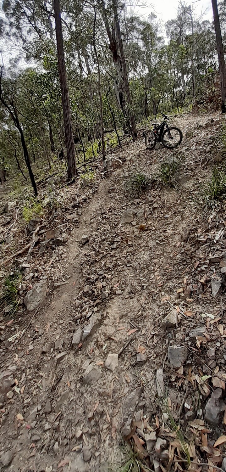

BUT - you mention scope creep. These bikes are incredibly capable and if you come from an off road motorbike background it's amazing how much of your motorbike riding can be replaced by a decent dual suspension emtb.

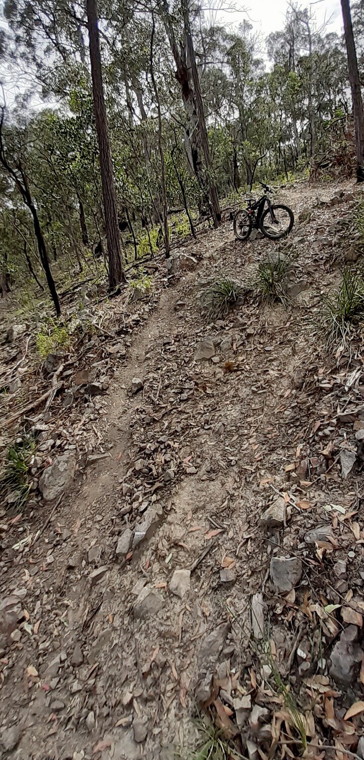

For perspective, this trail climbs 260m in 1.9 km ( 850 feet in 1.2 miles - 4x as steep as the trail you linked) . It was a stinking hot day but I only used 300% assist ( my giant pwx can do 360% , but I tend not to use that because it's hard to keep the front wheel down) . My bike is a 2018 giant, only 11 speed and the geometry is closer to the stance than the trance- although the suspension is closer to trance quality.
I come from a ( dirt) motorbike background but have been using normal mountain bikes for about 10 years. I've barely ridden my motorbike since buying the giant.
That pic defines " walk mode " .
