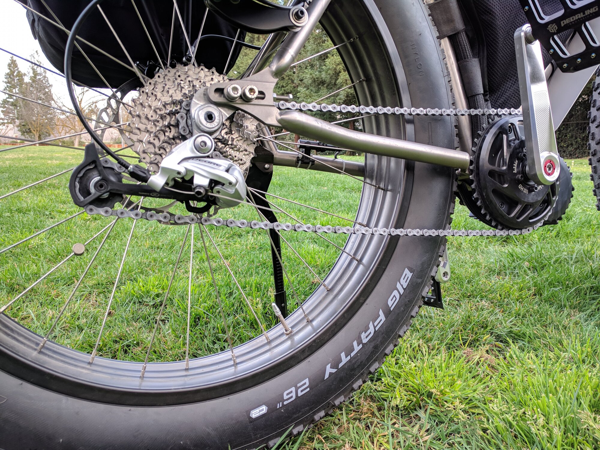

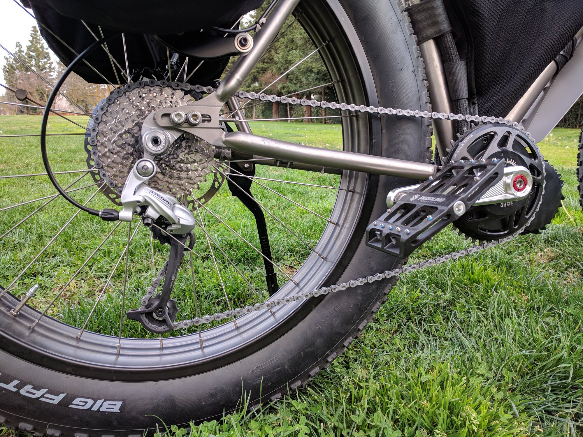

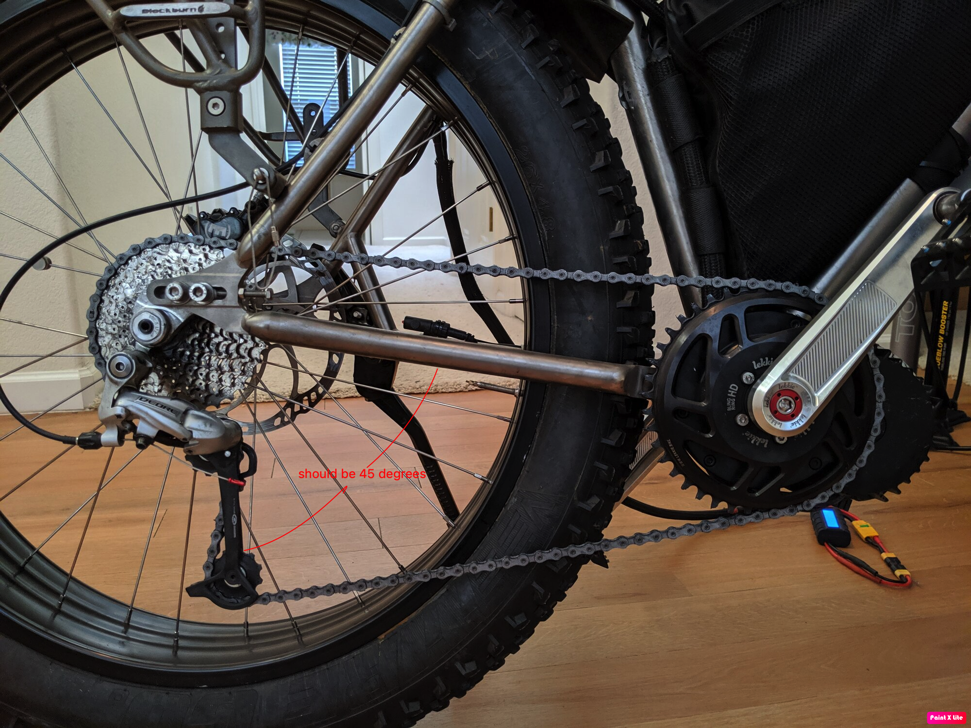

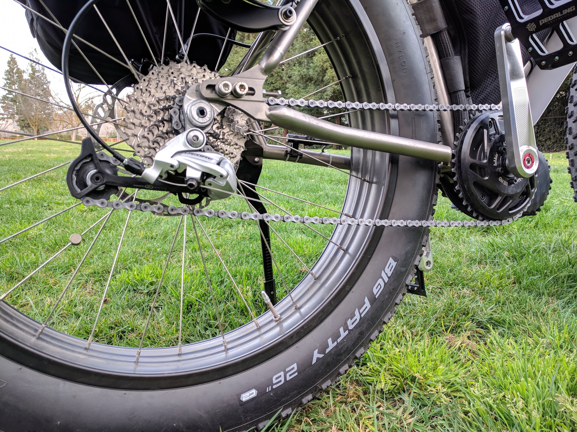

Worth mentioning: Measuring chain length on a 1x drivetrain is simpler than most chain length guides lead you to believe. You need to size the chain to the smallest cog. The biggest one will take care of itself. That is true because if you size it right, you make the chain as long as it can possibly be when you size it to the small cog, and in so doing you let the derailleur cage do its job (which is to wrap excess chain). On the smallest cog, that derailleur should be one chain link less than loose. As in just enough chain tension to be taut. Do that and the rear cage is pointing backwards on the small cog.
Here are examples, small cog and big one; sized properly.
Its not uncommon to see the derailleur cage pulled forward on the big cog by someone who has sized the chain too short. Doing that pulls the internal derailleur spring harder than it needs to be pulled, and is just the wrong way to do the job.
Here is a full description of the process with tools and pics.
And here's a video cue'd up to the chain cut/sizing job. Jump to the previous chapter to see how to re-route the newly cut chain, and the one following it to see how to connect the chain.

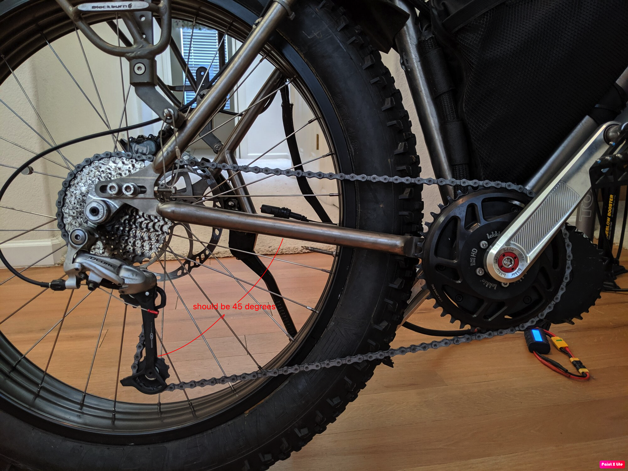

And why my Aventon was such a joke when I got it chain-wise. At the smallest cog the derailleur was at about 120degrees, and putting it into 8th pulled it forward so tight it was bending the derailleur mount.
Something made all the more suspicious by the fact the bike came packed with a spare mount. Never seen that before. I ended up using the spare even though I straightened the original back out, just because bent metal == weak metal.
So you're saying this dim should be 30-45 degrees at small cog to small cog?
Looking at my bikes, I suspect it more like 90 degrees large cog to large cog, and 135 degrees large cog to small cog... But what do I know... I've never played with chain lengths...
In an ideal world, yes that is correct. Specifically, the rule of thumb for perfection on the big cog is for the top pully in the cage to be a bit forward of the bottom pulley. So by that measure, the above is a little too short... but as I mentioned above, with a 1x drivetrain the big cog is what it is because if you do the chain length right (using the small cog and just-enough tension on the derailleur cage), thats as long as it can get, period. So the big cog takes care of itself.
The video above does a good job of displaying this visually in real time.

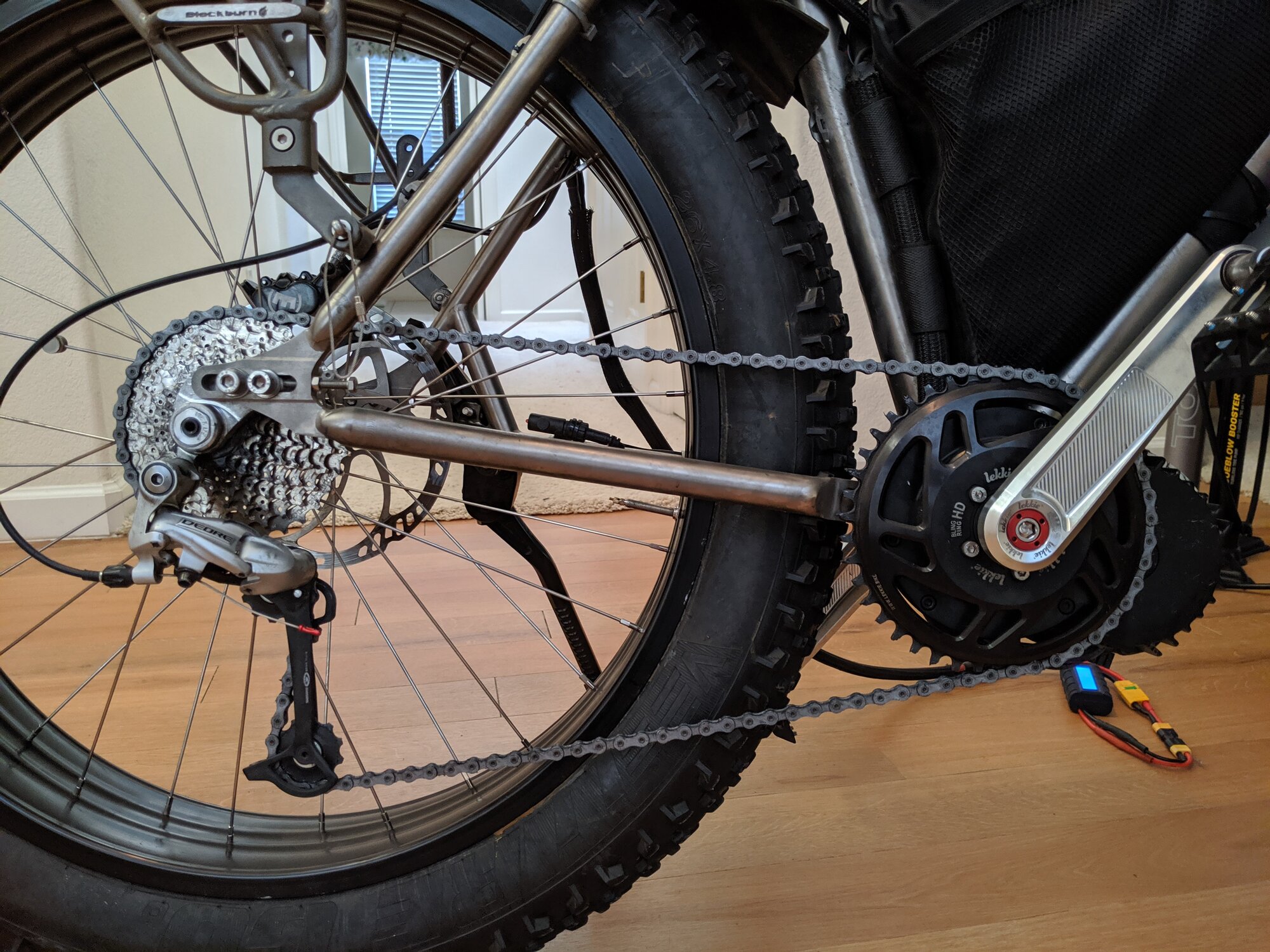

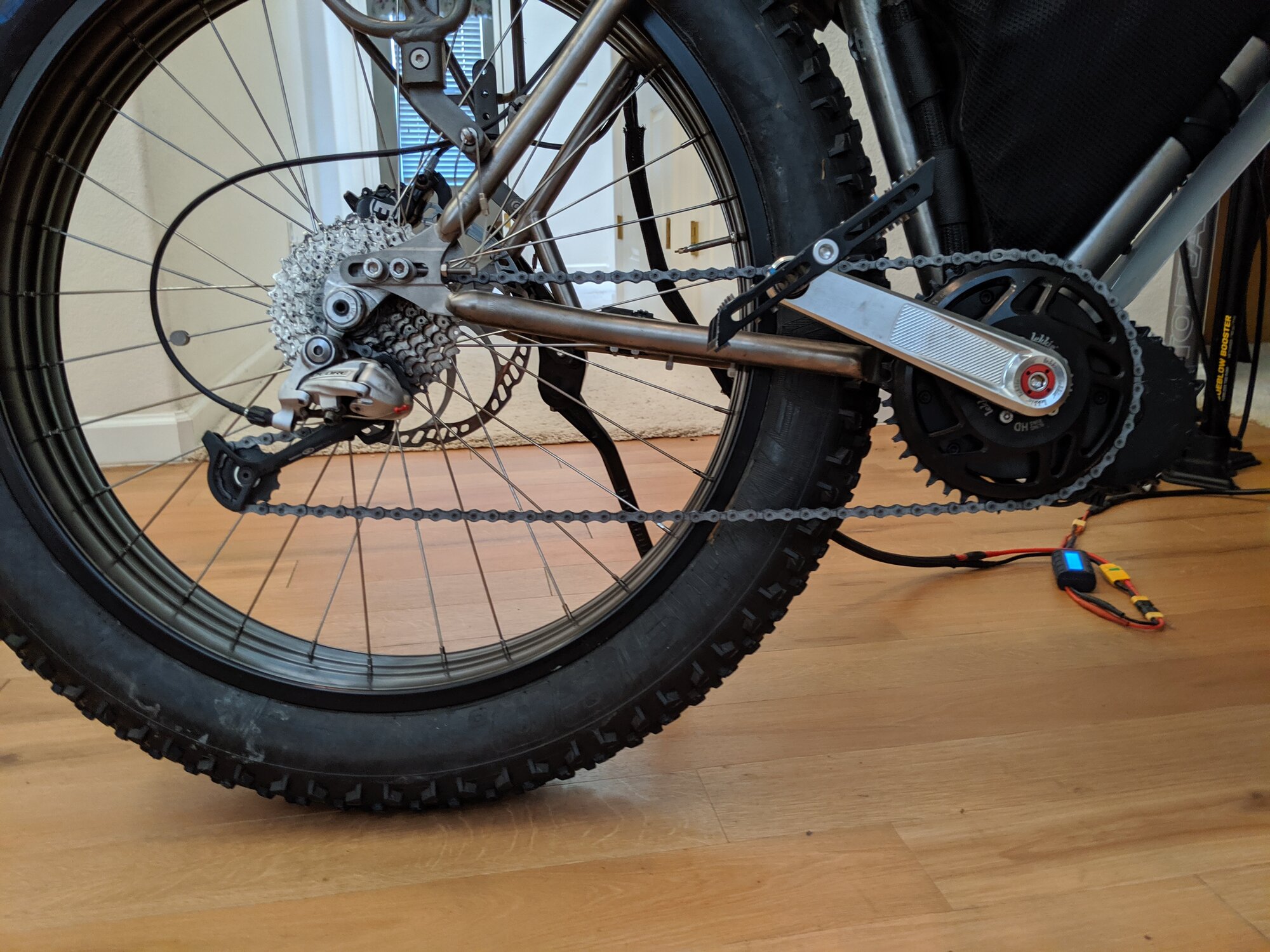

But this can happen: The two pics I showed you were my final length on that chain. Here is the textbook, perfect length on paper per the instructions I linked above, and it was my first try:
Like I mentioned above... top pulley just a bit forward of the bottom one. Visually, its perfect. But look carefully at the chain in the left pic. Its got a hair of slack in it. It rode great EXCEPT when it was wet and I was running 1500w of BBSHD on the 11T cog. The issue was the wetness of the ground coming up and slickering up the drivetrain just enough to cause a skip at full tilt. So I took two links off to increase the tension and it has remained like that since 2018 when these pics were taken until a couple months ago when I put a Box Two super long derailleur on it along with a rear cassette that goes up to 42T instead of the 32T you see here.
The above is the only time I have gotten bitten by a tolerance that is so close I had to lose a link. After these pics were taken in 2018 I did move the sliding dropouts forward to eliminate frame flex (an issue with titanium frames) and it took the cage back a little further, closer to the original, as a result.

Its really common for manufacturers of budget bikes to put the chain too short. Thats part of why so many people who are new to bikes think the cage angling forward isn't a problem.
