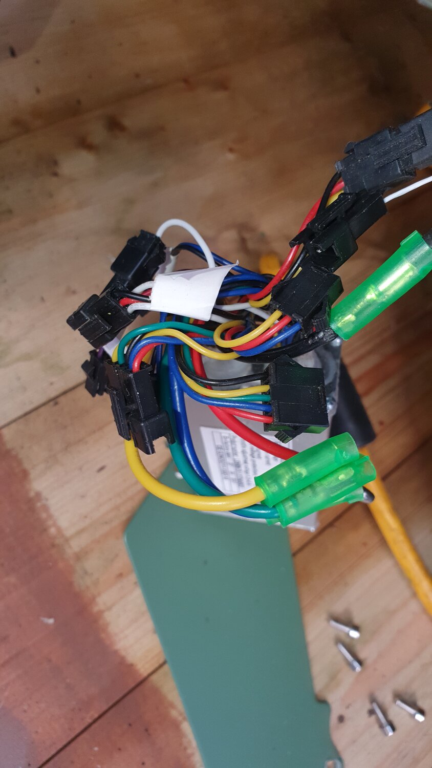

Do you have a picture of your controller with wires / connectors on it?
If you don't, I'm asking because I'm wondering what you need to replace, depending on what connector you have.
Specifically, what kind of connector do you have on your:
- Battery (I'm talking about the connector that goes to controller)
- Motor inhibitor on brake
- Display (You will very likely need to replace this anyways, since your stock display doesn't do much and won't be compatible with the new controller)
- Cadence sensor (Your bike has cadence sensor yes? Not torque sensor)
- Motor (usually Z910, Z916 or L1019)

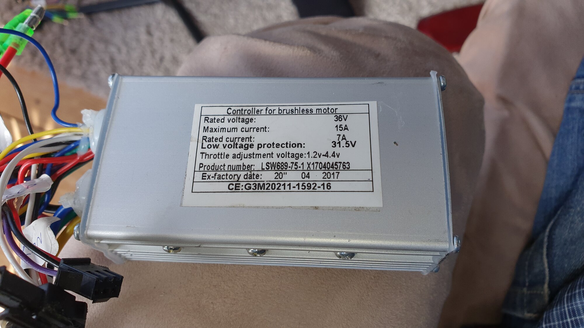

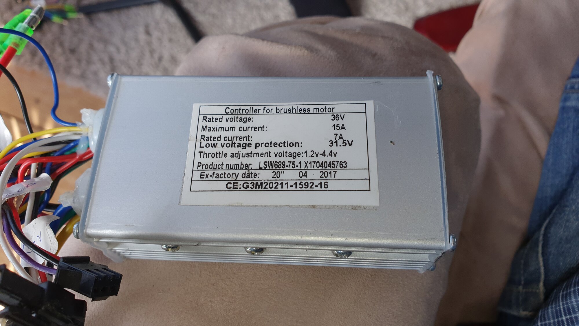

Hi
Thank you for your help and explanation, that makes a lot of sense and I will consider upgrading the battery in the future.
As requested I have attached a picture of my controller (I hope this will suffice) any additional help explaining how you go about fitting its replacement will of course be greatly appreciated.
Thanks again,
Les

Hi
Thanks for your detailed response, I will attach a picture of my controller in the hope you could advise me re it's installation

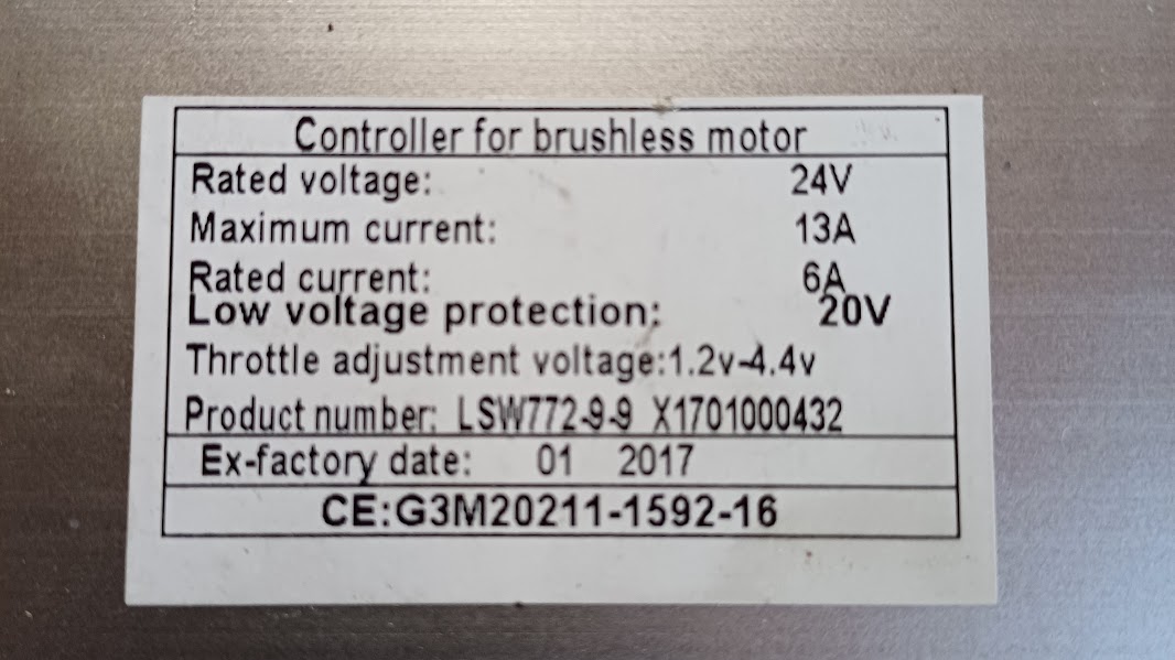

Greetings from Finland. My bike controller is broken. Where can I buy a replacement!
Hi
Thanks again,
Les
Hi
Thanks for your detailed response, I will attach a picture of my controller in the hope you could advise me re it's installationView attachment 119309
Attachments​
Attachments​

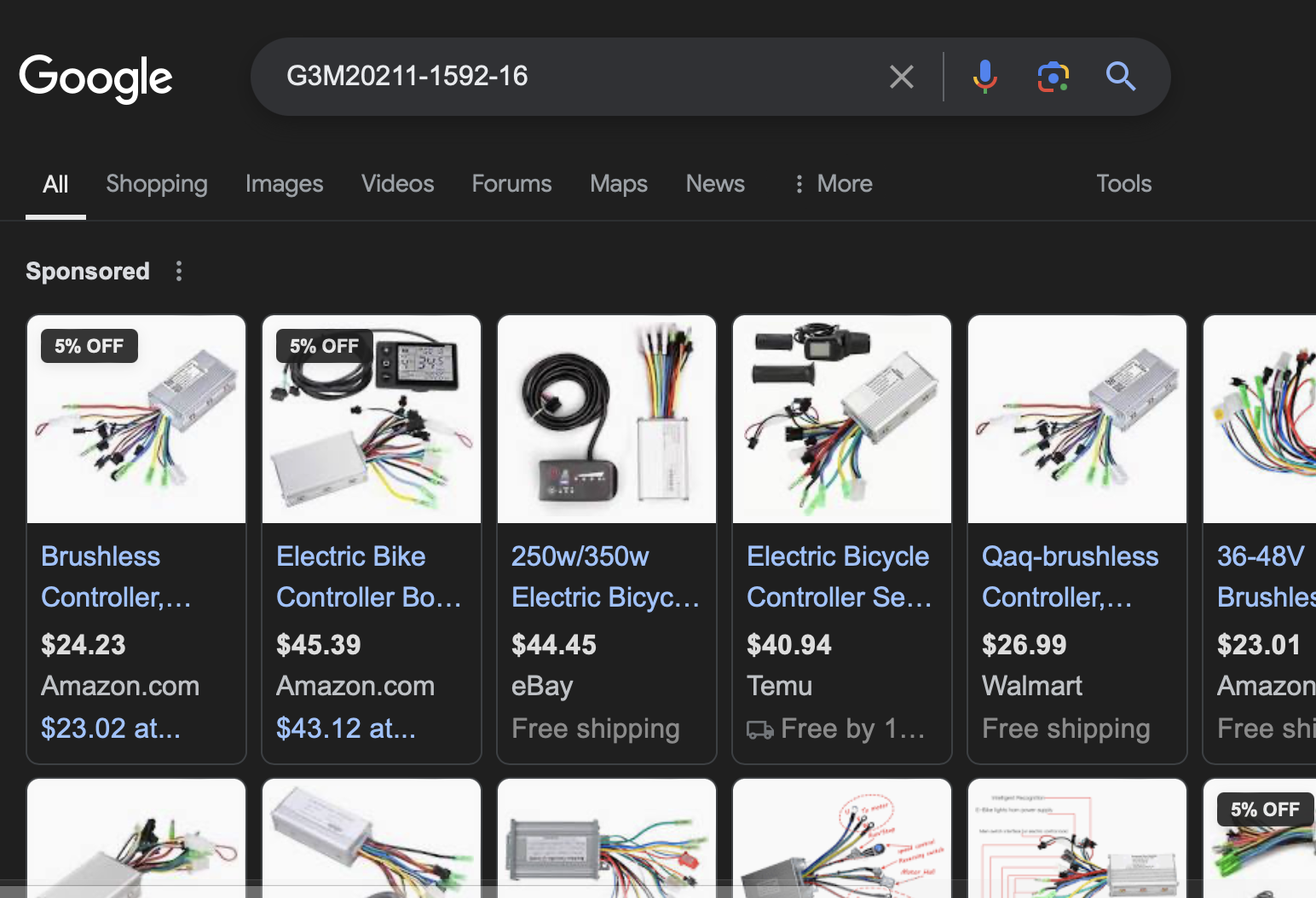

use Google, I just entered G3M20211-1592-16 from your photo in a Google search and got many hits.
