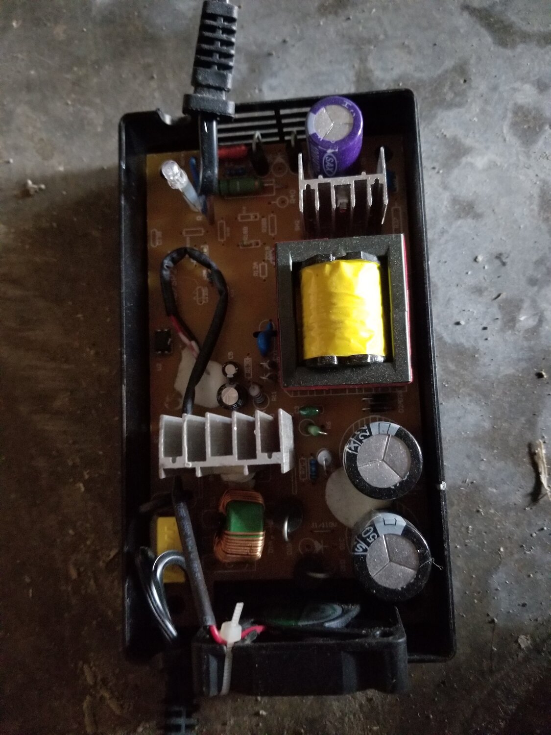

Here is the charger
Ok some success. The batteries work. After fiddling with the wires under the seat, it powers on. Moves forward, left turn signal works, headlight does not, right turn signal doesn't work. Not sure if the charge will work until this charge wears down to nothing. There is some wiring work I'm going to have to look into. Does anyone know where I can get the manual online? I have searched for 2010 Gio but the models I have seen don't look like the one I have.
That is a switcher supply. Unless the power cord is bad, they are not generally repairable by amateurs. I can't do it.

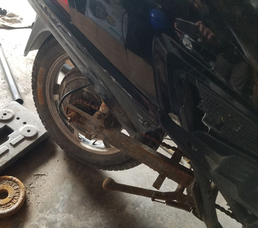

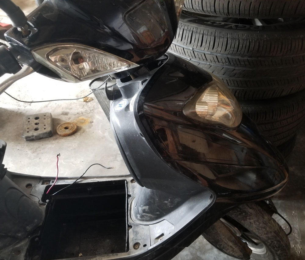

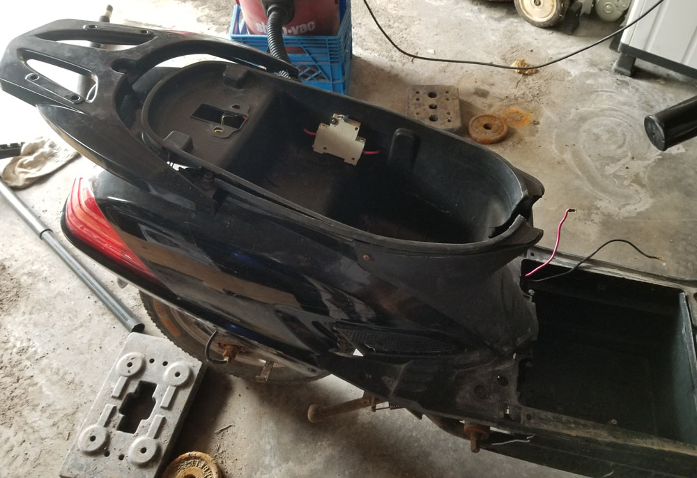

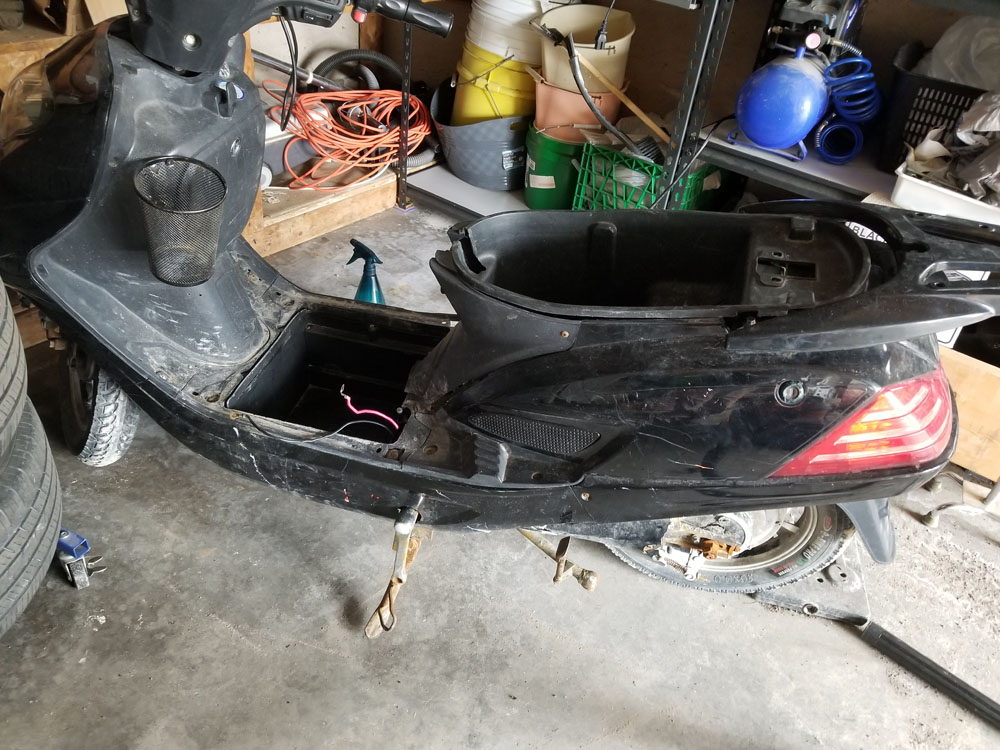

Here are some pics
You shouldn't need to pay $40 to buy a small charger for a 12 v lead acid battery. You should be able to buy generic chargers for about that. Only if the charger works on a stack of 4 batteries would there be anything special about it. 48 v lead acid chargers would have a different cut off voltage than more common 48 v lithium ion battery charger.
Yeah, I am not sure what to look for on Amazon, but I will start the search tomorrow. But before that, I just realised I have an outlet tester that I can try on the female end of the charger when its plugged in to see if current is getting through. I will try that tomorrow.
Ok tested the charger (female end} with my electrical outlet tester and the tester does not light up. Outlet tested, works fine.
I think the charger might be caput.
An outlet is AC, charger output is DC. I have no idea what you electrical outlet tester is, but a chance it won't work with DC.
