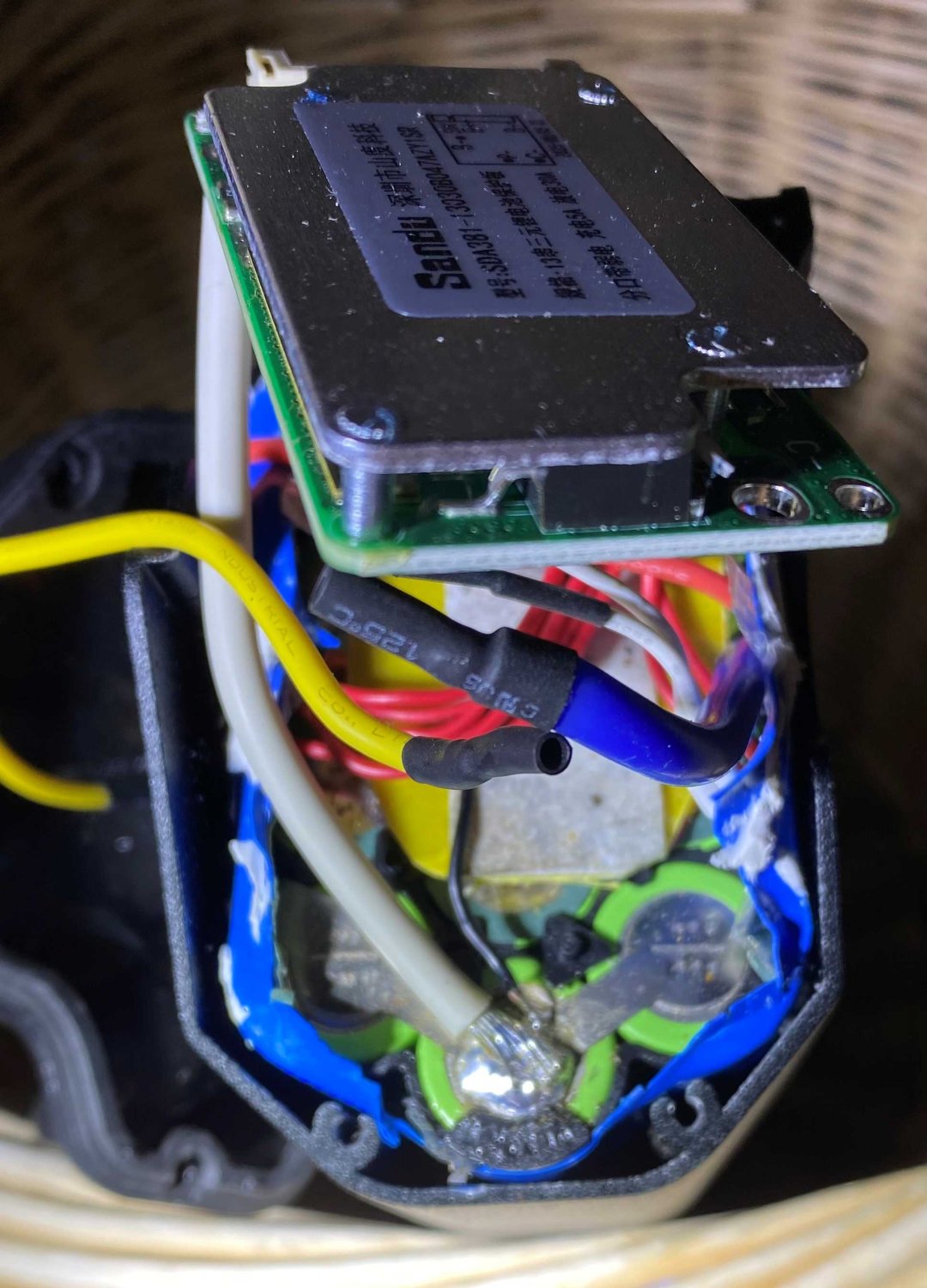

Hi All

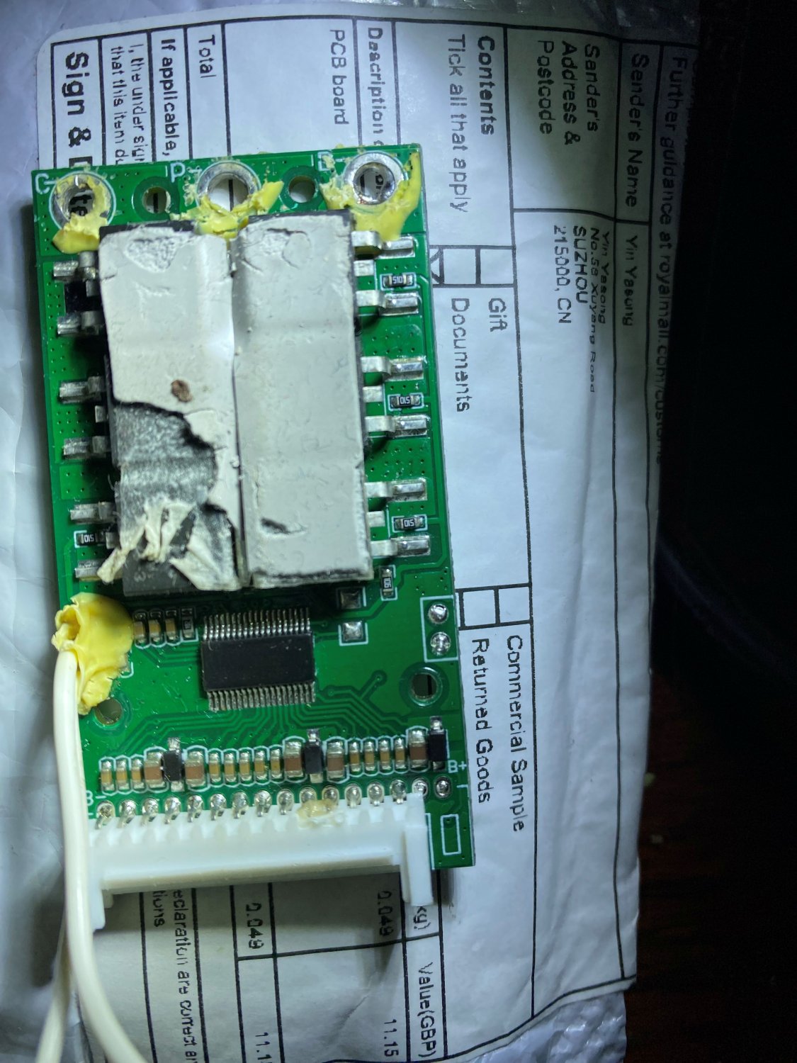

I managed to find a second one of these at a reasonable price with a failed BMS. All cells check out well and case/plugs/ancilliaries all useful but struggling to find a new BMS.
Not only this, but it appears that my wiring is unusual in that i have a stout wire coming direct from positive on end cell* to the original board, whereas all boards i can find all use Negative for all 3 main connections, i.e. B-/P-/C-.
I'm reluctant to unwrap the cell pack just to run a new negative, and there's precious little room in the case to run internally (and safely).
I hope anyone who's worked on these, reads this - Thank you in advance.
*EDIT -- WRONG!!!! - i now realise that it is correct, and it's the negative (doh!)

Can you post some pictures of your BMS?
I've got three Reention Dorado batteries, and I've removed the end caps on all of them, but didn't want to try and remove the cell pack to check out the BMS.
One of my batteries is a proprietary Das-Kit battery that may have that unusual wiring as well?
And,.. you might be able to find a part number or code printed on your BMS that you can enter in a search to find an exact replacement.

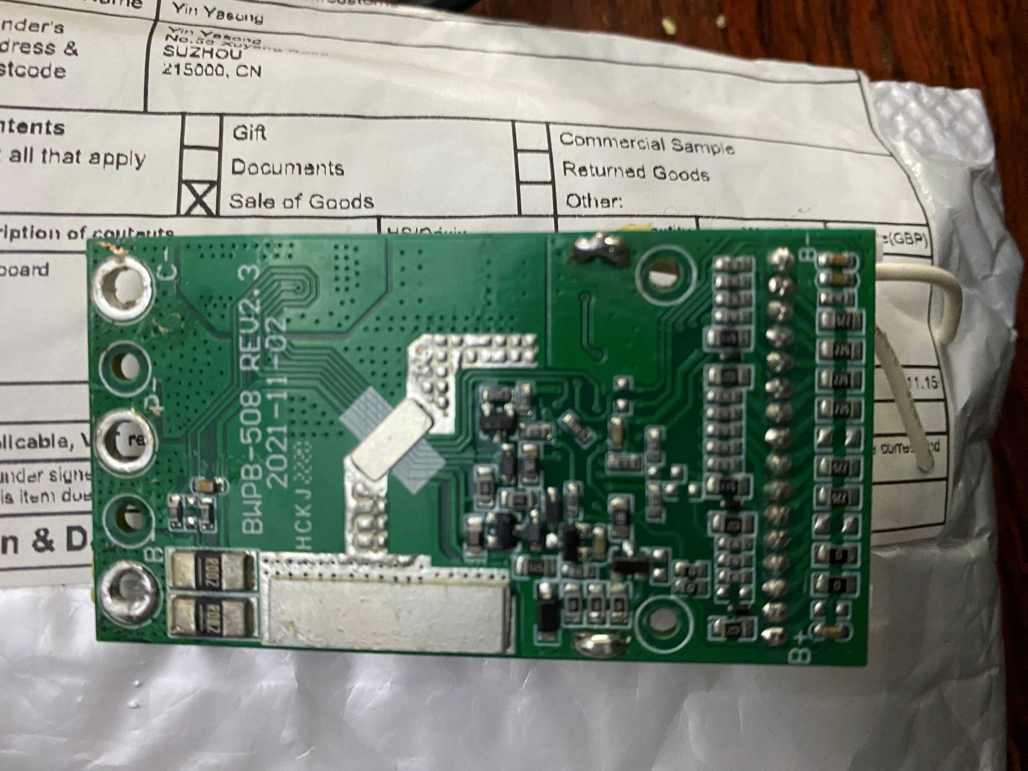

Thank you for your reply, it's helpful to know i'm possibly not the only one. I did try and track down the BMS part number but with no luck. It is a mystery because looking at the nomenclature on the original BMS, all 3 connections are clearly marked "-" (minus) and so i obviously copied this initially before looking at several wiring diagrams which didn't tally with my battery wiring. I will post some pictures of the original BMS soon.
Yeah, those Dorado cases are incredibly cramped. The issue is that most generic BMS units use low-side switching (negative), while the original setup you've got there is different. If you can't find an exact Reention replacement, you're pretty much forced to rewire for a common negative BMS, but like you said, safety and space are the biggest risks there.
I'm sure you are right, although it's a mystery as to how the original BMS ever worked (as explained in last post) with all 3 connections showing "minus" on the board, i now need to re-wire my battery connection according to the majority of diagrams i've looked at, in the hope that this will work.
Did you trace out the wires from the BMS to the cells?
I wouldn't go by the BMS markings alone.

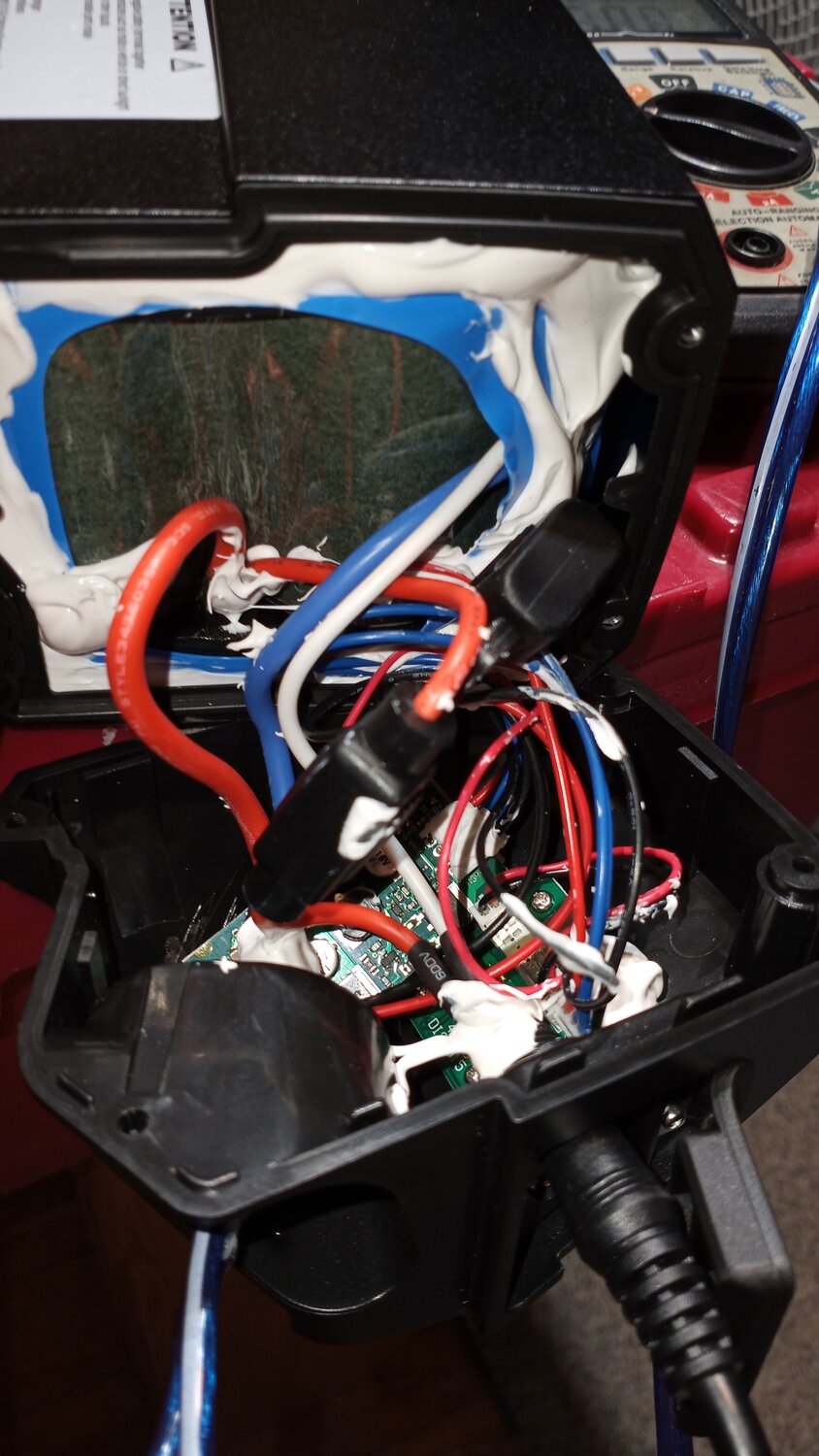

I am struggling to send single pictures to my PC (which is my only connection with EBR at the moment) but i will try and login on phone in the future. I still haven't solved the main mystery - i.e :- why my BMS is connected to the POSITIVE end of the ganged battery pack (all my studying of conventional BMS wiring indicates that the 3 main connections are to Negatives) but also how the hell it worked because the original Reention BMS that came with the battery also indicated only negative connections on the circuit board, something that failed to dawn on me while i was removing.
Not having a good experience at the moment as it looks as though my 2nd controller has just failed. I got caught in the rain two days ago but managed to cycle home around 10 miles with no indication of a problem until i looked today to find the voltage display indicating virtually nothing (3 volts) despite a confirmed fully charged battery that would normally show around 41 volts. After hours of fault-finding by swapping each item and cleaning all relevant connectors, a controller fail is the only thing that makes sense. The inability to confirm this, only got compounded when i went to use the old controller to see if it would shed any more light. Well, it really didn't because it showed IDENTICAL behaviour despite me thinking (memory wise) that originally it only partially failed originally due to an inability to pick-up/accelerate smoothly (the swap to the new one eliminated the problem immediately). Talk about a head-scratcher. I can only assume that this is the most common fail that happens to controllers despite me covering over 4,000 miles with little to no problems at all. It has me baffled and am loathe to order a new one because of such an unusual coincidence, but i truly have tried everything, and the only component i can't vouch for is the controller...
Succesfully transferred pictures to PC.. but "Files too big" to include on here..

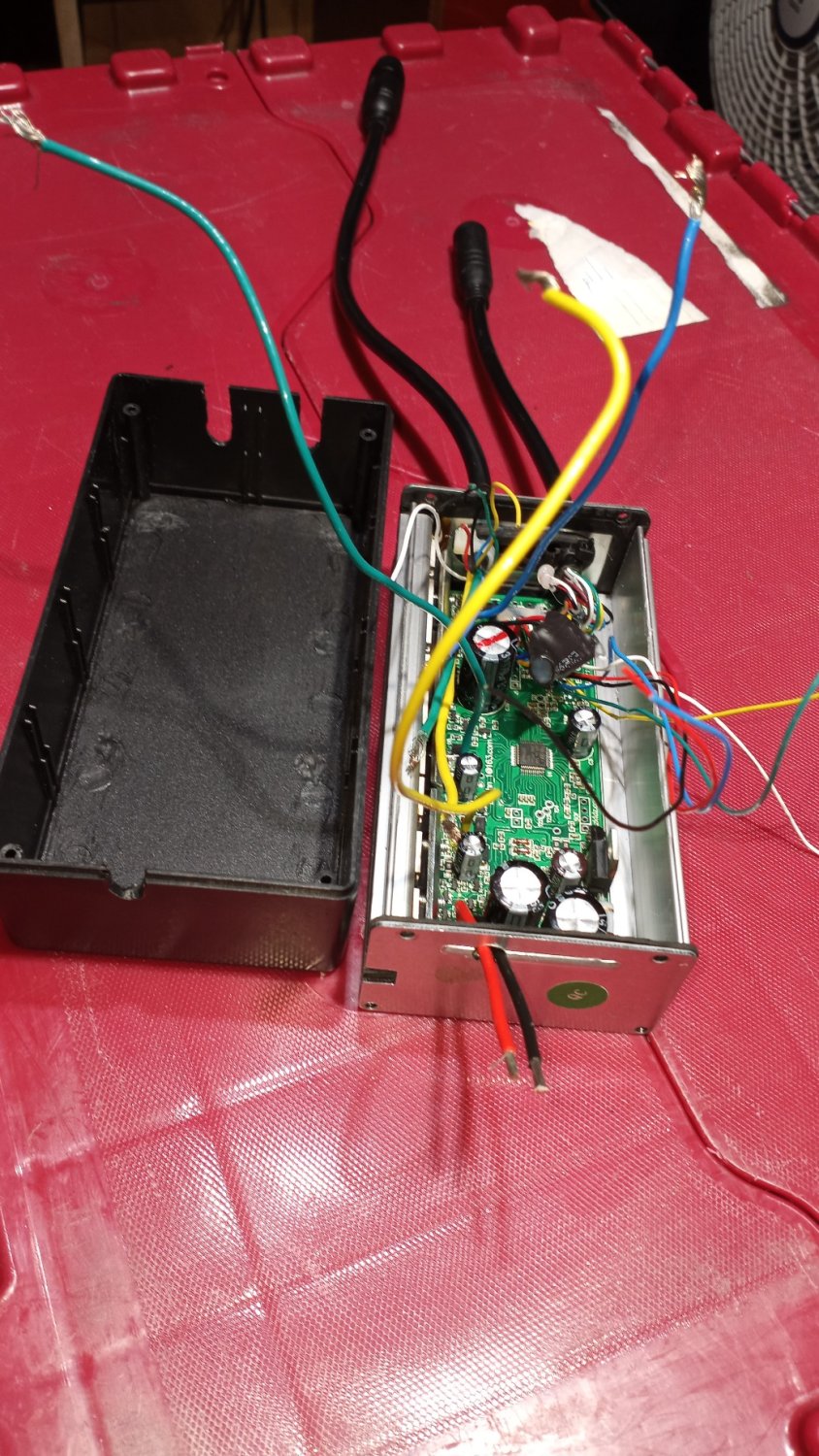

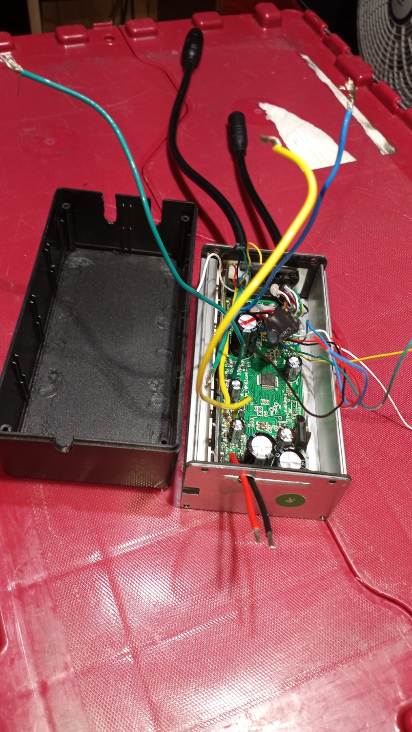

Thanks for your reply, it's definitely the Controller having swapped everything but this* - the mystery is that both controllers (ultimately) failed in the same manner.
*could not have been more thorough - 3 different batteries/brand new display/brand new "4 into 1" front wiring. Fault shows with both PAS and rear hub motor disconnected - BMS has done it's job. The common "fail" symptom is that the display turns on automatically as soon as power plugged in. I even changed the short powerlead where you locate the battery plug just to rule it out.

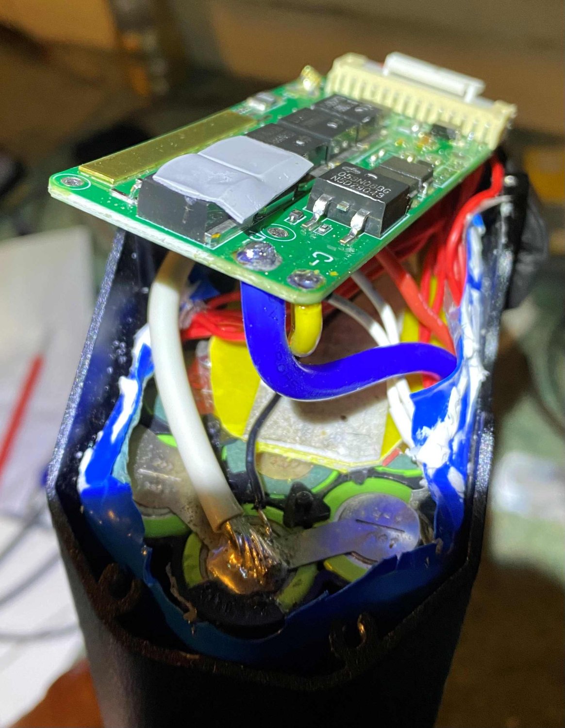

The top 2 pictures show the original Reention BMS with B-, P-, C- clearly showing on both sides of board, yet copying these locations faithfully worked on the first replacement briefly (too lower rating i believe but worth a try) and didn't work at all on the second.
EDIT - i can't believe it - something to do with my failing brain - the penny has just dropped and the wiring connection is correct after all, i got my + and - mixed up! - the clue was the - (negative) slot cut into the joiner strips that are spotwelded onto the ends of the batteries..
