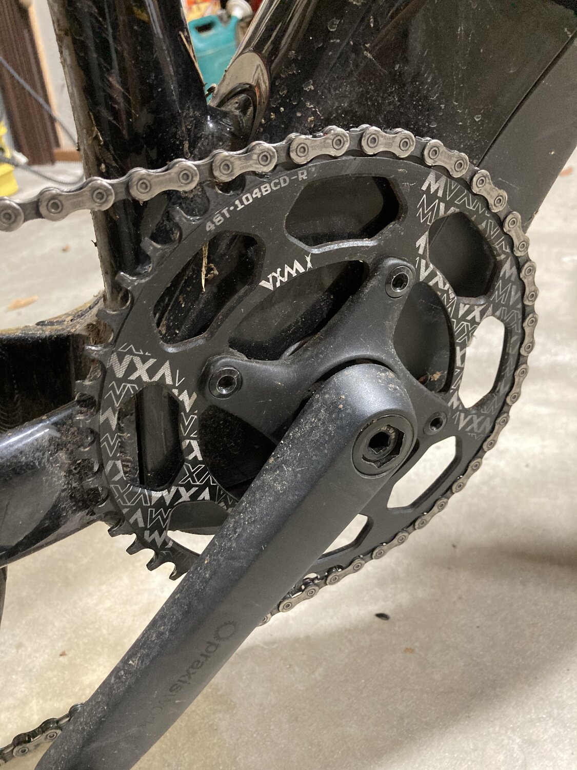

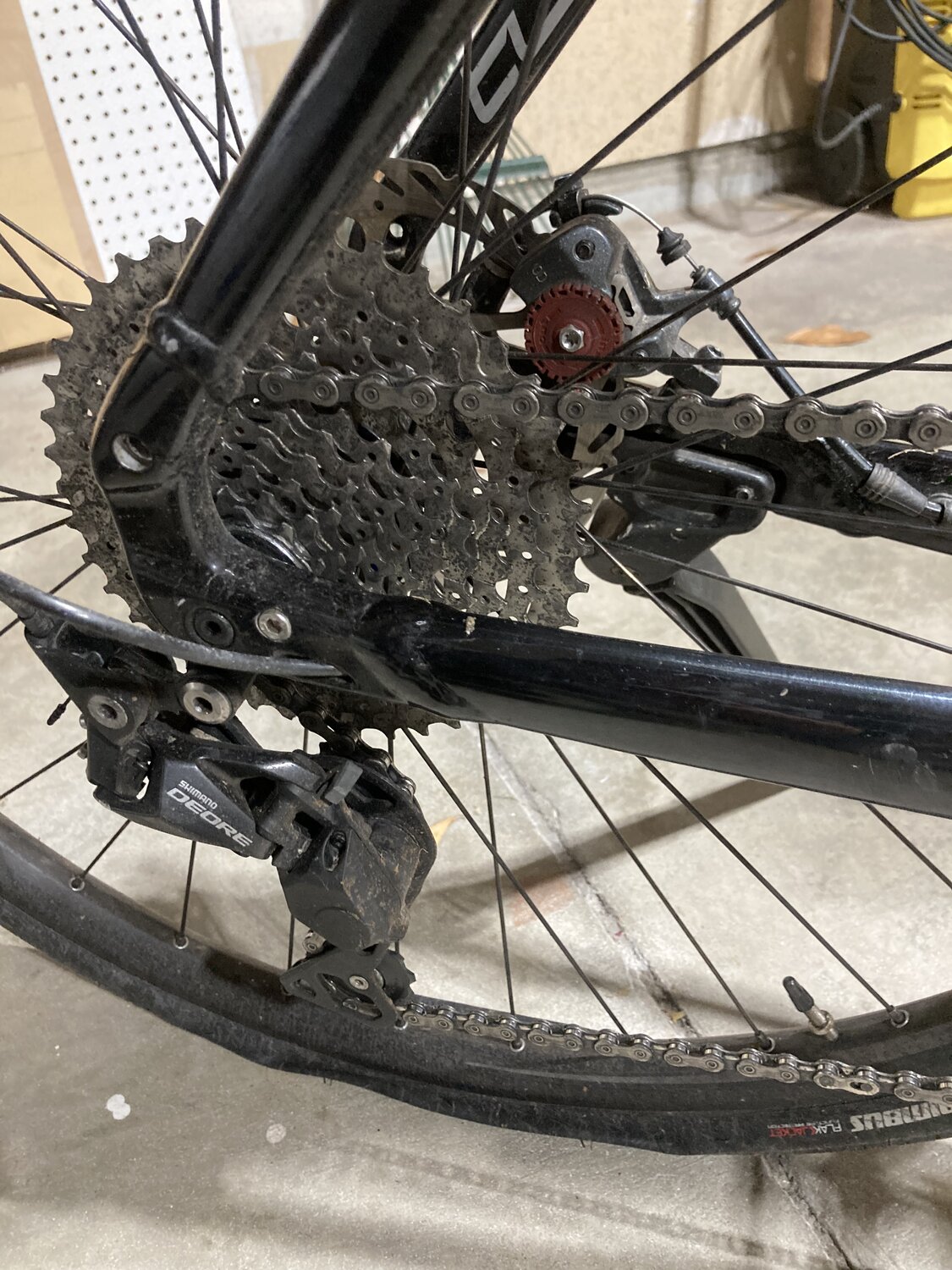

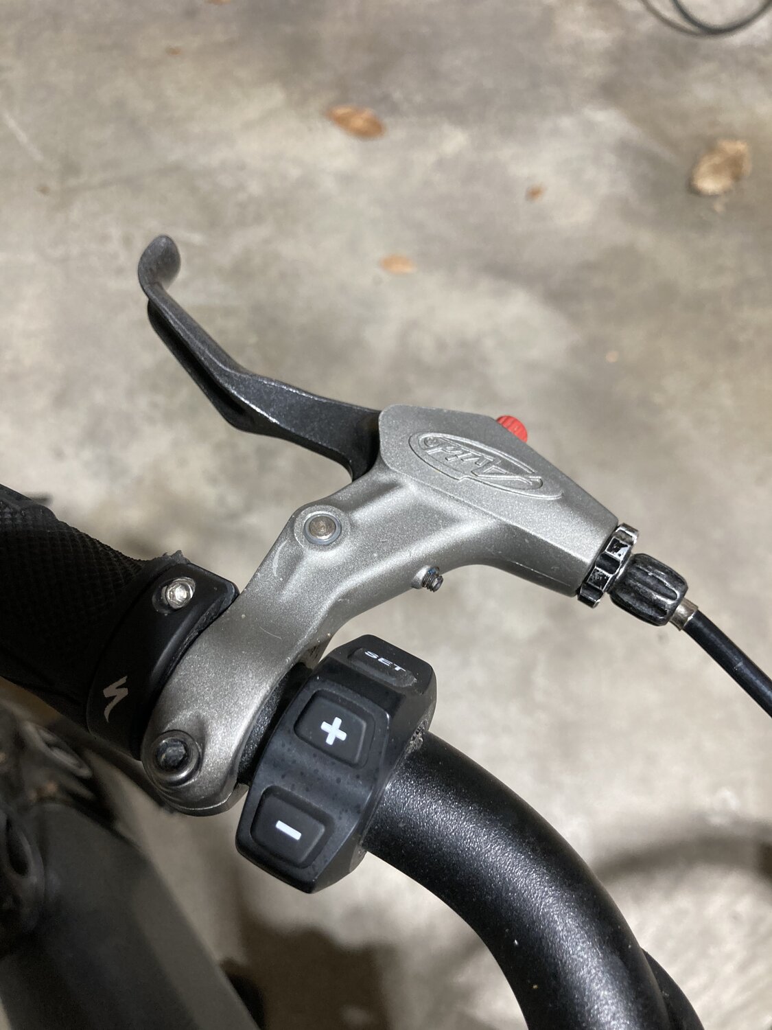

Hello all, I’ve recently picked up a second hand 2021 Vado 5.0, it was setup a bit weird in ways such as having no headlight a different 48t chain ring a set of mechanical brakes and a 10 speed cassette.
I’ve been trying to find out which headlight came from factory as well as pickup a pair of Deore or Deore xt brakes somewhere.

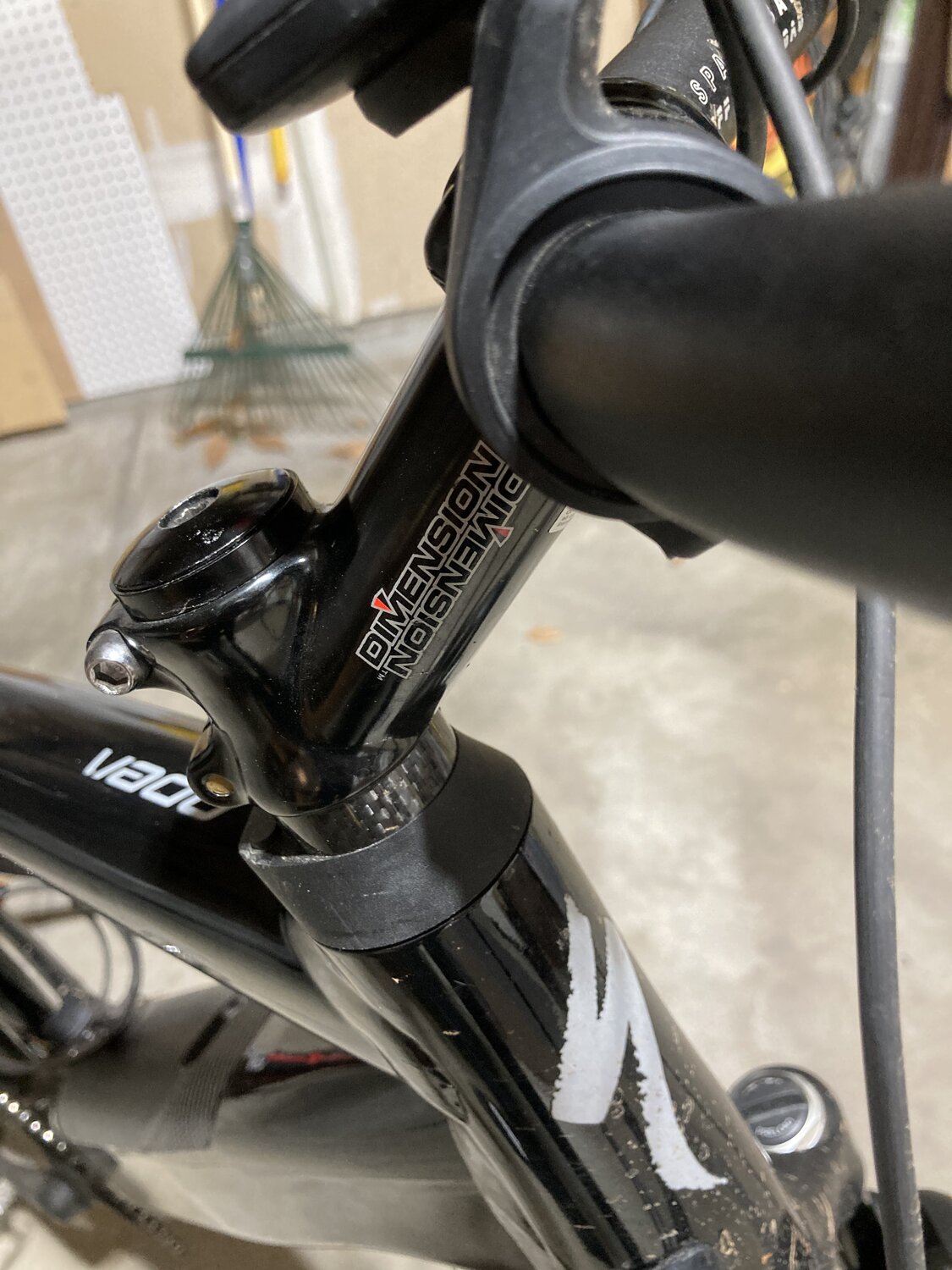

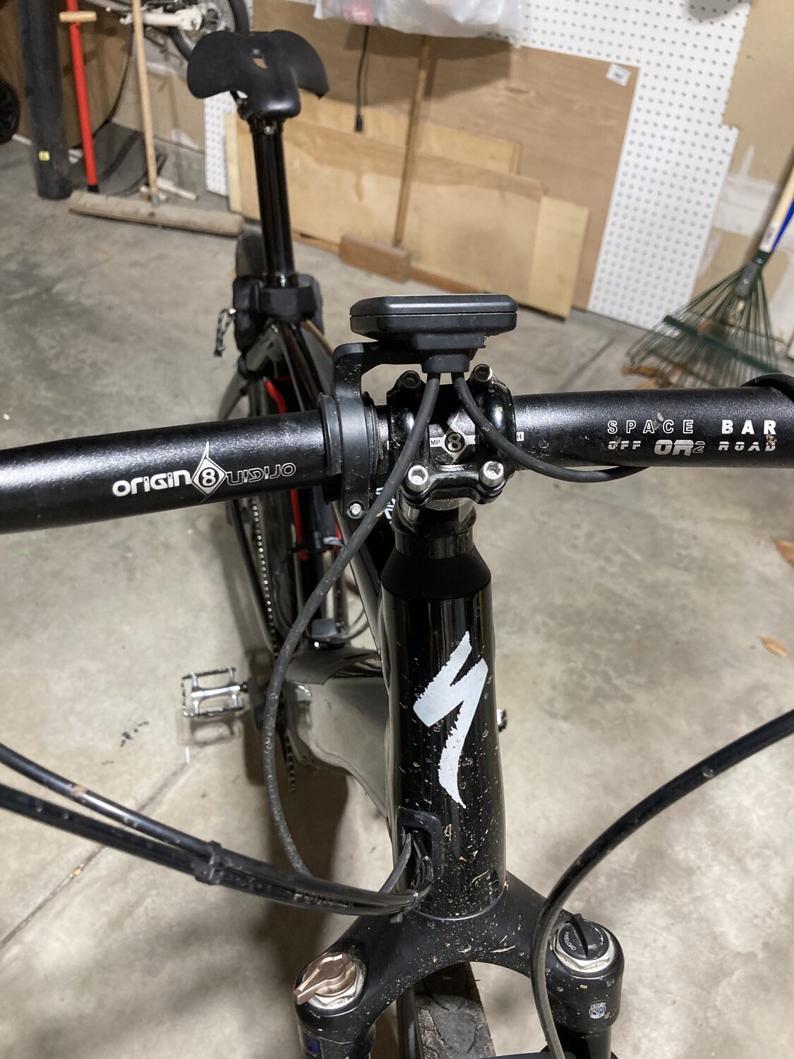

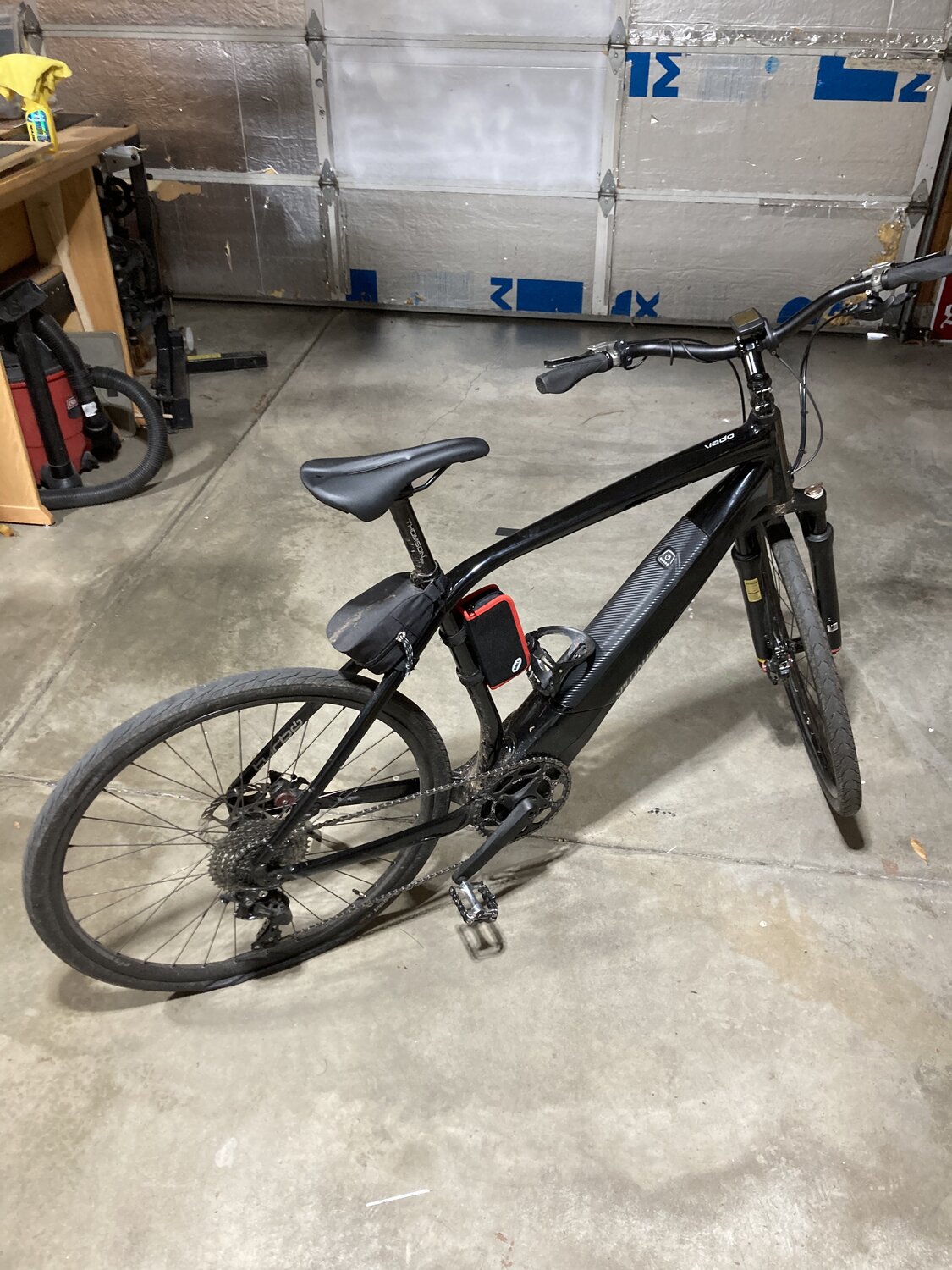

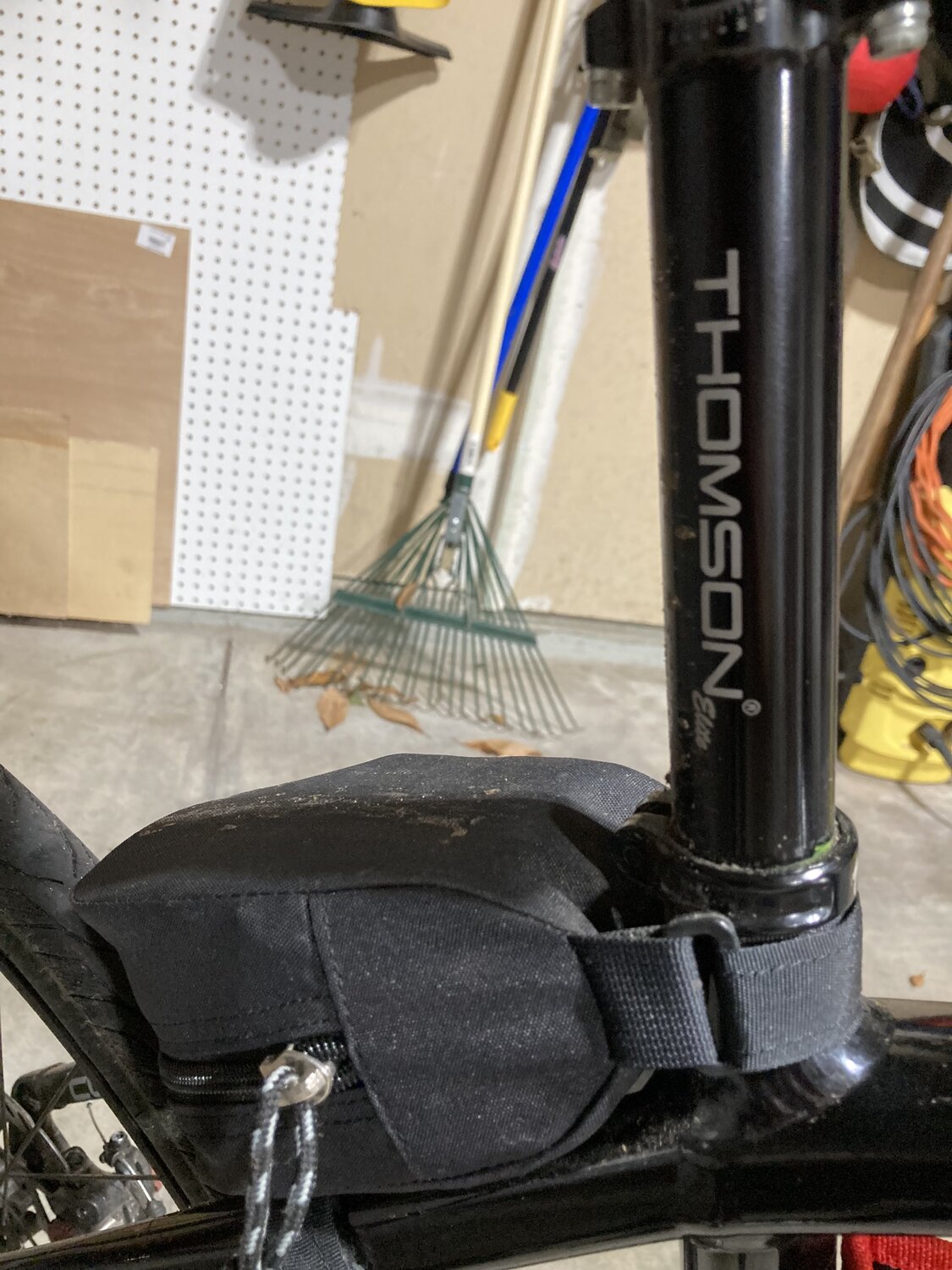

Thanks for that link, the bike has a different headset and handlebars on it too, he had just moved when I bought it and lost the original one in the move. He didn’t cut the wire, I’d assume he took it off when the bike was apart for the brakes. He was making it an ultra lightweight bike with carbon wheels and no front shock etc.
Heres a few photos of it, ignore the flat…

I prefer wired lights connect to the main battery and always ride with lights on, it might be a lot easier just to go with rechargeable lights. It's a common misconception you only need bicycle lights at night but I've had so many instances of drivers taking a second look because of the headlight especially on an e-bike where you may be faster in traffic than they assume.
