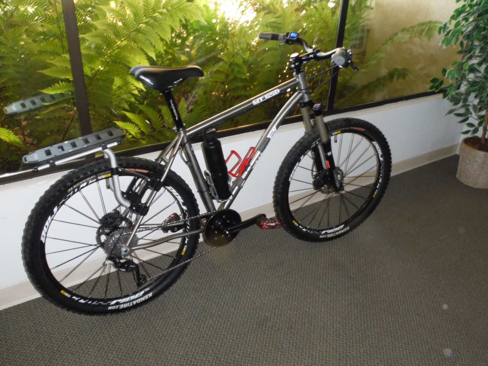

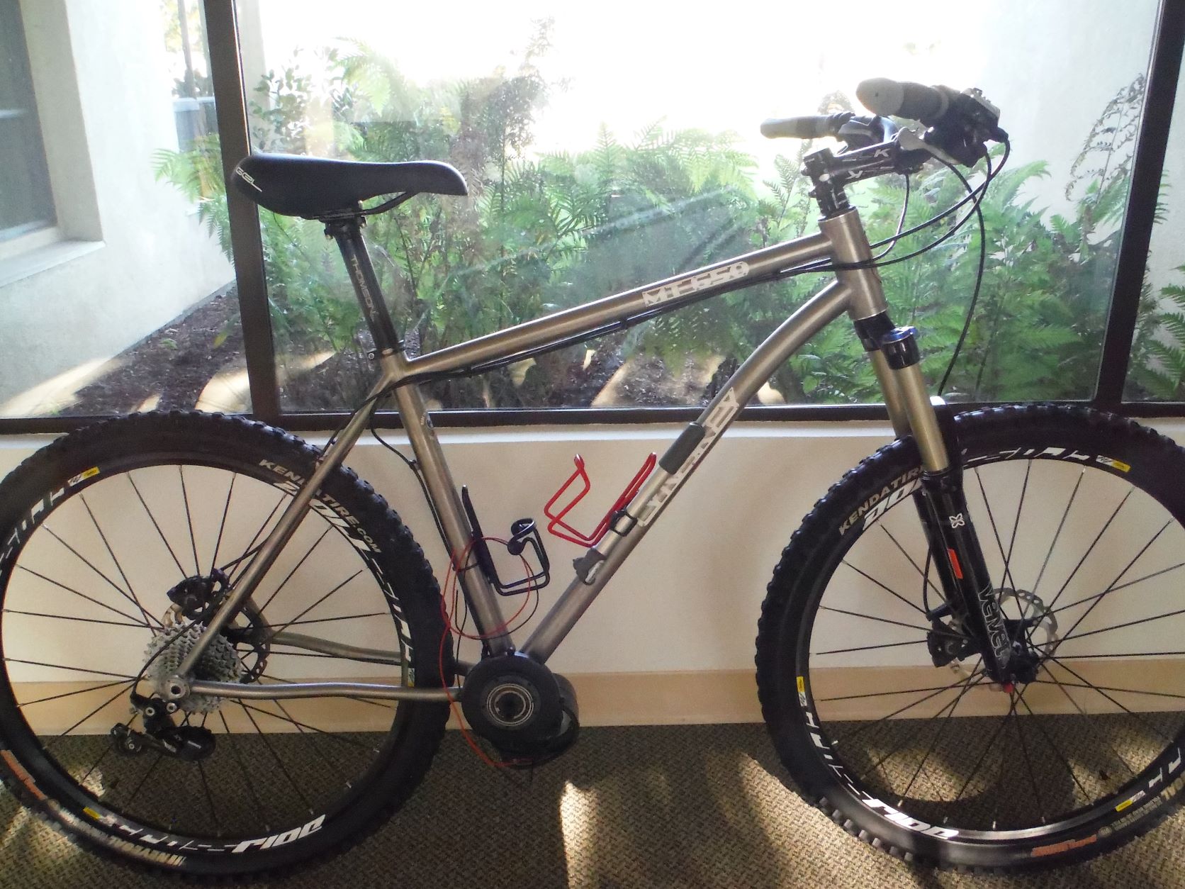

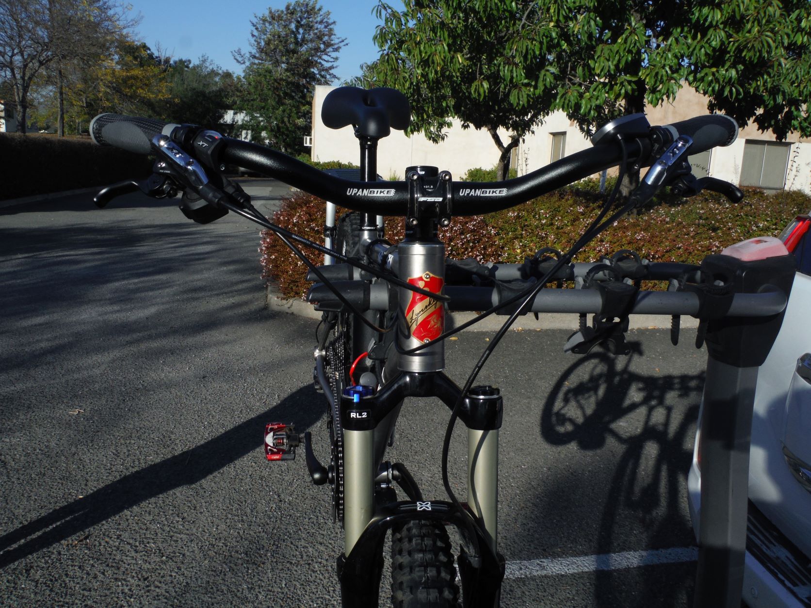

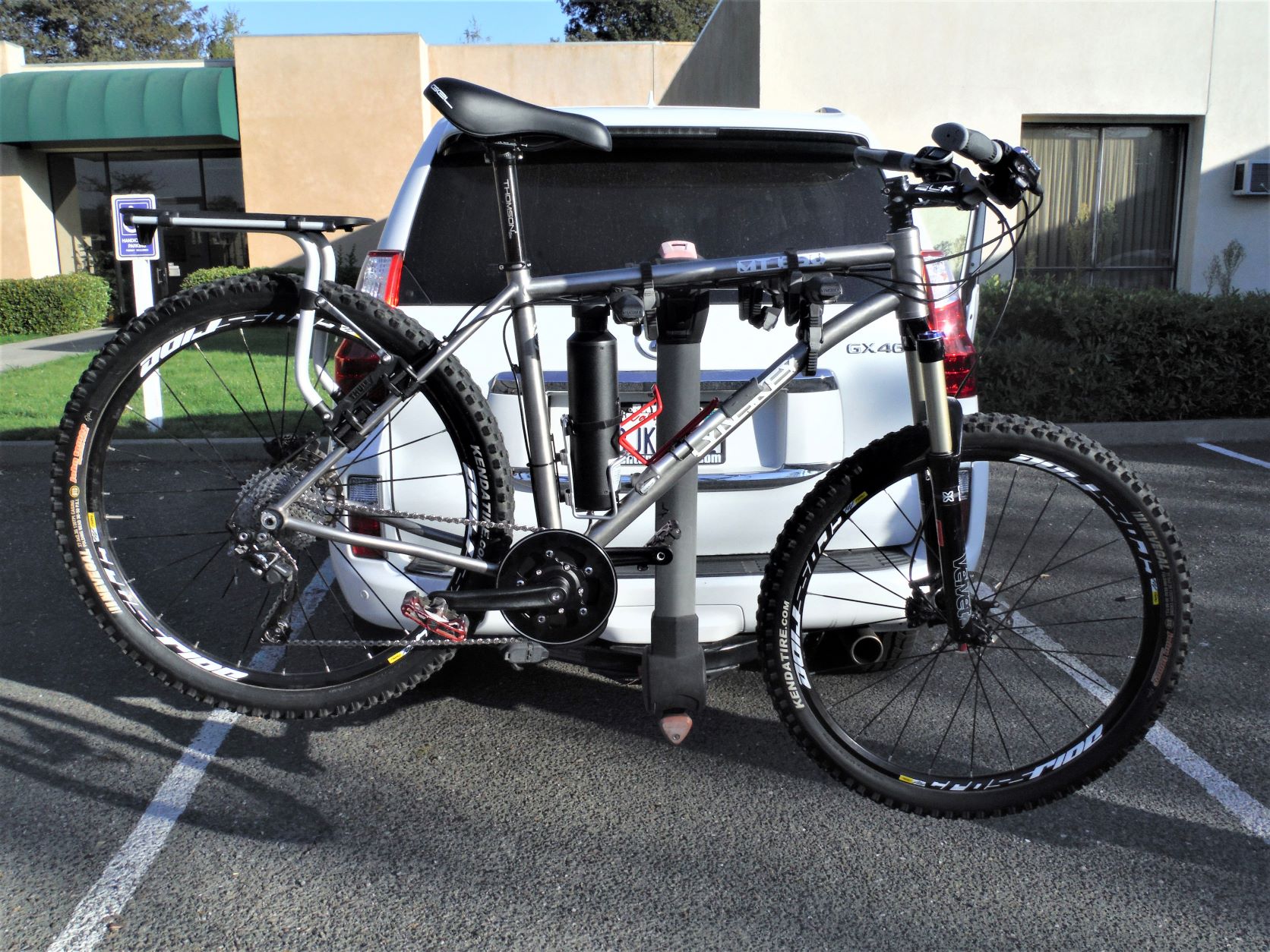

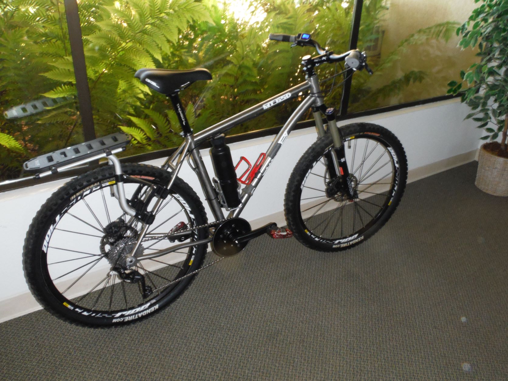

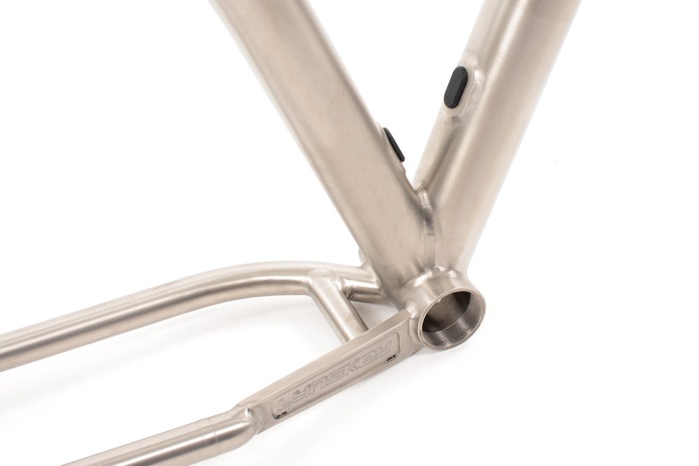

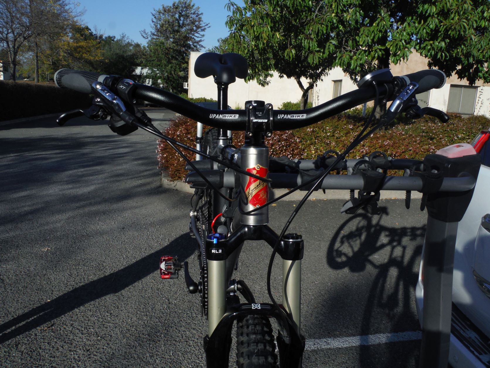

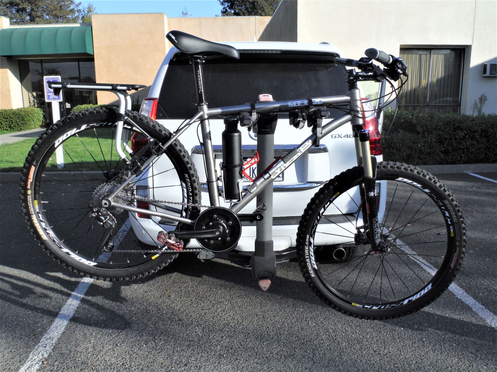

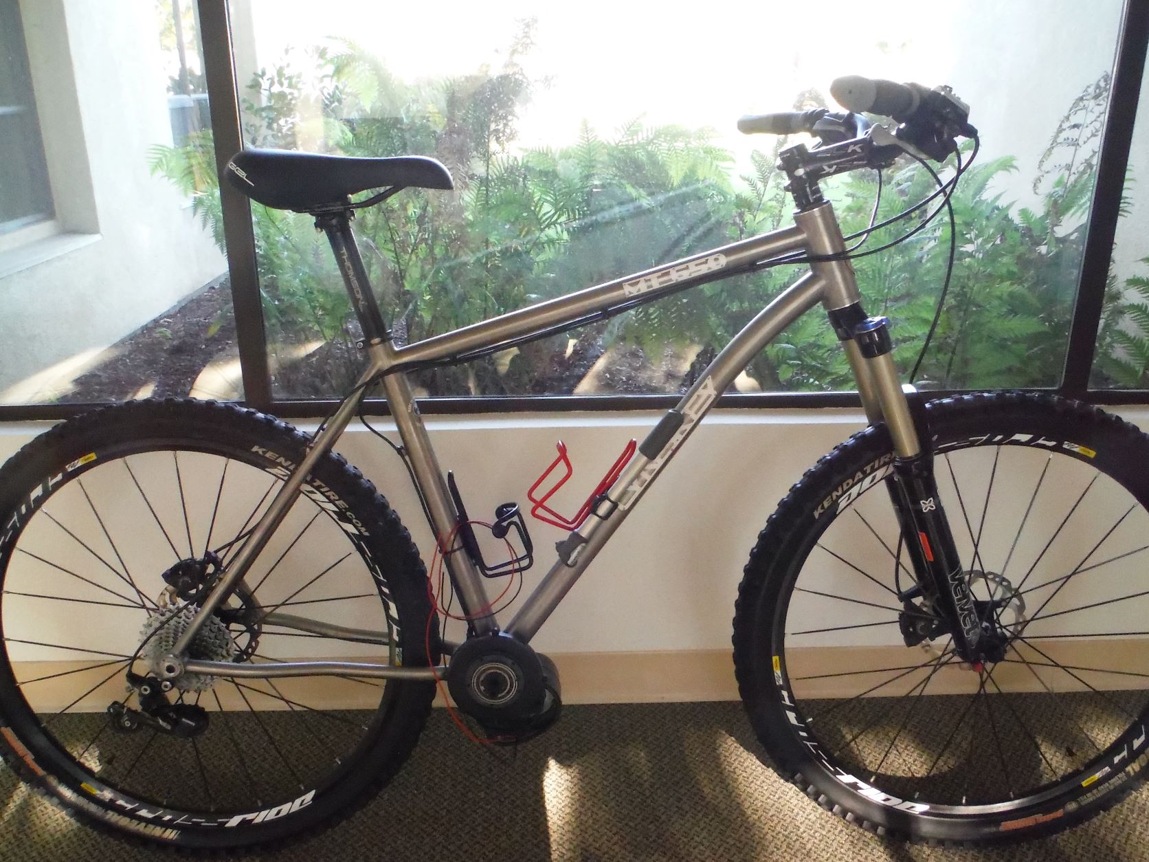

The Himiway is very heavy. A dud. Start with a lighter weight bike. A 350W bike like the one I made electric yesterday will blow away a Himiway and the $9400 bikes at bike shops. Here is the one I made electric yesterday. Note the lack of ugly wires.
