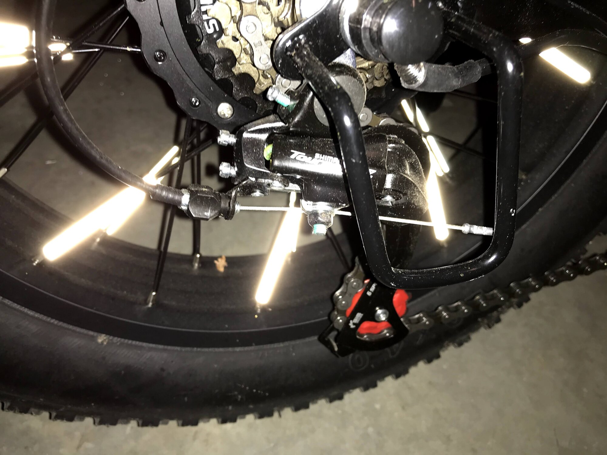

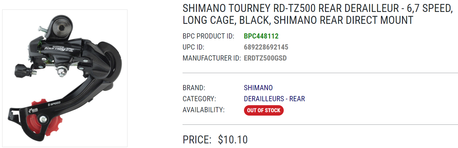

The rear derailleur on my new ST is different than that pictured on the Lectric website. It's simply labeled "Shimano" and appears identical to the ones found on the bargain basement Wal Mart bikes. What's up with that?

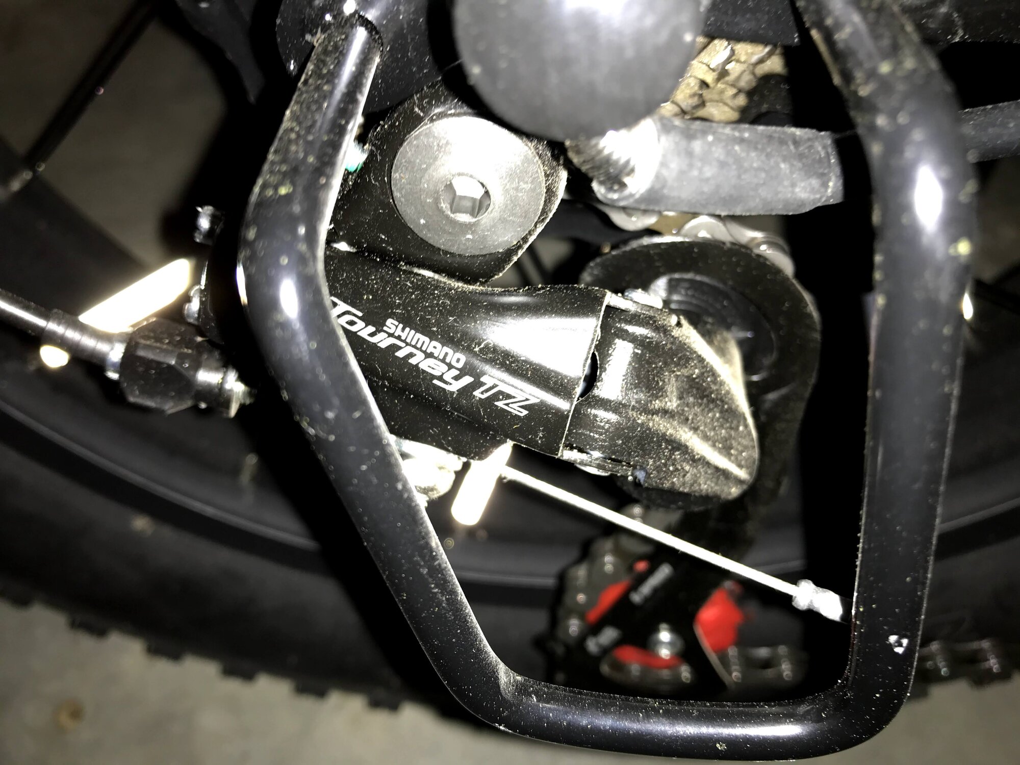

Even the ones without the name Tourney printed on them are considered part of the Tourney line, by Shimano and their sellers. I think the only downside is some of the models that aren't labeled Tourney don't have a B-screw for adjustment. That won't really be an issue as long as you keep the same gear set on the back. If you went with larger diameter cogs (more teeth on freewheel or cassette) then you'd need a B-screw. The quality is about the same on all Tourney.
Agree. I see them as part of the Tourney line on the Shimano website, just the bottom end of the line. Take a look at the $98 Wal-Mart bikes with "Shimano shifters" and you'll see this bargain basement derailleur. And with all the recommendations to switch over to an 11-34 freewheel on the XP, that was going to be part of my upgrades. That may now be an issue.

Hmmm that little red gear/sprocket is what Lectric included? Interesting.
I've seen the bottom red sprocket for years now... Not sure if it's a OEM thing.
