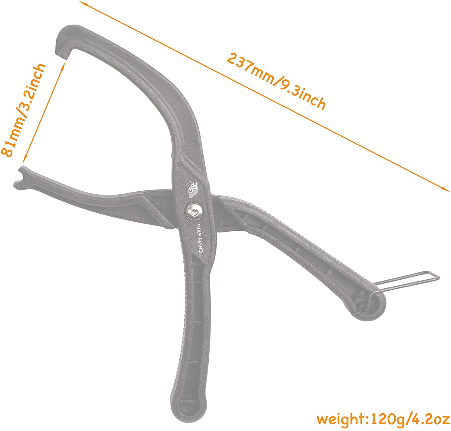

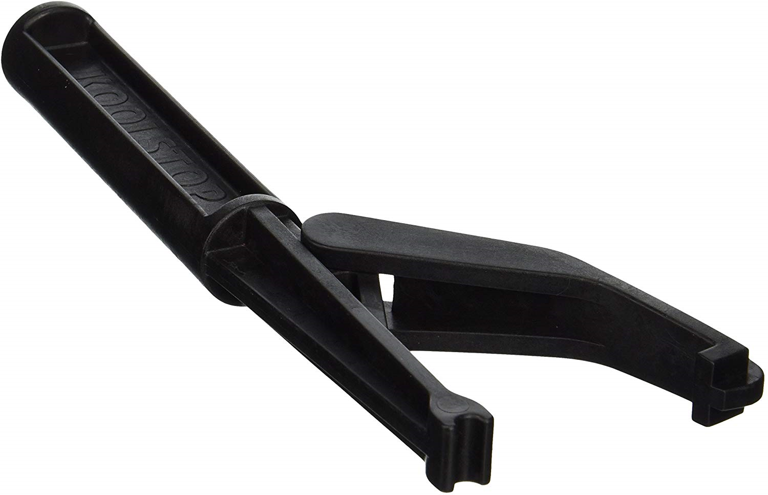

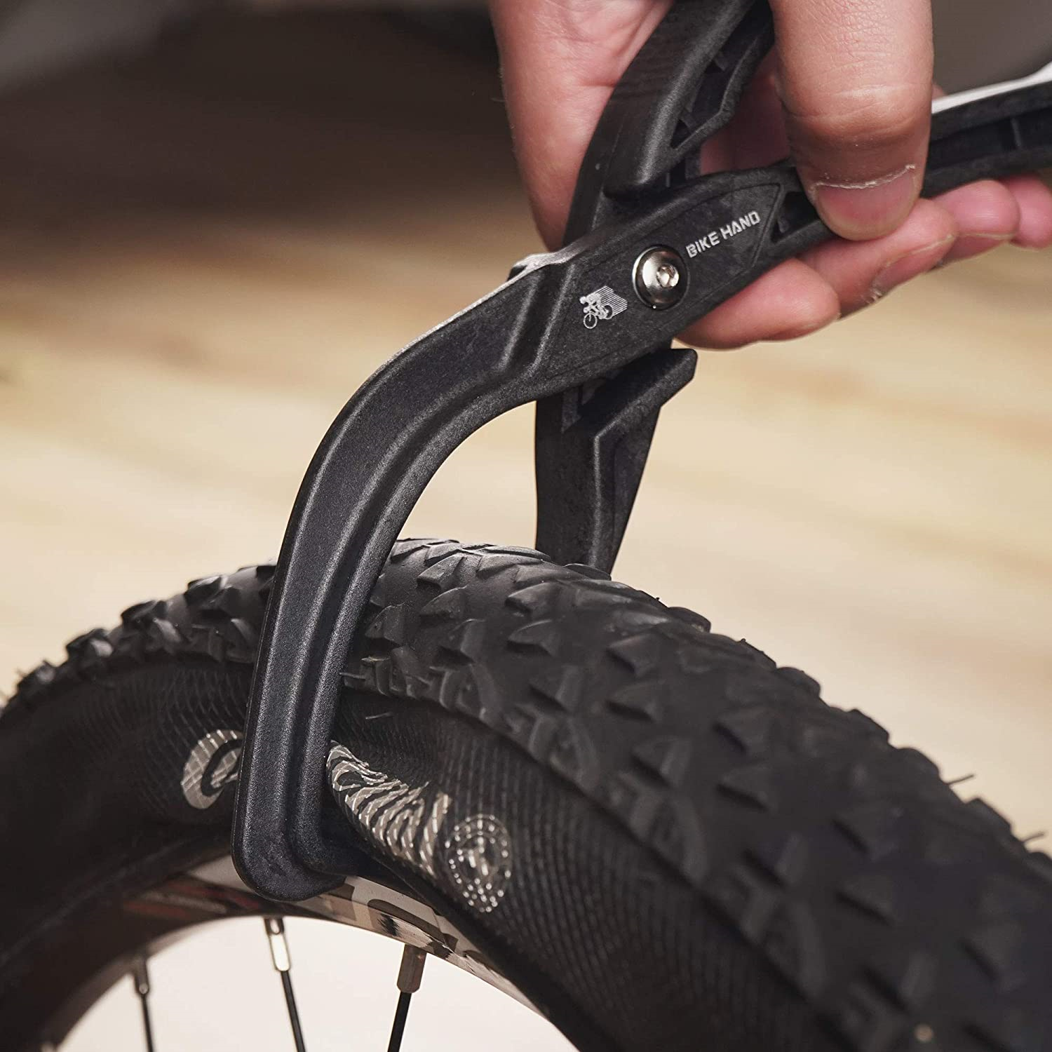

Glad to hear you found a solution... just be careful about working on the horizontal rim as it is very easy to damage. Try the rim tool next time... ;)
Thanks for this suggestion - but I bought this item and found out that the Moto X tires are too big. The jaws didn’t fit around the sidewalls to reach the bead. I returned it and am still looking for one that might fit the 2.8” tire size.
This tool will work on wide tires... no problems with my 2.8" Nobby Nics. :)
