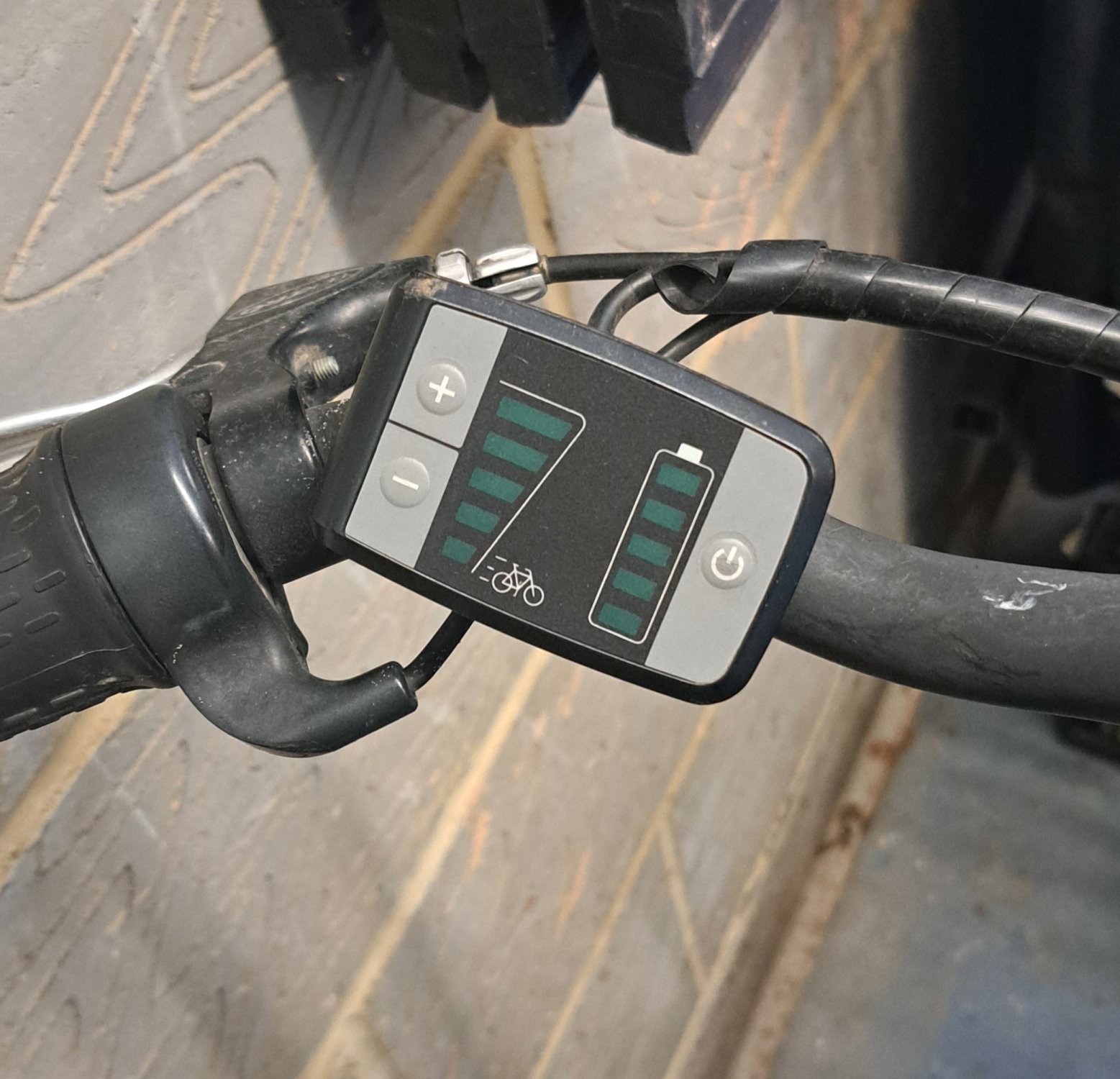

FYI, the bikes do not have any sort of display, just a couple of buttons and a series of lights to show when it comes on, how much juice in the battery and what power you want to use.

Thanks for your thoughts on this matter. The bikes do not have any sort of display, just a couple of buttons and a series of lights to show when it comes on, how much juice in the battery and what power you want to use.

Thanks for the picture. Maybe it’s unlikely given your picture, but definitely have a look. And, yeah, Harry’s advice to try swapping the display is a good one for diagnosis.
