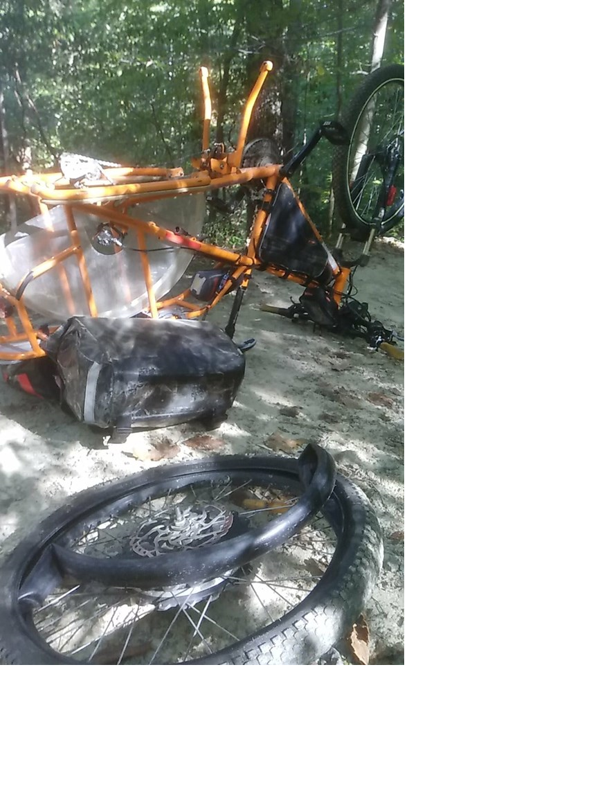

Got my first rear flat on the Radwagon after a few years of riding. I carry a socket wrench along with my repair kit and extra tubes just in case. It turned out to be a pinched flat probably from one of the tree roots I bumped into on the trail.
40060
Getting the wheel off was pretty easy once I disconnected the cable from the hub. I replaced the tube, put the torque spacers back , installed the wheel, and re-centered my rear hydraulics. It was a lot easier that I thought. With the exception of the cable, it wasn't any harder than replacing a tube on a regular bike.
Oh, I also loosen the bolts on the screen display so I could rotate it out of the way when I flipped over the bike.
