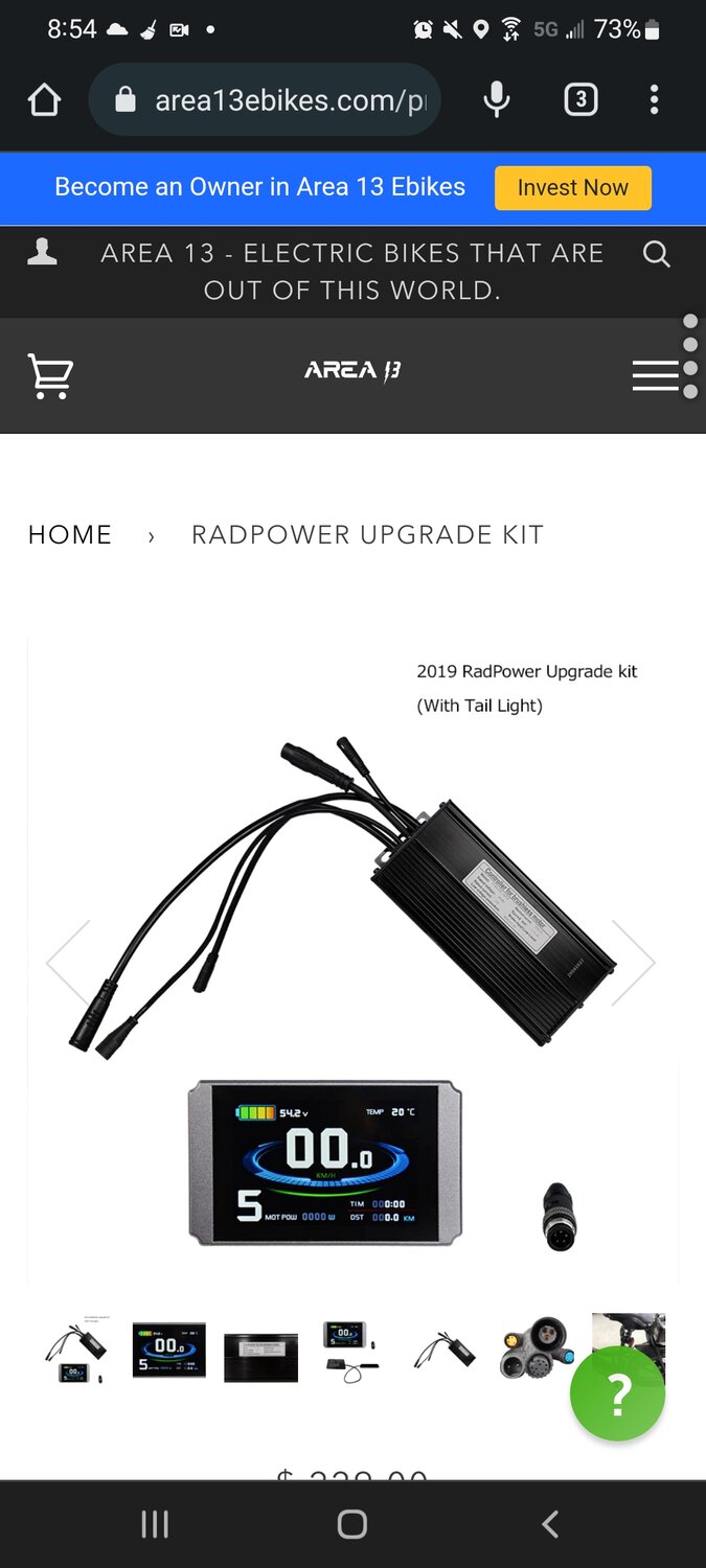

Has anyone adapted this to the Aventon Adventure?
Will the connectors have to be modified and how so?
I think some modifications in the way of wiring connectors is going to be a safe bet/the best assumption. I can guarantee there will be no direct plug and play available.
How so/what will need to be changed? Impossible to tell ahead of time.
