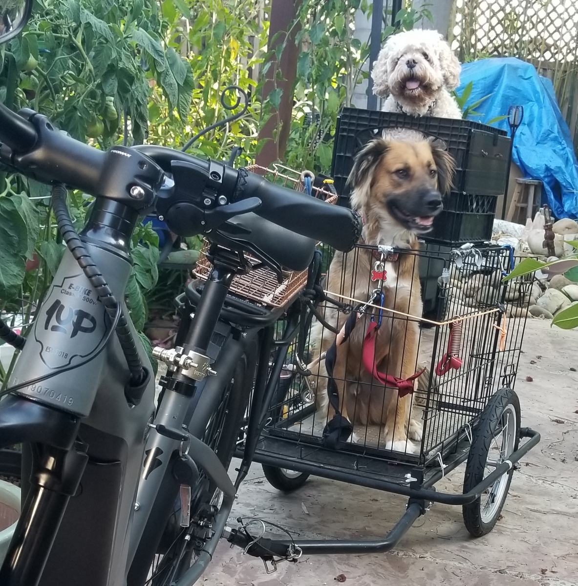

This obviously isn't an Axle Mount, but the ones I made for mine and my wife's 700's work great.
I am building a Double Pup Trailer so our pups can ride together, as they get 'antsy' when apart.
I welded up attachments that bolts to our back racks that hooks up to the tow bars on the trailers, rather than
attaching the tow bar to our seat posts.

A couple of pictures of the 'rack mounts' that I made to pull the 'Pup Trailers' with.
The last picture explains why I decided to build a larger trailer........
The last two pics are of my Pup's Double Trailer and the Rear Rack mounts I welded up.
