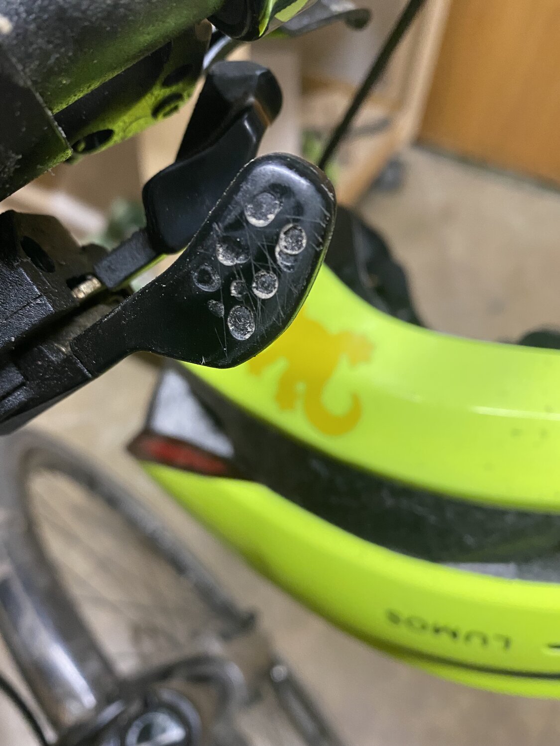

my shift lever has gotten so slick from all the shifting I ahve done in the last two years that my thumb slips off sometimes. so at a stoplight I took my knife to it and got some traction.

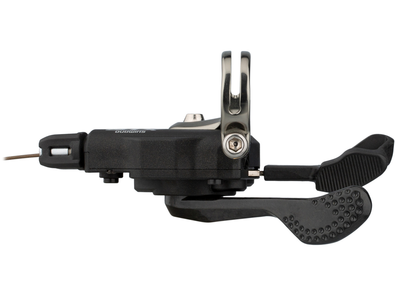

see the xtr shifter has dimples. I think thats what I will do its easy and should add enough traction. or if I get rich an upgrade.

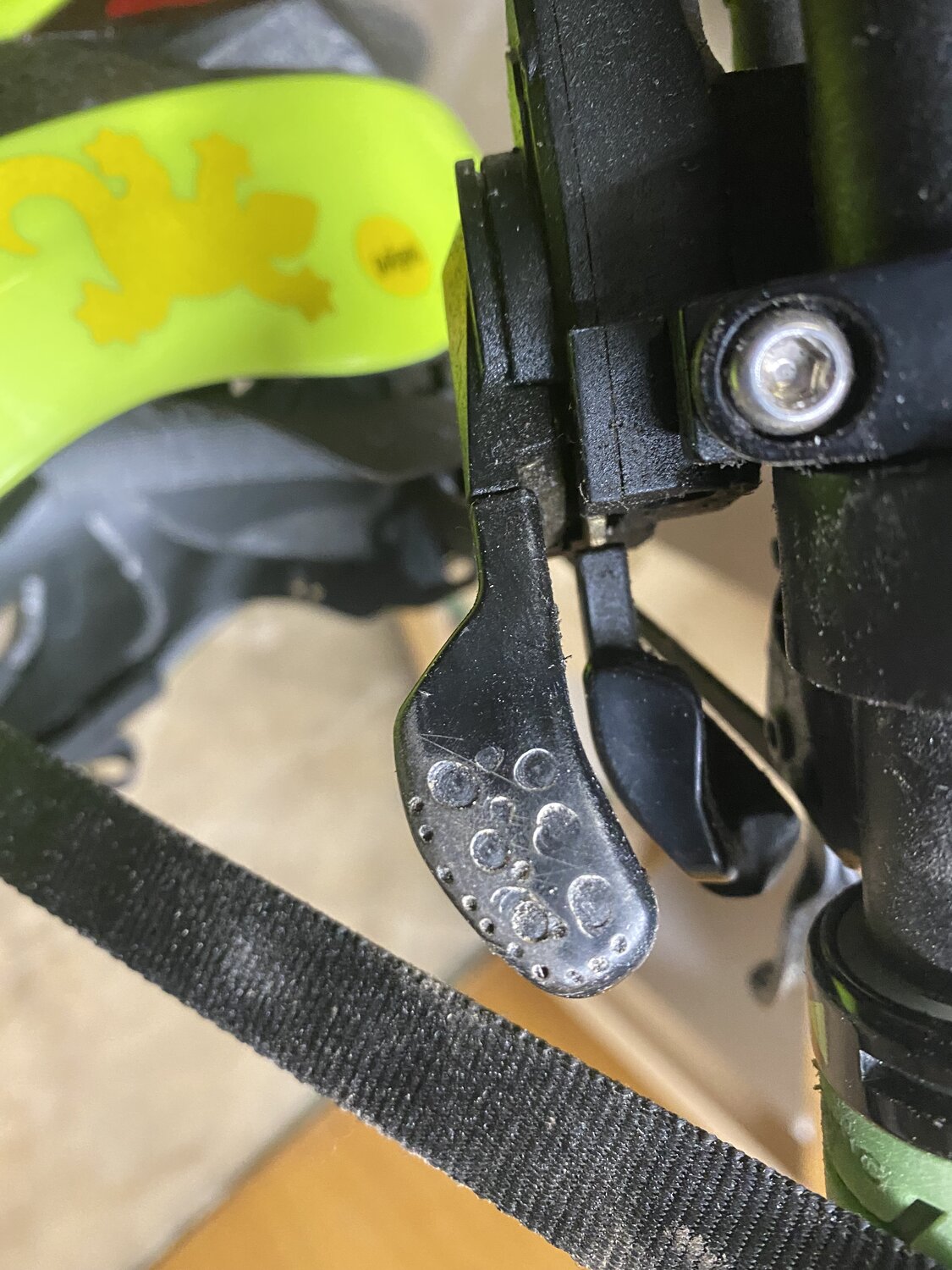

no worries. I only need a tiny bit of grip. the scratches worked but they would not be long term. I ised a dremel and should have used a 1/16" bit instead of a 1/* but I don't have one that would fit. a bit ugly but it works well. little hard to drill on a curved face.
a little ugly but not like anyone will see it. I should have used that 3/32" bit for all the holes. then I sanded it with some 800 grit paper to smooth things up. my finger will buff it out from there. but the grip is good but not aggressive.

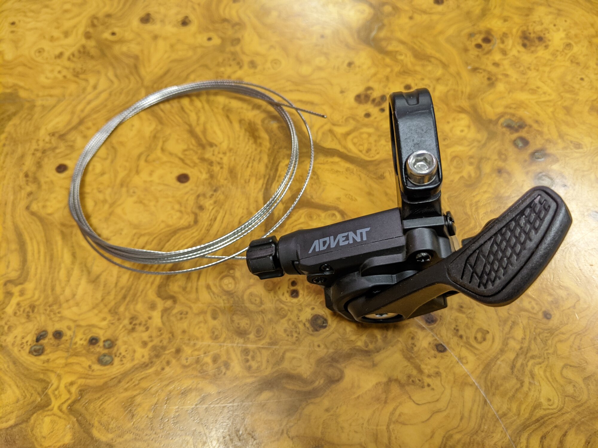

Interestingly, the only upgrade on the Microshift Advent Pro shifter is the pad on the thumb. It used to also be a ball bearing mech but they are all using bearings now.
