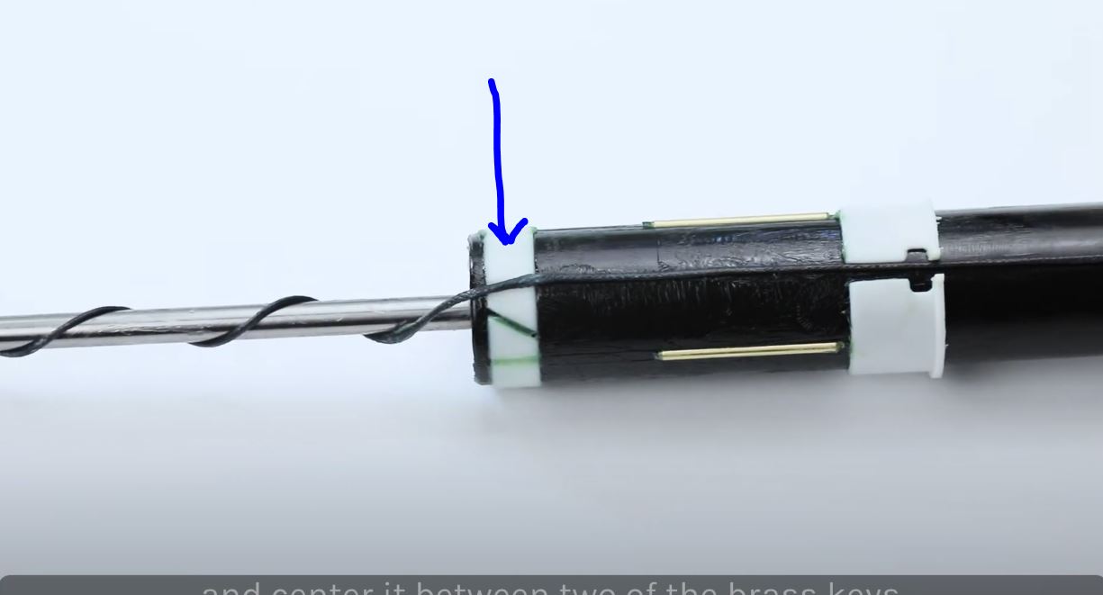

I took the dropper out (it's an externally wired one) and started to try to see what was going on - I'd hoped it was something relatively simple.
It wasn't... they use a nylon cord from the actuator lever at the bottom of the post that connects internally up to the external actuator location (which connects via cable to the lever on the handlebars.
That nylon cord was broken.

Once I got it completely taken apart Sunday evening, it was clear that there was an important part actually missing (manufacturing defect - no other explanation).
There is supposed to be a lower bushing to assist in the routing of the nylon cord that links the external cable to the actuator at the bottom of the dropper.
There wasn't one on mine.
I once again contacted PNW support (email Sunday evening) and yesterday morning they responded and once again they did it right.
They immediately overnighted the correct parts (including some extras of stuff that I "might" need) and everything arrived this evening via DHL.
I installed and reassembled and all is well. I've a crap load of stuff to do tomorrow, so the next ride will likely be Thursday. So I'll pull my favorite saddle off the NCX and put everything back on ROGER so I can take advantage of the relatively mild weather while it still lasts. I'll also get out Friday - as I'll take my bike with me to the VW dealer while my car is serviced.
