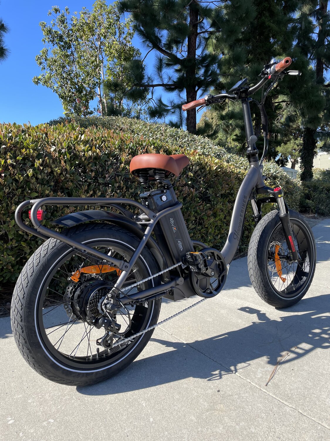

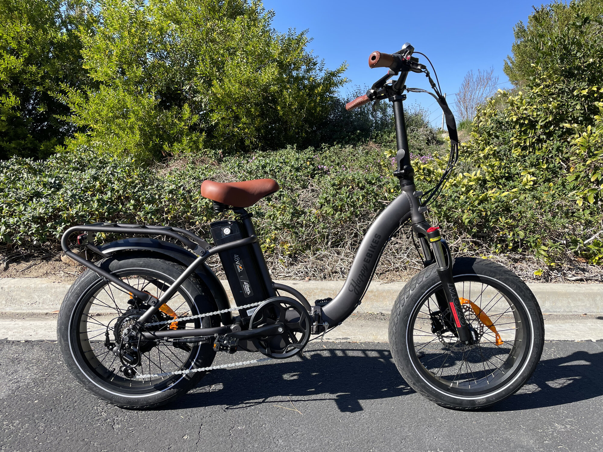

Just got the first pics of my Happy Bike that was customized for 5’ tall me! Should get it early next week.

Batteries pack is very dangerous underneath butt chops. You will be ejected out of the saddle hyper fast. If the Mlrs time alarms set on. Get off the saddle. Stand the bike using kick stand/parking stand.
I no like bike with Batteries pack underneath my butt.
I was going to get the Magnum Premium 2…it’s the same, but taller. What is an Mlrs time alarm?
Ah, yes, this is a style we were very interested in, but could not find a test ride near us at least before she found one that made here drool ;)
I don't agree with the commenter you replied to. What matters is weight distribution. As those of u who have used pannier racks for decades (and those before us for decades more), what is really problematic is having your center of balance too high or unbalanced side-to-side. You do have a big battery and yes, it might be better under the frame, but it's a lot better than a rack-mounted battery, IMHO. Further, your bike has a nice springy looking saddle, a front suspension and fat tires, which can really help. The fat tires weigh a good bit and, when spinning, create a lot of centrifugal force, which will further stabilize you under way. If you use a pannier bag, placing weight low in the bags will help stabilize your CG even more.
Thank you for your comment! Makes me feel better. I was not able to test drive this one either, as they are in California and I’m in Nebraska, but I really wanted to be sure it would fit me! I tried a Magnum Pathfinder and a BlixVika+, and both felt a little too big. This dealer was willing to customize it for me, so he got my business! It was kind of pricey, but hopefully having it fit properly will make it worth it!
