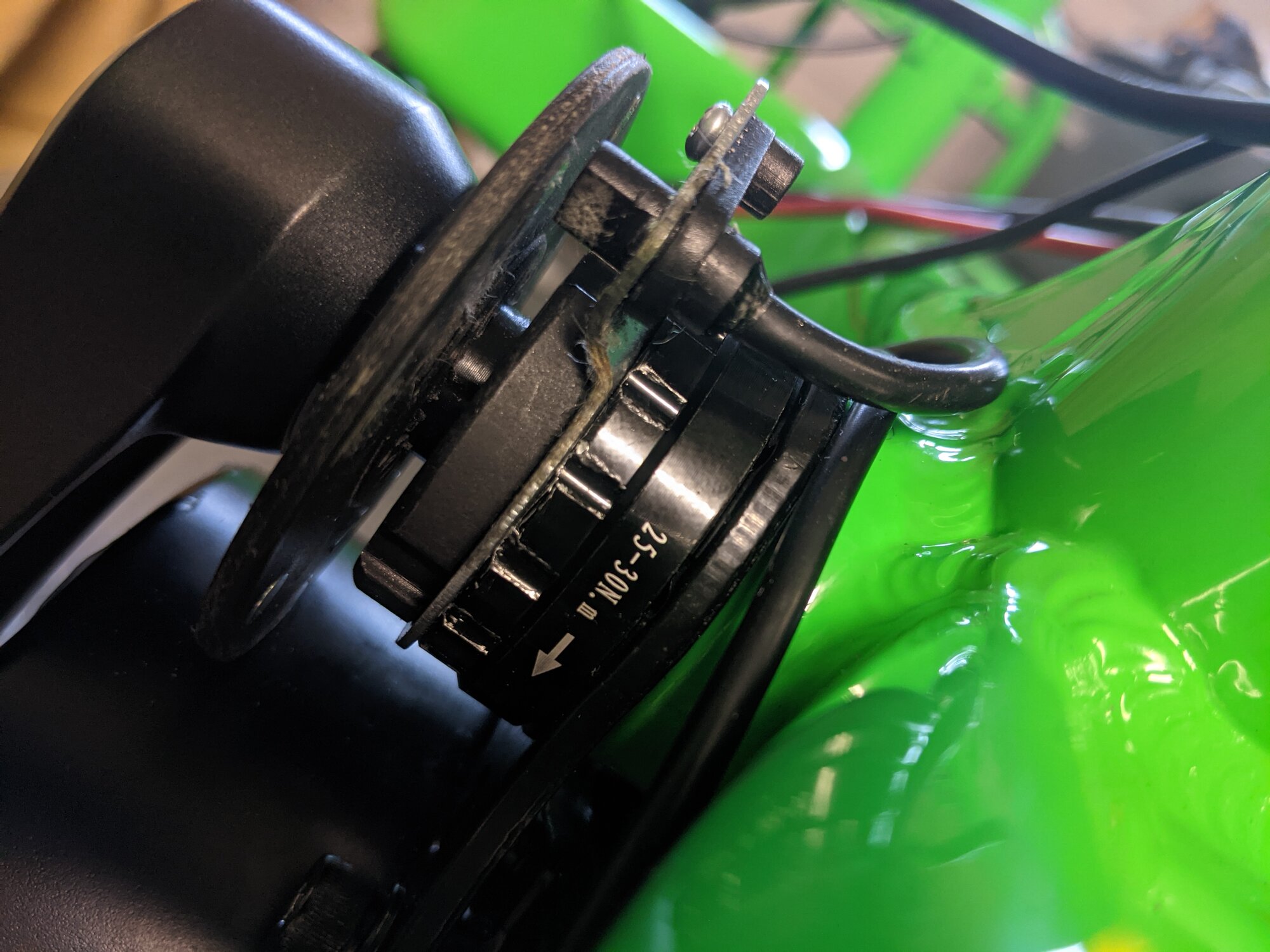

Flipping the sensor around is what I think everyone is thinking of flipping if talking about flipping hardware; not flipping the disk. A PAS disk just has magnets in it and those don't change anything if you flip the dis around except they work better on the proper side where more magnet is exposed. On a couple of my bikes I have flipped the sensor around, but only because it let me physically move the sensor closer to the PAS magnet. Here's a pic of one. See how the metal bracket is an outie, now? Thats what I needed to get the sensor close to the disk. Also see the little screw that mounts the sensor? I unscrewed the sensor, put it on the other side of the bracket and poof it works on the forward setting but is traveling in 'reverse'
