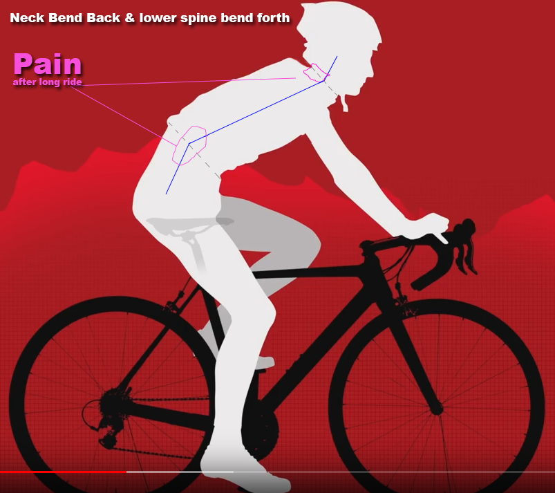

I feel your pain. I had similar problem in the past. The ebike I had in the past had a forward position (aggressive) which caused more bend (angle) at my lower back and neck. Plus the handle bar had an awkward wrist position resulting to back, neck and wrist pains.
I needed to reduce the excess angle at the lower back and neck, I also needed to reposition the handle bar reach, height, and wrist angle. (see yellow lines)
After comparing the riding position to my older and more comfortable non electric bike, I ended with a Jones H bar, stem riser, and and short stem.
Here's a video on the advantage of using the Jones H bar.
The video below explains how handle bar wrist angle affects comfort and pain to the wrist, upper extremities, and upper body.
Now, I can ride for more than 4 hours straight with no back, neck, or wrist pains.
