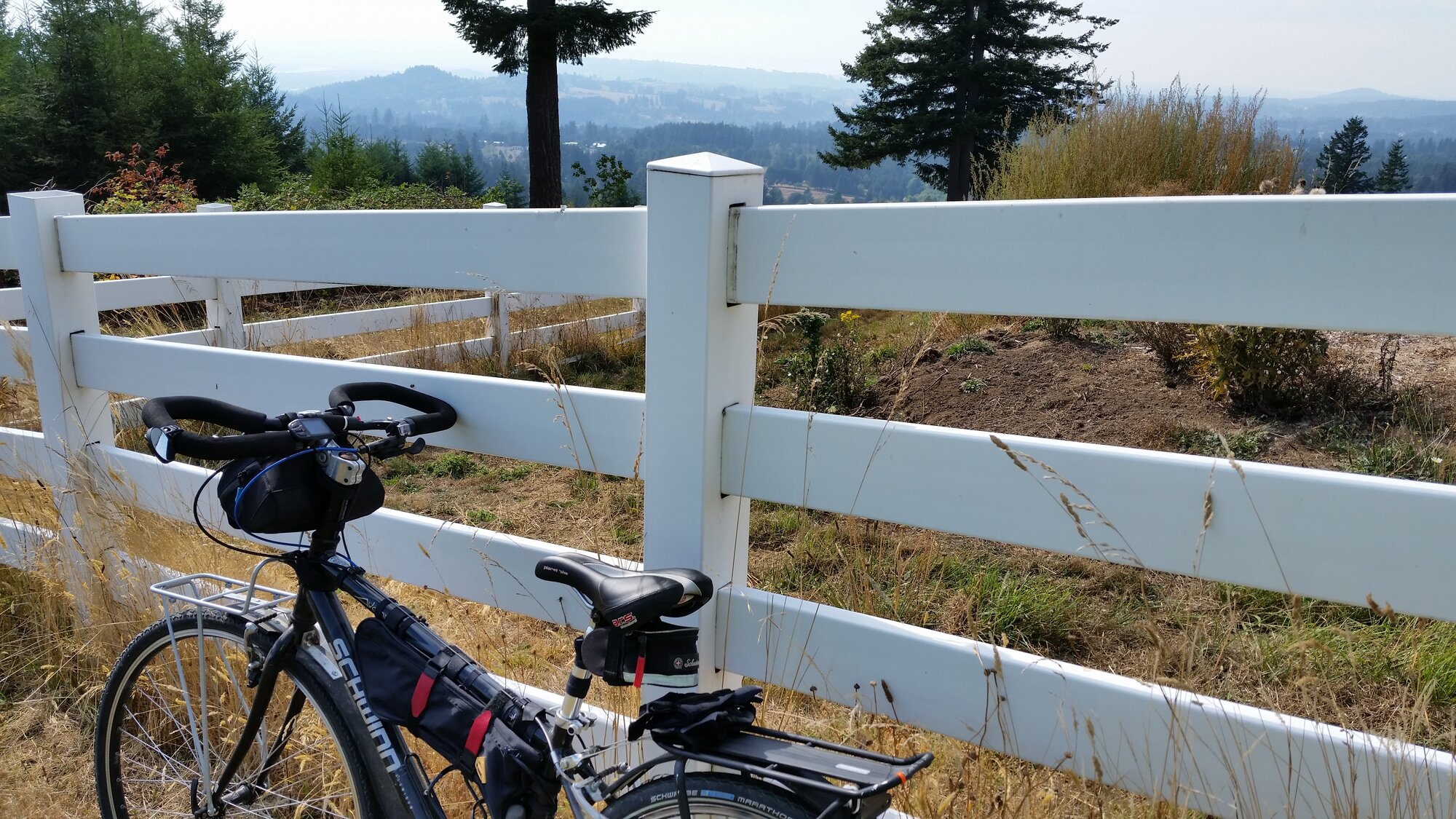

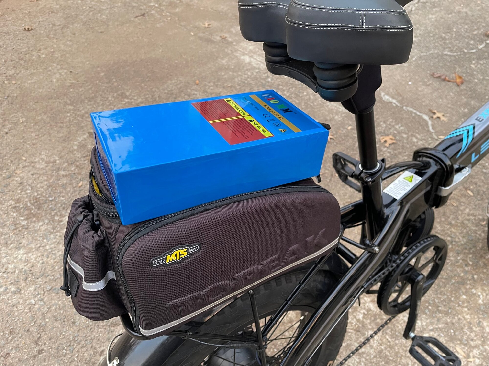

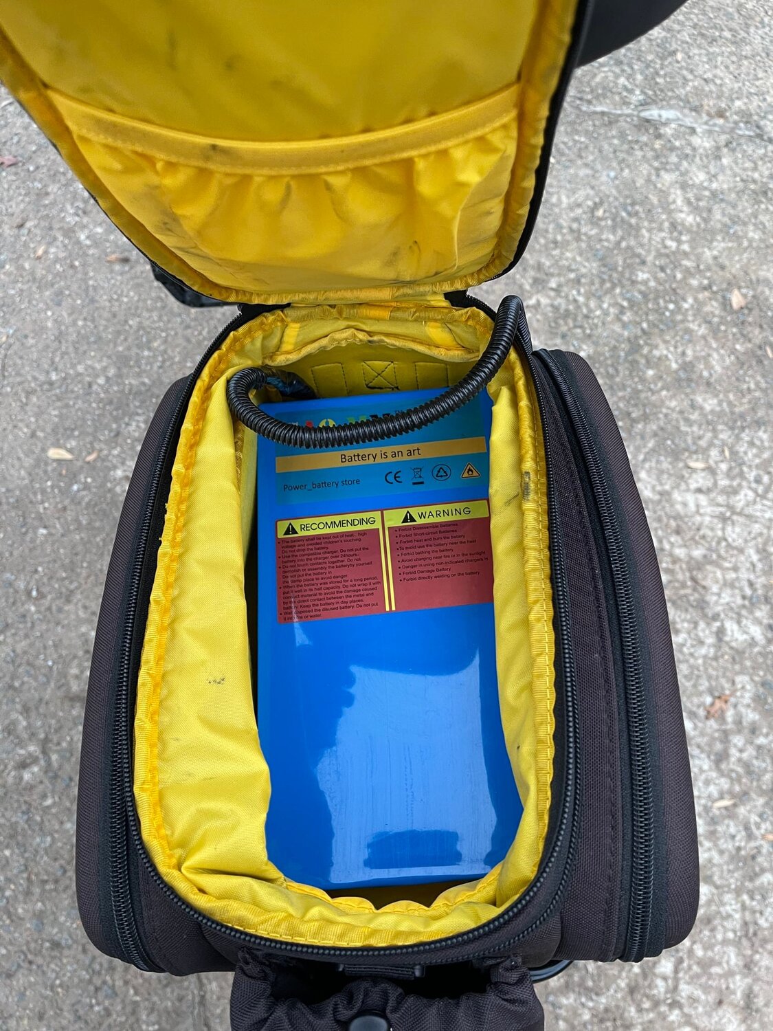

If you're going to put the battery in the basket or a rear bag, this one fits perfectly on my bike as an extended battery. I combined it with the stock battery for a total of 30ah. The bottle batteries look great, but I've found with an ebike that I want to ride a lot further than I originally thought I would. Maybe use a bottle battery as the main battery and wire a removable aux battery in the basket or rear bag.

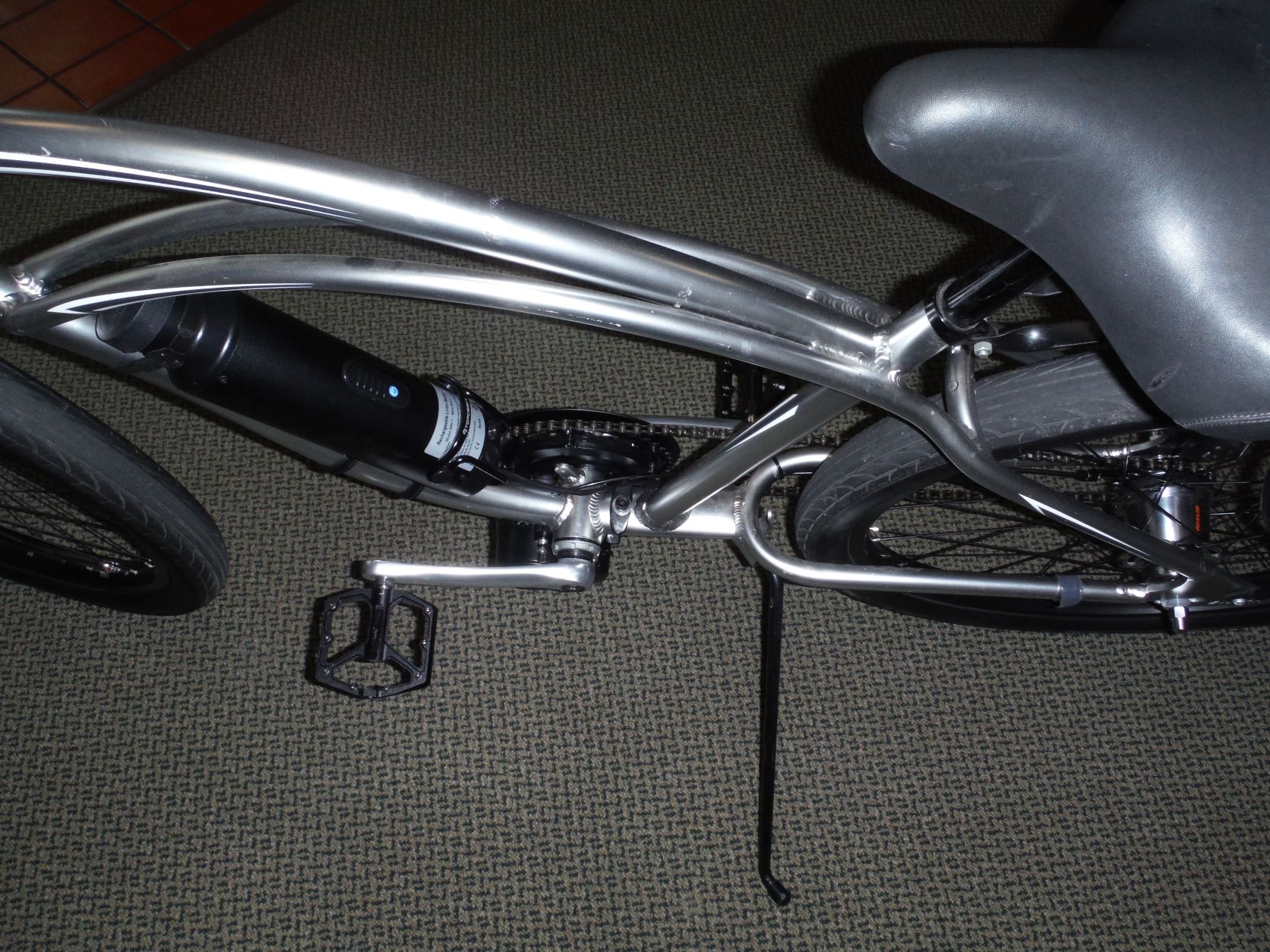

@Ducky77,

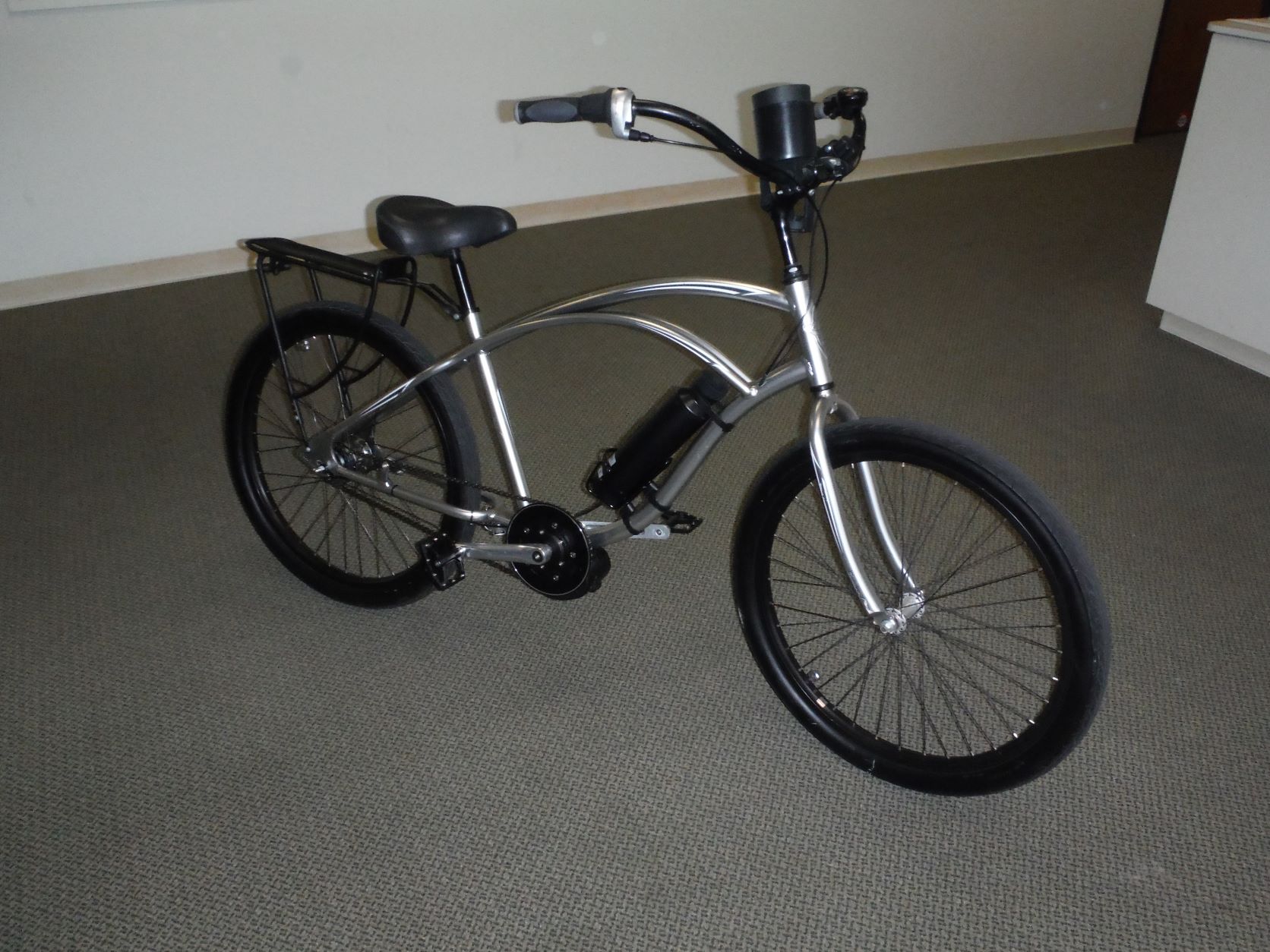

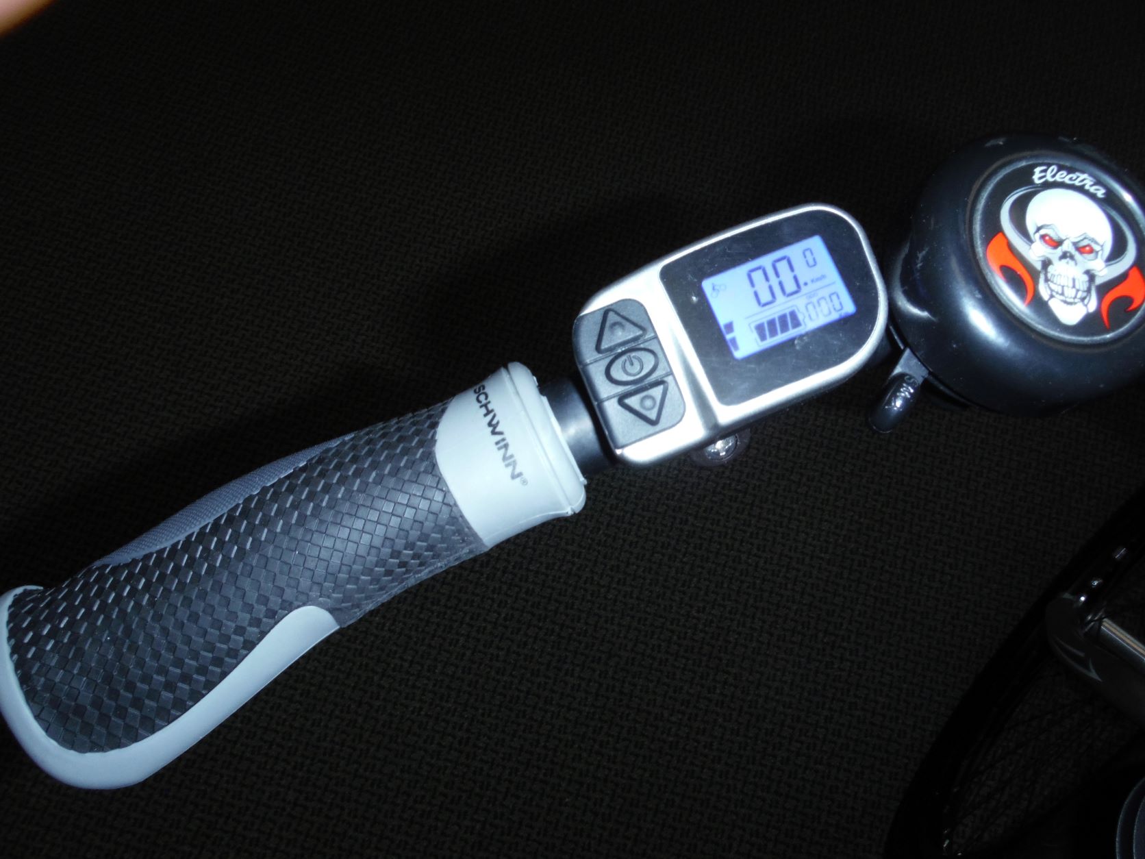

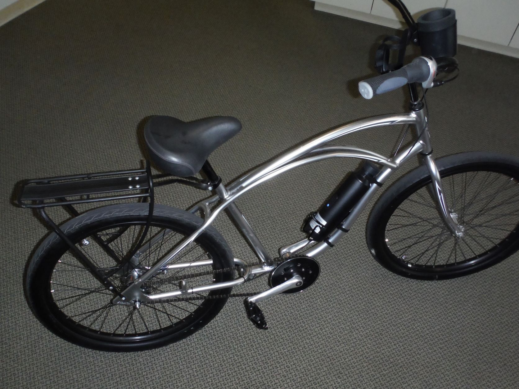

Sounds like a fun project. If the Townie is a single speed you will want to add gears to take advantage of the mid-drive. I do not talk about my suppliers. Those relationships have taken years to develop and the cost of tuition was very high in the form of mistakes. Here is a townie that I made electric. I hope it gives you some inspiration. Look at the wires and connectors on the handlebar. This battery will do a good 60 miles. Is your butt really going to want to ride for three hours? Keep all added weight low and to the center of the bike. Rack packs will flip a bike on tight corners.

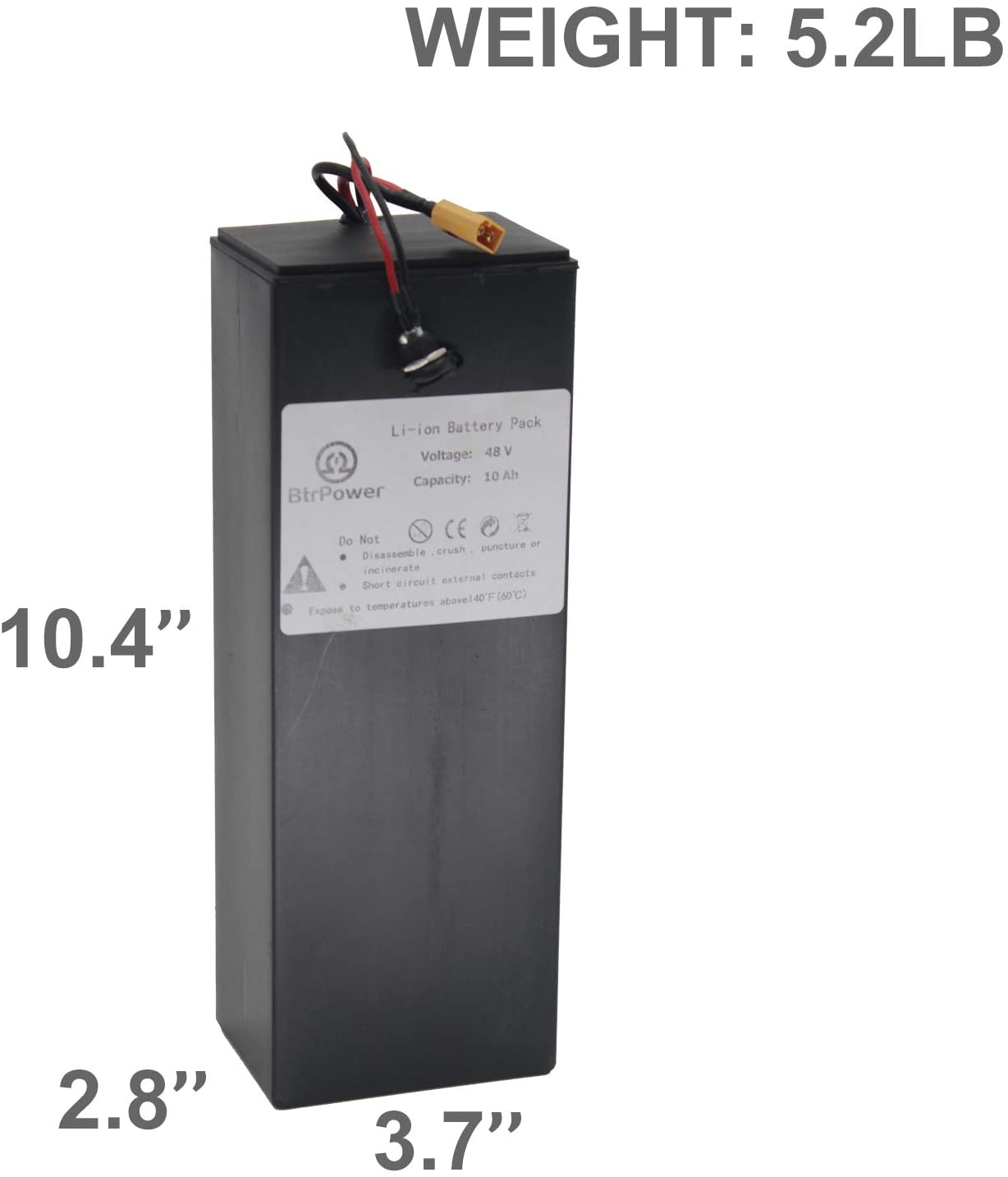

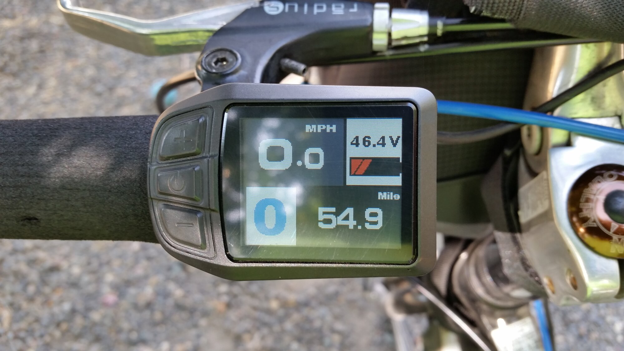

I've had good luck with using this one on a bike with a 48v 750w TSDZ2. $160, relatively small and light weight.
I put in a good amount of effort and don't use a throttle, this battery supports my rides over 50 miles on hilly routes.

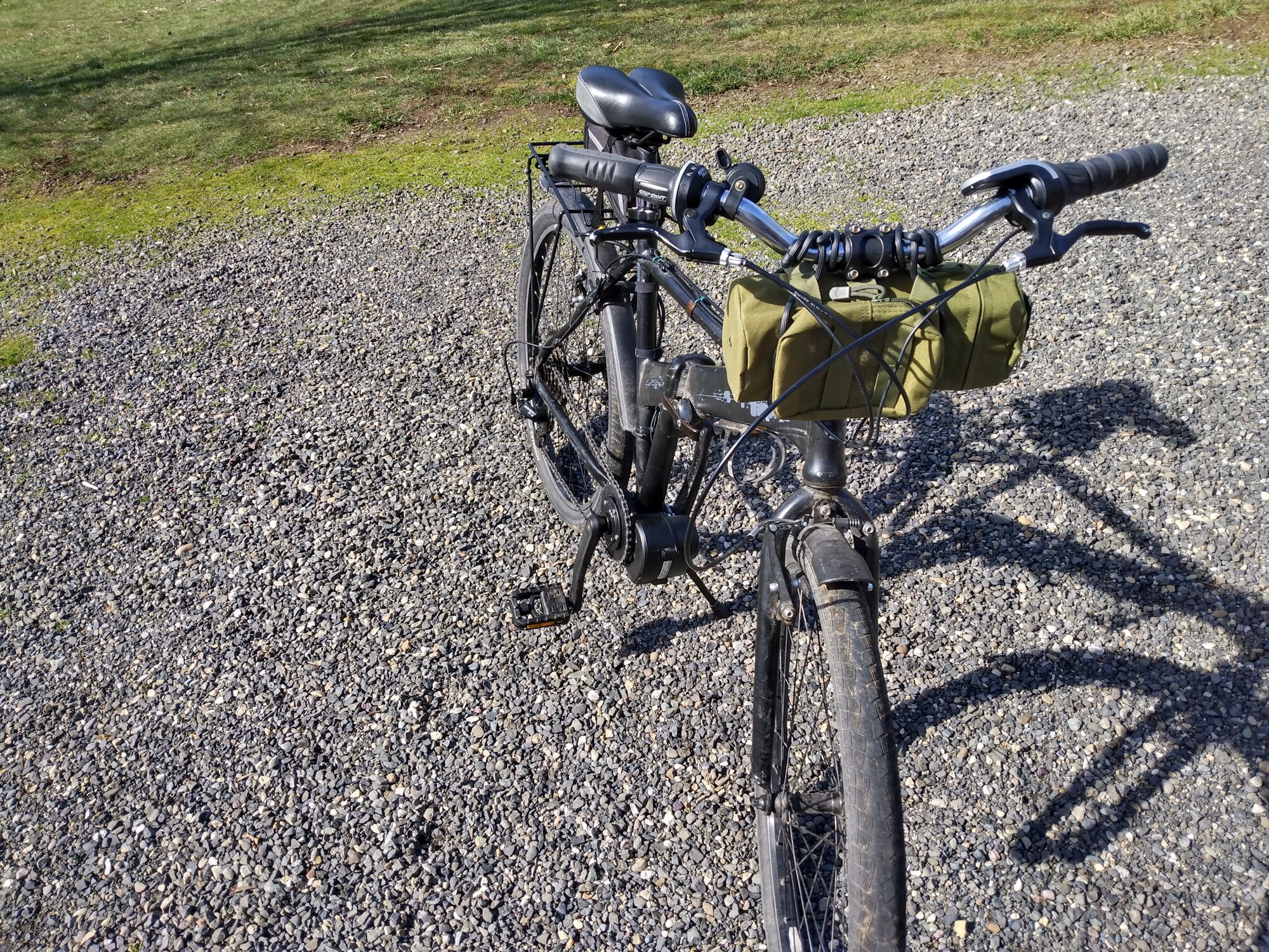

Battery and battery placement is the hard part. So far I have preferred to use frame bags when possible. On this bike I have a 48v 10ah battery in a MOLLE water bottle holder as a handlebar mount. Around 6.5# including the bag and there is an attached zippered storage pouch for other stuff. Definitely not perfect but what I could come up with.
