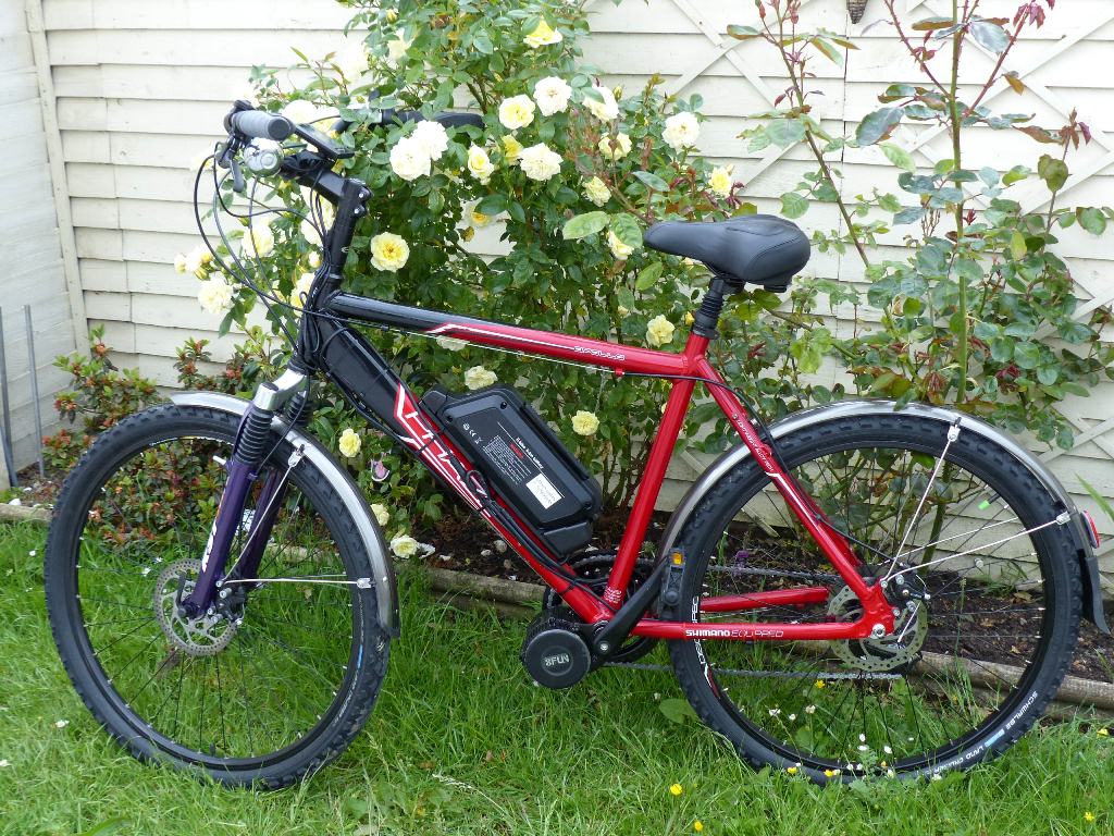

Hi, Just completed a similar build from the frame up with a 48v 13.6ah battery instead (photo attached).
I`m thinking your battery box is a little overkill even for a 15aH, there`s plenty of downtube and bottle batteries that power which should fit your frame?
You`ll find the power is harsh especially using the throttle, too much like an on/off switch, possibly em3ev have addressed that and re-programmed.
There`s a lot of info on programming the controller on endless sphere. Good luck with the build!!

LOL...I agree that the battery box will be bigger then necessary. I am building the larger box so I can accommodate custom larger capacity batteries. The down tube batteries are great and the best option for most conversions.
I don't install a throttle on any of my conversions. Used the throttle once on my Neo Carbon and thought...OK what's the point? I understand why some might want the throttle, but for me it's useless.
