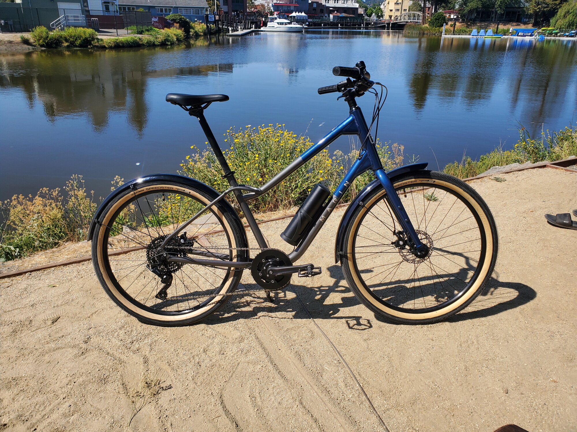

I made three bikes similar to what you are looking for. They are mid-step commuters with 2.35 tires so they do not need a suspension and can ride anywhere except the most extreme off road conditions. This one has a comfortable riding position with an 85Nm mid-drive. The starter bikes were about $600 before accessories and conversion. They are Marin Stinson 2's. The one in photo got a rack and panniers for shopping and commuting. They come with an 11-47 cassette of gears, which is a very wide range. The Medium fits just about everyone. This one is the XL; I also built a Small. That ridder went to a high-end bike store and spent $3500 on a bike that could not take hills. I got her money back and we went across the street to the Marin dealer, picked up her Stinson 2, then I did the conversion. She loves it.

@huckleberry, The woman who purchased that sized small bike was sold a Rove e+ with a five-year maintenance plan. She was told that it could take hills. It could not take the hill where she lives over looking the sea in Marin County, California. She had to walk the bike a mile. She already had one of my converted bikes and knew what it can do, but wanted a more comfortable bike that can do more than smooth tarmac. If you are local and read reviews on Google Maps we can discuss the details of your needs. Look for PedalUma eBikes, about 45 miles north of the Golden Gate. She saved a ton, got a more capable bike, and one that is not proprietary, so that in five-years if she needs a new battery, any same voltage battery from any source will work. And if in ten-years she needs a new motor, any universal fit motor will work as technology improves. Every part is interoperable, non-proprietary, and open source. Her bike is more like Wiki, Linux, or Firefox, than Apple. Two local places are qualified to work on the motors, and turnaround time is same or next day. With most local bike shops they need to send motors to a service center and that can take twelve weeks.
