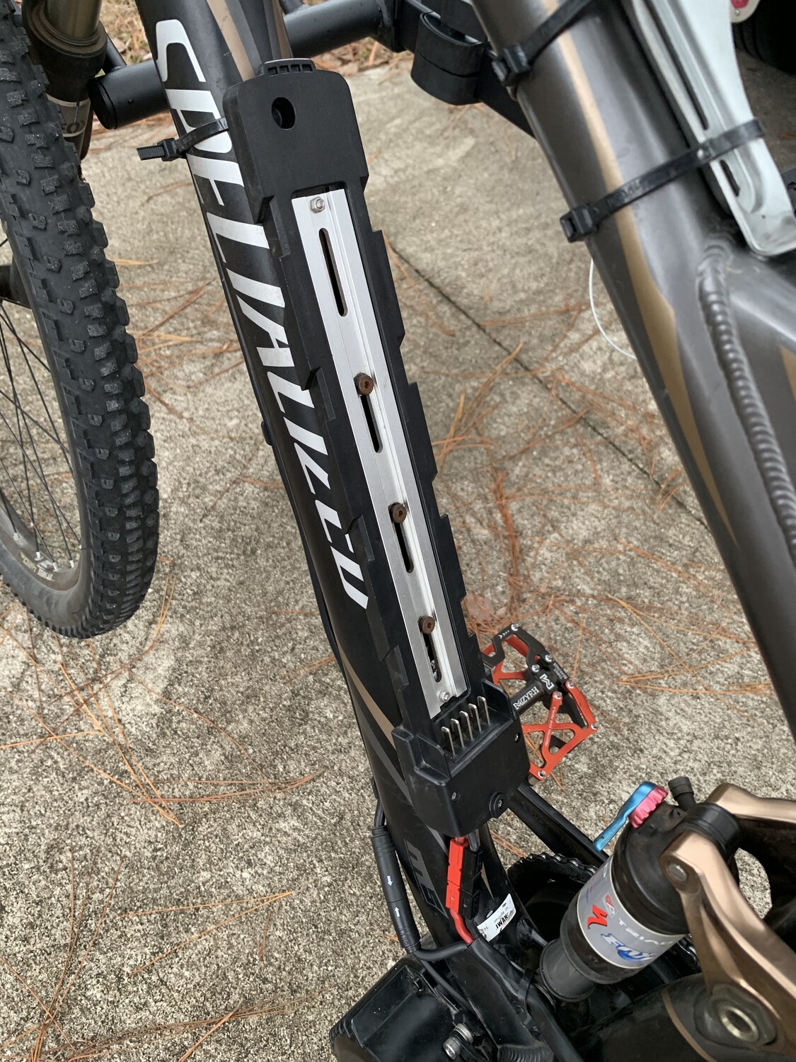

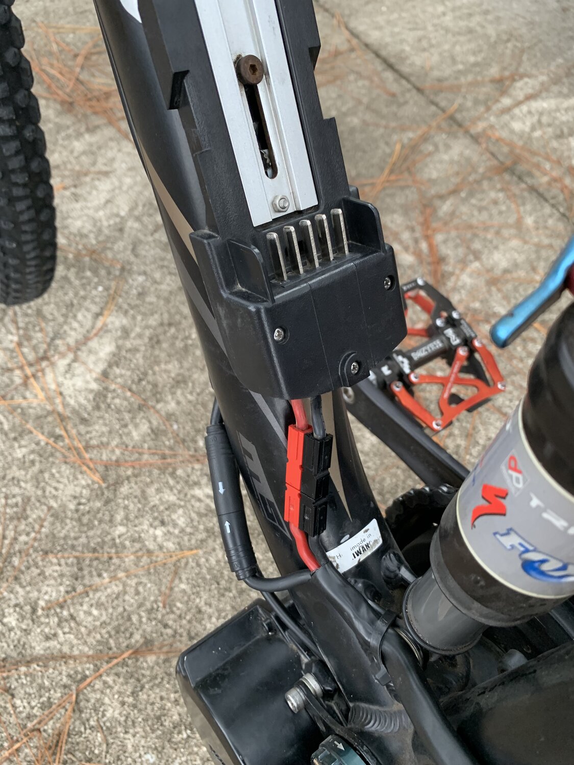

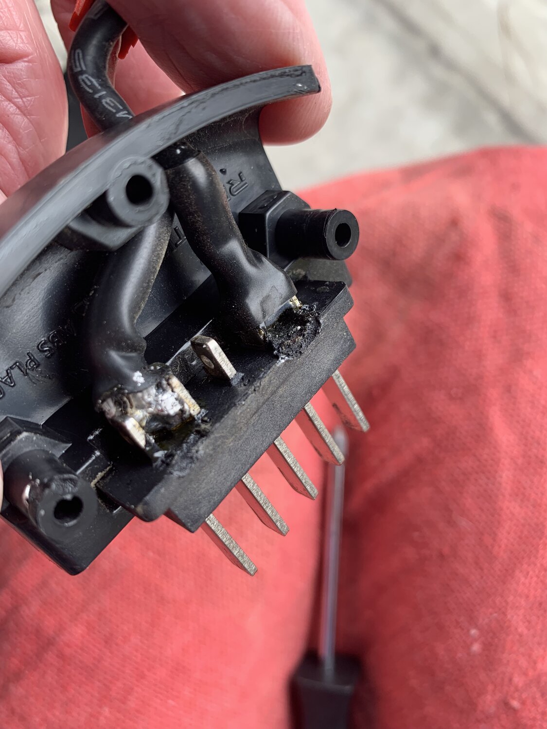

Hi, Petaluma, Thank you for your reply. After speaking with vendor

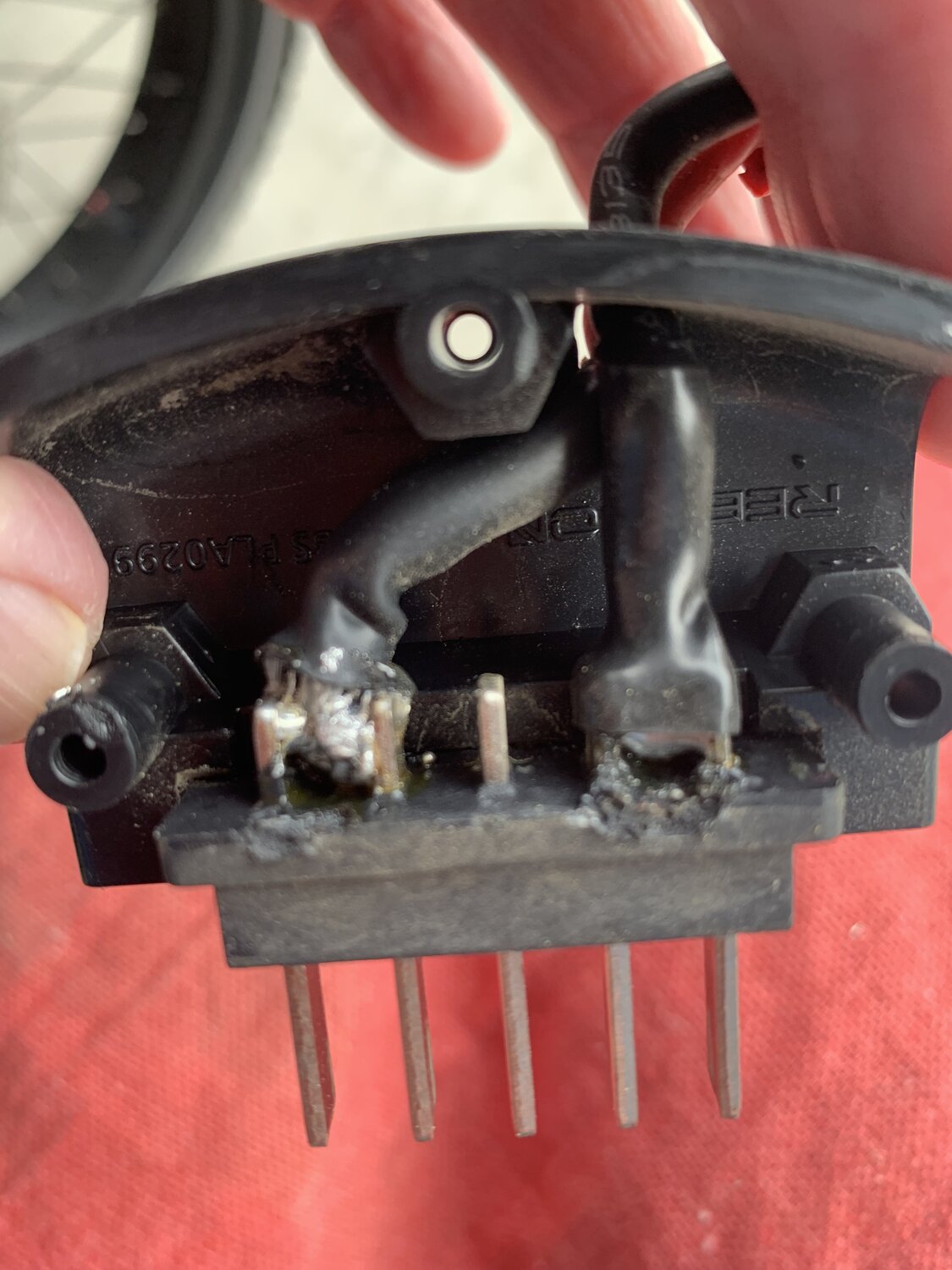

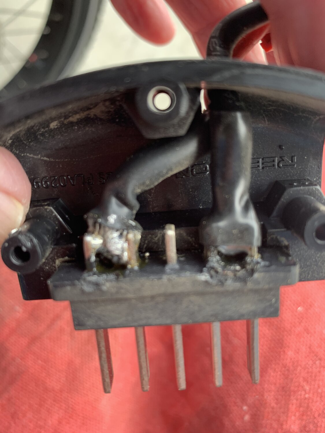

about above issues, I disassembled the battery cradle to see up close the
solder and shrink wrap connections. Appears the soldering is intact
but adjacent portion of interior of cradle case a bit melted as though heat from soldering gun or soldering tool brushed against. Don’t know if
a battery surge event, or prior short of some kind may be responsible.
Anybody see something there that a Newbie doesn’t see?
Have emailed original vendor to send a new battery cradle to see if
that may help. (See pics below).

Okay, now we are getting somewhere! Great photos. That helps a lot. The vaporized insulation material on the battery connection cradle was not caused by a soldering iron. Those are only less than 700 degrees F. This was caused by arching at welding temperatures, of more like 7,000 degrees. I suspect water incursion on the day the problem was first noticed. For example after the bike was washed with the battery mounted and ON. Two things: 1) With the battery OFF, clean the battery's contacts. 2) The welding arch most likely fried the controller. The part of the controller that fried saved the motor and display. When the new cradle is installed a fuse can be installed on the positive line side. In the future, that will be the first point of failure.
There’s a long history of failures with those Hailong case connectors. Unfortunately sellers do not warn or make owners aware they should inspect the case to base connectors.

Thanks for your assistance. Did make certain never to wash bike with battery attached. Was generally careful to keep water away from electrical, but…apparently not well enough. . We are where we are. So I’m assuming moisture managed to get into cradle connections area and voila, just add power! ( Am I understanding correctly?). Unlikely original vendor sells Bafang BBSHD controllers but will check.

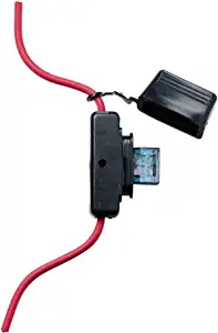

@tomjasz will check me on this for a second opinion. Something like this can go between the battery and the controller on the RED, +,
Positive side. For your setup, I would use a 40 Amps fuse. It would only blow when needed and not when just riding the bike. A spare fuse could be kept taped under your saddle. Automotive shrink, crimp, butt connectors would do the trick for the splice. In addition I would use black adhesive heat shrink tubbing over the connections for added protection and improved looks.
I use car stereo fuses as well as the blade type you posted. Sadly sellers don’t offer any advice regarding those blade connectors. If the battery is removed from the base regularly you’ll spread the base inserts eventually. I saw more failures where the user never, or seldom separated the two, and moisture was the culprit. I’ve been suggesting the use of Boeshield or ACF50 on the connection. That will solve the moisture issue.

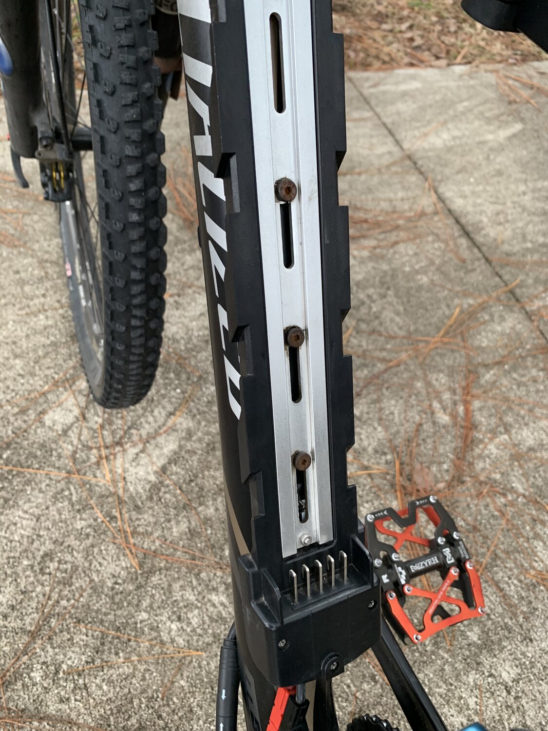

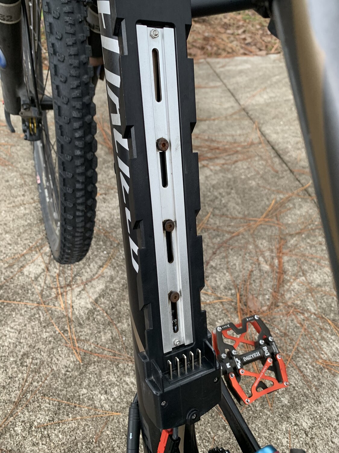

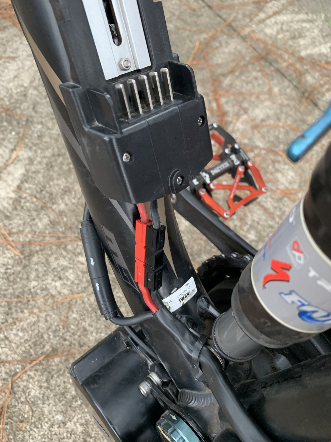

Thanks to all for input. Just wanted to make sure that the battery cradle I have ( with the electrical voltage arcing related damaged connector pin case shown in prior pics), is the same style or type as those prone to the issues of condensation, moisture leakage, and a history of failures. I have attached several pics here.

Looks to be. Think of the big aluminum plate as a glass of iced tea. I would use dielectric grease. I repels water. In and of itself it does not conduct. There will only be the transmission of electricity where there is direct contact.

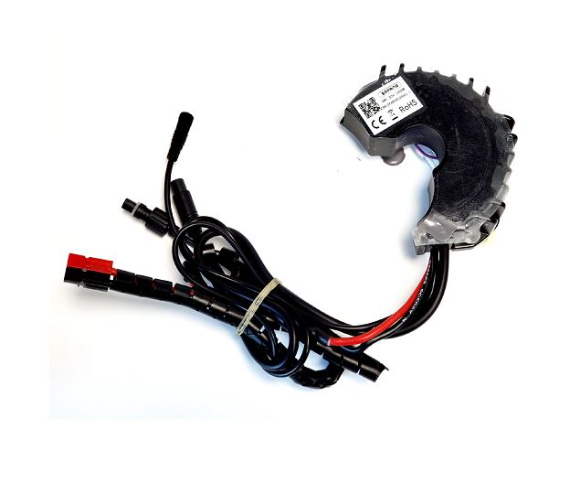

Long Delayed Update to BBSHD issues.
Thanks again to all for helpful education and
insights for troubleshooting and recovery. Sought out LUNA BIKES and Purchased BBSHD Controller (Hot Rod Edition) B style ( flat blade connectors). That’s the Ticket! Put on about 200 miles last month or so
and Back To Full Power! Display reads up to 1500 watts when using
throttle when I want a serious kick or max power. Appreciate the sage
contributors sharing their vast knowledge and experience. Kudos!
